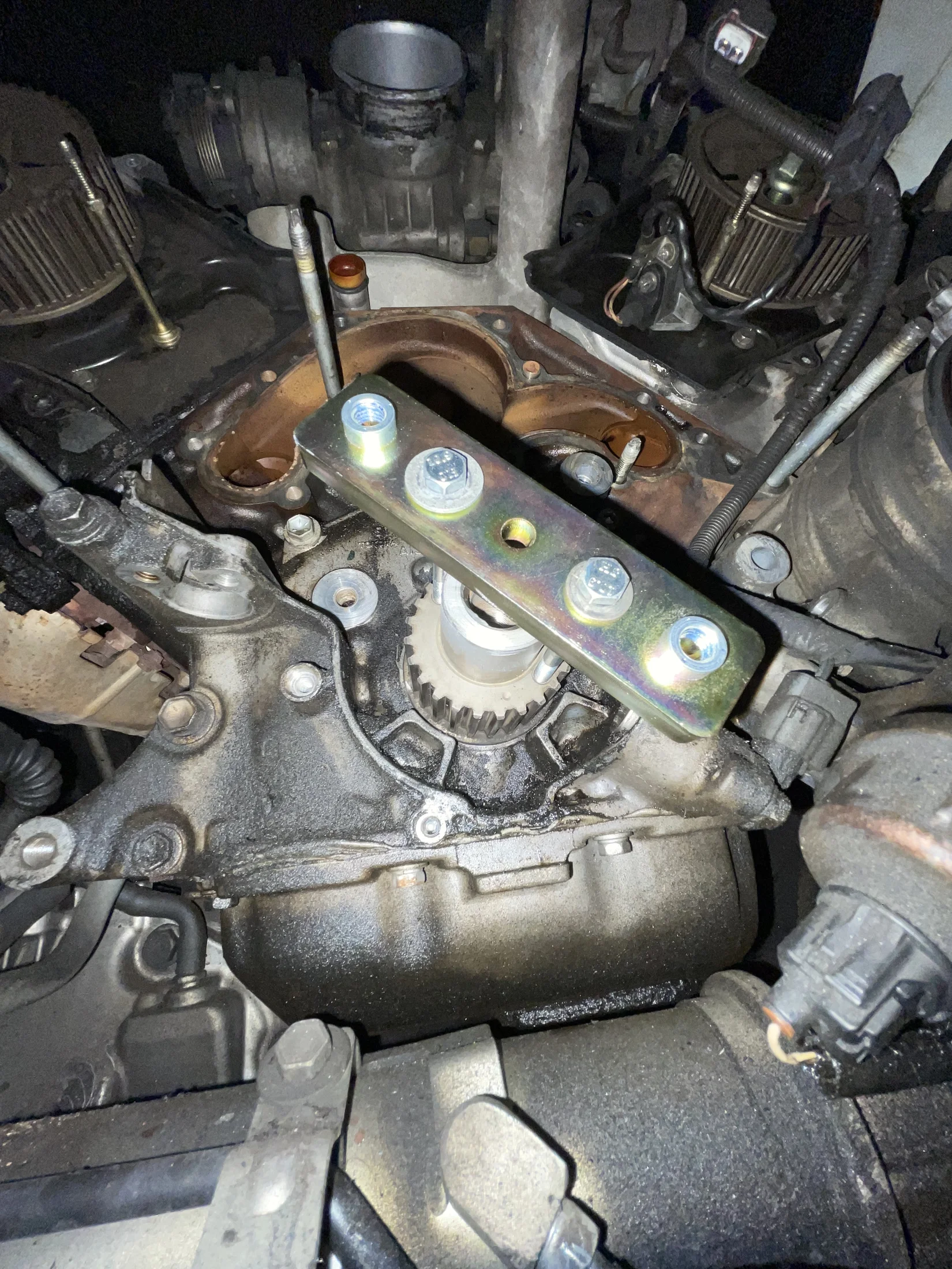

Redesigned the CV axle puller (again) to include 2x bolt holes for some M6 hardware
This allows the user to pull the 2UZ-FE crank pulley in order to replace the crank seal (90311-43006)
Also shrank the size of the tool down a bit to save material, cost, carbon emissions...
The center hole will now be threaded with M8x1.25 threads (same as the CV axle)
V2 will drop sometime in the next few weeks
