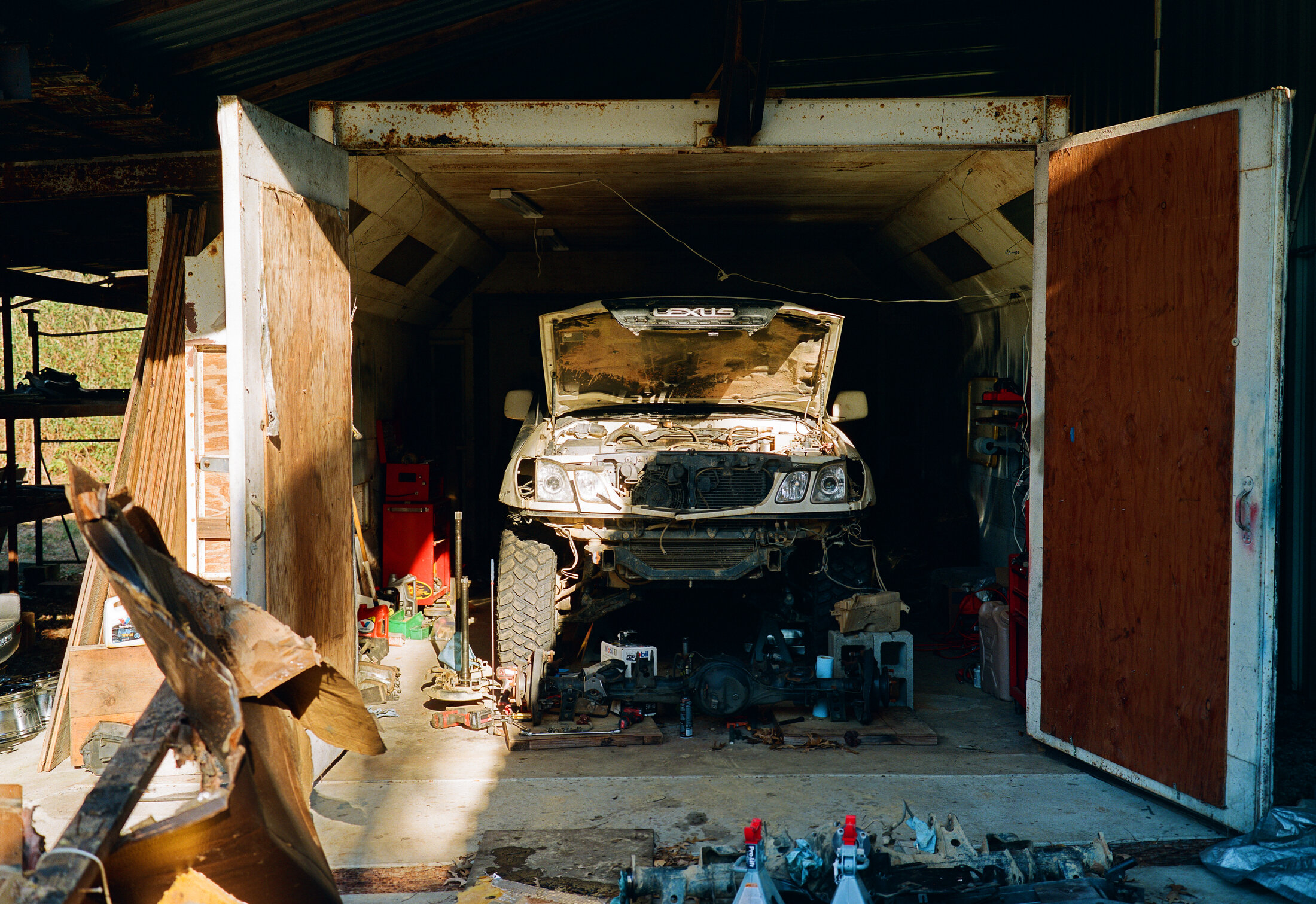

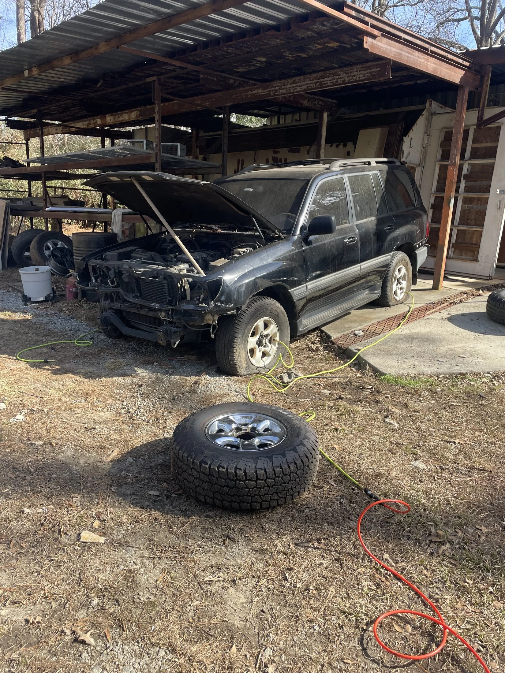

I’ll have a black 1998 L.C. being parted out soon (see photos). Engine and transmission are already spoken for. Does have a factory rear locker. 485,000 miles though

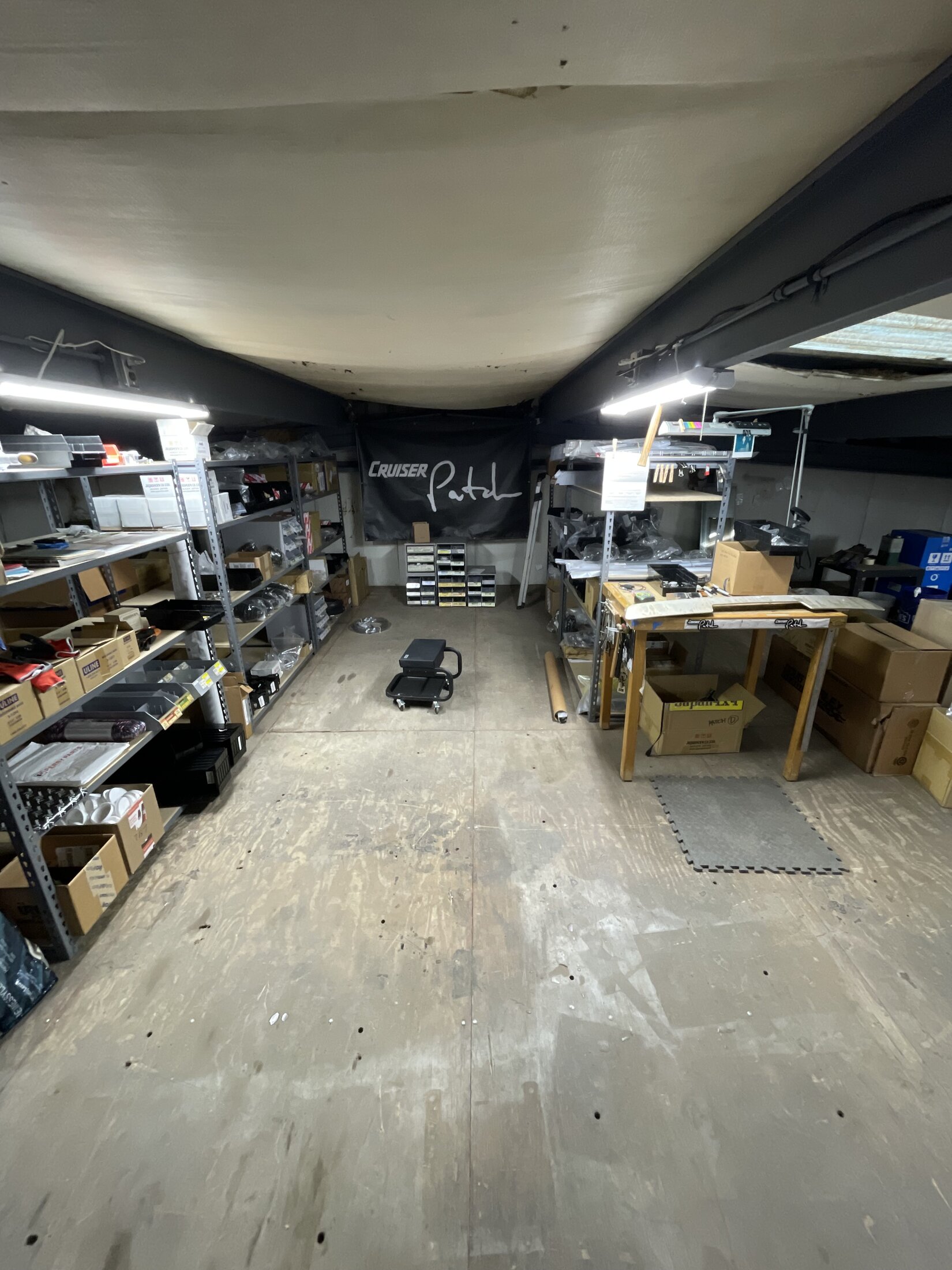

I've added a few new 100 Series Products to the site over the past week or so. Lots more to come in the future now that I have some space to spread out and collect my thoughts.

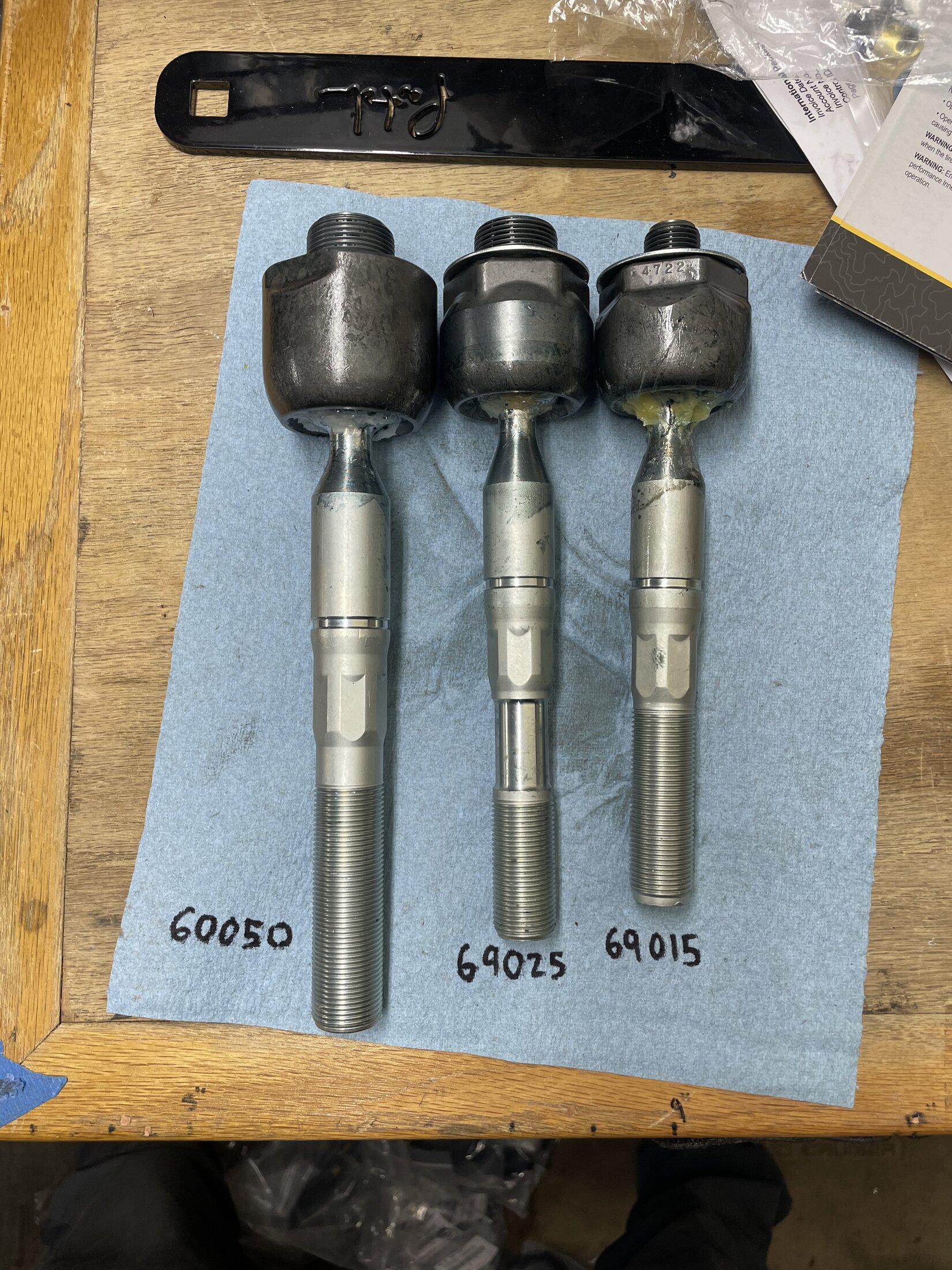

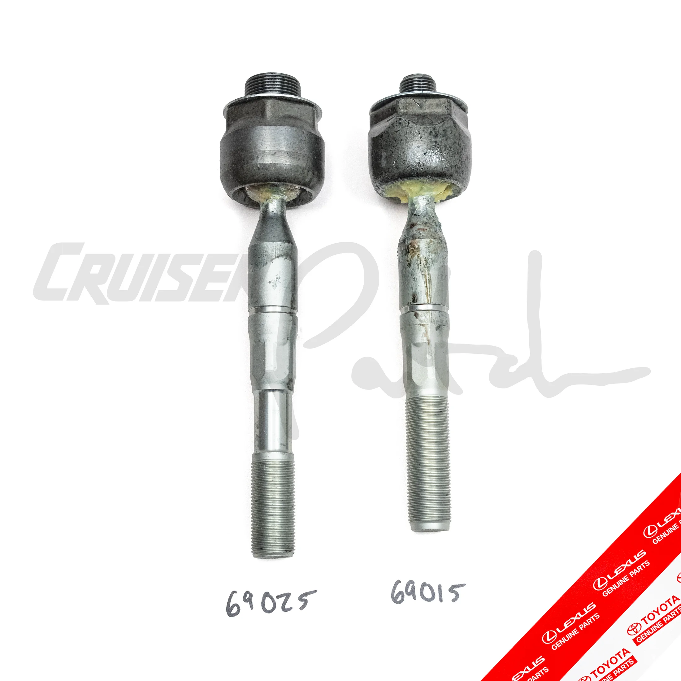

This may be a candidate for a new thread but I know of at least two late-model 100 series owners who have snapped inner tie rods on their rigs within the past two years.
Paging @MongooseGA and @BurnsCrew for photos/videos
I'm stocked up on 100 series inners now since these have become 'wear items' in our crew at least...

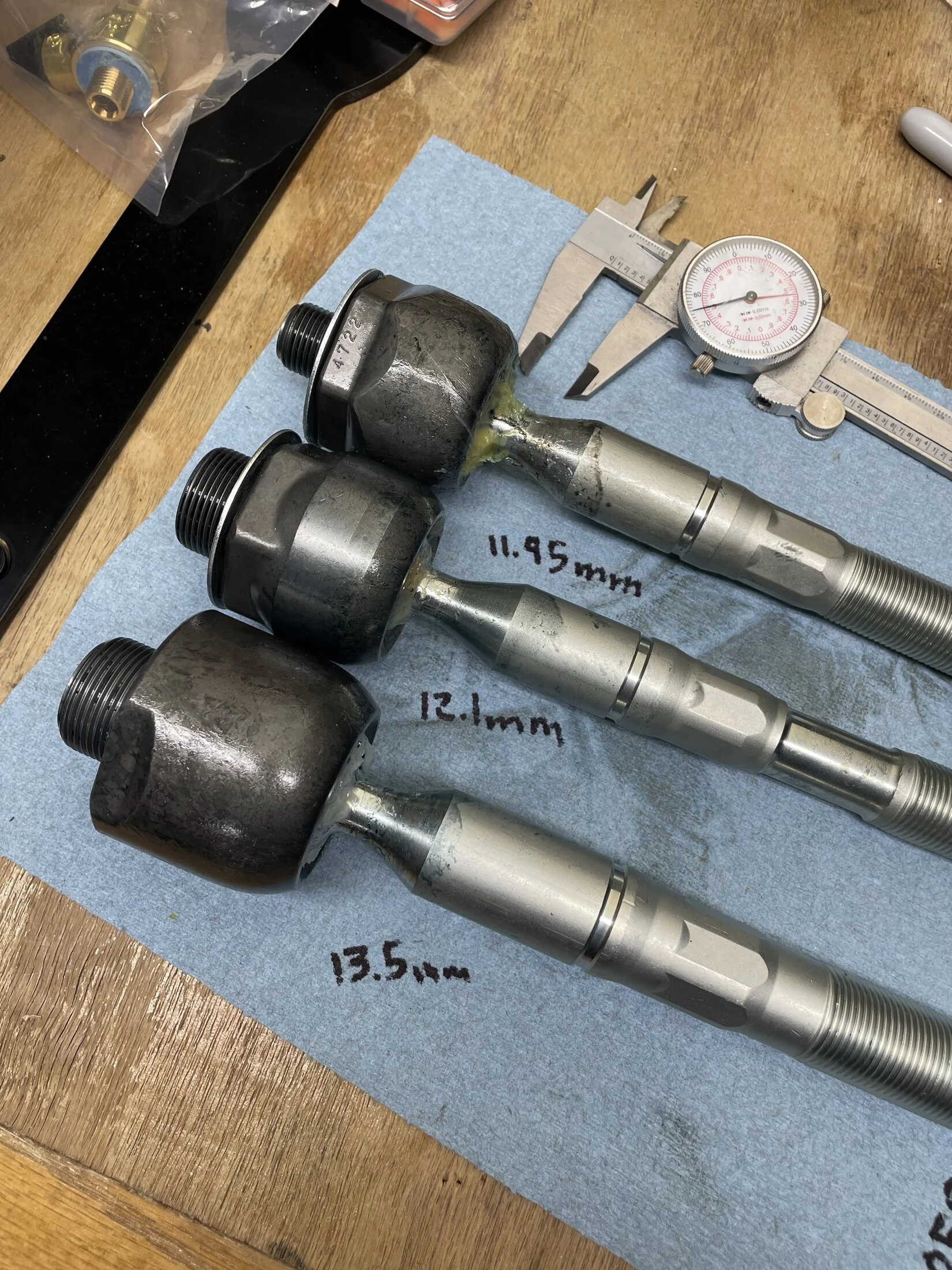

Here are some side-by-side comparison photos of the 200 inners, late model 100 inners, and early model 100 inners.
The dimensions I measured are at the smallest point on the tie rod (also where they broke in both cases).
I was curious to see if 200 inners would thread onto a 100 rack (they will not) or if the smaller threads were the same size for the outer TRE (they aren't). Rats.

What's interesting to me is that you see tie rods snapping all the time on different model Toyotas, yet it's not typically common on 100s. It may be a sheer volume thing where there's more Tacomas and 4runners out there in general (and then also wheeling their rigs hard on the trail)? However, even on MUD I'm not seeing a lot of discussion or talk about tie rods breaking on 100s. I haven't done any measurements of a Tacoma tie rod personally. The main take away from this is I'm officially paranoid and loading up on extra inners and outers.
I could be mistaken (it happened once) but I do believe the Cruisers had slightly heftier tie rods than the peasant trucks.
FWIW, Crossfit Zach and I are the only 2 *I* know of who have had this issue. But, I also carry spares now due to this incident. Zach wheels pretty hard and is now on 37s, and I had some kind of issue before climbing those steps in the video (visible if you watch in slow-mo). I was also locked in the front, which I don't tend to like doing when there's much steering to be done.
You should also grab some extra U-joints from Patch, because those have a little more history of trail breakage than the tie rods. I carry a spare f/r drive shaft, spare axle, spare inner tie rod, and 2 spare outers (D/P specific).

Oem 100 series tie rods generally don’t break…. However 200 series tiie rods NEVER break ;)
they just find the next link in the chain which is the CV
Well I’m not really sure what one has to do with the other but I’ll play along…..
It’s better than a broken front diff. :p
Did I miss the part numbers for the tie rods? Would like to buy spares all of a sudden

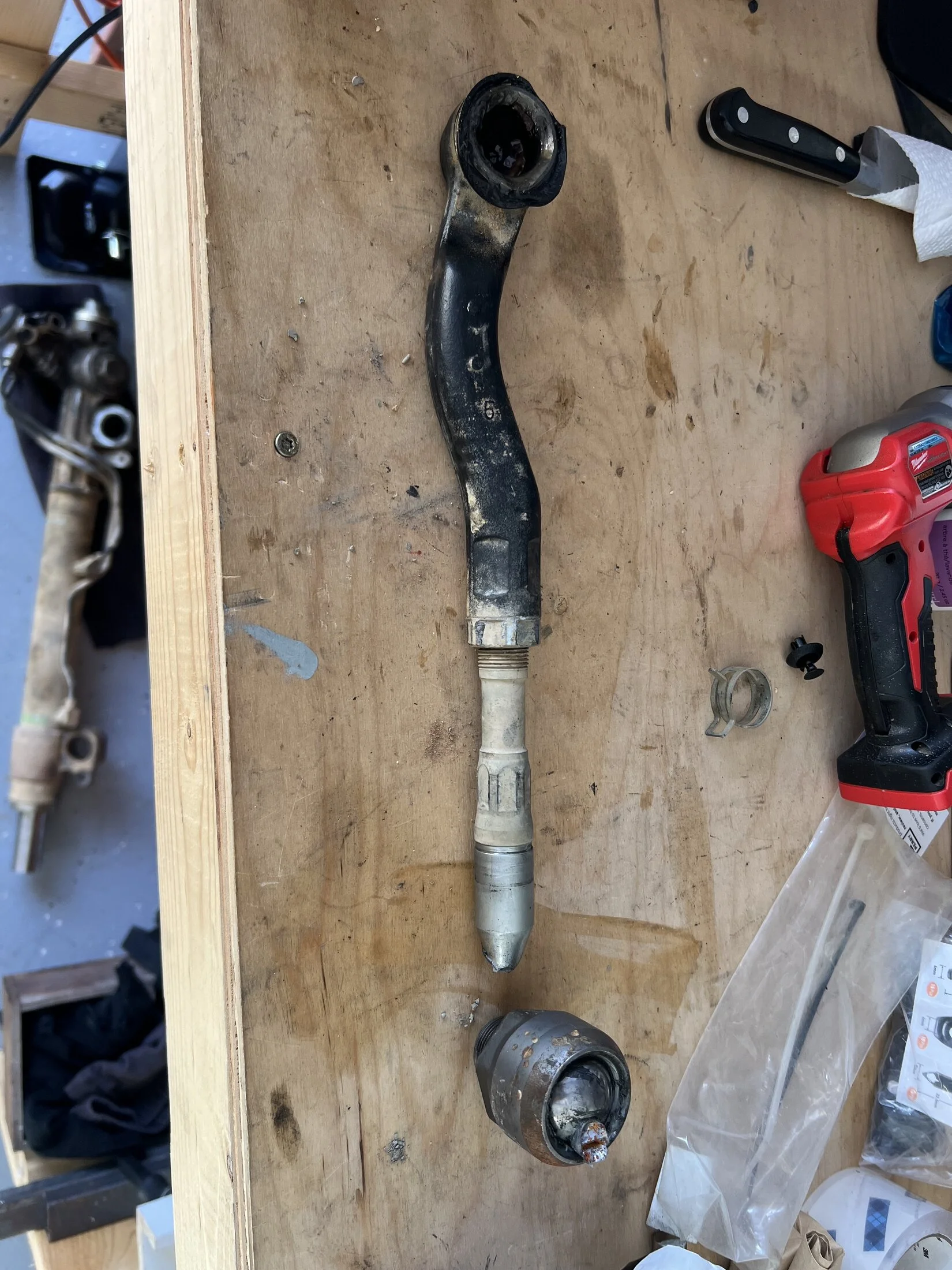

FWIW, I was in an odd situation. Where I was sliding backwards down a hill after attempting a rather spirited run at it in 2nd gear. As I was sliding backwards down the hill, my driver side wheel caught a rock and just pulled the tire very aggressively to the point of snapping the tie rod.
The tie rod broke with such a force, that it ejected the outer tie rod from the steering knuckle, leaving the ball joint bolted in and slammed into my shock mount on the LCA, denting the shock mount down against the body. The whole truck jumped when this happened. I honestly thought I blew a cv in a royal fashion.
The first photo is me realizing I did an outer and an inner at the same time! Hahaha, and the Cv Is OEM and alright as far as I know.
