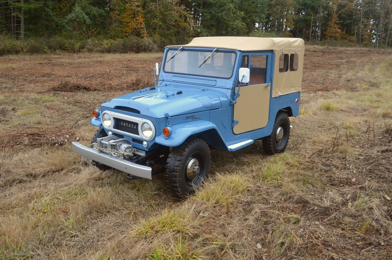

Black is good too, especially for early rigs.

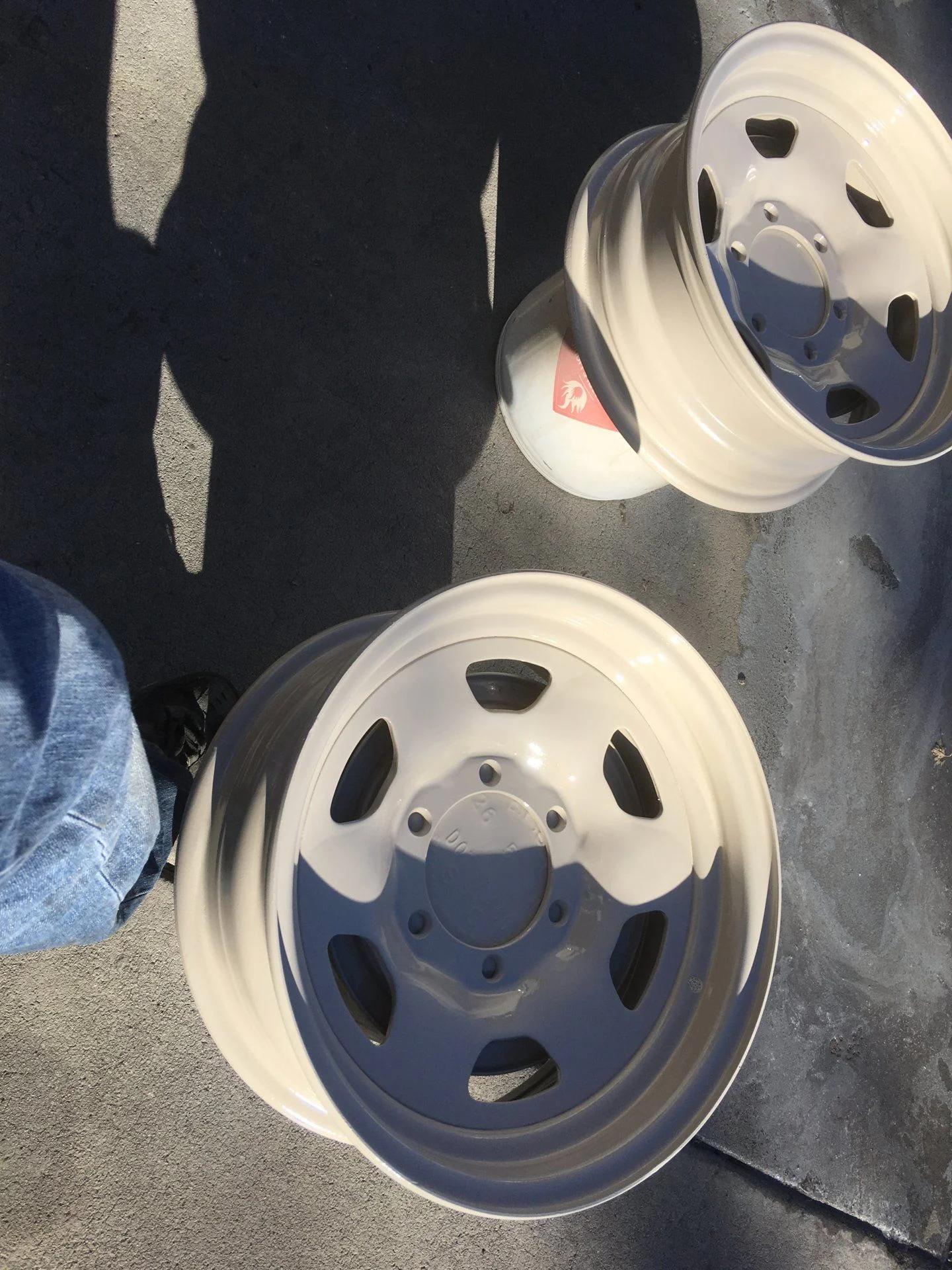

Admittedly, I'm no expert, but I chose to paint mine Shell Ivory. The wheels are not "correct" for my year ('74) but I got a super-good deal on them, I love the look and they will match my bezel and roof. Incidentally the color below matches (almost perfectly) the original paint I found under the respray on both the bezels I have.

Apparently those blasted and repainted in "very close to the factory Cygnus white originally on the rims" wheels are so rare they trade straight across for their weight in gold. :rofl: Also, Cygnus white appears in the color books for body paint, I did not see it in the paint book for accessories that I saw. And if anyone is thinking about pulling the trigger on those eBay wheels, I'll sell you 5 in the same "fresh from paint" condition (although they are Shell Ivory, if you think Cygnus is correct) for $2000 shipped LOL. 2 of them pictured below. Hit me in my PMs.

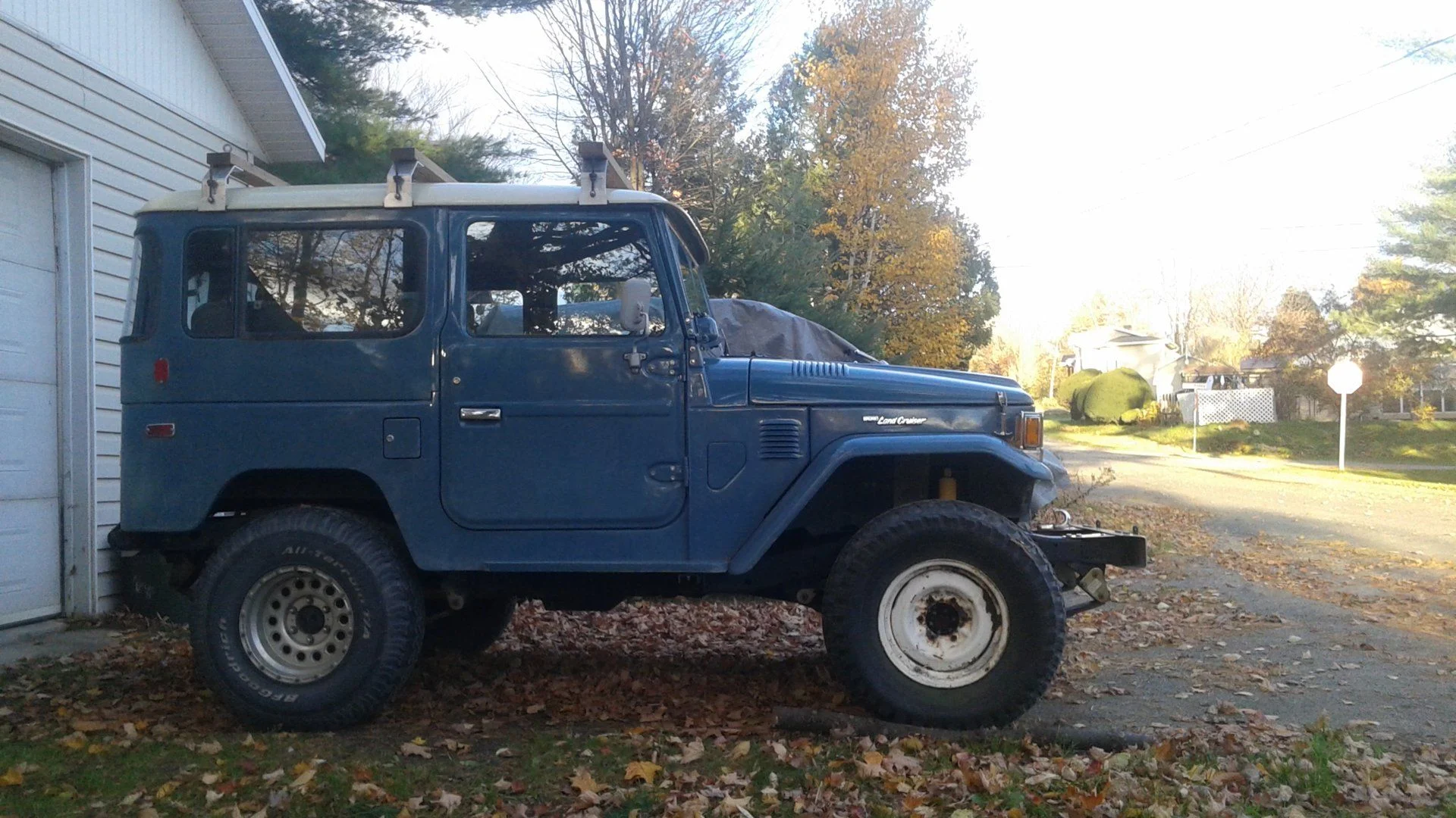

Early clip style wheels, '67 and earlier (I think) are black. Later clip wheels (as in clips to hold the hub caps) would be grey until 1979 the US wheels are similar to a 60 series wheel and are white. Non US split rims should be grey.

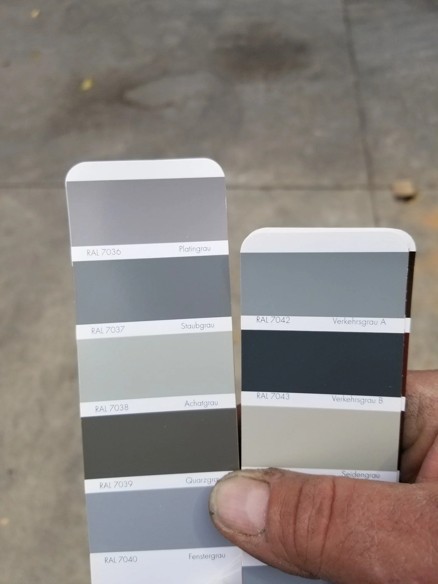

If you go grey powder coat, RAL 7042 like @pbr streetgang said or try RAL 7037.
If you go white powder try RAL 9016 or more yellowish RAL 9010.

RAL 7037 powder coat.
Both 7042 and 7037 cast a little "brown" and not "blue". It looks a lot better on a Cruiser imo. As for the colors one is just a bit darker than the other. Both nice tho.

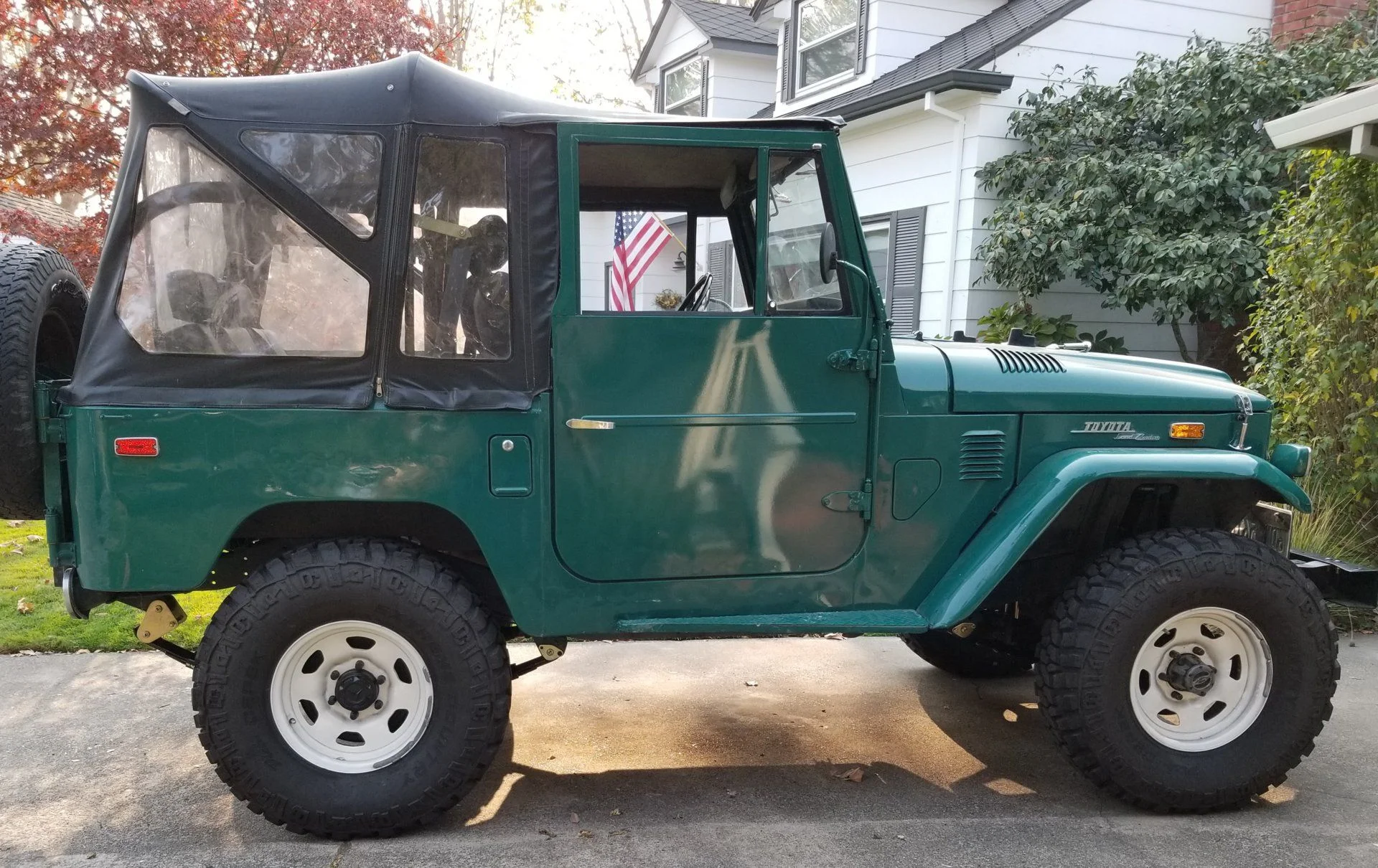

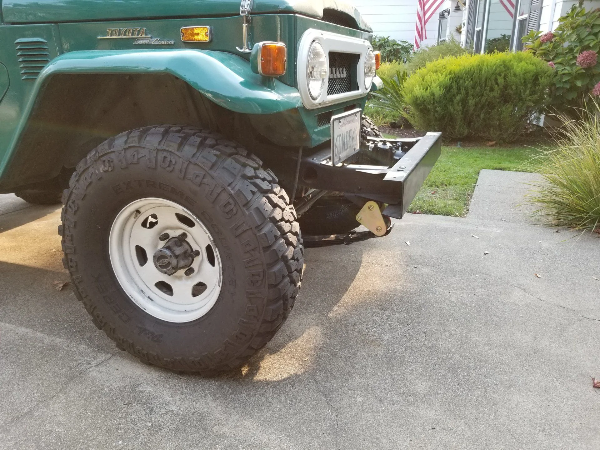

I also have a set of 5 of the spoked wheels which are appropriate for your year. I am trying to figure out what to do with them since I'm having a fit up issue with them on my '76 that is necessitating wheel spacers. They are powder coated Cygnus White, but have been plastidipped over them, which can be removed.
Did you find a rattle can that was close to Shell Ivory or did you have paint mixed?
Rustoleum rattled bows n rims in Satin Heirloom white. Initially a touch bright....but with a few months of sun and natural darkening-the rims will catch up to the bows and body.
