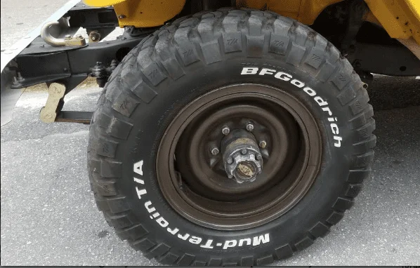

I am a Newbee to this forum, as well as a newbee to owning my first 1982 FJ40. I have a really simple question to start. The color of my wheels are brown. I really like the "cement gray" colored wheels I have seen on other FJ40's and was wondering what the "correct" colors for a 1982 are?

Those are 16" split rim and the color is wrong. Stock 40's came with 15" non split rims

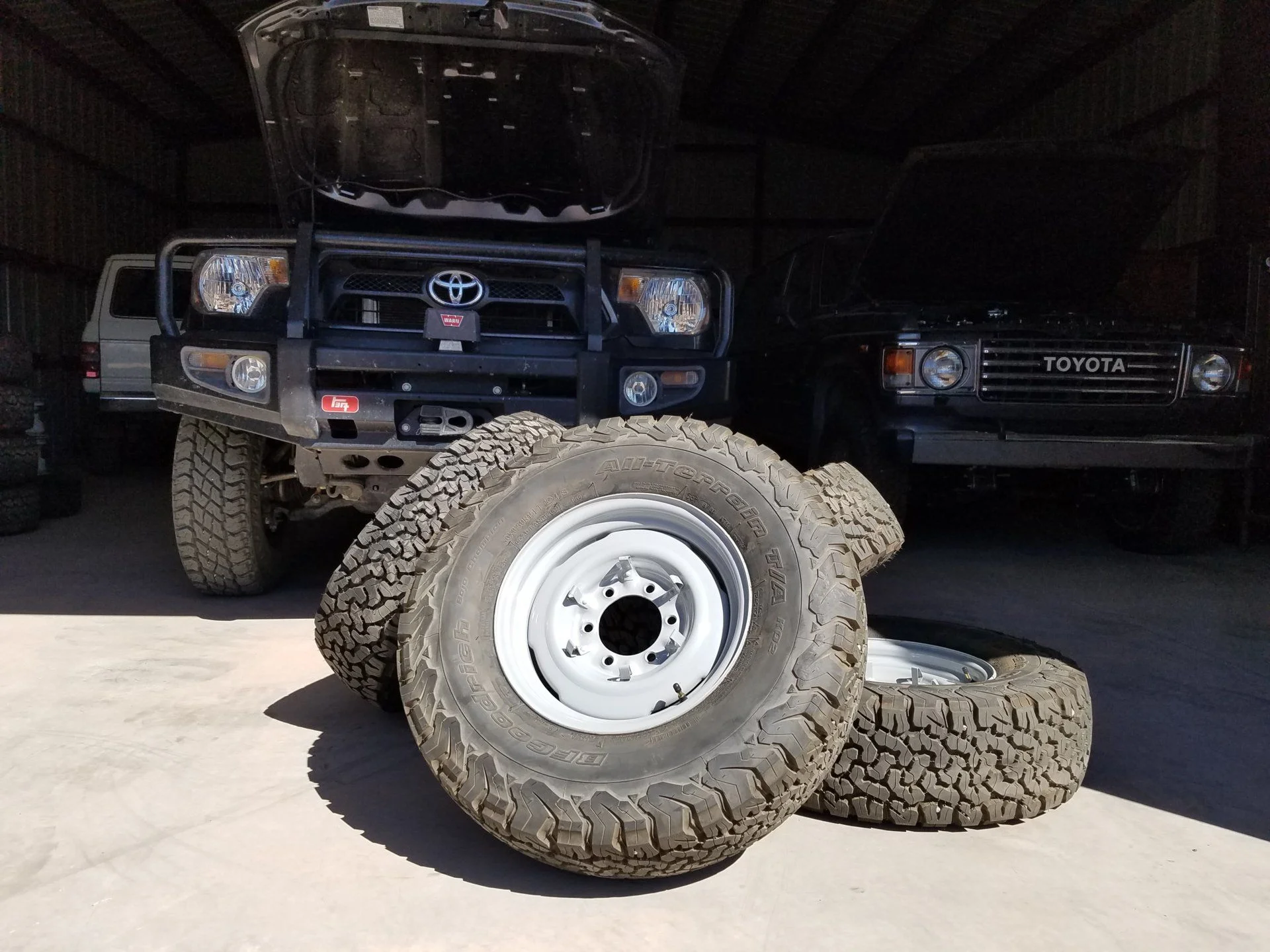

On a slightly related note. As far as matching the grey on OE 15"s we've been very happy with Cardinal RAL 7042 P008-GR21 powdercoat.

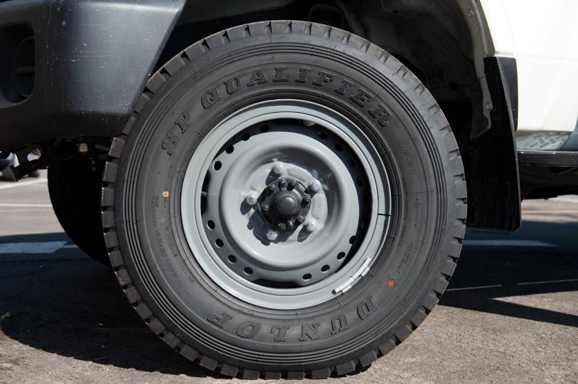

OP is in Florida, which is apparently crawling with SA imports. Those 16" splits are probably correct for a So. American truck. Still should be gray, though.
