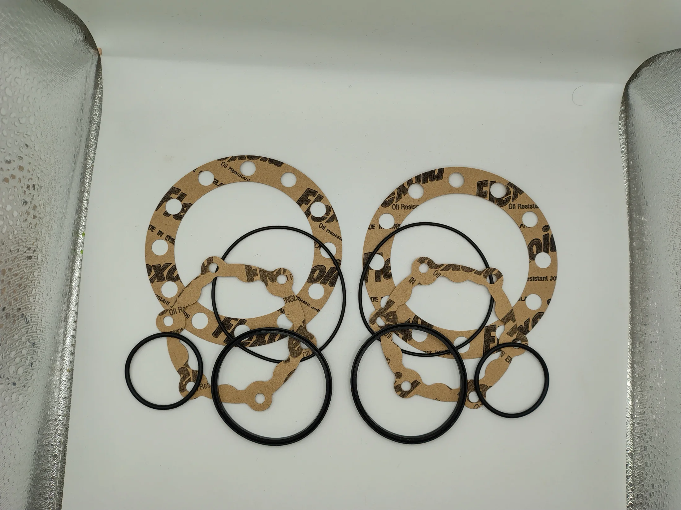

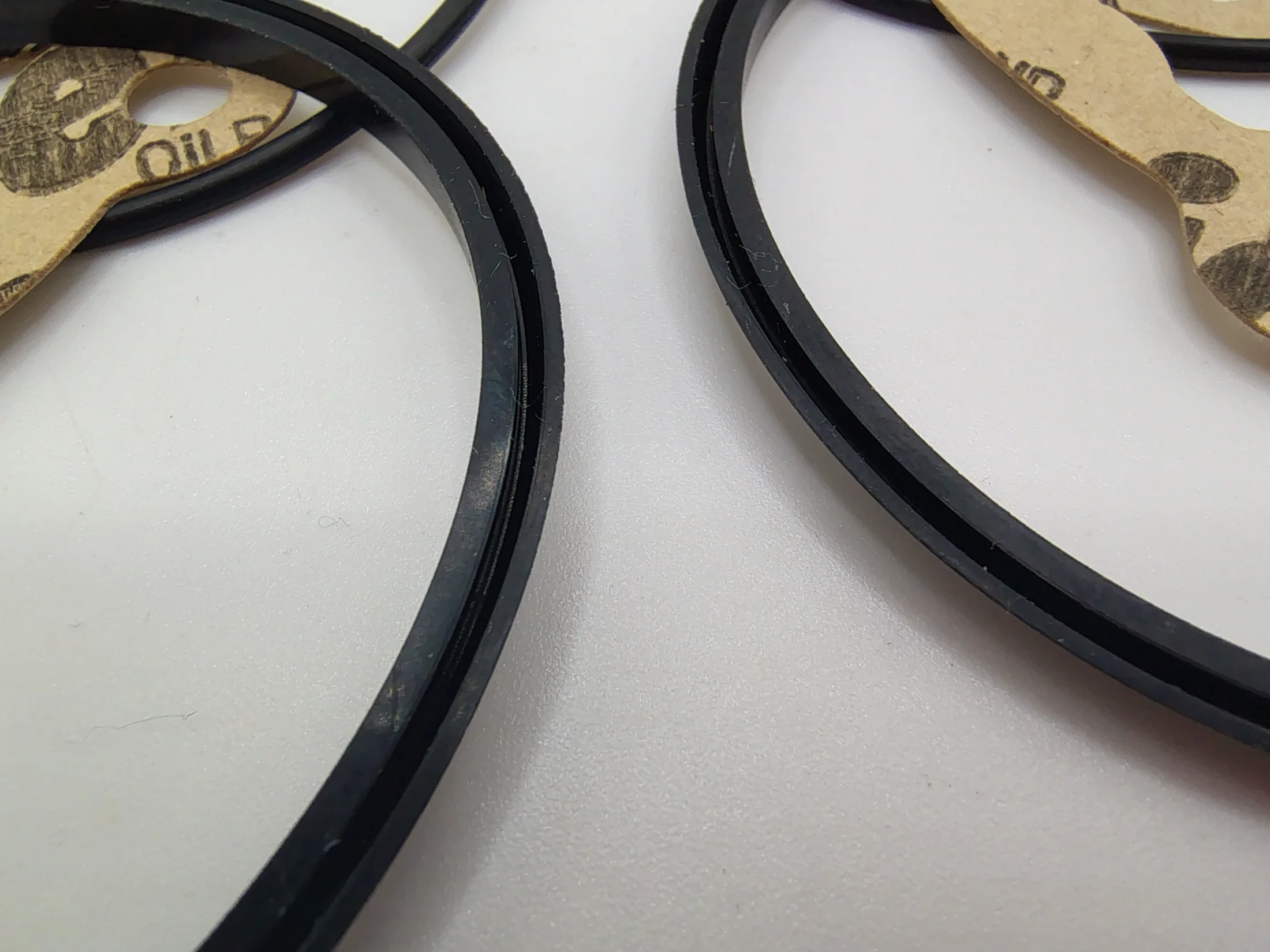

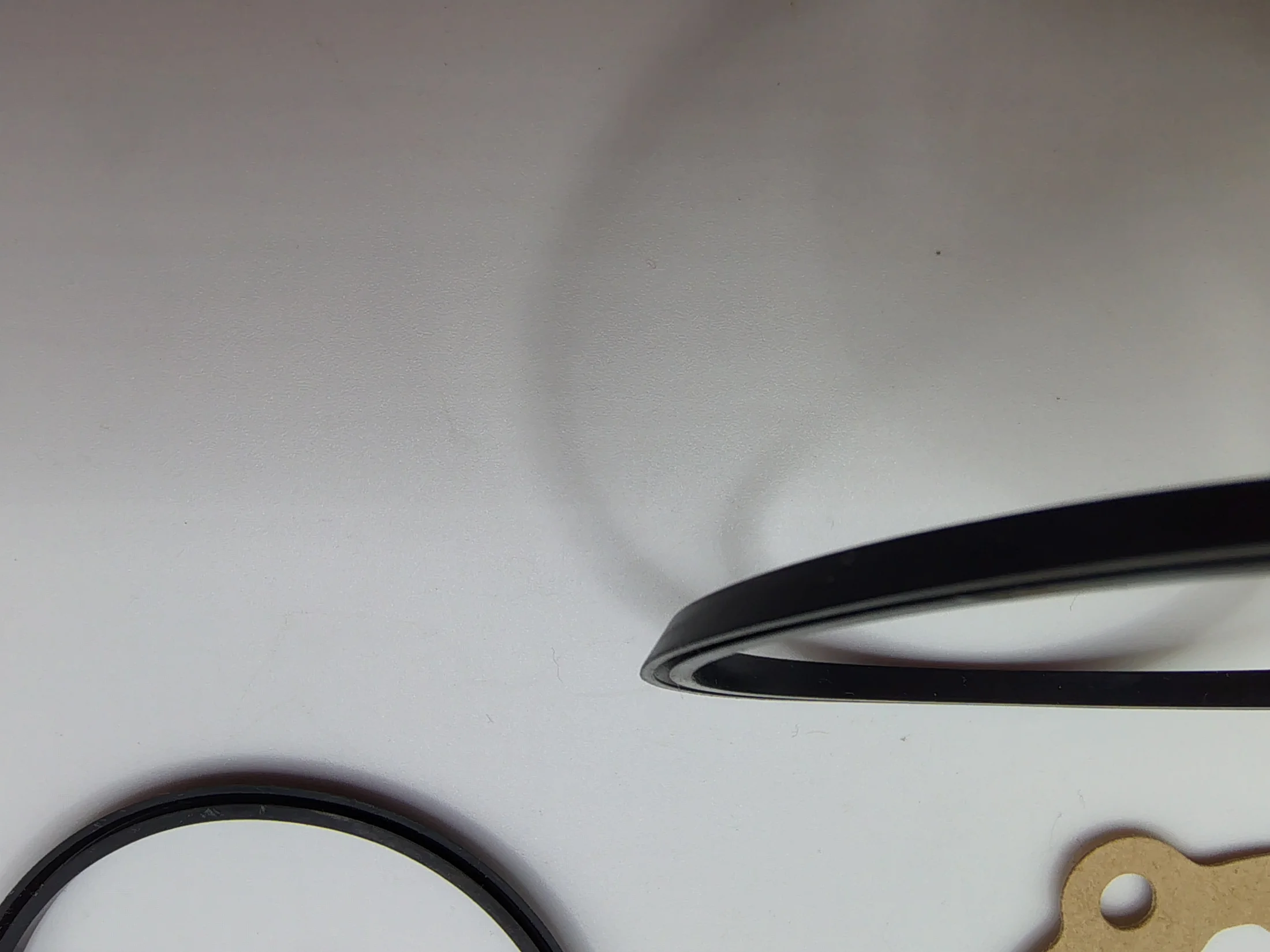

Hi all,
These are the rings I made for the dials of old AVM hubs but they look uncannily similar to the grooved rings SE206 4000 for old Warn hubs discussed here. I have noticed the manufacturers of locking hubs often borrow designs from one another or license/sell complete hubs under many names.
I am looking for someone with old Warn hubs to try these for fitment and take some photos.
If they fit I have a complete rebuild kit available.
I am in the Netherlands so it will take some time before they are delivered.

The idea is I send a pair of these rings to the one who is in a position and interested in trying fitting them and send me a couple of half decent photos. Preferably within a couple of weeks after receiving the rings.
No money involved.
I am willing to work with you.
Just to confirm, these are the hubs I would perform the test fit on.
I will PM you my mailing address.
