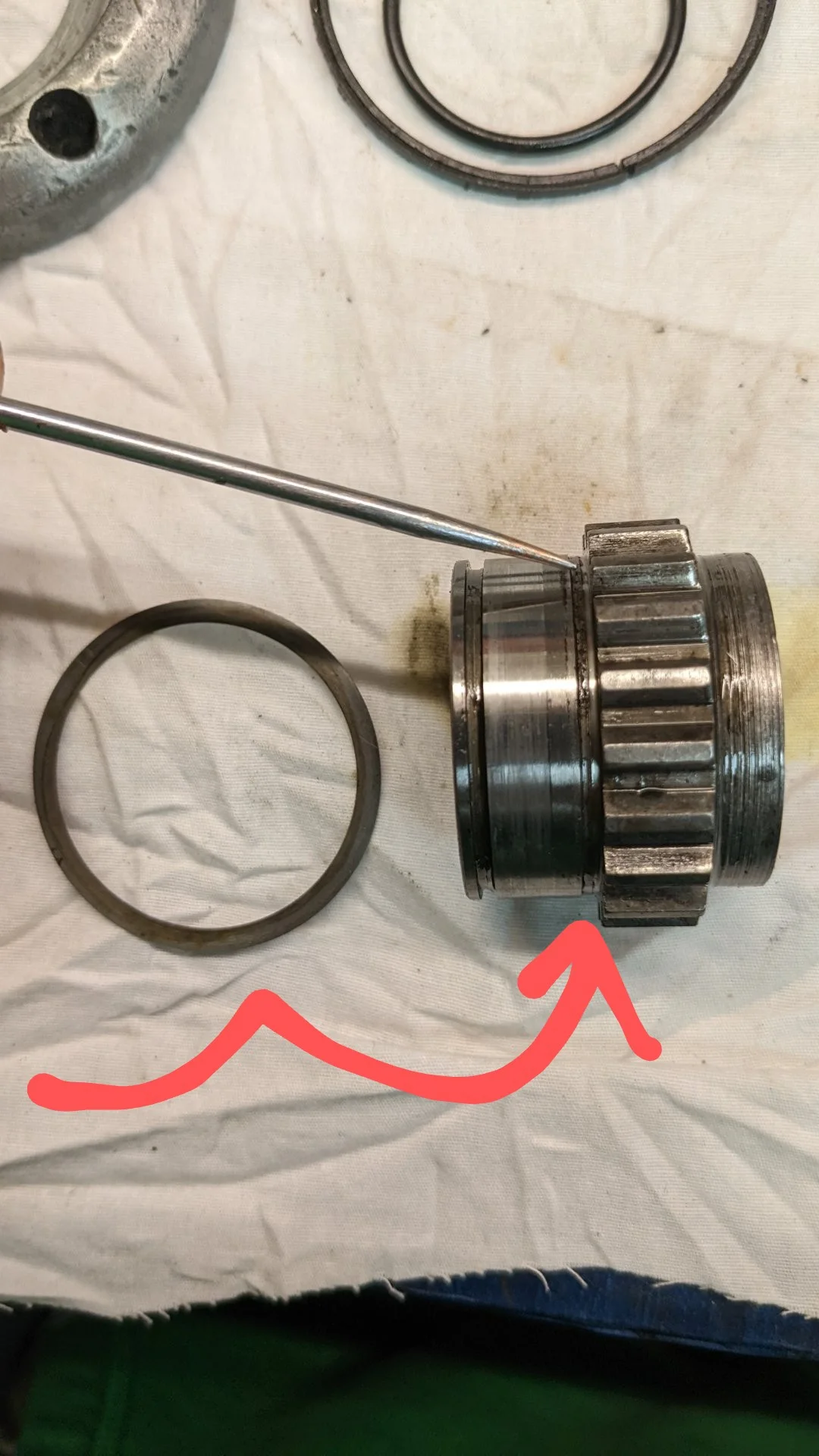

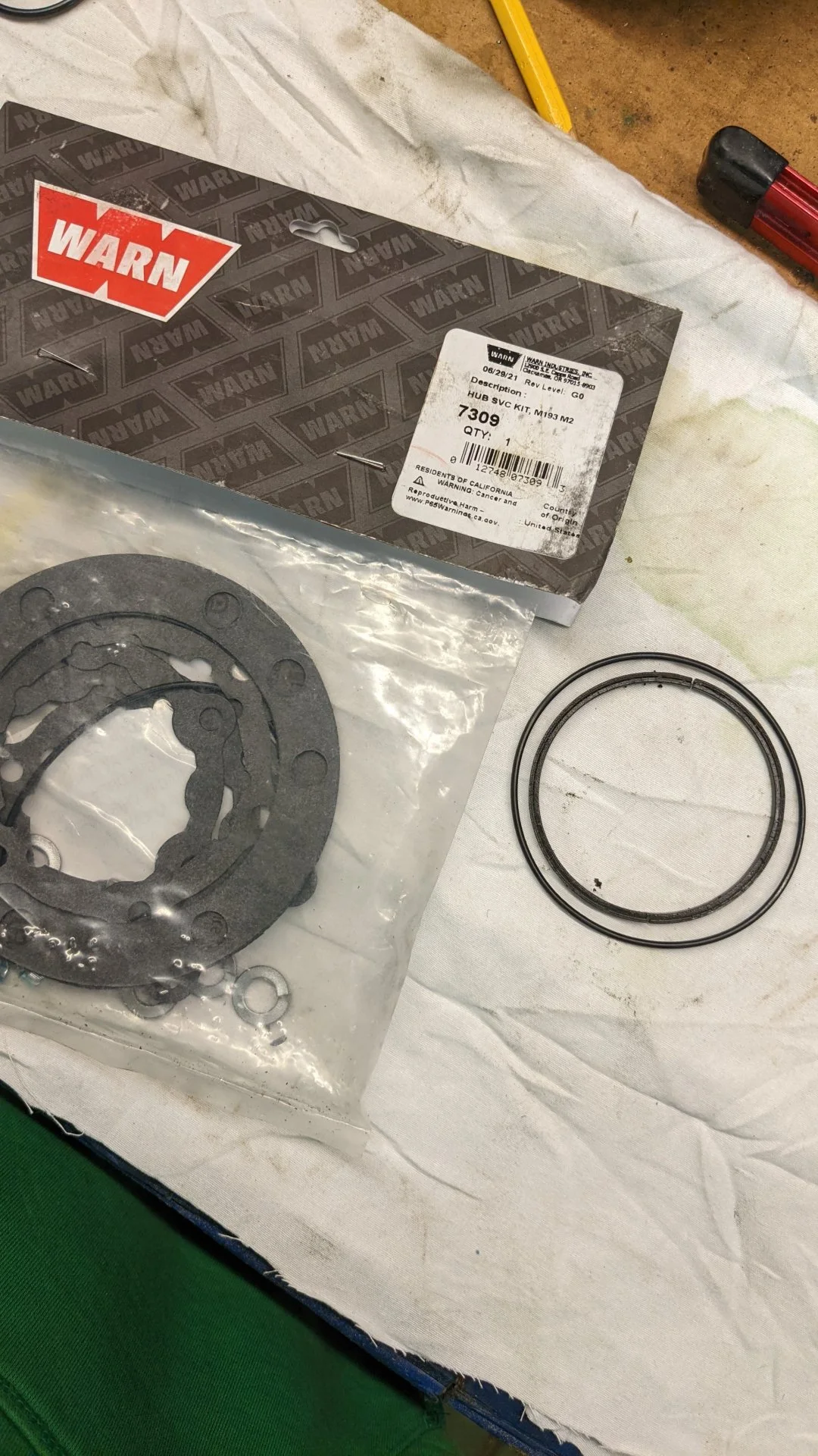

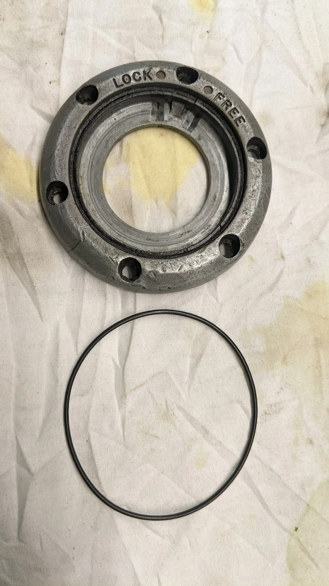

Rebuilding my Warn coarse 6 spline locking hubs and the Warn 7309 service kit orings aren't even the right size 😤

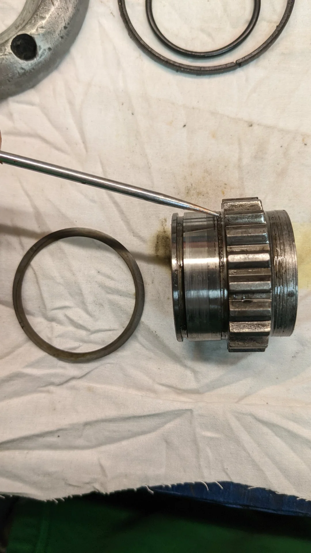

I believe these are Warn 28781 hubs just wondering where I can get the proper parts, since the original oring is shot. Plus I'm missing a .40mm wear shim for the one hub, pretty sure that's important lol
A few years ago, I contacted WARN to see about getting a "proper" rebuild kit for
the hubs on my '74 FJ40.. I was sent a gasket and an o-ring for each side, nothing like
the "7309" kit pictured above!! (seems I paid something like $25USD for my "kit"!)..
I called WARN back and was THEN told they do NOT make "rebuild kits" for "those old
hubs".. When ask if new hubs (that fit) are available, I was told they are, at something
like $600 per set (pair).. I don't believe the "new hubs" installed on my "purchased new"
FJ40 cost anywhere near that much!!
Are the "new" Warn Hubs made outta gold, platinum, or what??

The shim for the 6 spline should be the same as the fine spline one. I’ve swapped the 6 spline gear out and replaced it with a fine spline one to fix someone’s butchered fine spline hubs.
I don’t know where the o-rings would be available, but a generic o-ring supplier could likely provide them.
