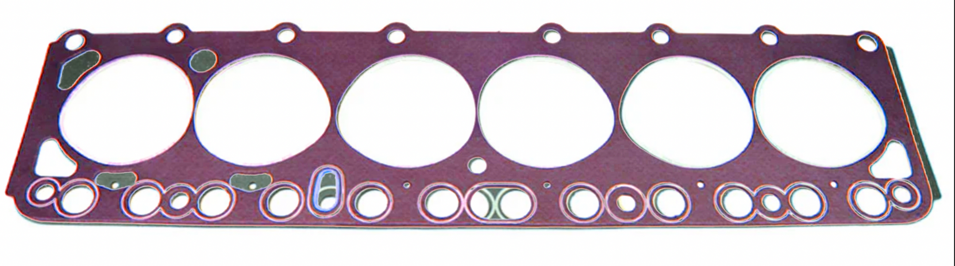

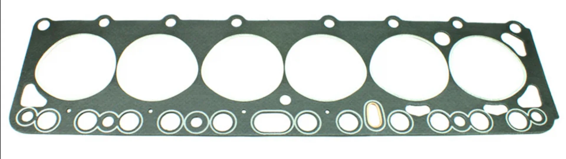

First, I'm sad to report that Marlin @Marlin Crawler passed away roughly a year ago... RIP. He was clearly dearly loved, especially in the 4x4 and crawling world...
Second, Holy crap... Is that the head gasket sticking out the back of the head? @60Works ? Have you experienced this issue? I need to be certain, of course, before pulling everything apart. In case the picture is confusing it's an oval shaped mirror on an extension arm looking at the back of the block. Is that metal gasket sticking out an indicator that it's installed incorrectly?
If someone wanted to install the head gasket backwards, they would have to cut the tab off of the back end in order to do so. The tab is there for exactly this reason. To ensure the gasket can not be put in backwards. Not an easy mistake to make. It would also deprive the rocker arms assembly of oil... not an easy thing to miss. Doubtful in the extreme that Marlins's guys did this.

So I just grabbed the image of the gasket off the @Cruiser Corps website. I'm a photographer/photoshop guy so I copied the image, flipped it over, changed the color and sandwiched them together. The biggest tell is that the rectangular tab protrudes from only one side. The tab protrudes from the back of my engine as you can see in the picture above. The green that is visible underneath the purple is where there is blockage or mixed flow when the gasket is flipped. @Mark W I agree with you this is unlikely and for a couple years I've been working under the assumption that Marlin's work was the one constant that I could count on... But unfortunately we all make mistakes. And considering that tab is sticking out the back of the engine, I have to assume this is what I've been struggling to resolve. @60Works I can't thank you enough for pointing this out. I would still appreciate your feedback if you've had this happen before.
The tab is SUPPOSED to be sticking out the back. Your picture clearly shows (in the mirror) that it is.

The tab will interfere with the waterpump if you install the gasket backwards and it will not fit. Unless you do something stupid... like cutting it off.
Mark...
oh....... I guess I misunderstood. So having the tab in the back is correct.. Well crap. I was literally ready to take the whole thing apart, just happy that the mysterious back flow aberration was resolved. But it sounds like it's not. Why does my truck get hotter when I push the knob to Warm?!! And why can't I normalize the engine temp?
