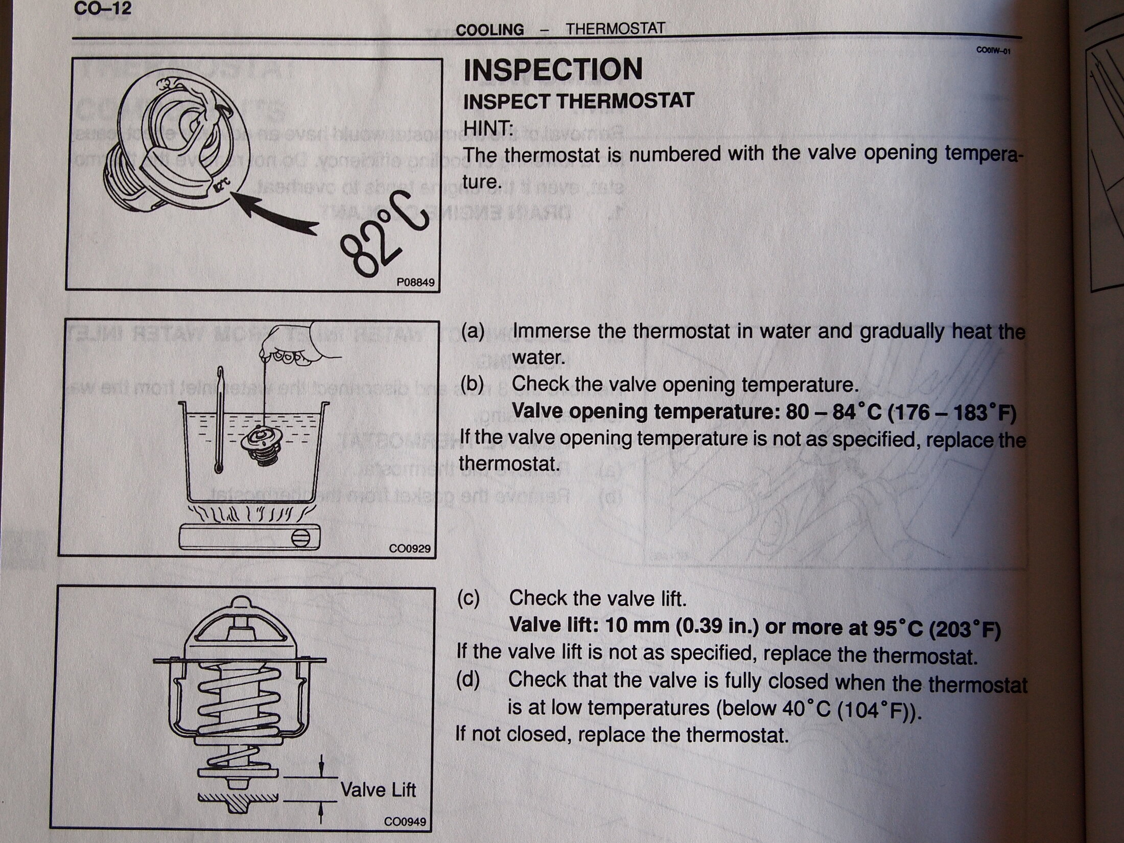

In summer heat, the 06-07 VVT, ECT (engine coolant temp) runs at 194F to 197F. They will go over 197F to ~200F, usually for only a few moments. Then fan clutch locks up to increasing air flow through radiator fins and ECT drops back down. I've only run test at 103f OATs max in full 3PM sun driving on blacktop.
Thermostat is controlled by temperature of coolant. It's not connected to electronics. Although ECU does use/read ECT, using info for a number functions.

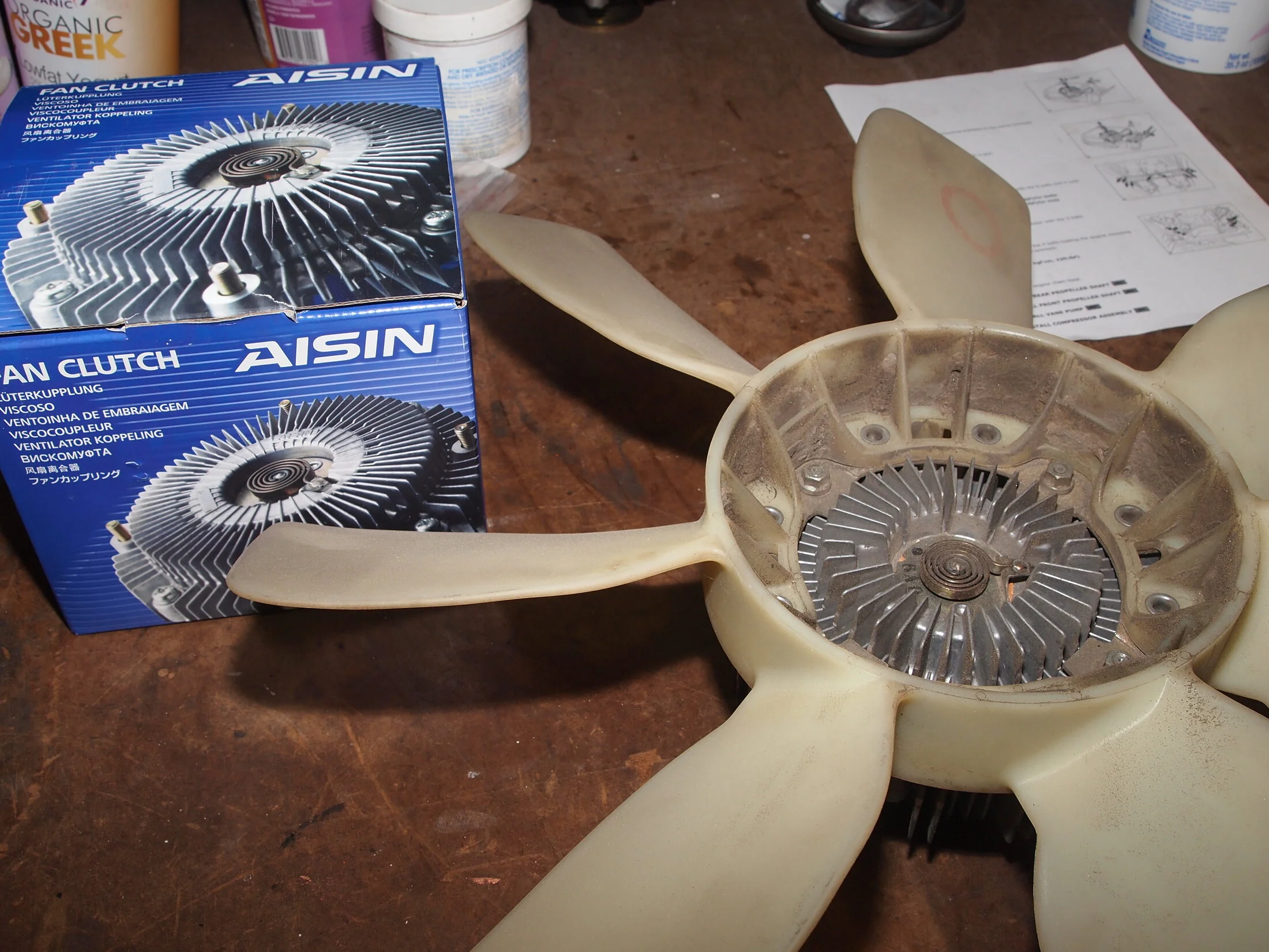

I should have been more clear: I saw ECT of 202 - 204ºF briefly WHILE at highway speed. I don't see how the fan clutch could have made a difference. It should have been freewheeling.
As heat raises, radiator shed more heat on coil of fan clutch (FC). Coil expands open valves inside fan clutch. This locks fan increases resistance within FC.
FC does not "free wheel". It has more of less resistance, in response to its coils temp. The higher the heat the more resistance (locking fan as if solid drive).

Note the coil on FC.
@2001 Thanks, did not know about the coil. I was thinking old-school that it was just a clutch. I wondered why it was so big. Perhaps it’s time to change it out at 182k mi?

FC is to reduce drag on crankshaft, when max cooling is not needed. Saving horsepower, thus increasing MPG.
You'll hear fan roar loudly on cold start-up, first ~90 seconds. Until oil inside moves to reduce resistance of FC. Then again, as ECT gets above optimal operating temp to increase cooling (air flow over radiator fins & pipes).
