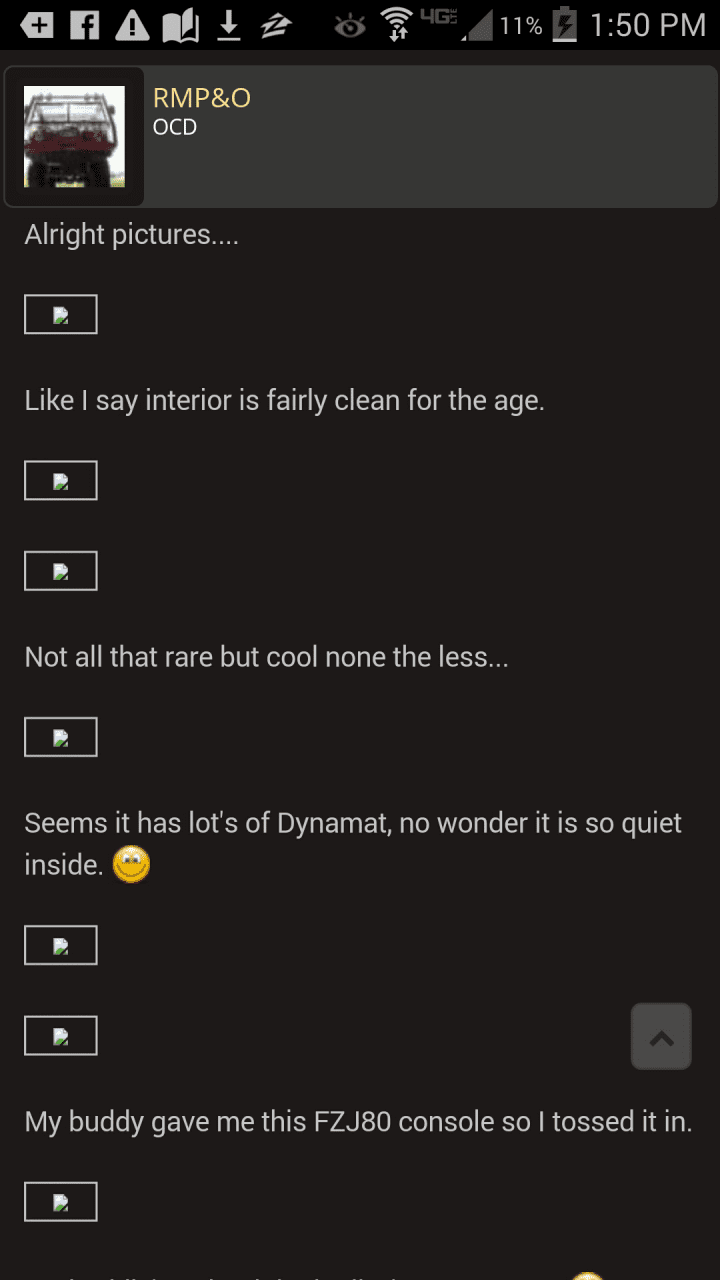

You 1st page pics are all missing or the links are no longer good.
Just letting you know. I would like to see them.
