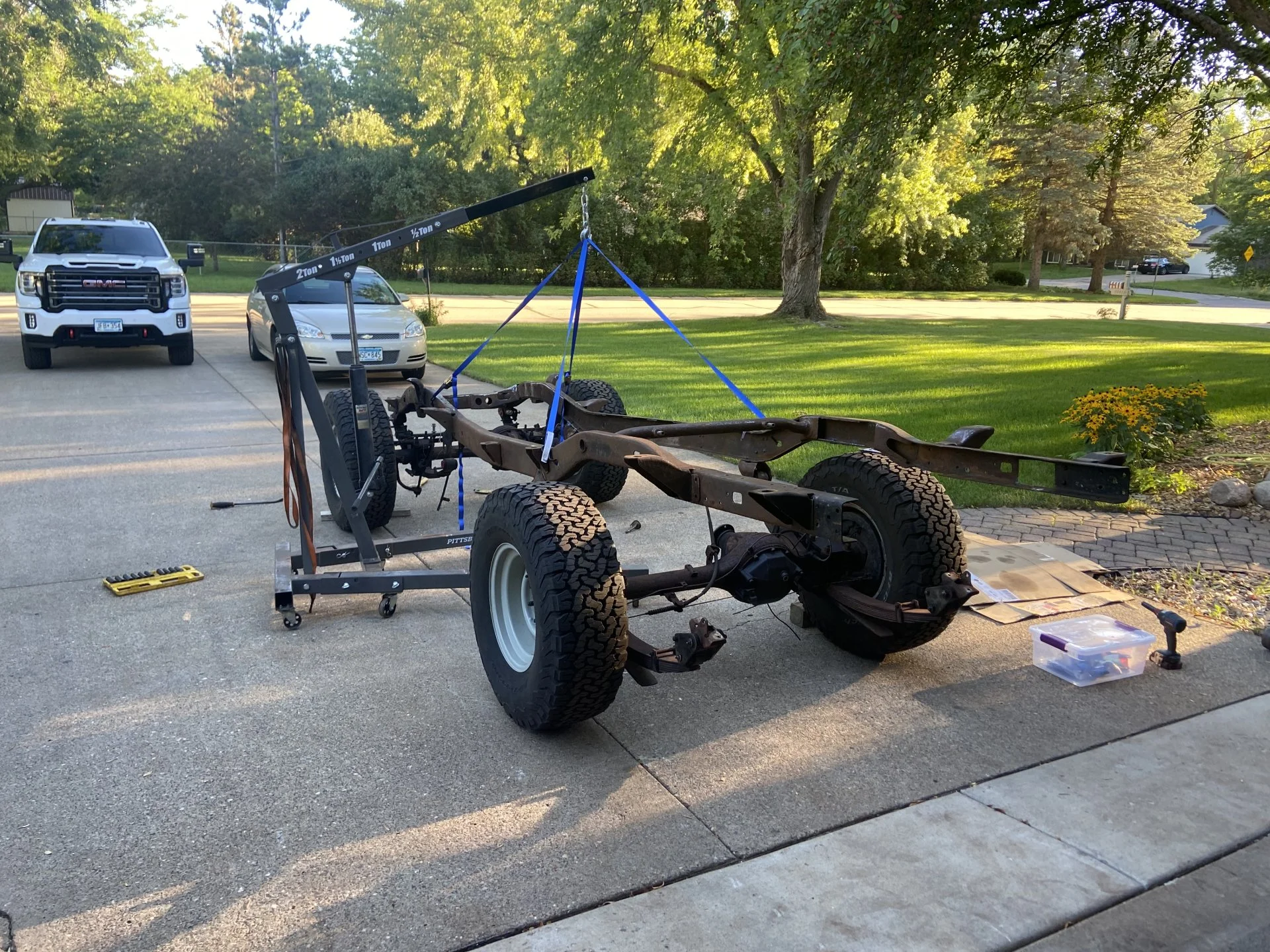

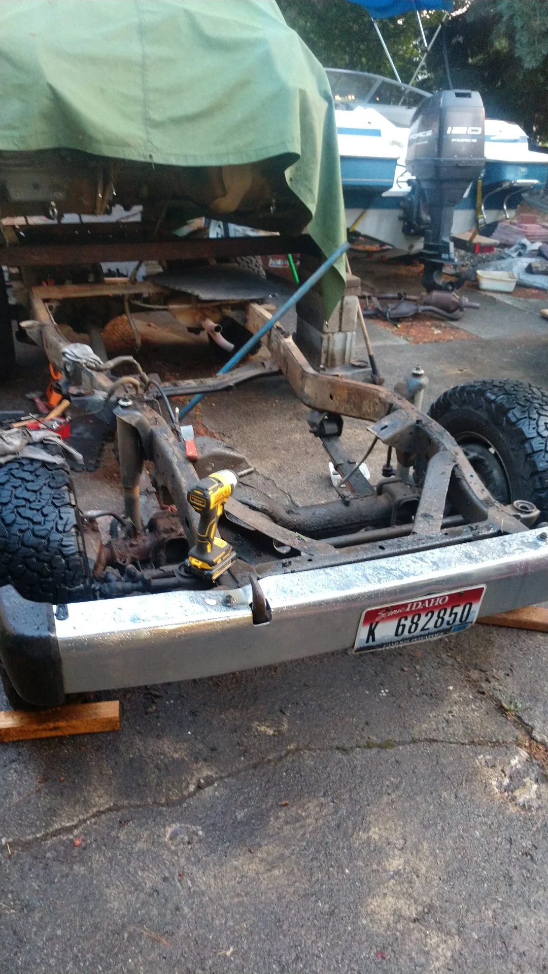

Body is off, Motor Transmission, and T case are out, the fun continues.
Pretty easy removing the body this way, needed a neighbor to lift up the back end, and then just lifted the body up and over, and off the frame. The only thing that was forgotten was the speedo cable.

Today I spent the time pulling off the core support and the motor and transmission. No major surprises here, it's quite easy pulling a motor when you don't have to crawl under it. As mentioned in the last post, there are some issues with the frame, looks like a few spots have some bad rust I'll need to fix, but overall, it's in better shape than I thought, for a Minnesota frame. Turns out if you use an engine hoist, and get the back end of the truck up in the air, you can use a power washer to get all the rust debris out of the frame, working pretty well.
I think I'll also post up the motor and transmission for sale, it will be years before I get to a 40 project. I'll be keeping the transfer case, everything else can go. If you are interested let me know, if not, that's cool too, I'll put it up in the classifieds when I get to it. Essentially, it's a super good running and nice shifting transmission (4 speed). I've been daily driving it in the summers since 2016 with no issues, there is about 200k on it, seems like it was well maintained, i only put about 13k on it while i had it. Rebuild it, refresh it, or just run it as is. I've had the oil pan off, and put in a new oil pump, and it looked super good. Also when I did a valve adjustment it was super clean (I have a picture). I also did a rear main seal, and a new clutch a few years back. I did some borescope pics of the cylinders, they look good too, a few score marks from the cylinders, but really you can still see cross hatching.

How did you get the body off? On mine I have everything disconnected and had my cherry picker inside with chains to bolts. But when I lift it I can't drive the chassis out cuz it'll run into the cherry picker legs.
Just lifted it super high, had a buddy lift the back. Then pushed the picker all the way over to the other side of the garage. Then I wheeled the frame out and put the body on jack stands. At least for now.

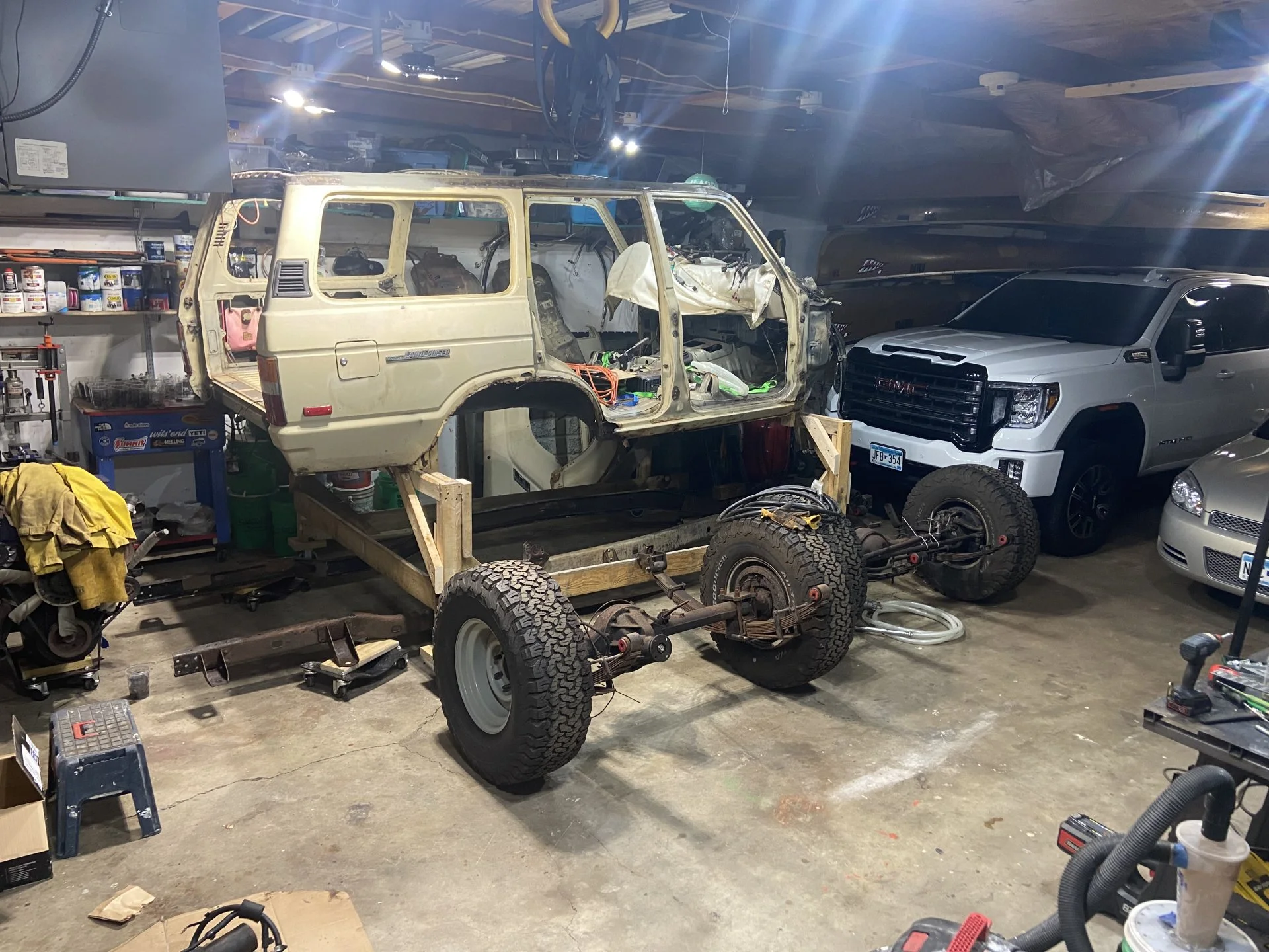

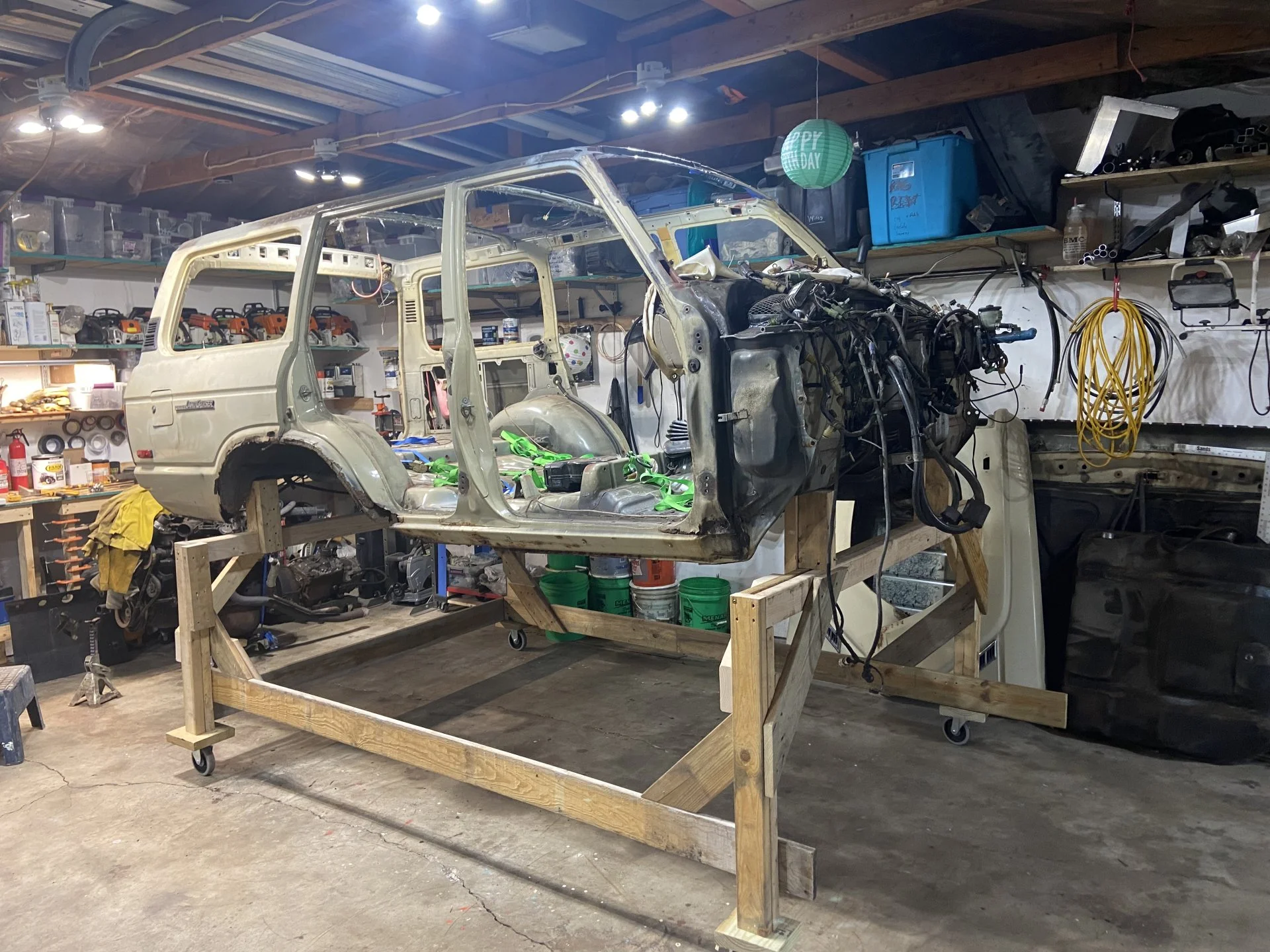

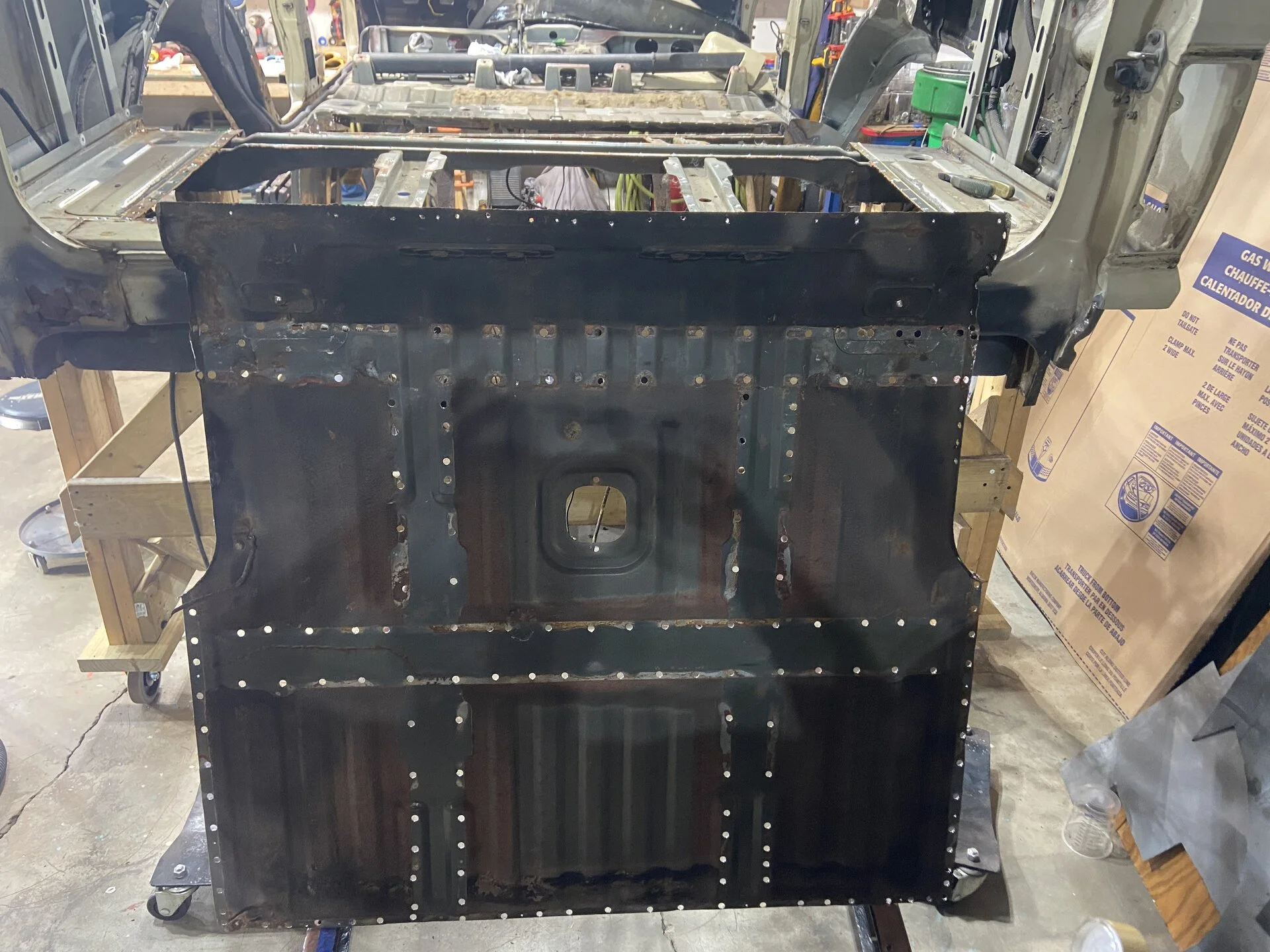

Here is where I finished off today. Made a stand for the body that the frame can roll under to save space. It also puts most of the body rust at a more comfortable level to work on. This will also allow me to work under it comfortably.
I need a bigger shop, and a lift. Hopefully I can make that work at the next house. That will be for the fj40 project.

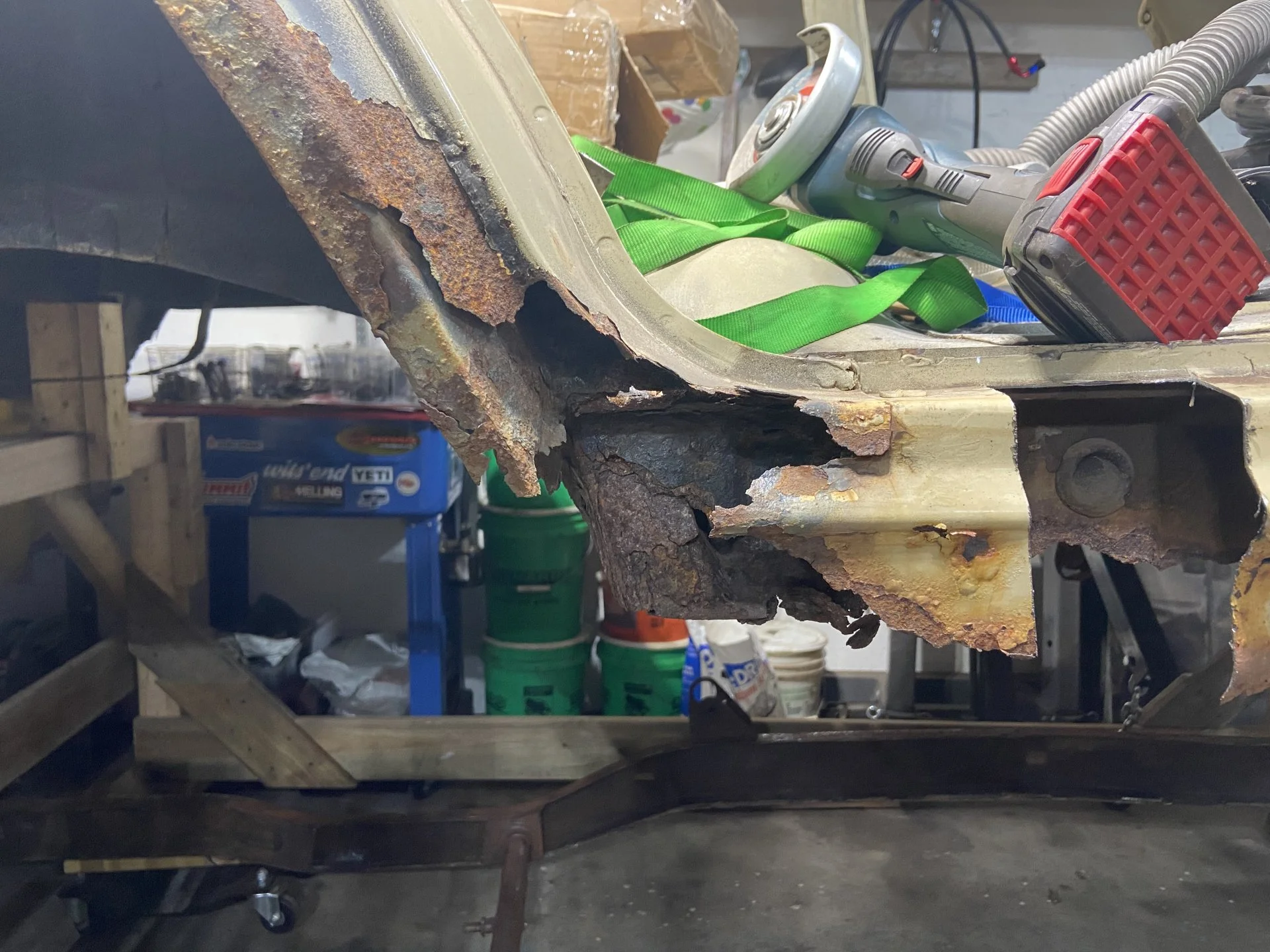

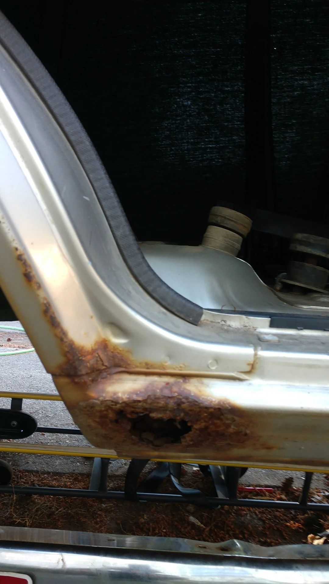

The rust is bad…. really really bad….
Well, my home remodel project is done for a few weeks, I still have a kitchen backsplash to do, but it can wait. Metal work is more fun than housework. I did do some work on the frame, but that can wait until another update. For now, I was sick of only cutting things and wanted to actually put stuff back together. The rust is so bad, in fact, I'm willing to bet a beer no one has attempted to “restore” a 60 this rusty. if so, we should talk, I put the restoration in quotes as this won't be perfect, it will look good, but it's not going to be a high end restoration, take that for what it's worth. A body in better shape is not in the budget, so here we are. I wish I would have taken a few more photos to document before I started cutting but next thing you know, large chunks of the truck were gone. I was only able to save about a 10 inch section of the inside rocker. Most of the floor next to the rocker was bad, it's just bad… really bad, the wheel well(s) had to come out as well. Here are a few photos of what we are up against. lots of spot weld drilling

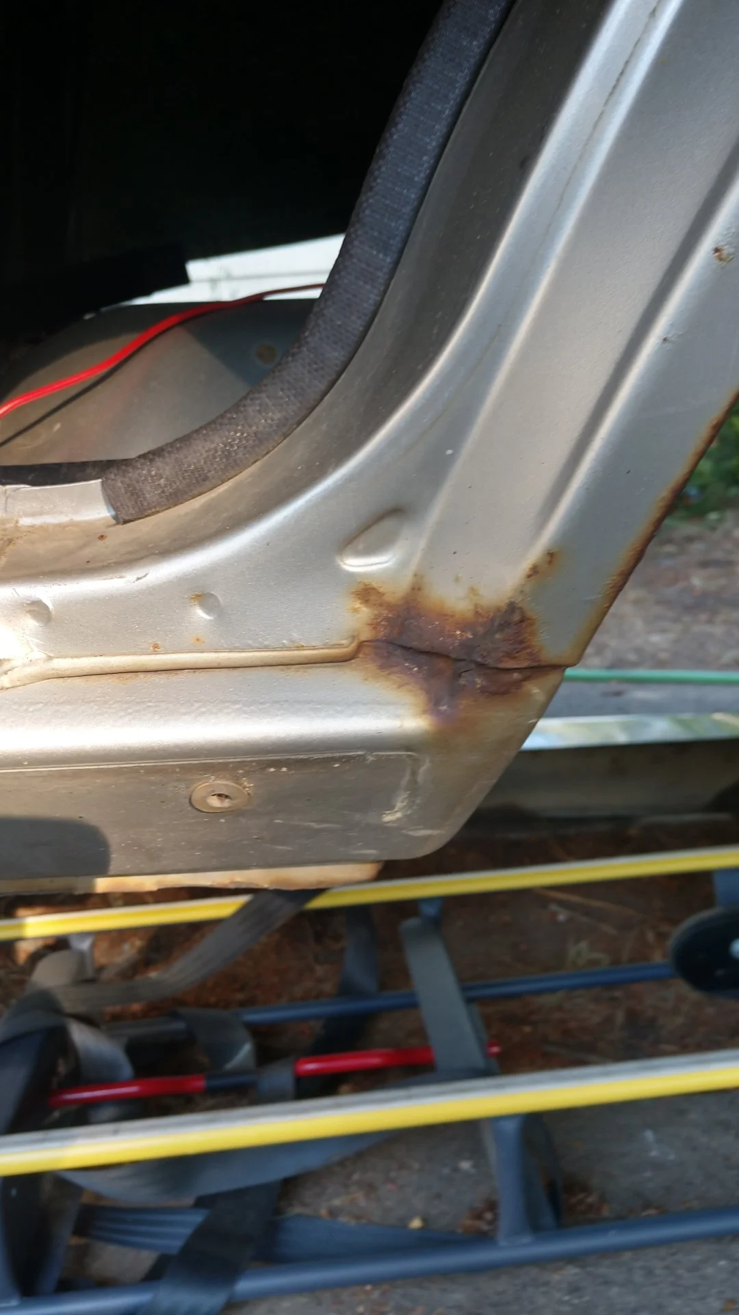

rear seat mount has seen better days... i did not realize how bad it was.

Already did some work on the inner wheel well as you can see in the upper right, lots of spot welds to drill out, both wheel wells will need a lot of new metal.

You can see the inner rear door area here, mostly gone, this will be a pain to recreate later on.

This is about the best photo I have of the extent of the rust that we are tackling so far, as you can see the rockers are mostly gone, as is the small flat part of the floor next to it. This was a good reason to buy a sheet metal brake, as I needed to re-create the inside rocker.
Now to start putting things back together. The driver's side is in better shape than the passenger side, so i was able to make cardboard patterns, then flip them over and use them to make parts for the other side.

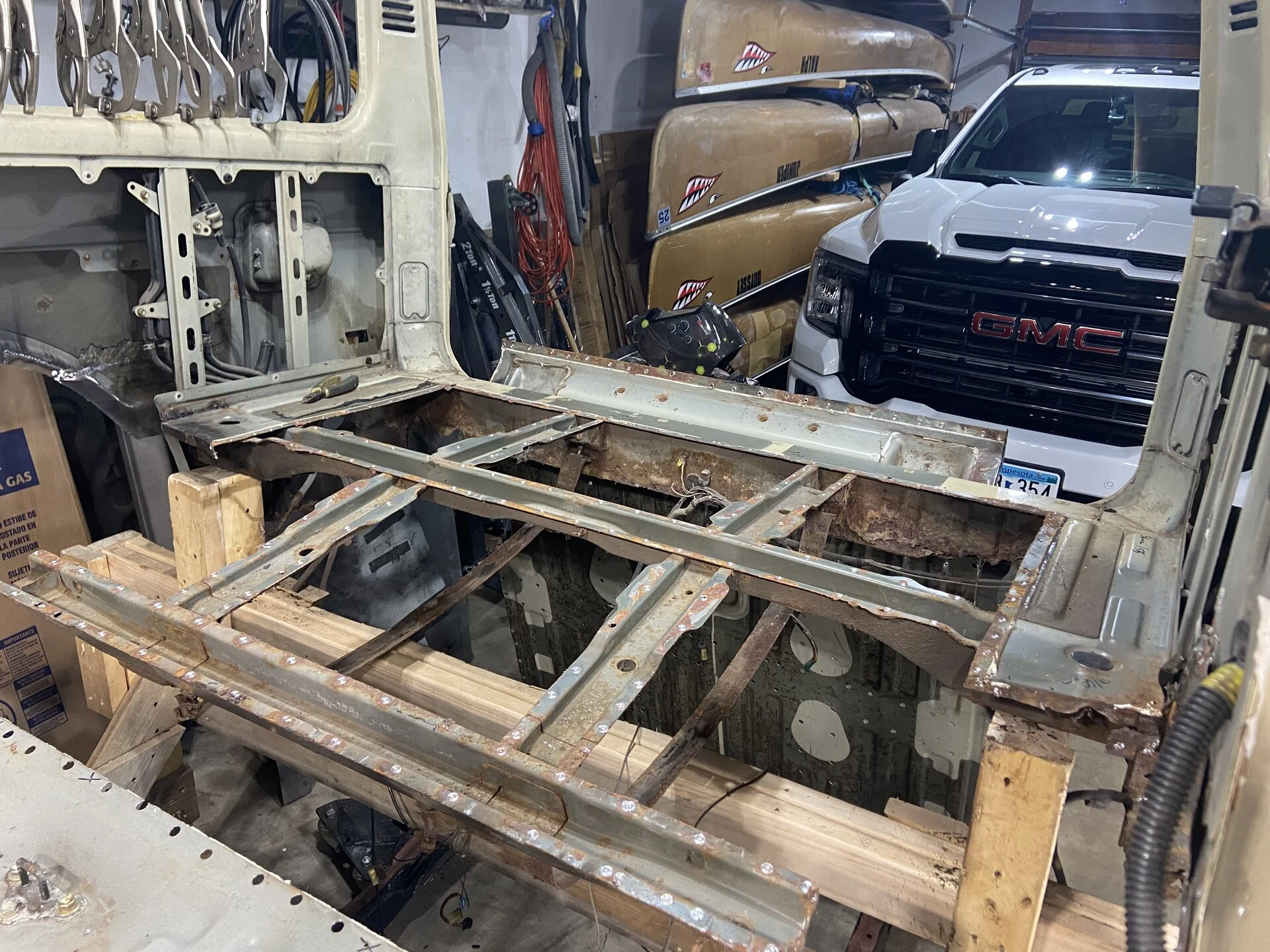

Not a huge update today. Not as many hours as what I’ve been able to do recently. I also took a break to work on the 80 a bit and put a new bumper and winch on.
The rear body mount on the drivers side is completely shot. Decided the easy way to get to it is to pull the rear floor. Instead of just getting the grinder out, figured it would be better the pull the floor by playing hide the spot welds again. I did drill several cleco holes for alignment in the future. So after even more spot welds here we are. Not quite to the body mount but getting close. I’m quite surprised how good the floor supports look, some minor sanding and paint and we should be good. A more detailed write up will be coming soon I suppose.
