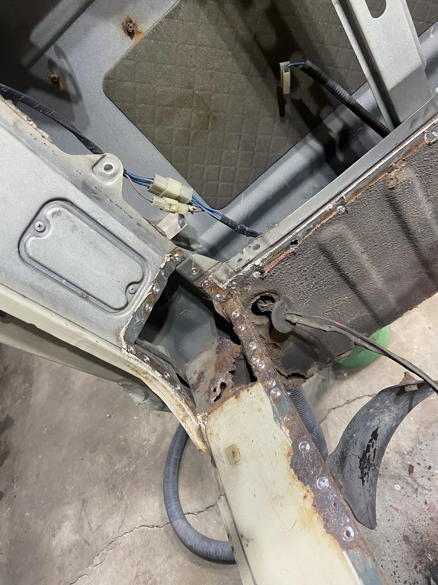

Just for kicks… here is how bad the driver side rear body mount looks.
Should be semi easy to re create this. I’m really getting sick of drilling out spot welds

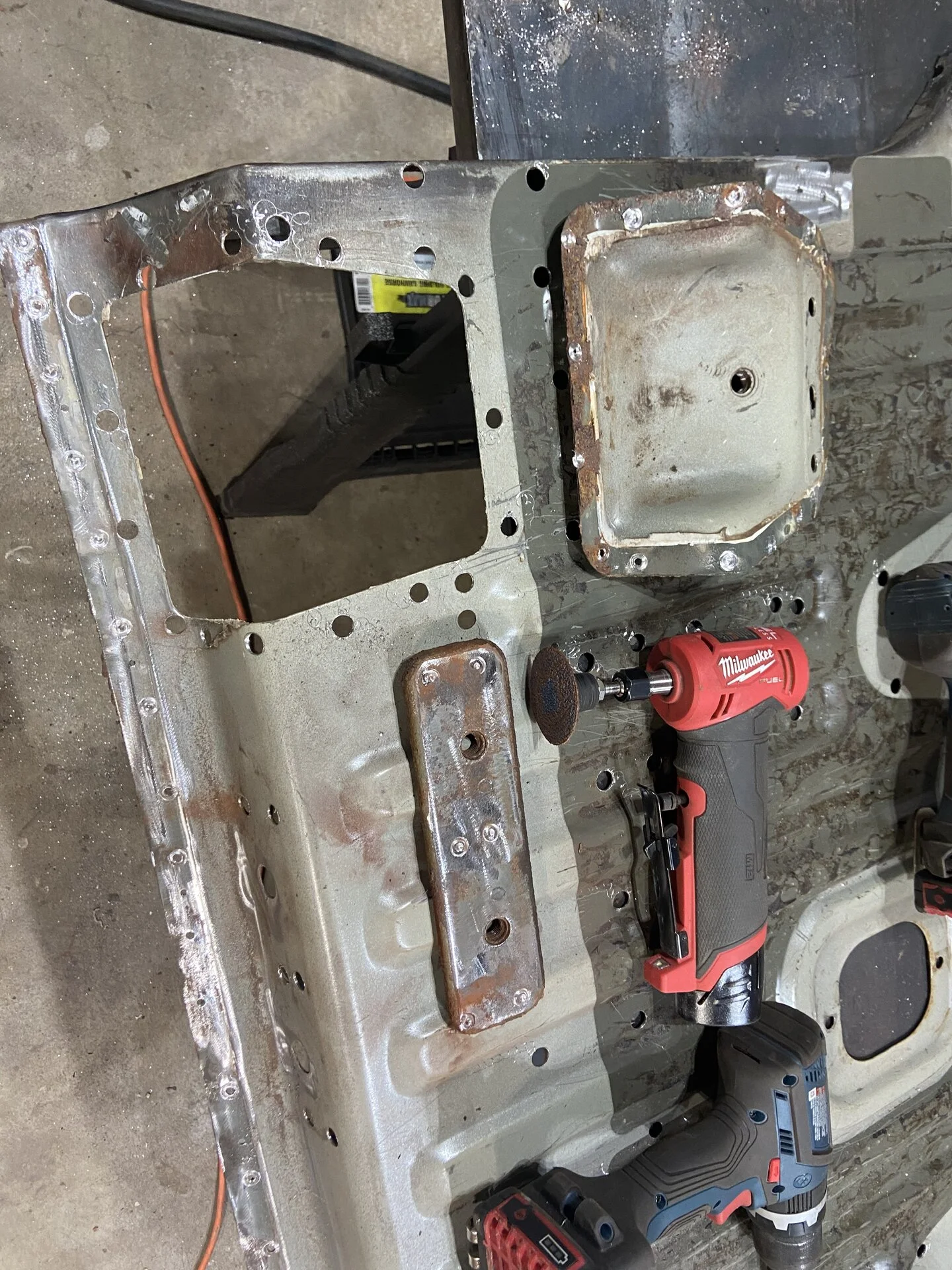

Alright, another tale in the restoration of the most rusty 60 ever, we left off with the rear cross member where the driver side body mount was completely gone, while the drinker side looked pretty good. After much spot weld drilling and cutting, I was able to remove the entire assembly. In general the entire support structure was gone on both sides as can seen in the next two photos. Just rebuilding the cross member isn't going to be enough, how it's attached to the rear end will also need to be re engineered. Since no replacement parts are available, I used the parts website to at least try and replicate some of what I was working with. Before I removed anything I drilled a few locating holes for future use, these were super important when it came time to put it all back together.

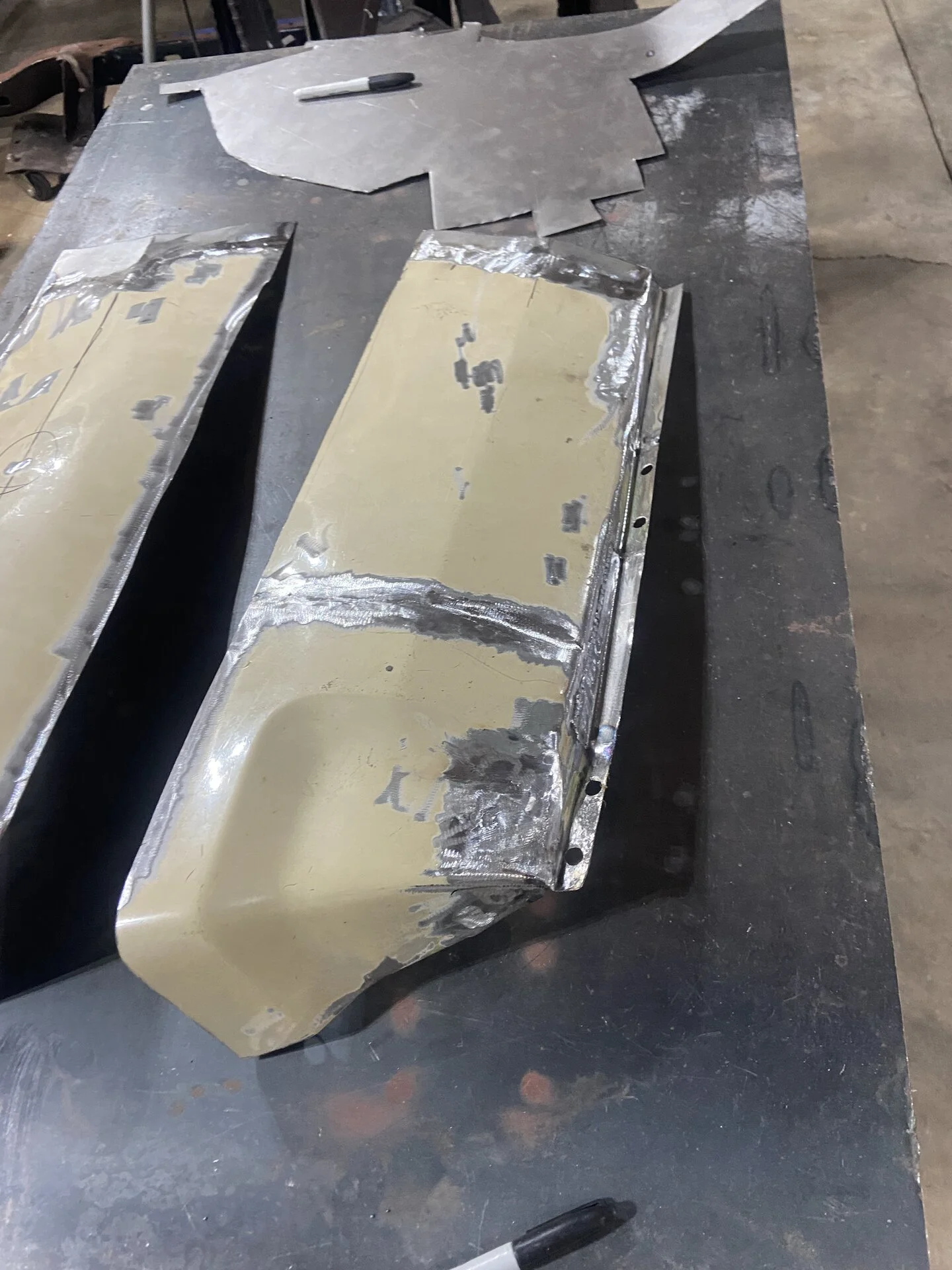

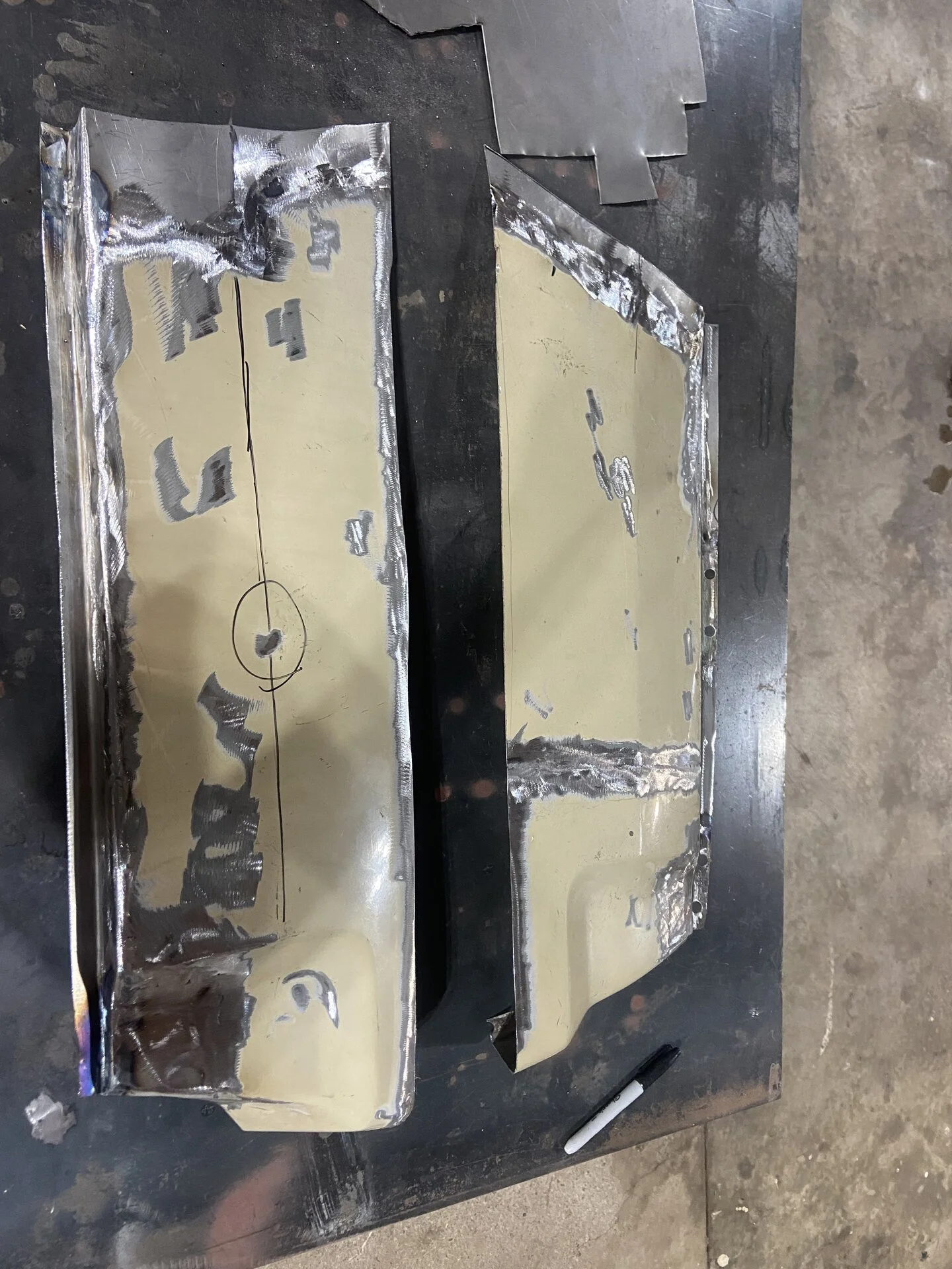

Here is what is left, after all the parts were separated, the body mount on the driver's side is gone, as well as a lot of metal. Using the existing body mount I made an opposite side pattern and made a new one. Next I welded on a new “lip” on the bottom side. Then made the back side out of 18 gauge as I don't have a setup to make all the indents for strength. I only have a small break so I made 3 panels and welded it all together. There were a bunch of other chunks that had to be cut out and re-welded in. lots of seam sealer too to keep the water out.

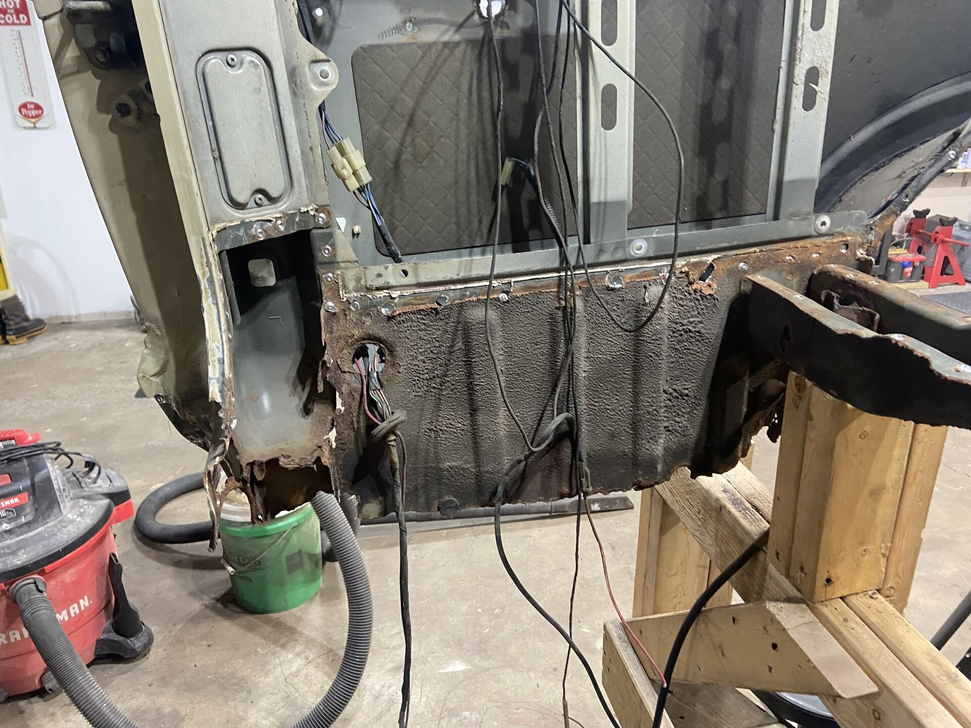

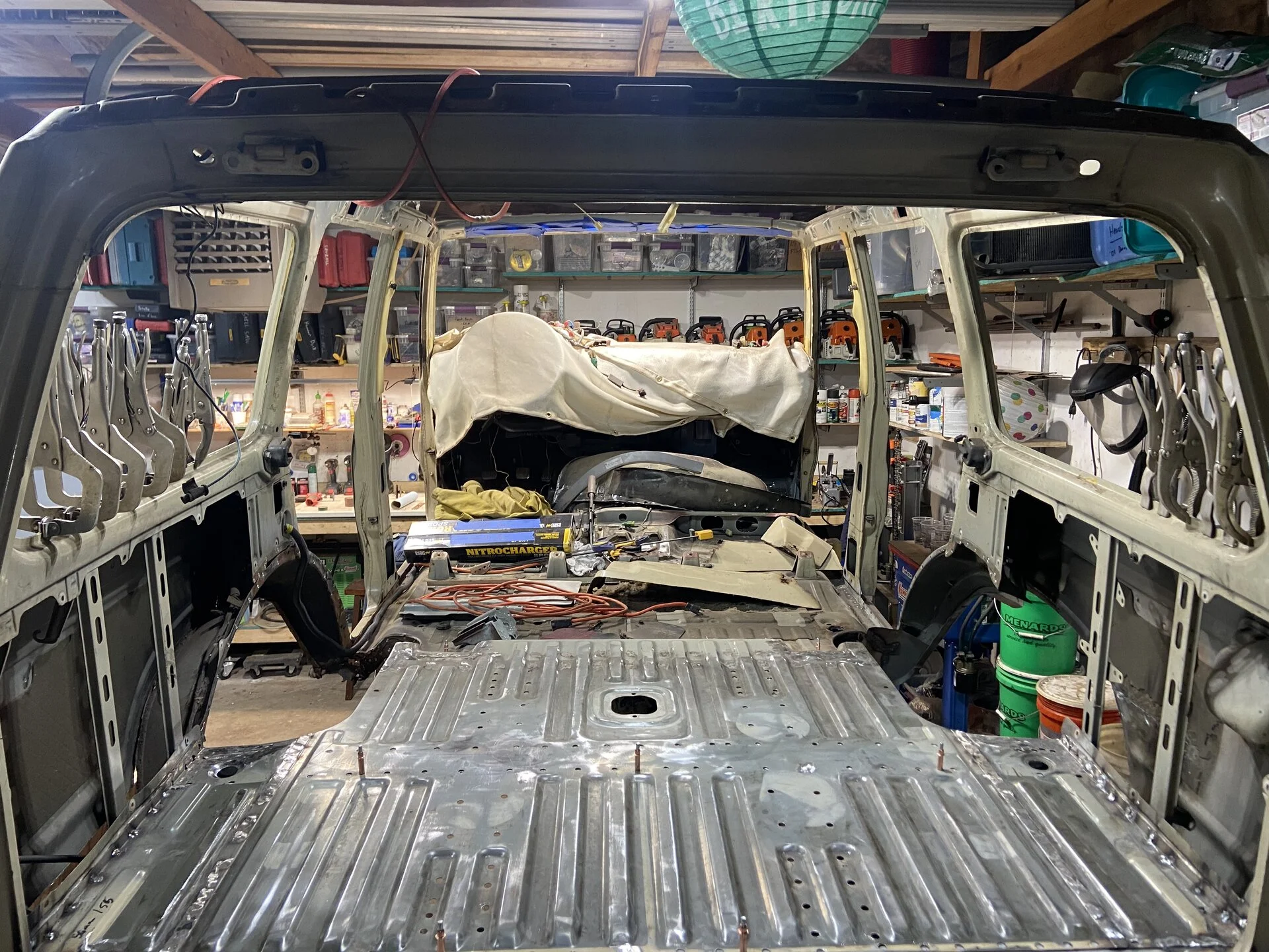

I bet rebuilding the rear cross member took 15 hours at least… and now its ready to put it back in. I had 2 spot weld holes that I used on the back side to line everything up. I should have taken more photos, but each side needed 4 different sheet metal parts separately cut, folded and welded in to support the cross member at a close to OEM configuration. As can be seen in the photo there are a lot of ugly spot, plug, butt, and just tack welds holding it all together. After all the welding and grinding, I used some decent 3M seam sealer to seal it all up and protect it in the long run. I had an open tube from a different project so I decided to use it here.

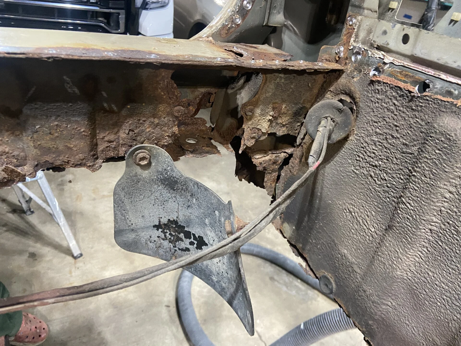

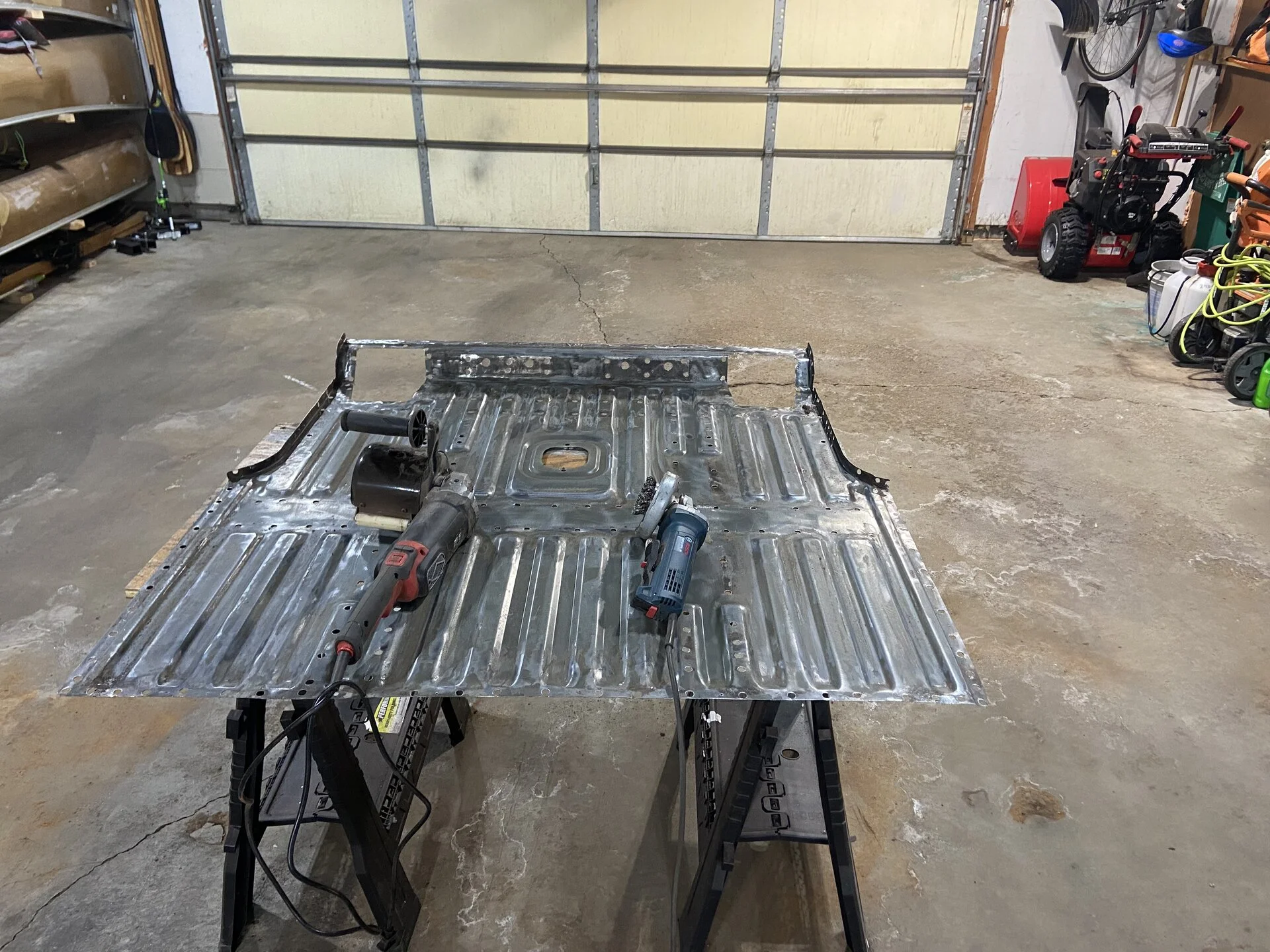

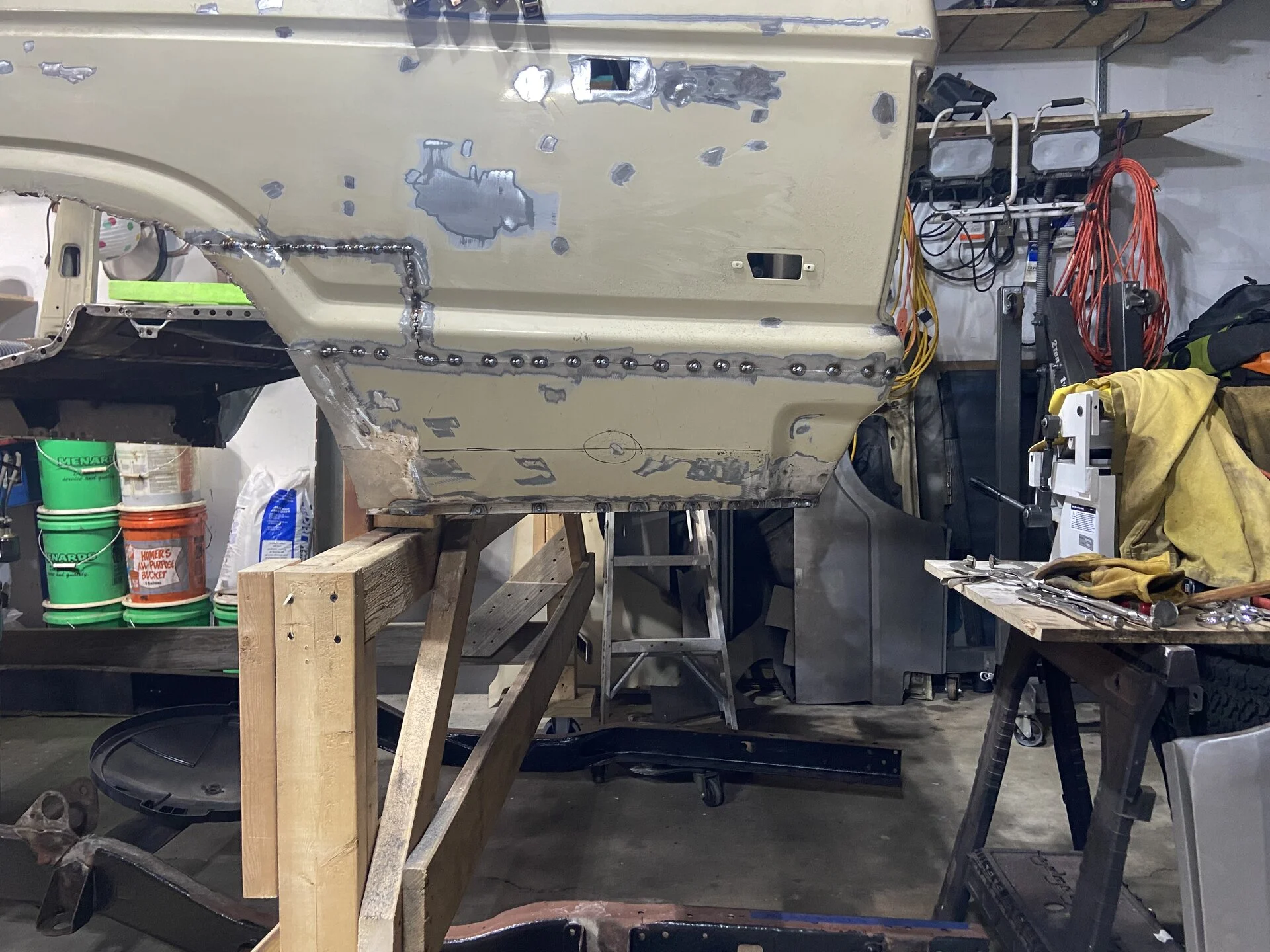

Was able to do some work on the driver side rear wheel well and lower rear quarter panel. Trying to keep the stock looks to even re created the stiffener in there.
Both rear quarters are pretty bad. But with enough welding and grinding anything is possible. I have the Wolf replacement panels, but the shape isn’t quite what I want. I’ll use parts of the wheel arch when I get a bit further along.
