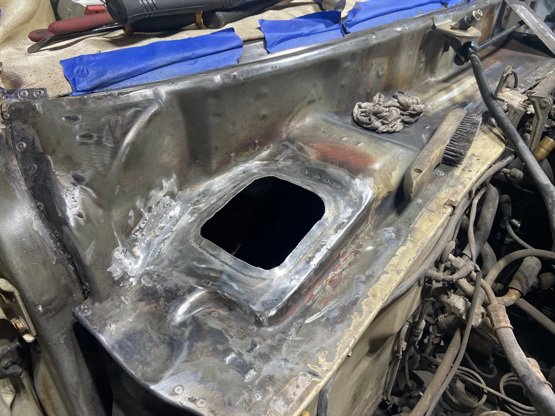

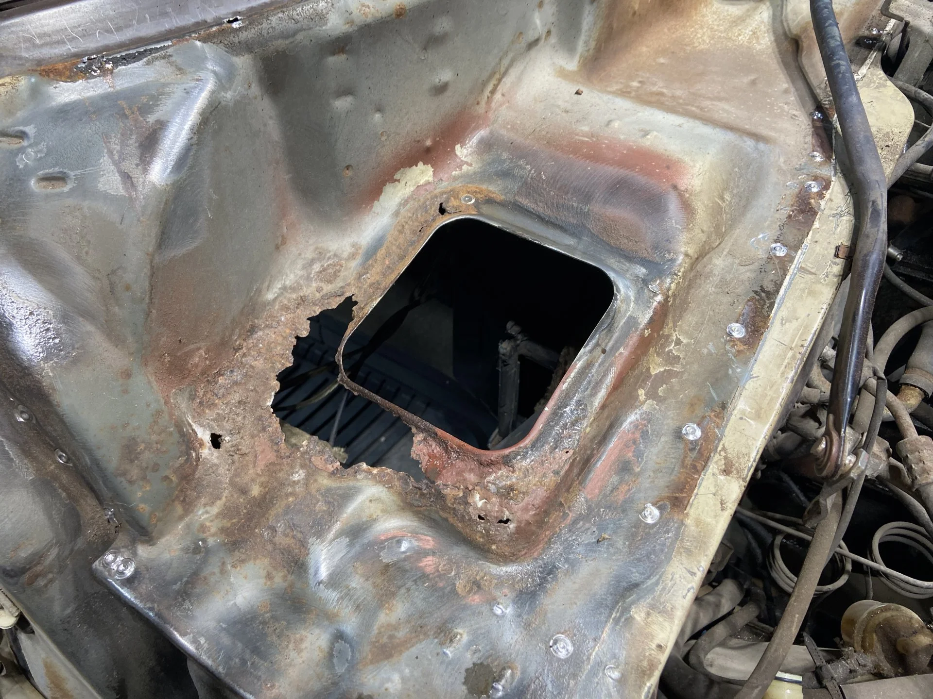

Well, here we are, late summer 2022, and I figured I should address the rust around the air intake for the a/c unit, and that has now spiraled into the truck gutted, and the roof is off. In this thread, I'll talk about how I got the cowling and roof off, how I dealt with the drip rails, and how I put it all back together. There will be lots of other rust work, but that has been covered extensively here, I'm also going to do a full roll cage, and a LS / NV4500 swap, the motor is already built and ready to go. This will take forever, so this will be a long haul.
Goal of the project is to make a super drivable over lander, I'm not a purist, so LS swaps, and non OEM items are fine with me. The rust is so bad, that trying to keep it original is way way past anyone’s reasonable budget. Lots of non-conventional sheet metal work will be needed to get it back in shape. The outward appearance will look stock(ish) other than the lift and bumpers.
The Cowel

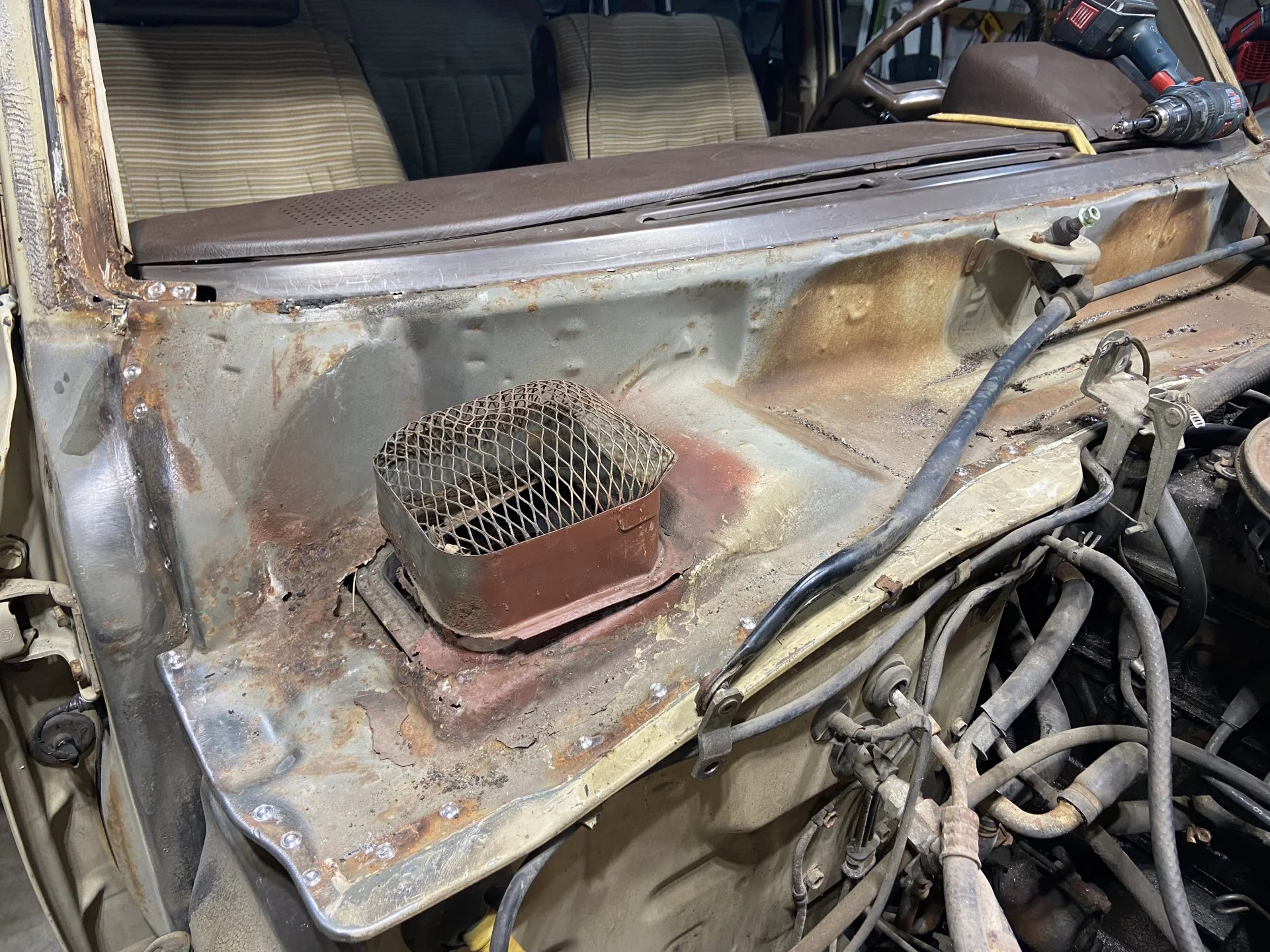

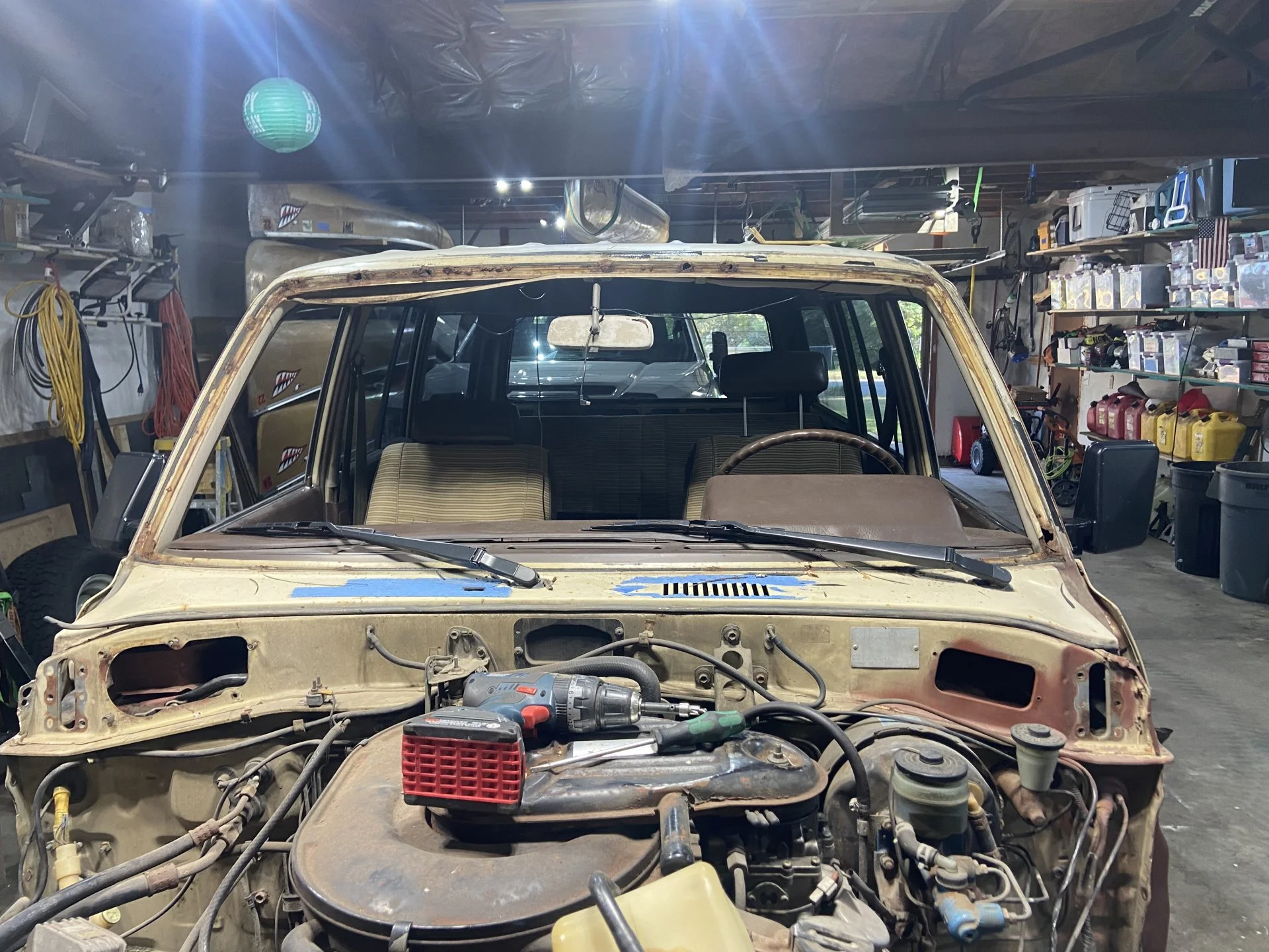

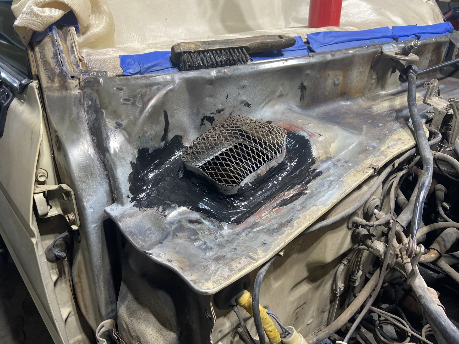

When I first got the truck, the floorboards were rotted out. The first week I had the truck I welded those up, poorly, but fixed. I knew this was from the windshield gasket and or the air intake. Further investigation showed it was both. My solution since garaging was not an option was to use duct tape to cover the windshield gasket as the air intake, so when it rained the water was minimal, this worked ok, but it also meant no fresh are for the vent fan to use, as the A/C stopped working long ago.

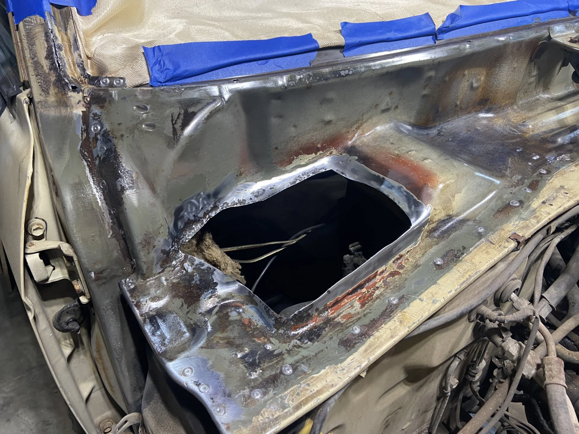

I found myself with a 2 month window between house projects and figured, hey, let's fix that. So, I first removed the fenders, wheel arches, hood, and windshield. Managed to break the windshield, extra too bad as it was OEM, but that's ok. I have another. I also removed the vent fan and glove box. All this is pretty straight forward stuff, just bolts and time. That led to the horror of how bad the windshield surround was… no big deal, just more metal to cut. So really the work was straightforward, a ⅜ spot weld remover, and lots and lots of drilling, you can see the spot welds, just drill them out, and don't go through all the way. I found that starting the spot weld remover with another drill bit first seems to work well to center the spot weld remover.
There are lots of small parts on either side that need to be removed

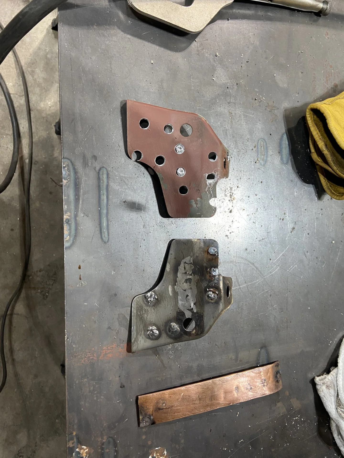

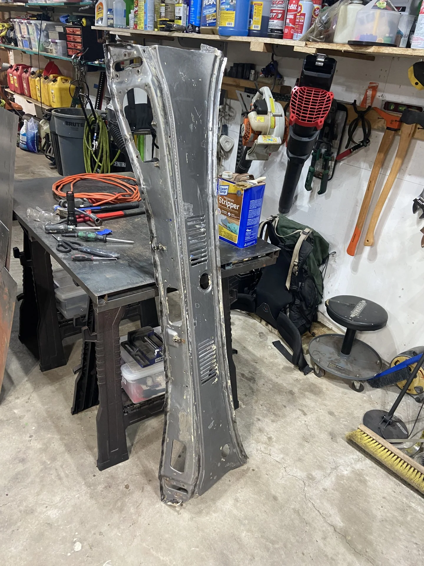

When I pulled off the cowling and small parts, I filled all the spot weld cuts using a homemade copper spoon set up, I also stripped the paint and set them aside for future use (ill take better photos in the future now that i'm doing a build thread here). I then cut out all the rust around the intake, and welded in a new section. The stand pipe we will call it, was also rusty, so I just took a ½ inch off the bottom and then welded it all together. Then spread a nice 3mm seam sealer around it all. That took care of that, then I started cutting out the windshield rust, same deal, cut the rust, drill out the spot welds. This is when I realized that the top needed to come off, more on that later.

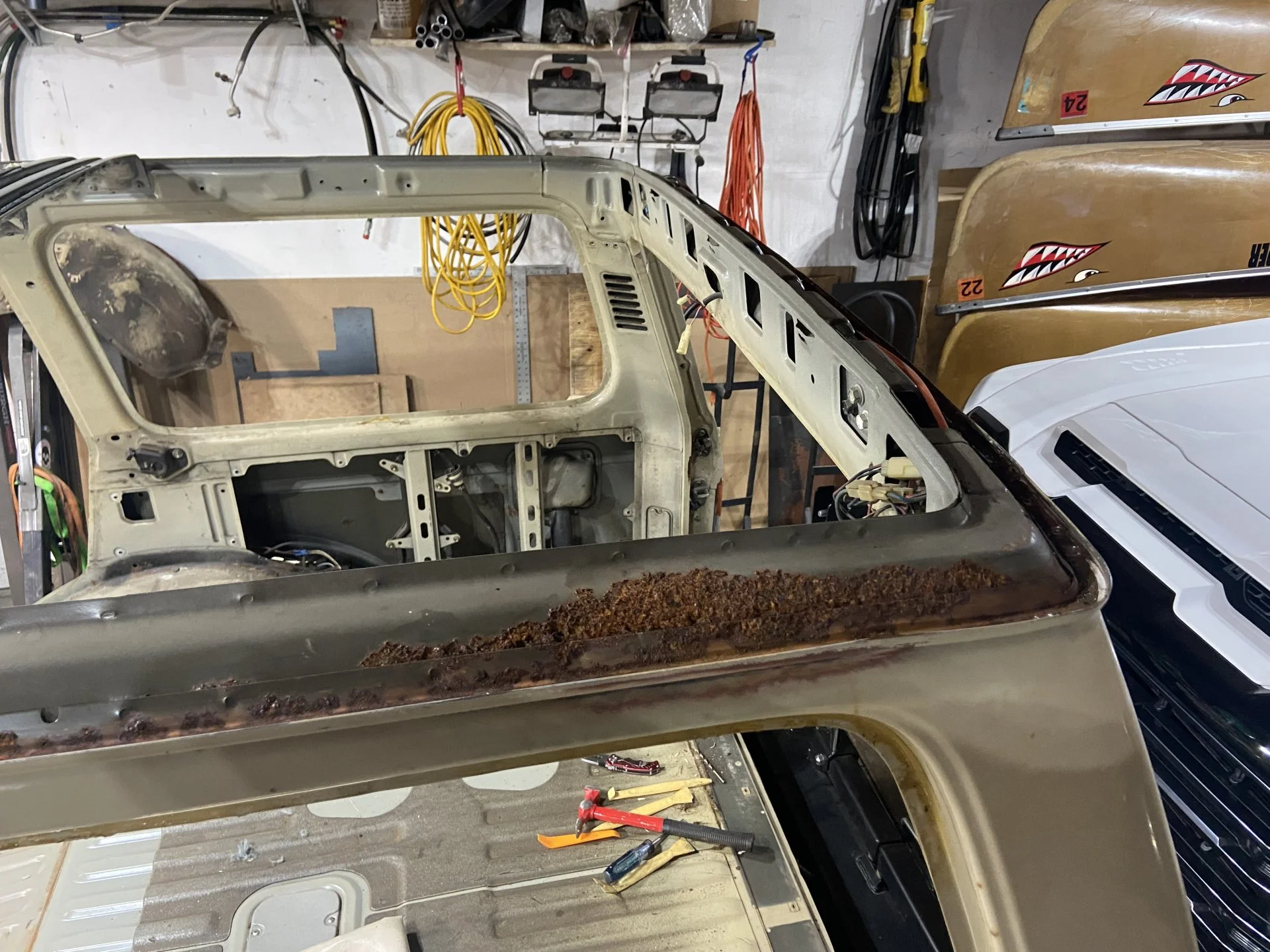

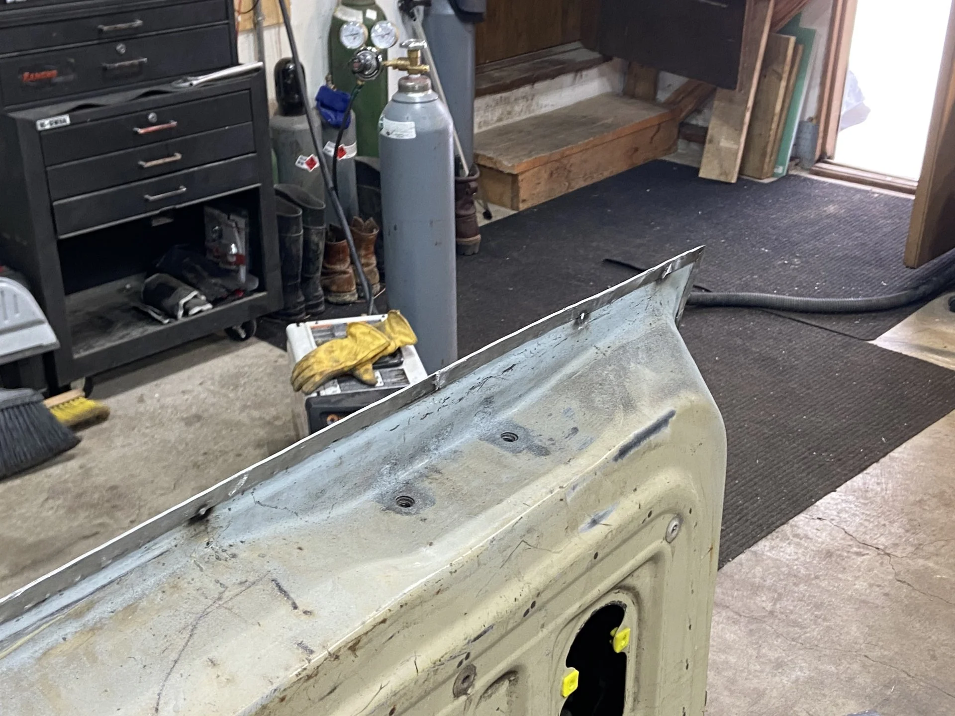

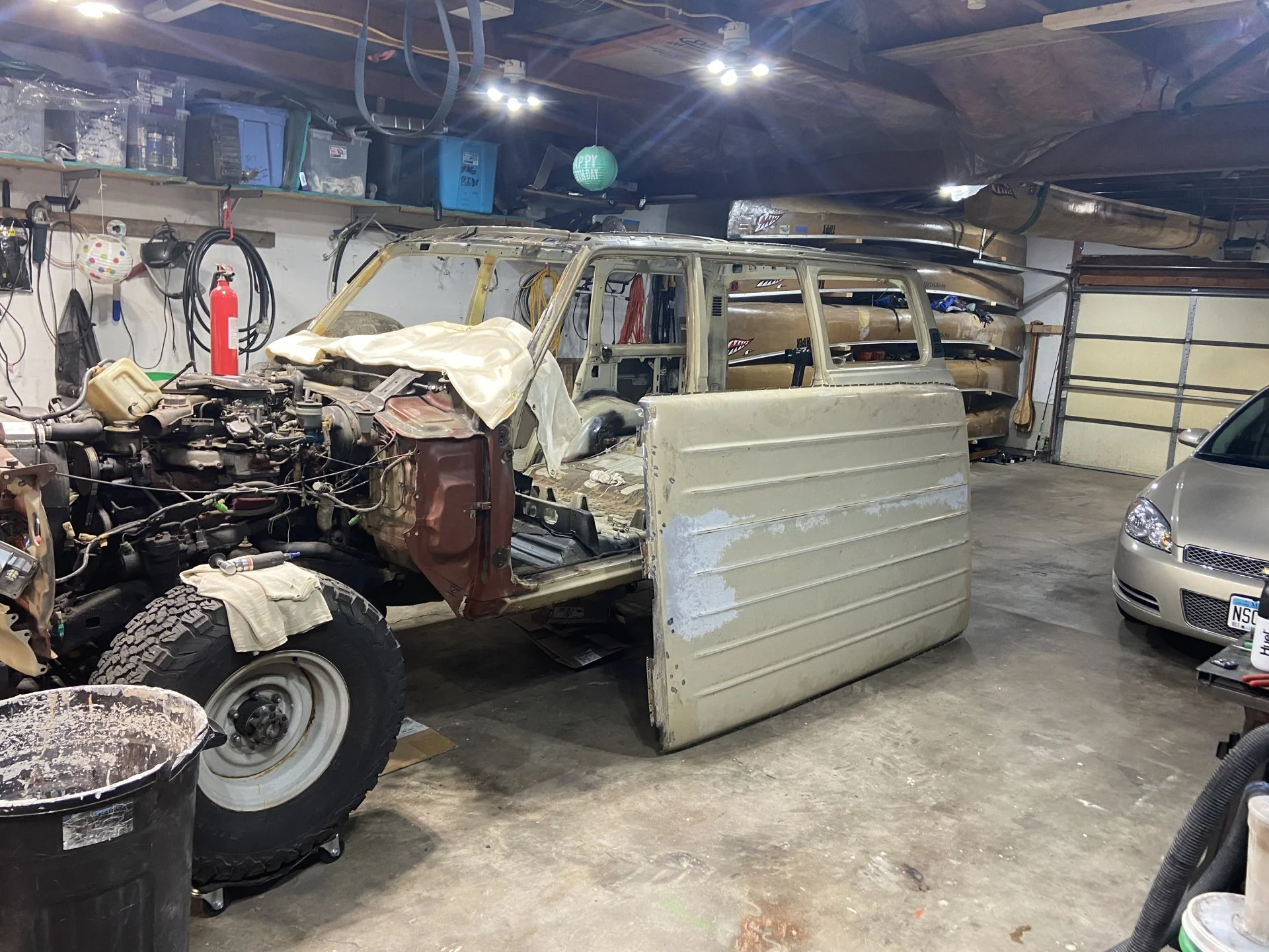

Well, the windshield rust is bad, when looking around the truck, I noticed some rust around the rear drip rail, I poked at it with a screwdriver, and well, it went right through. So now I have a hole in the roof. Further inspection, and I found it was worse than I thought. I searched for solutions and really didn't find much. The couple posts I did see were only small sections of it all, and I didn't like how it all ended up. Really I think this way may not be that much harder (my opinion)
So I decided the roof must come off, similar to the cowling, it's just a ton of spot welds, so I went to town. First I removed all the doors, glass and interior, then i starting drilling out the spot welds with by using a small drill bit to make a small detent and then the spot weld remover, really it was about 4 or 5 hours of work, a few beers, and next thing you know the roof was off. I discovered more rust than I thought, and am super happy I can address it. Next up will be the removal and restoration of the drip rails, I'll cover that in the next post. That is just more spot welds too.

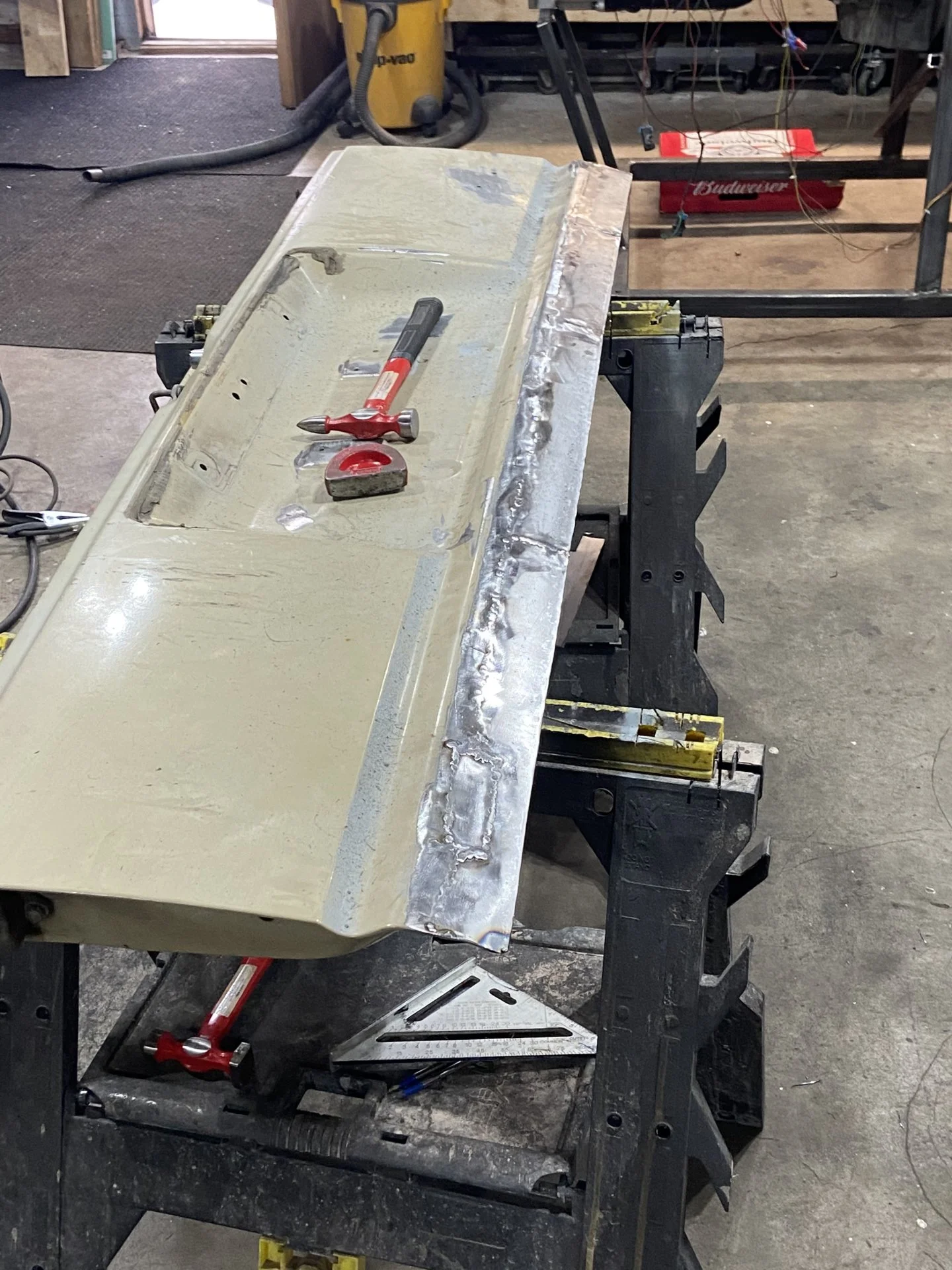

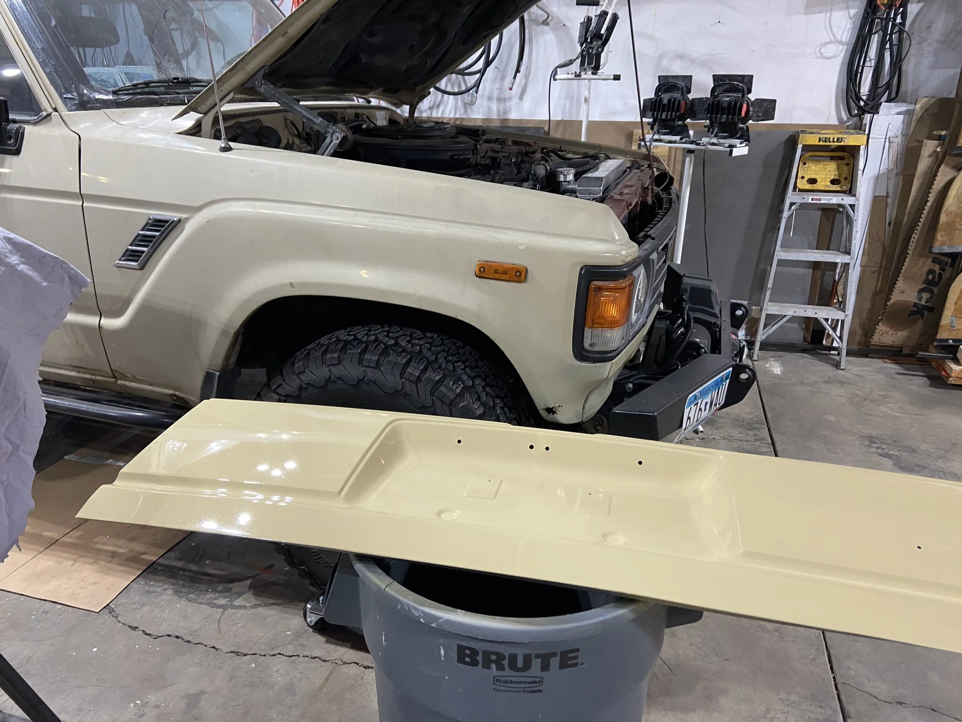

I really really admire your work. You must know what your doing with all that rust! I would like to learn how to fix rust, my Cruiser is in okay shape but will need help soon as most of the important parts are rust free.
But please, where did you get the tailgate skin? Or the metal for the tailgate?

Check this guy out on YouTube, Fitzee Fabrications. He does a great job on how to fix rust.

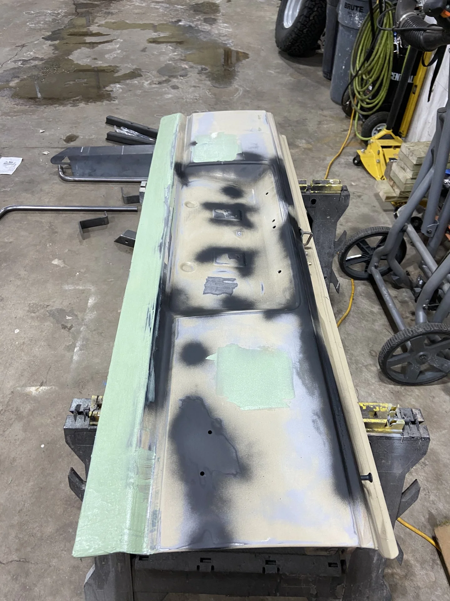

I just fabricated my own a few years back. It’s a strip of metal with the edge rounded over. Some grinding, bondo and paint and you have a nice looking tailgate.
Wow. Good job looks amazing. I need a new tail gate.

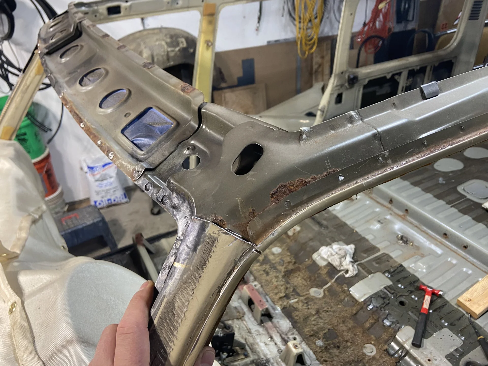

Then I pilot drilled each of them, while the spot weld remover has a spring loaded drill bit in it, I found that a shallow pilot hole seems to work better to keep everything aligned. Follow the directions, and don't go too fast, and your remover bit will last a while, I went through 3 bits before I figured out, if I slow down they will last way longer
After drilling out all the spot welds, I used a 5 in 1 painter's tool to split them apart. I found that better to use than a automotive panel splitter. It's thinner, and was able to do less damage, and it worked super well.
NLK2ZY9U-1-huqudfWO6xtkVI20P3rCs7IgqM3hLW1WfQ8SPQN3EGaqiO8ZXCWbx9BgE-anTg-oHB1J7BqBZ83zuYTPGYtVhIuwlzfdJ4ltFpMt-lLE1WQnsBbawmUedGiwhaJ4Ta78E3NB4deqkbhHGeuFAcWWww-X8GqoZkNg2x-UeZHFyFCldFA
Below you can see the drip rail cross section, the roof is just spot welded to the gap in the drip rail, when the seam sealer fails, which is will, then the water finds its way in. willing to bet most 60's look like this, unless they have lived in a garage their whole life. Which to be fair, a lot of them have.
ZL7X6bBztcBWkSbnrqSiThdrQU8hMZVfigo2k1lCeCHNvJ54cm8ojouPEsh11VuzcDHKnq9ikqLNuVKPkI5Vv9_aQ1Raju1X4qsXrDTYEz0VXc5fgrYrImzPG7ET_TtBn9Bf9loOopS4vKuPTf2tFdc
After I removed all the drip rails, I found, well, rust, but most of it was just on the surface, only a few spots were bad enough that it would need to be cut out and new metal welded in. I wire wheeled everything and sprayed the not as bad spots with rust converter, I'll paint all of this in the long run, and when it's all put back together with modern seam sealer, I'm sure if will hold up for another 40 years.

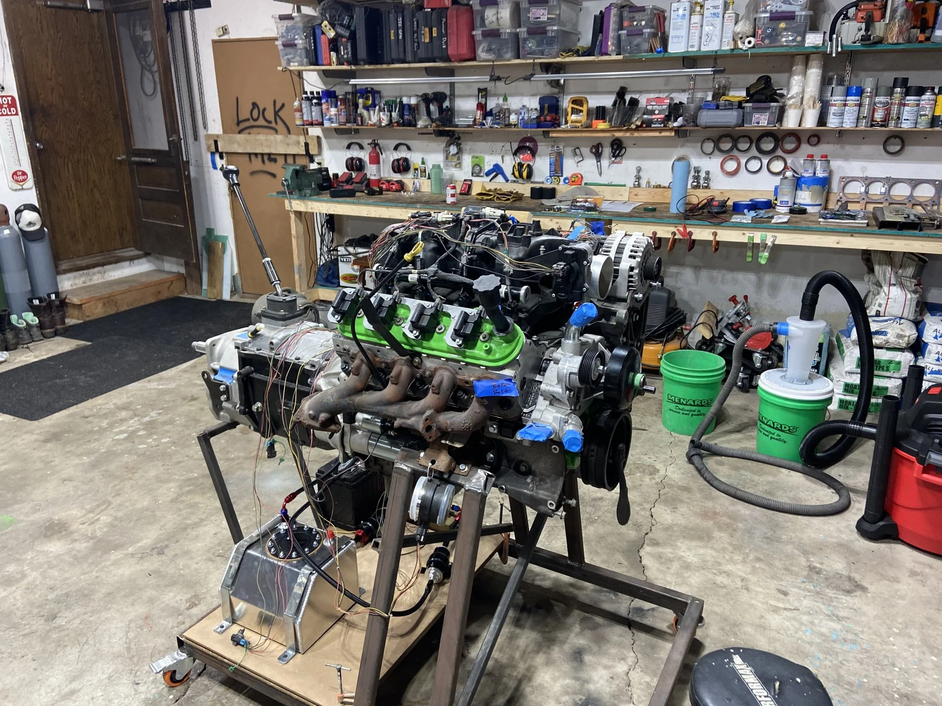

At this point, I'm going to go after the full LS/NV4500 swap as well...
