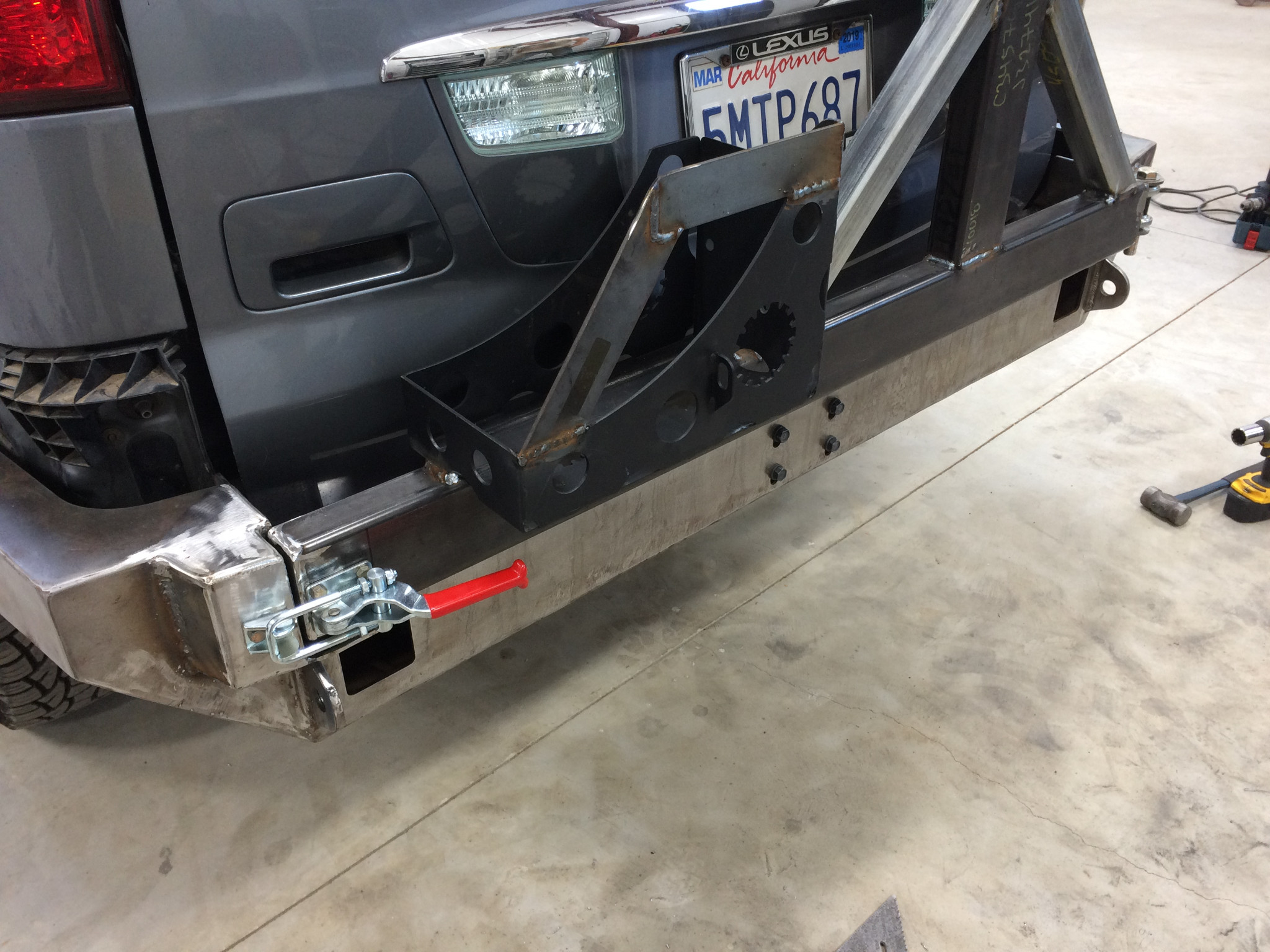

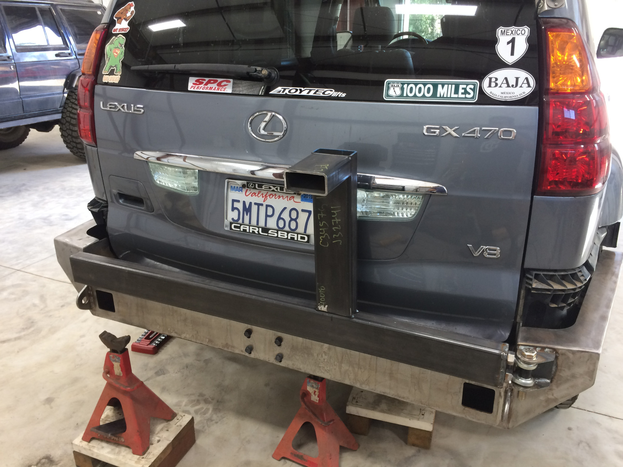

I wanted to update the thread, got the swing arm built a couple of weekends ago. For those of you on Instagram that follow me (BajaKuz) you saw it that day but got the photos uploaded to my website today.

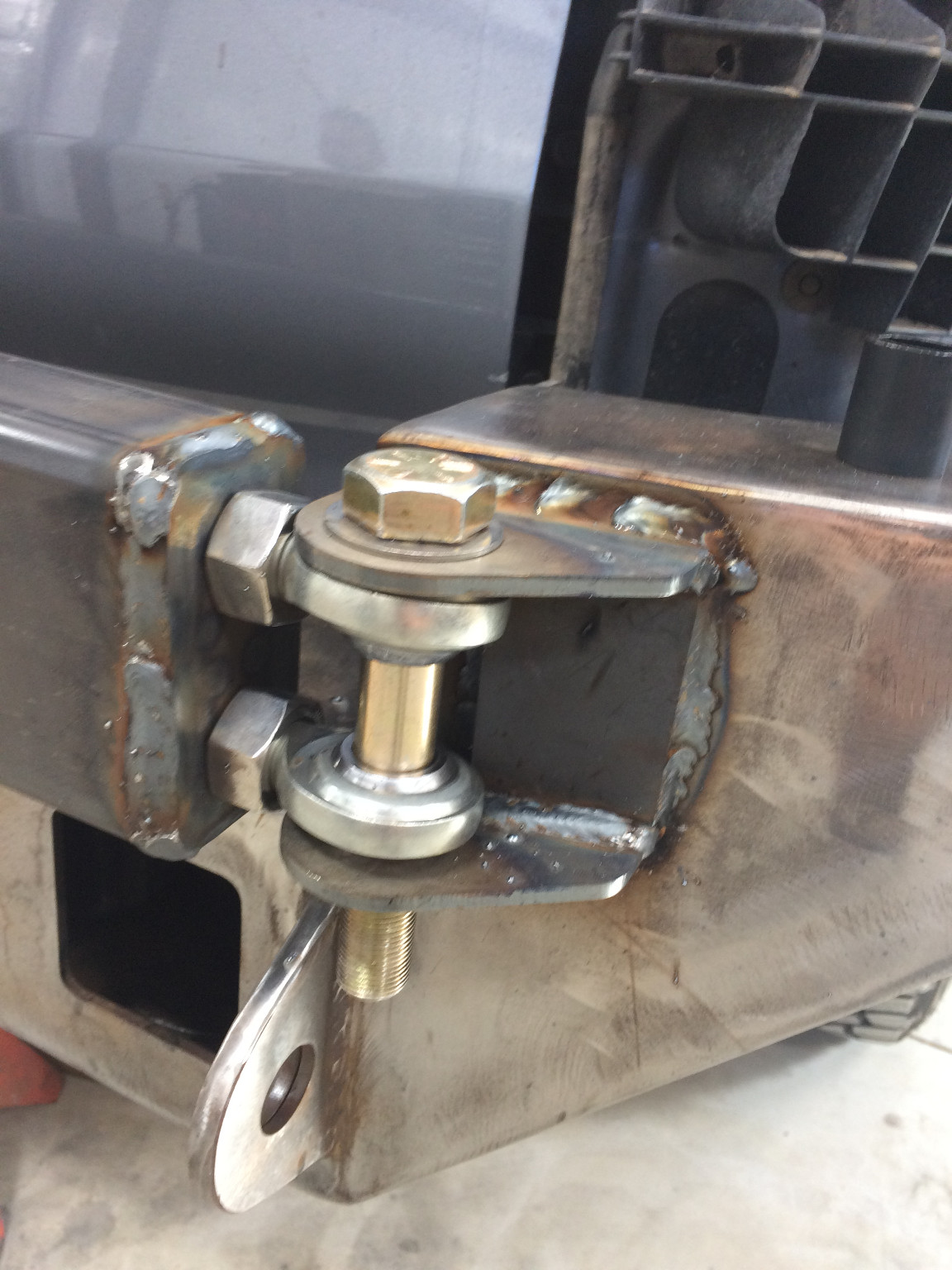

I special ordered the kit from Coastal Off-Road without the tire swing with the exception of the swing joints since I wanted to do a full swing out. So this is what my buddy and I came up with on the fly. We beefed up the swing attachment and had to figure out a mounting point for the clamp and how to do a locking pin.
We added a plate between the two swing tabs to give more surface area to attach to.

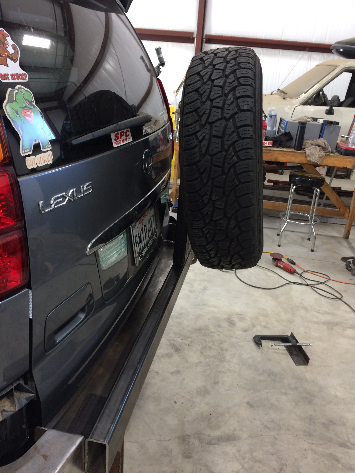

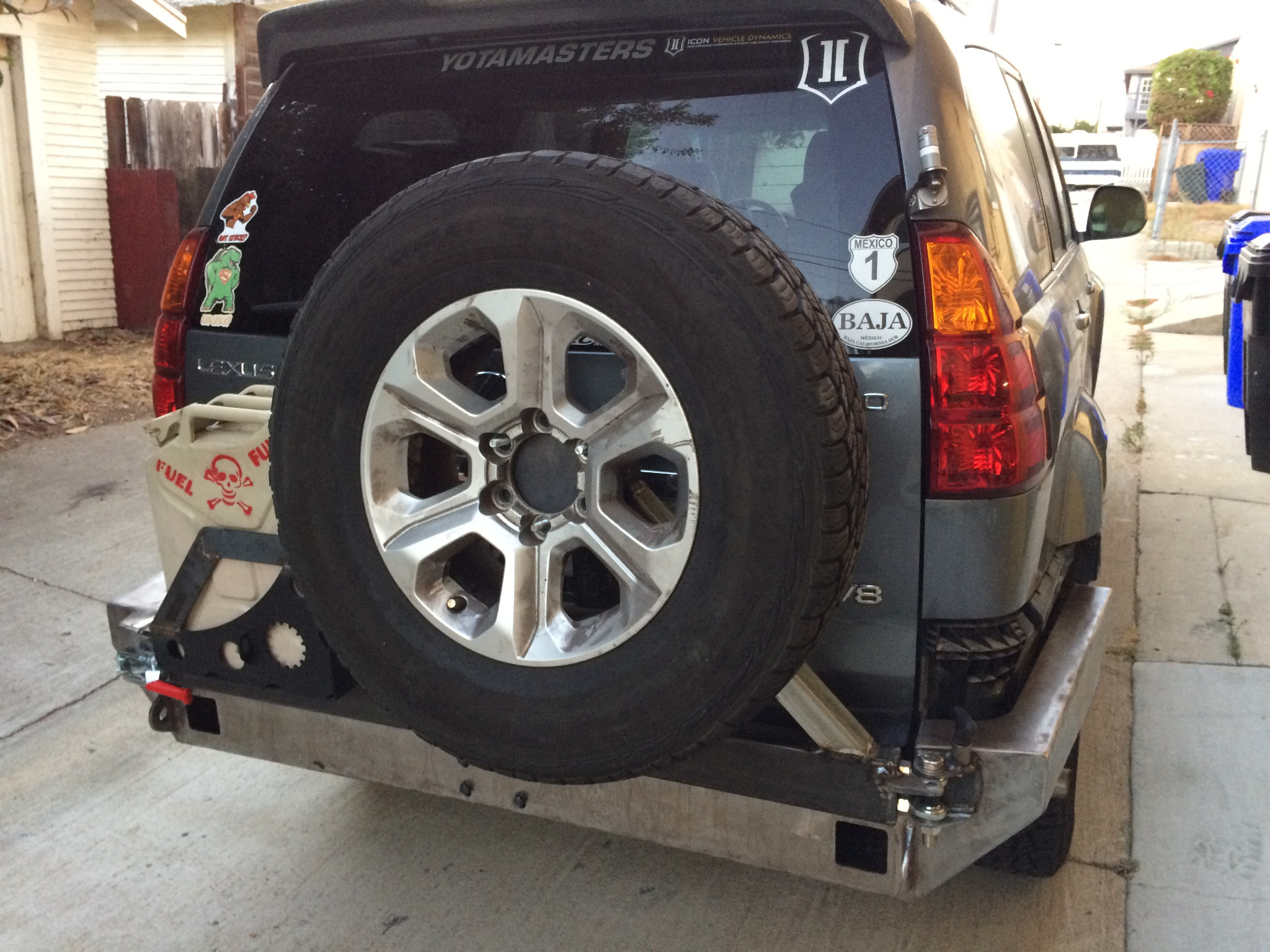

A nice tilt to the tire not too much but it looked funny at 90° exactly.
We built out a latching point for the latch to hook onto and matched the size and shape of the swings on the other side.

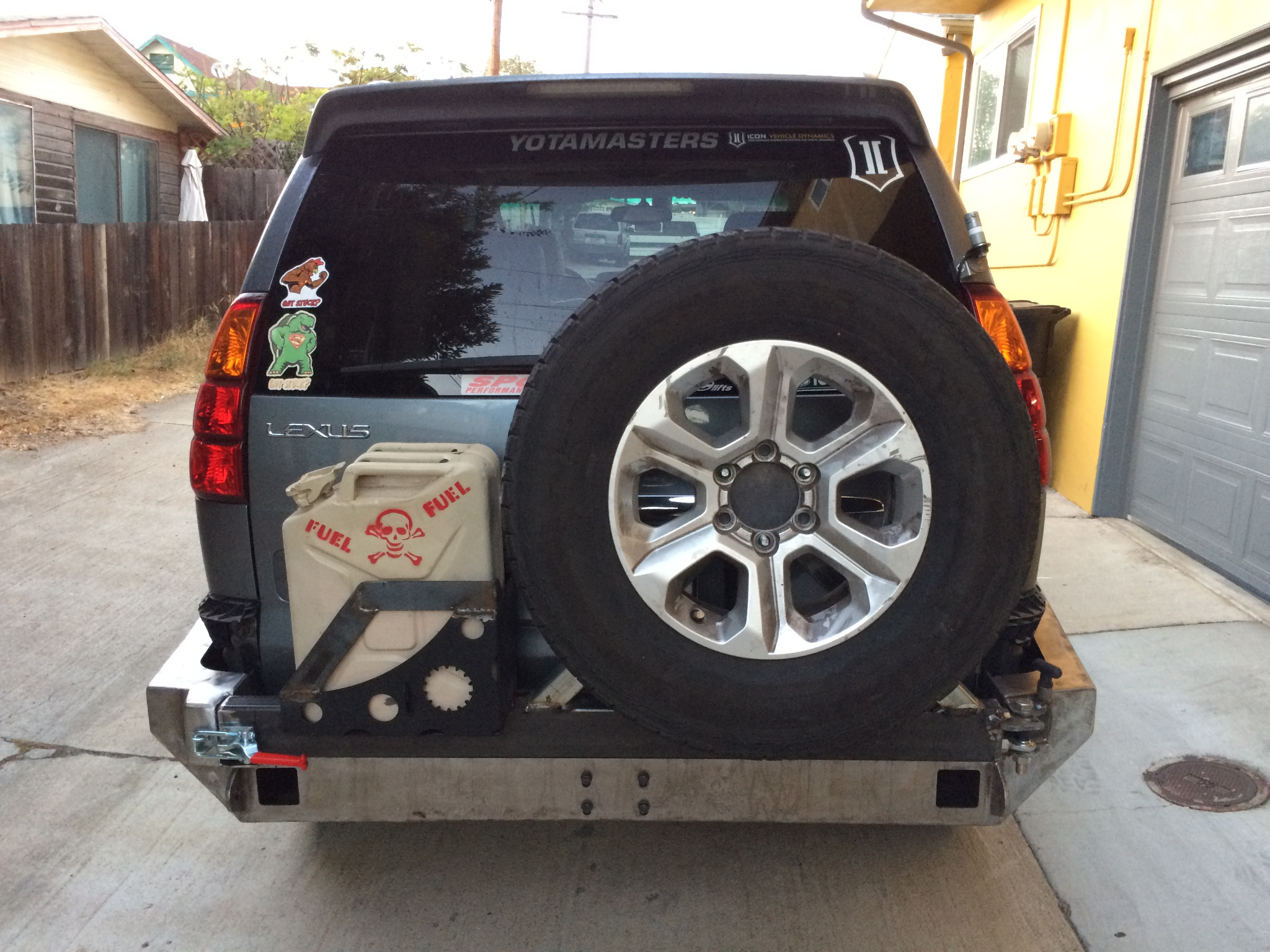

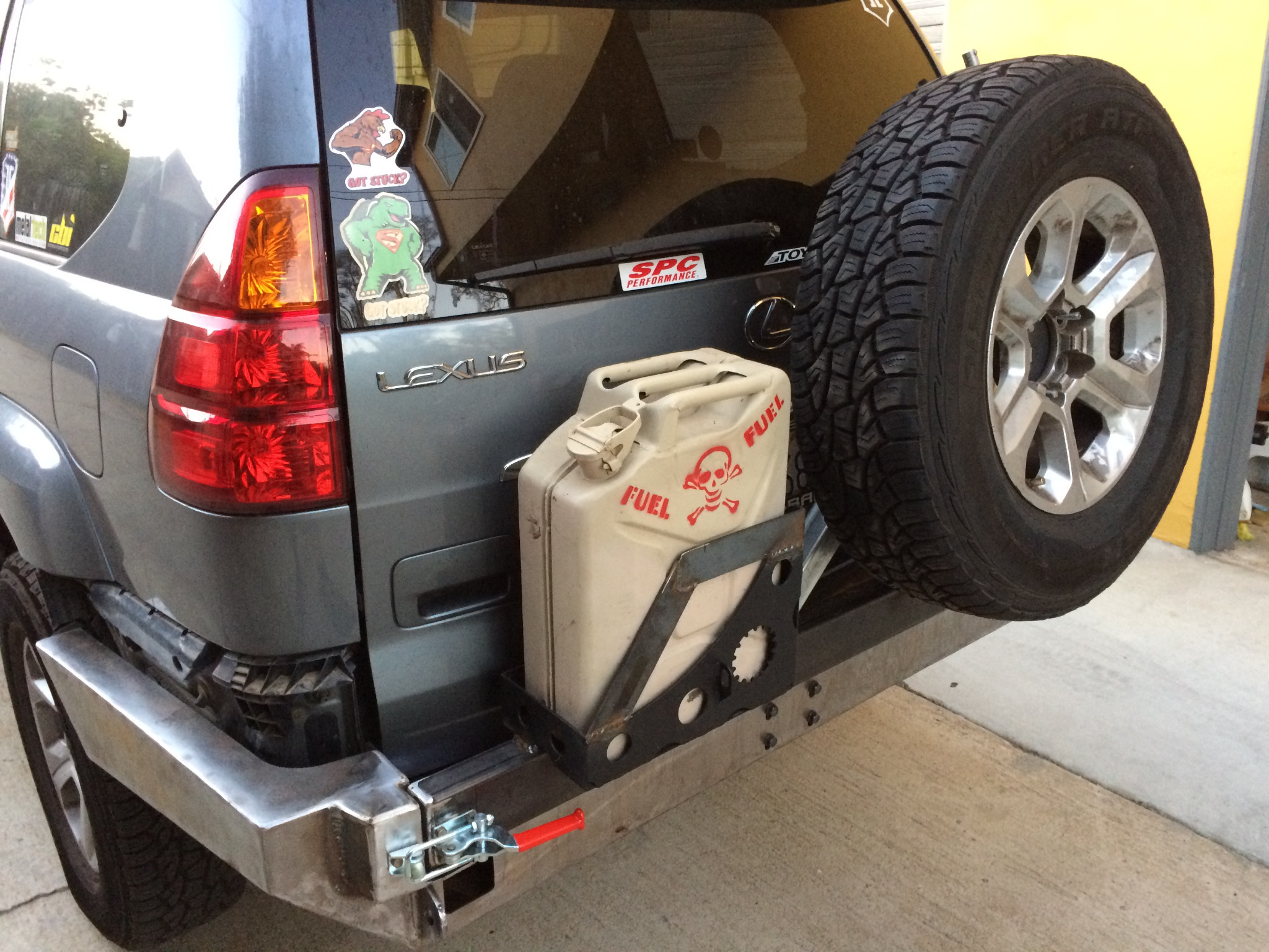

Then we attached the gas can basket I got from ????? And added a mounting bracket that will be for my 2gal water Rotopax to attach to.
A few Poser shots before I took the bumper back off.
Next we just need to mount a circular plate for the rotopax to attach to and then I am thinking of cutting the factory tow hitch and welding it directly to the bumper high and tight. I want the three point full hitch because I plan to tow in the future.
I like where you have gone with it, looks good. I like the long arm swing as opposed to dual swing outs. Has your rig been down this whole time during fab?

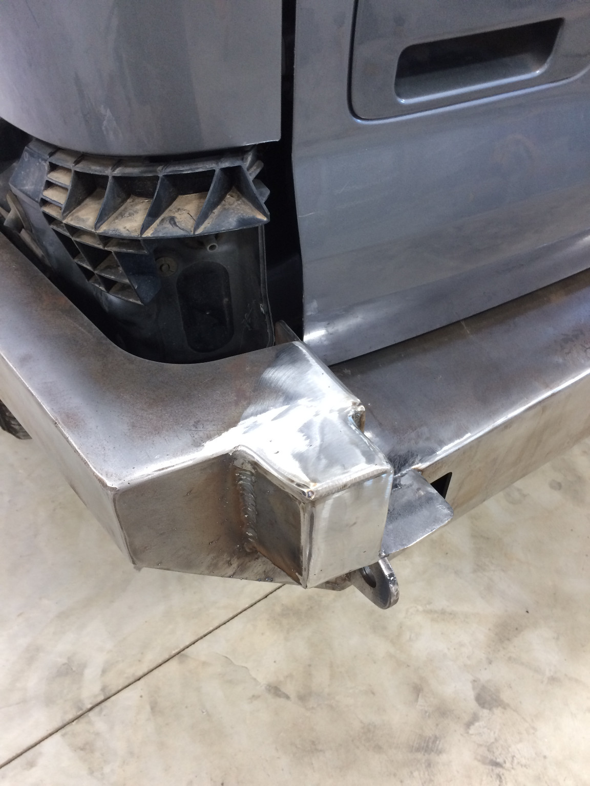

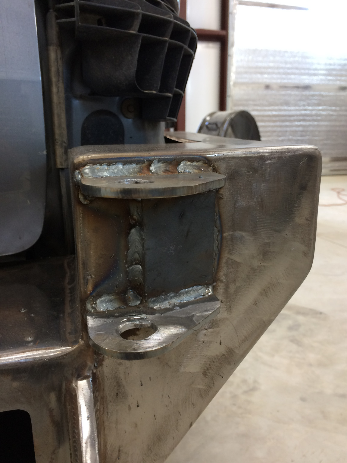

So I received the slightly newer version of the rear bumper. I went to test fit it after rack welding the center portion but noticed the body mount is getting in the way. Did you all have the issue too?
