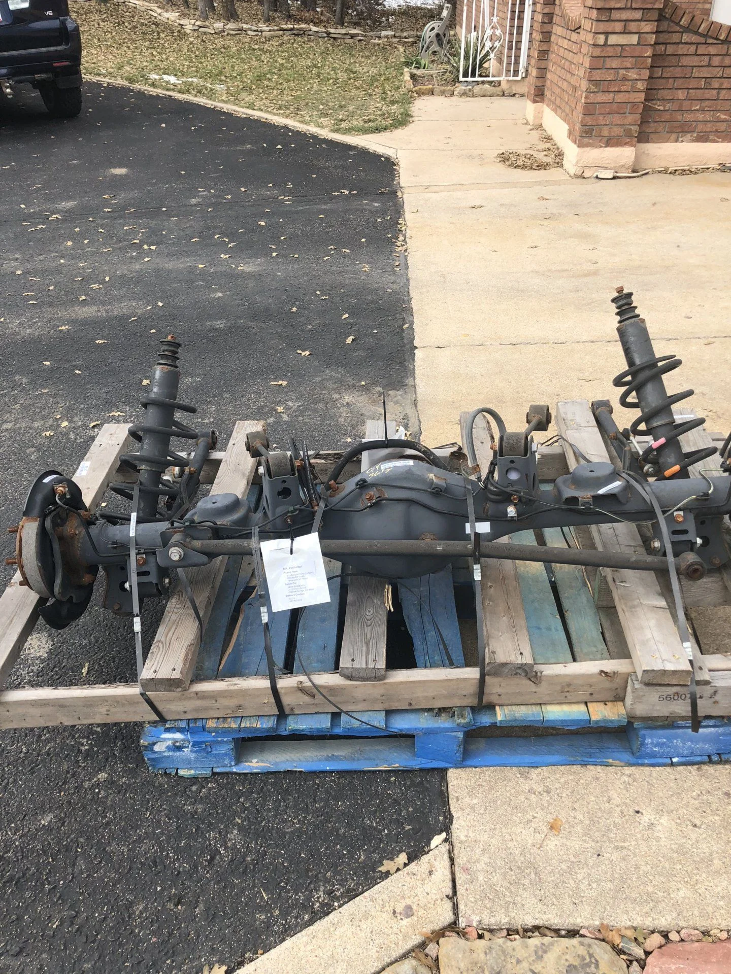

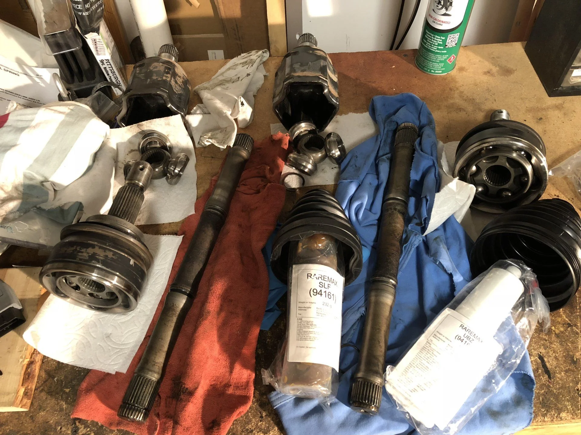

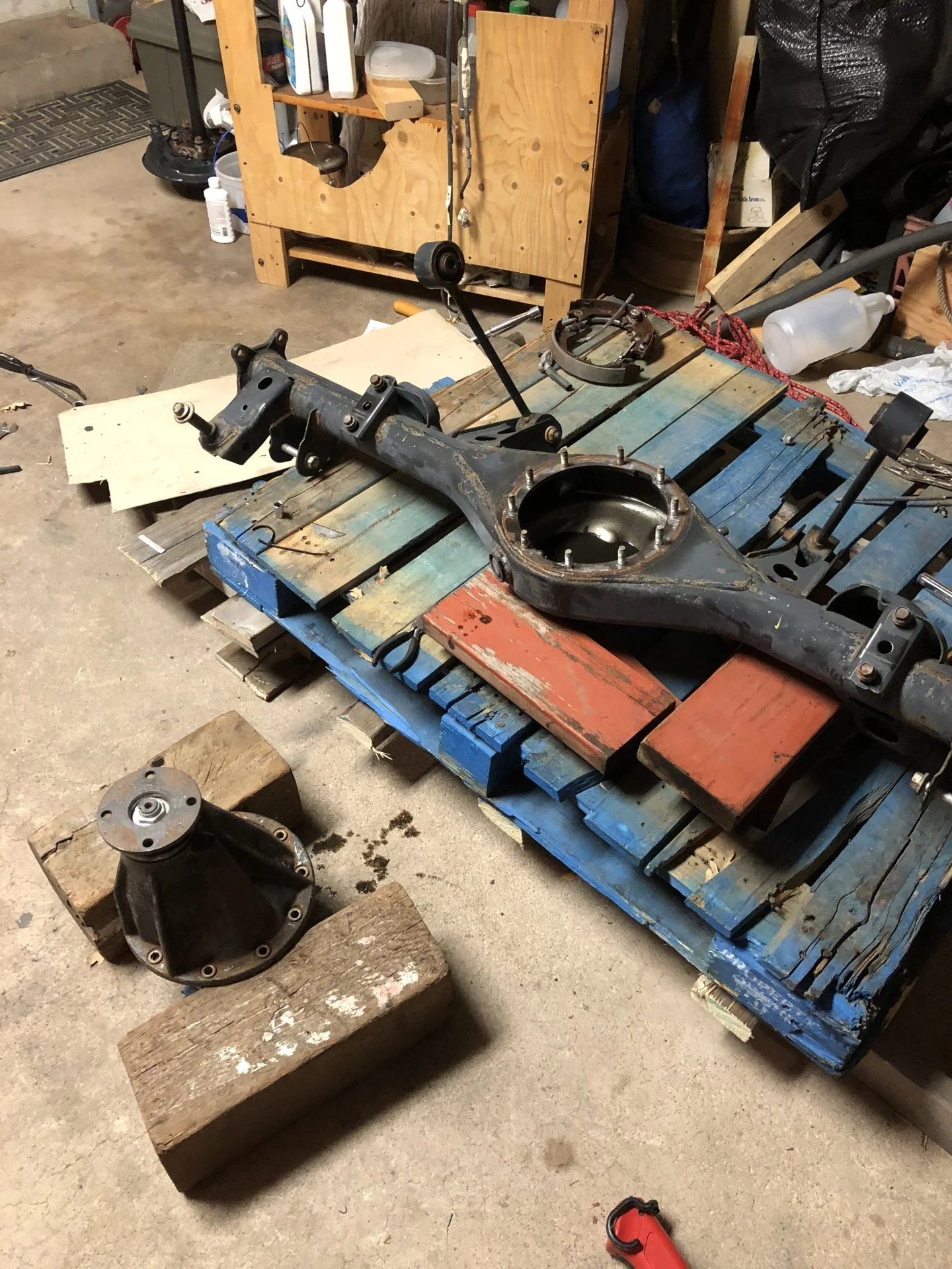

I’ve been busy and realized I needed to give an update. I got the new axle housing swapped in but found out that the brake rotors are not interchangeable, not a big deal but a surprise. The parking brake system has to be the worst design ever, not user friendly from a wrenching standpoint. Regeared to 4.56 Nitro’s front and rear. Slee did the front, I took the diff out and took it to his shop and waited around for it to be finished. A buddy of mine and I did the rear and put an ARB locker in. While I had the front apart I decided to go ahead and completely take apart the half shafts and service them. Glad I did, the grease on the inboard side came out like chunky chocolate milk. The outboard sides were definitely better but it needed replacing as well. They are different greases but you could tell they had lost some character. Cleaned, new grease, and new boots. I also opted for the McMaster Carr clamps.
Primer on new housing
Half shafts cleaned and ready for new grease
Edit: While I was waiting on the front diff to get re-geared at Slee, I ran over to CVJ axles and got the c-clips for the outboard half shafts. This is not a serviceable part from Toyota and you will likely have to find an axle shop and get from them. I took one to NAPA to find a common/local source and they said they don't carry them.
Diff housings ready for new parts at my friend’s place. Nice to have a friend with that knowledge and tools such as press etc.
One thing I noticed is one of my ABS sensors had a lot of gunk on it. Looked like water had gotten into the hub at one point and had rusted a bit. Cleaned up the sensor and the hub as best I could and replaced the oil seal on both hubs. I am going to test drive with VSC in normal mode and see if that was the problem with VSC function.

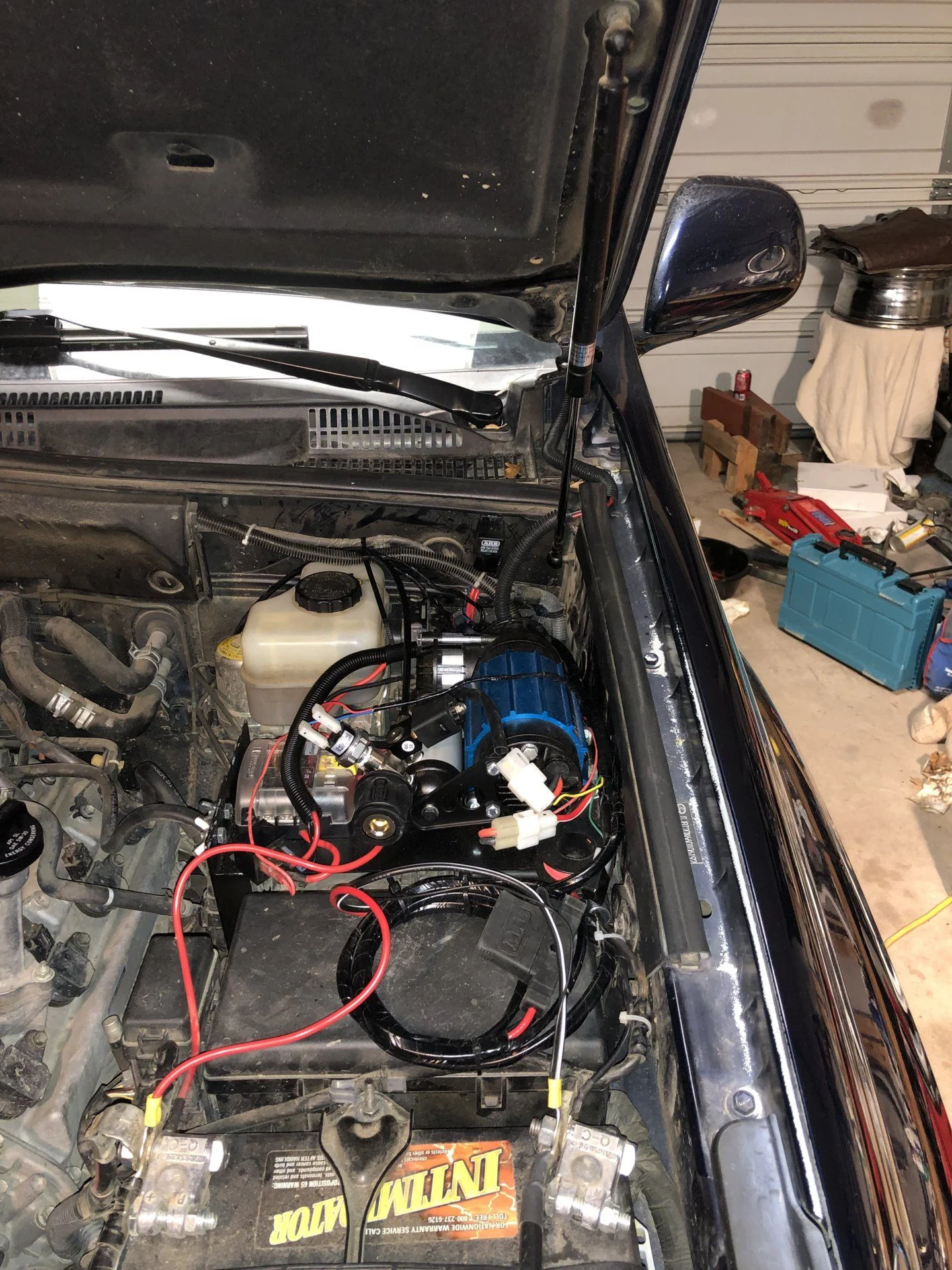

I fabbed up a compressor bracket and mounted my fuse block on there as well. It looks a bit messy but with a HAM radio, led lights, 12v outlets and trigger wires, there is a lot going on. I will likely try and clean it up a bit more, but that ARB compressor has a lot of stuff hanging off it and that space got pretty tight. I mounted the compressor and locker switches up and out of the way, but still easy enough to reach. After installing these, I really like the 80 series dial better, much harder to accidentally engage.
Compressor and fuse block

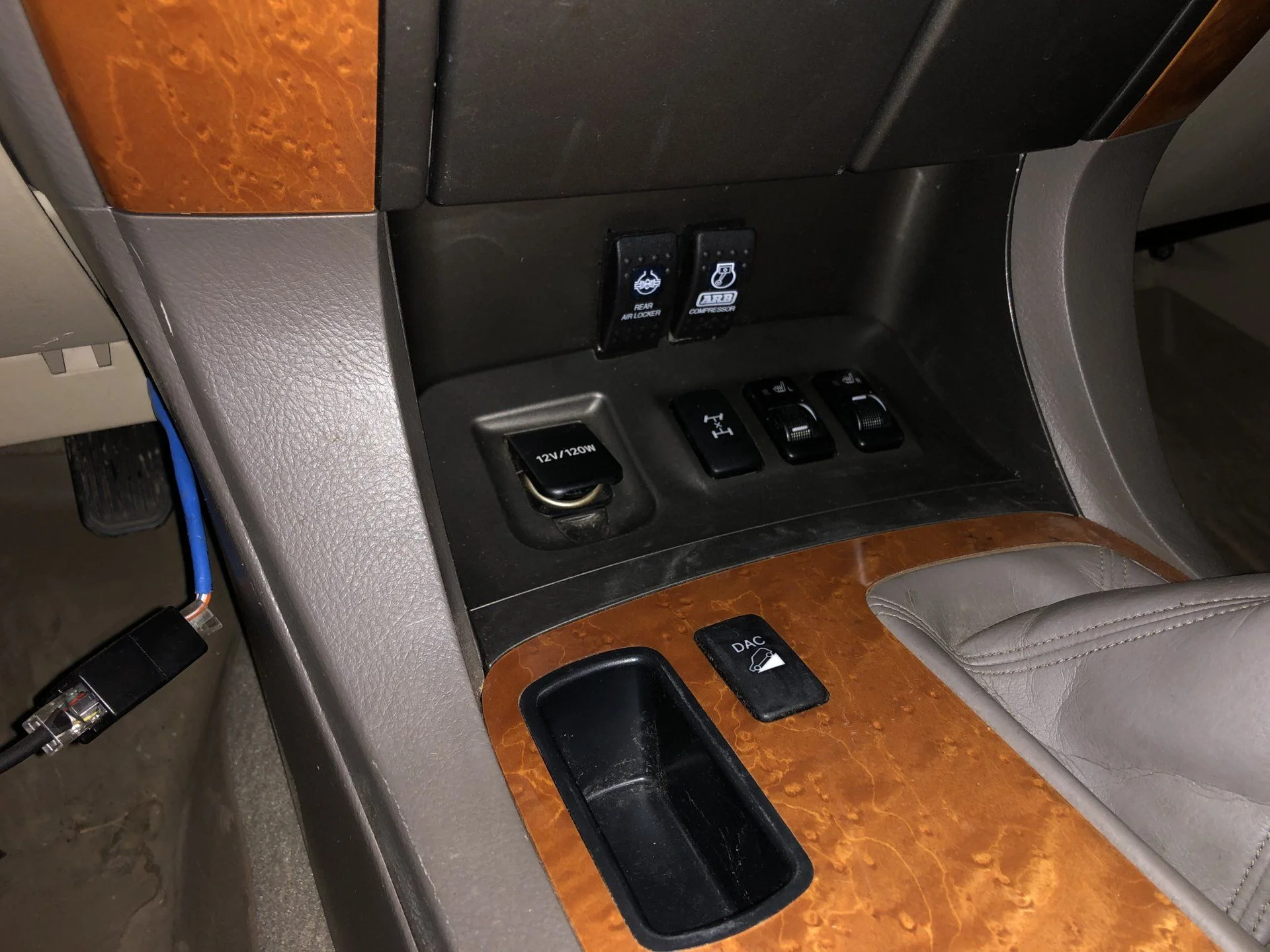

Switches installed

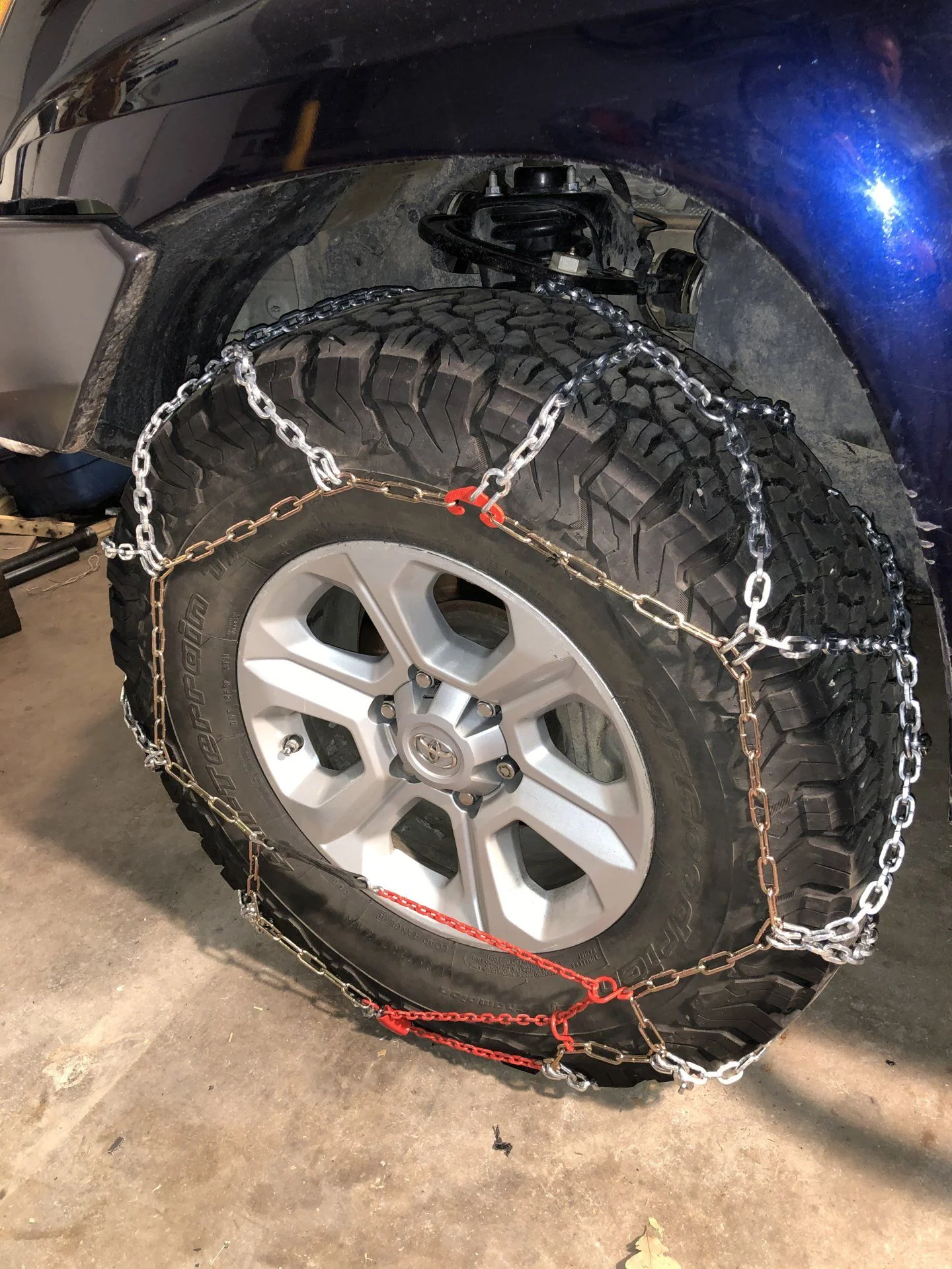

I picked up a set of 4Runner wheels off CL for a good price. The main motivation, besides looking better, was the extra clearance. I really wanted to be able to chain all 4 tires and I was fortunate to find a set of never used RUD chains on CL for the front. I’ll use my regular chains on the rear. The folks at RUD chain said I needed 1/2” clearance on the inside. Clearance looks good in the garage, test drive will tell.
Inboard view of RUD chains
4Runner wheels with RUD chains
Switches installed
Nice work and updates. I still haven't found your detailed write-up on the nanny switches (traction). I think its detailed in another tread, and just mentioned in this build. (albeit my "looking" has been cursory ;) )
Amen to friends with knowledge, tools and abilities, eh @gahi !! ;)
Thanks. The link is in post 45 but here it is to make it a bit easier.
Snow and Ice Performance/VSC Disable
I had to go back and look at my pic, the mind's eye had those rims, gunmetalled out and already on your GX. They'll look great!

Here is a pic of what I did to the RUD chains. Actually, I was impressed by how well the held up considering I dug a hole in frozen gourd with them. On one set, the brackets got bent due to hitting the side of the hole when I was leaning a bit. All in all, happy with them and really glad I can now chain the front.

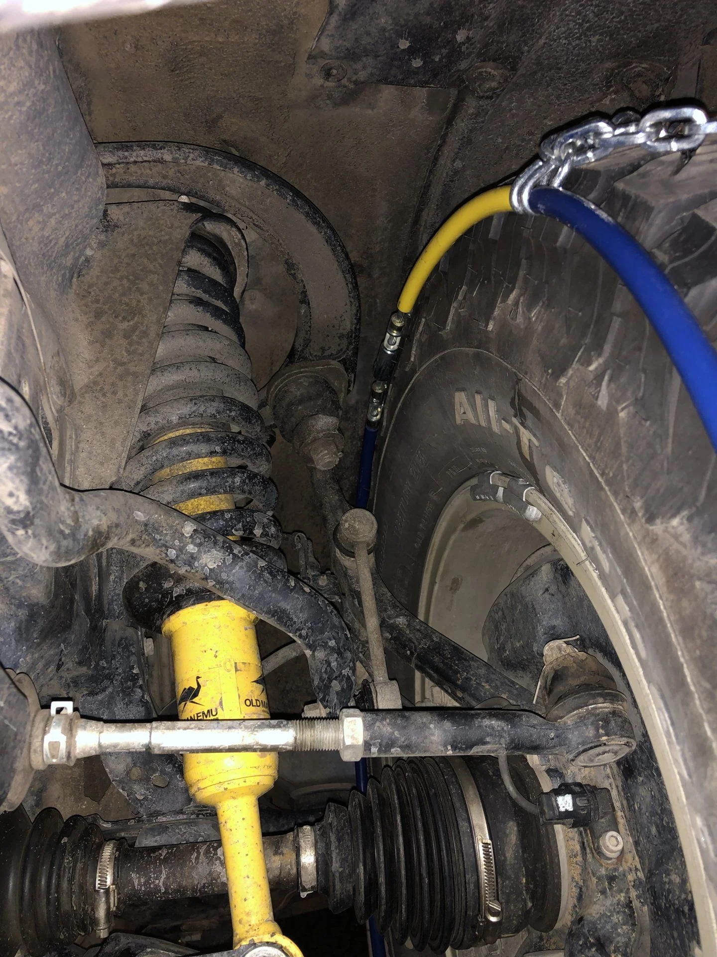

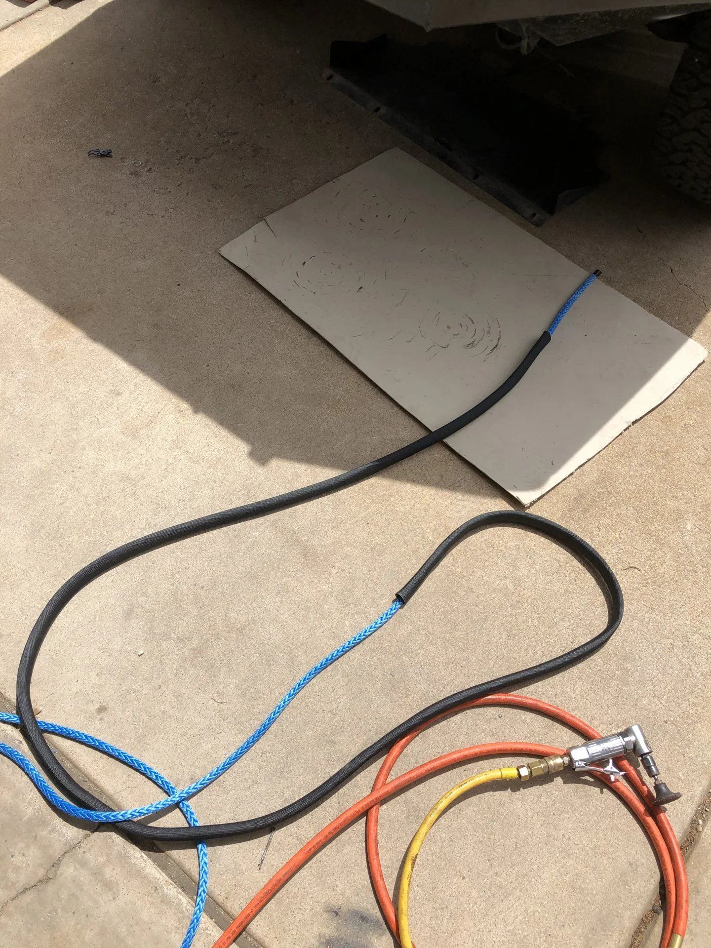

I bought some 7/16 and 3/8 Amsteel Blue. I made about a 75’ mainline and 35’ of extension. I made 3 soft shackles out of the 7/16. I used some fiberglass heat sleeve on the first wrap on the drum. I used some blue water tubing for chafe guard. Kinda cool doing the splices etc.
I had one pull on the winch prior to doing this but it was enough to roughen the roller a bit so I polished them before installing the new rope.

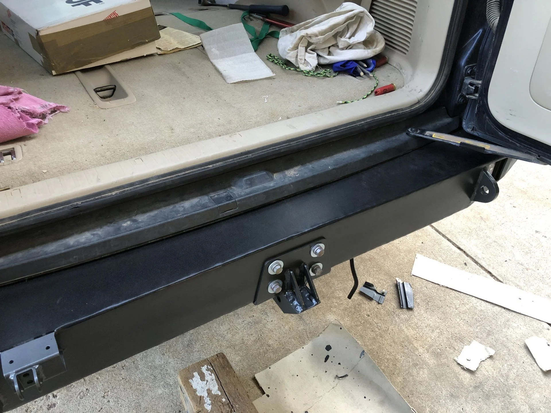

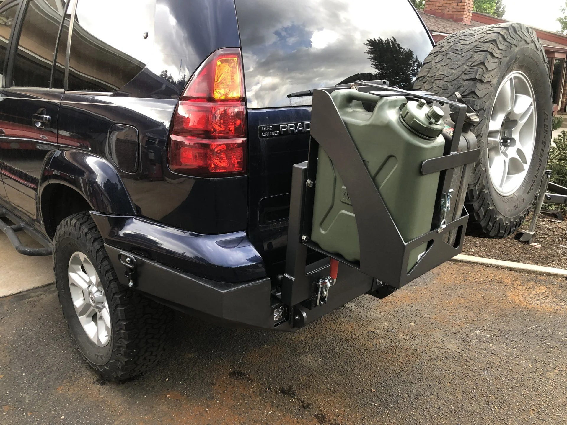

Just finished my Coastal Offroand bumper build. I ordered the long arm kit and jerry can holder. The location of the latch block is far enough over it shouldn’t be a leg catcher. I won’t go into a lot of build pics since there is enough info in the Coastal Offraod thread. I was back and forth on how to coat it and finally settled on POR15. I prepped it with flap disk, sprayed it with brake clean then used POR metal prep which is basically phosphoric acid. I then put on three coats of POR15, then used the POR self etching primer before top coating the vertical parts with hammered matte gray. Matched pretty close to the ARB front bumper. The horizontal parts I coated with spay on bed liner so we would have a nonskid surface climbing in/out of the back.
I also reinforced the the hinge area like Bluetribal did. The lock pin is my addition and not part of the kit. I also reinforced the vertical part of tire holder with angle on each side plus the back of all verticals. Just a little extra cheap insurance. I added these foldable steps on both sides of the bumper and think these will come in quite handy.
