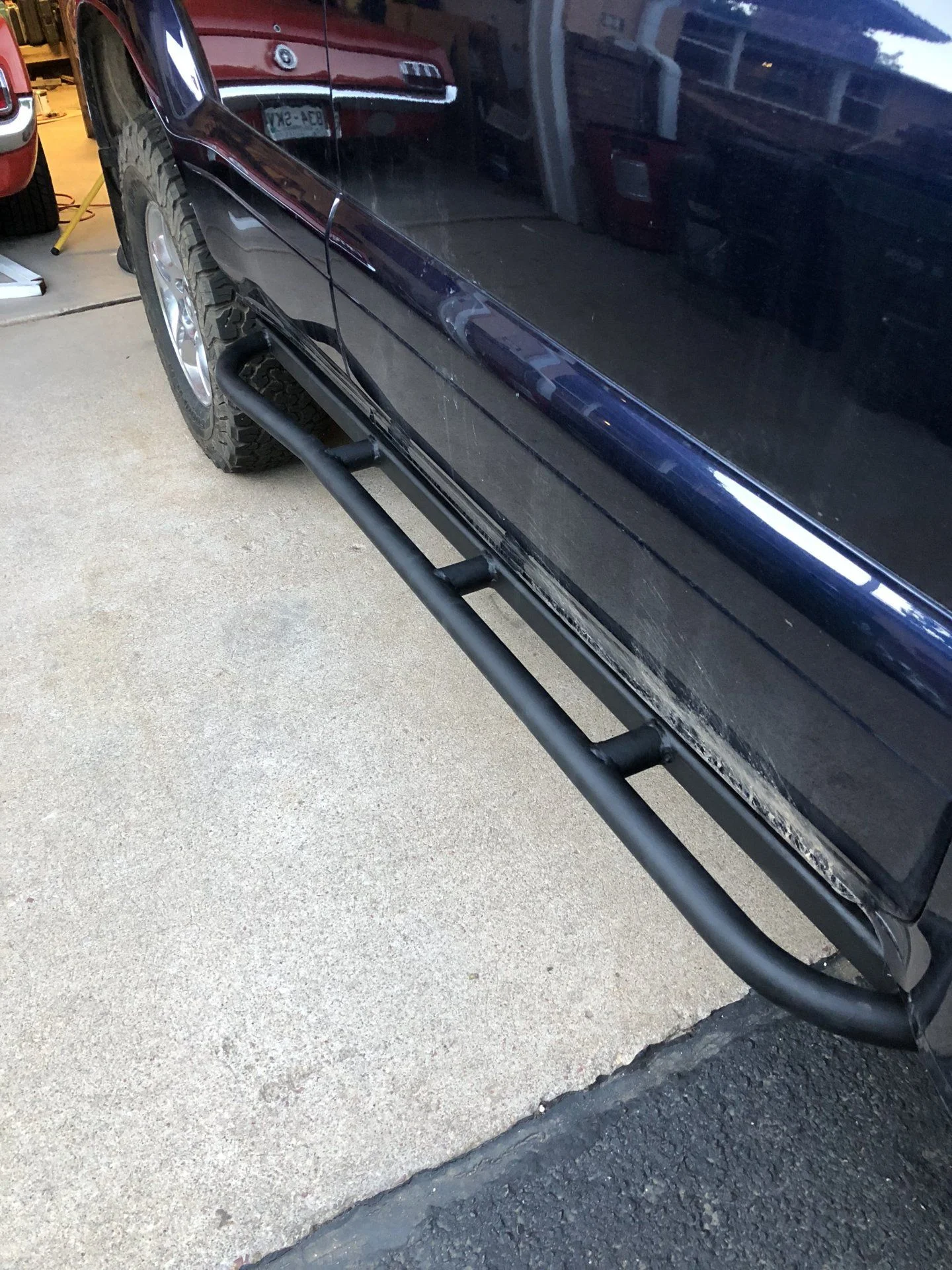

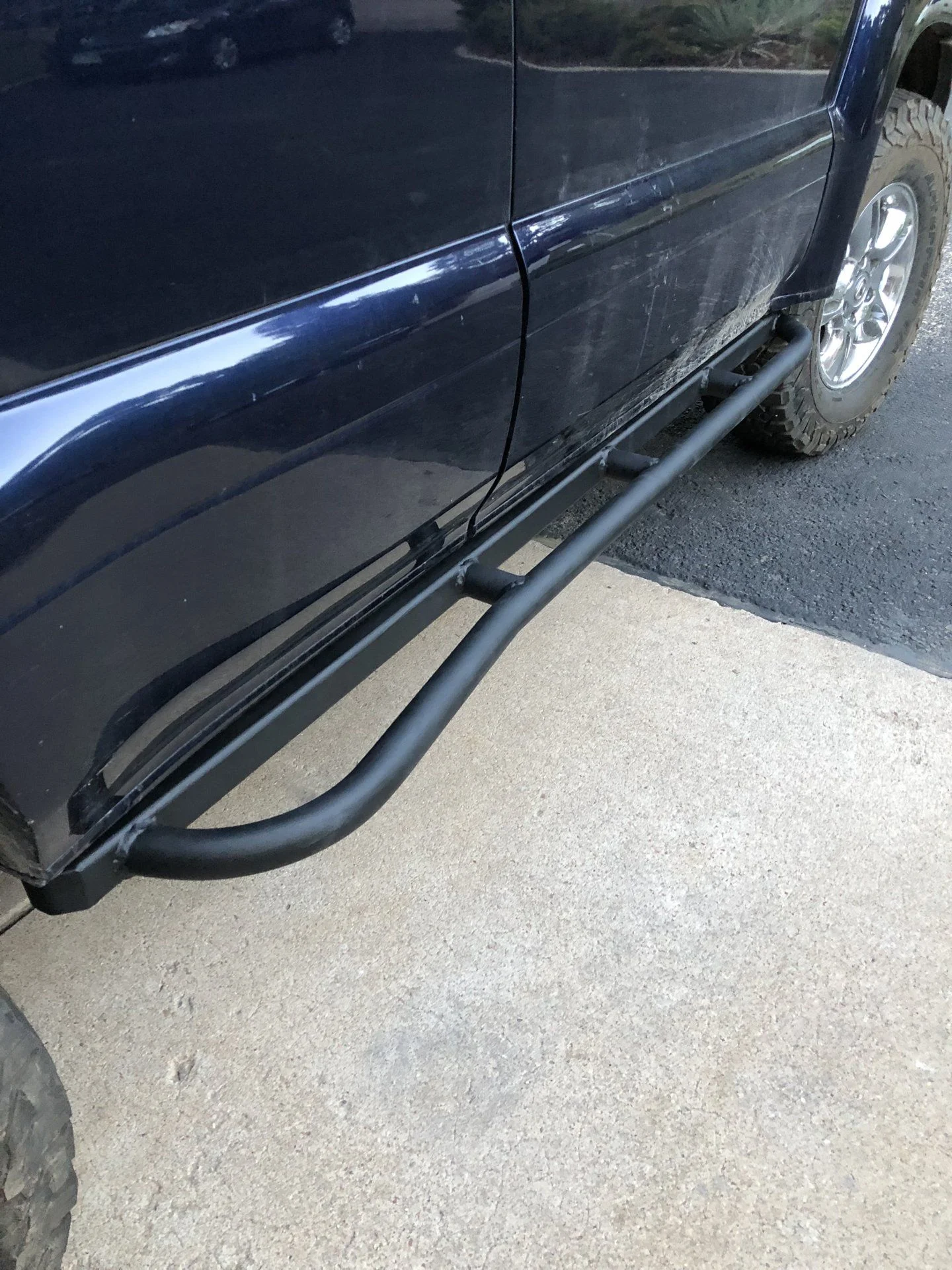

Got the second coat of paint on last night and mounted them this evening. Install of the Heftyfab sliders couldn't have been easier.

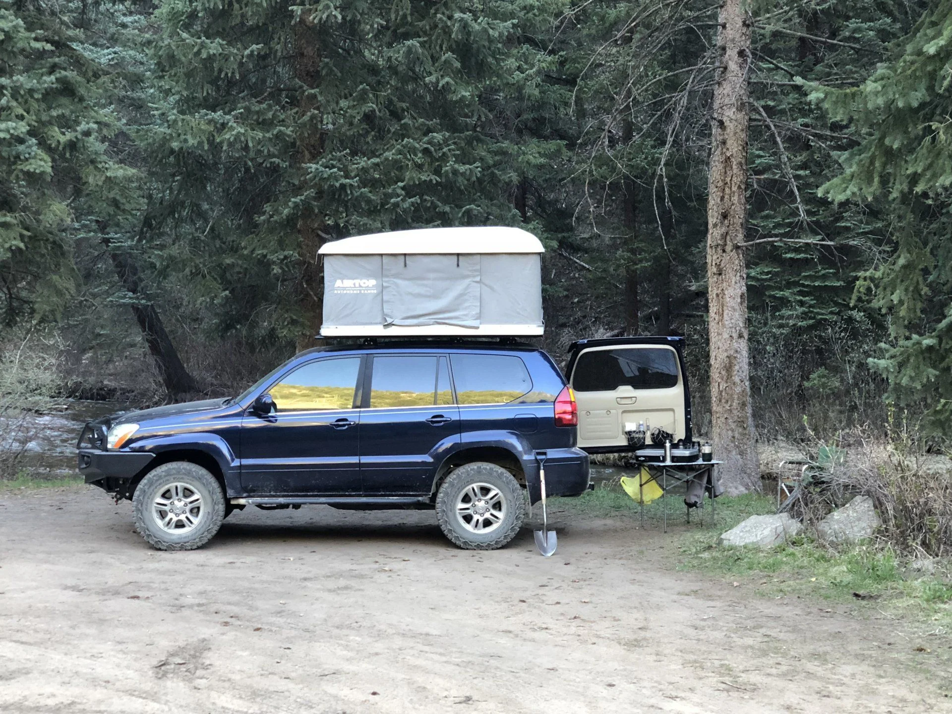

Okay so I had to put down the wrenches and get this rig out. My wife and I took a long weekend and popped over to the Gunnison basin for some fly fishing and exploring. All in all a great time and we are really liking the GX, except for VSC, but more on that later.

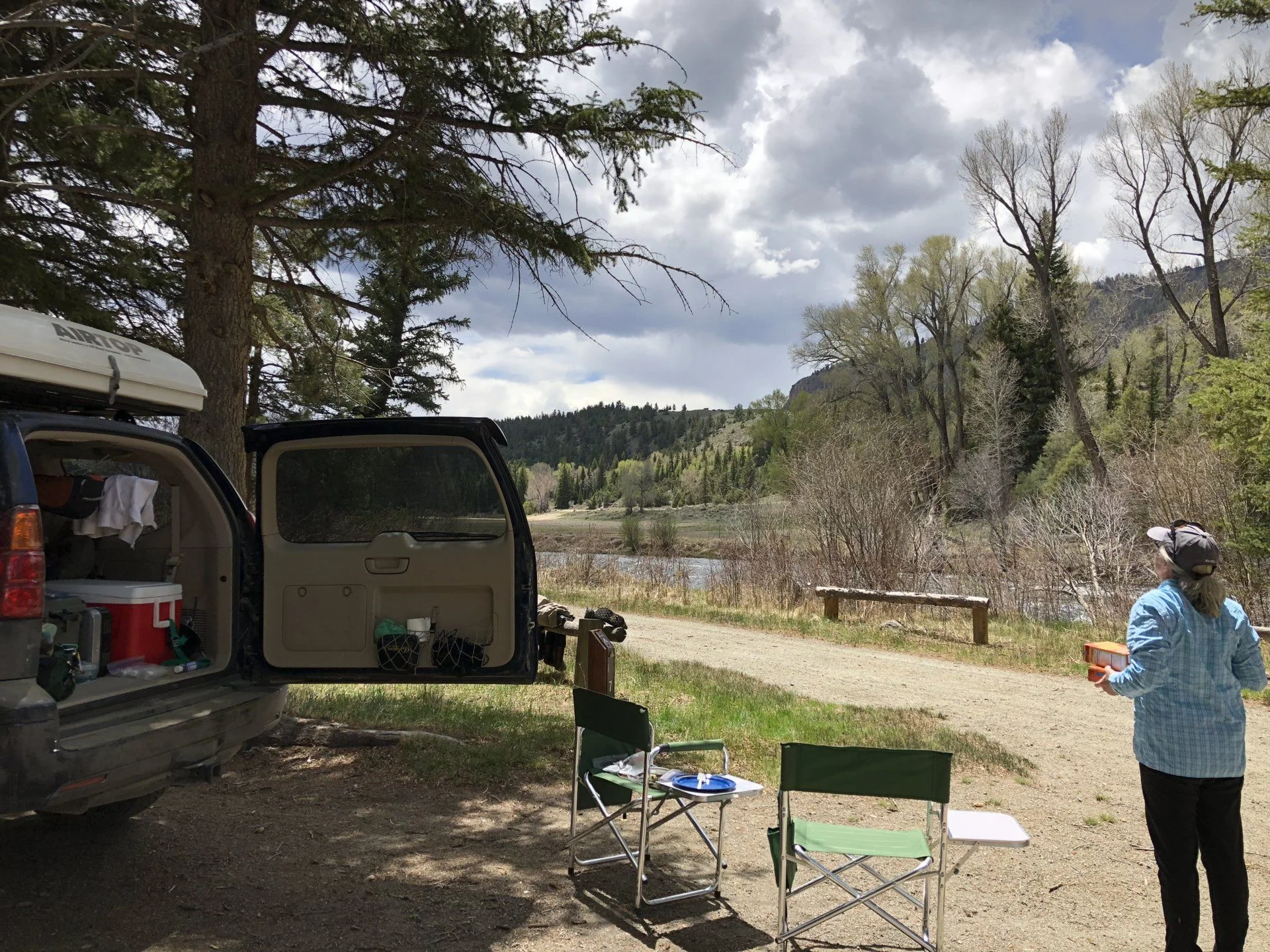

The side opening rear door is different. We do miss the tailgate but the side opening makes for a great windbreak. It will be handy once I get the fold down table.

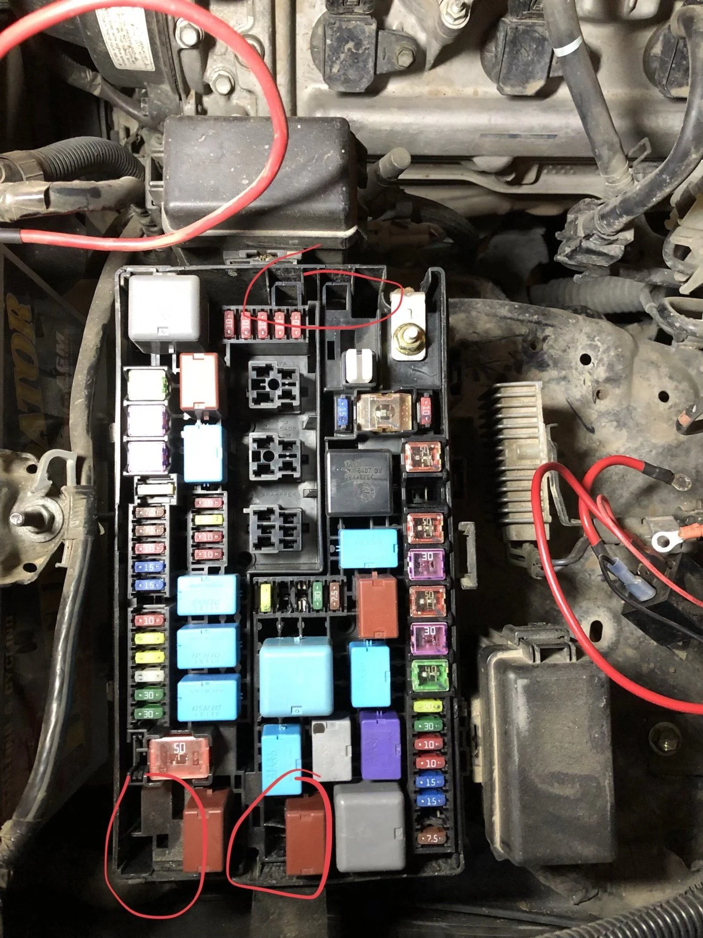

On another note. How do you get that 50 amp fuse for the air suspension out? It's not a simple pull, is it one of those bolted from underneath?
Fuse isn’t secured by anything. I think I stuck something in there to help pry it loose.
So I went back out last night to pry on it a little. Then I realized I had been working on the wrong 50 amp fuse. The air suspension fuse came out pretty easy. The one I had worked on/over was labeled A/pump. Now I have to remove the fuse box to unbolt and replace that sucker...:bang:

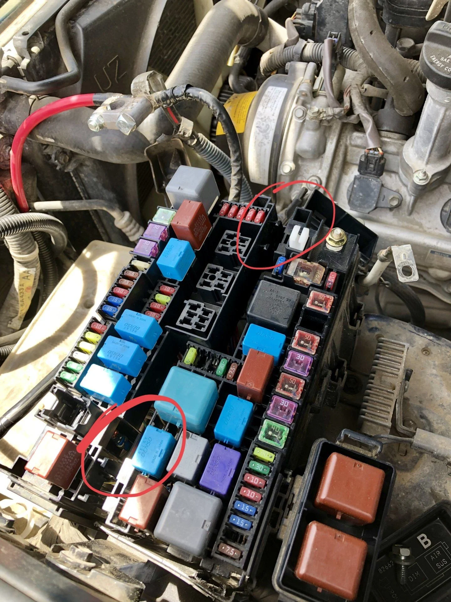

Its been several weeks since I posted an update so here is a summary of sorts picking up where I left off. That A/Pump fuse was a pain to track down, the factory manual didn’t even show it and the dealer had to call CA to track it down. The PN is 90982-08228 in case anyone ever needs it. Pulling the fuse try was a real pain as well. You need to undo the 4 side clips and then cut the zip tie underneath and then loosen the connected wire looms by disconnecting the retainers.
There are four square holes circled, two are right next to each other. Need to get a thin screwdriver in there and fiddle a bit. That’s about the best I can describe the method.
Then when you get the tray out you need to slip something very thin in a slot where the red circles are to allow the tray to split and gain access to the fuse bolts. Picture is the tray already split.
