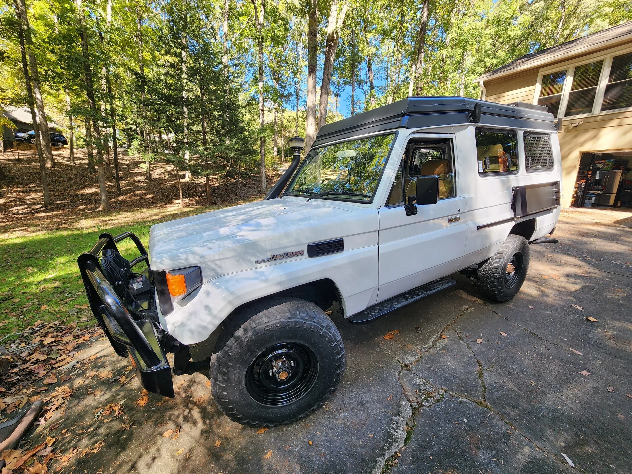

I'm an idiot. What is this for?View attachment 3747776
Love the Xplore Glazing wing gulls!
I also have no idea what that is for.
Looking at the website it MAY be used for the side of the vehicle to put the maxtrax table into that runner.
You're not an idiot, I couldn't figure it out at first either.
Pretty sure they're for the Maxx Trax table.

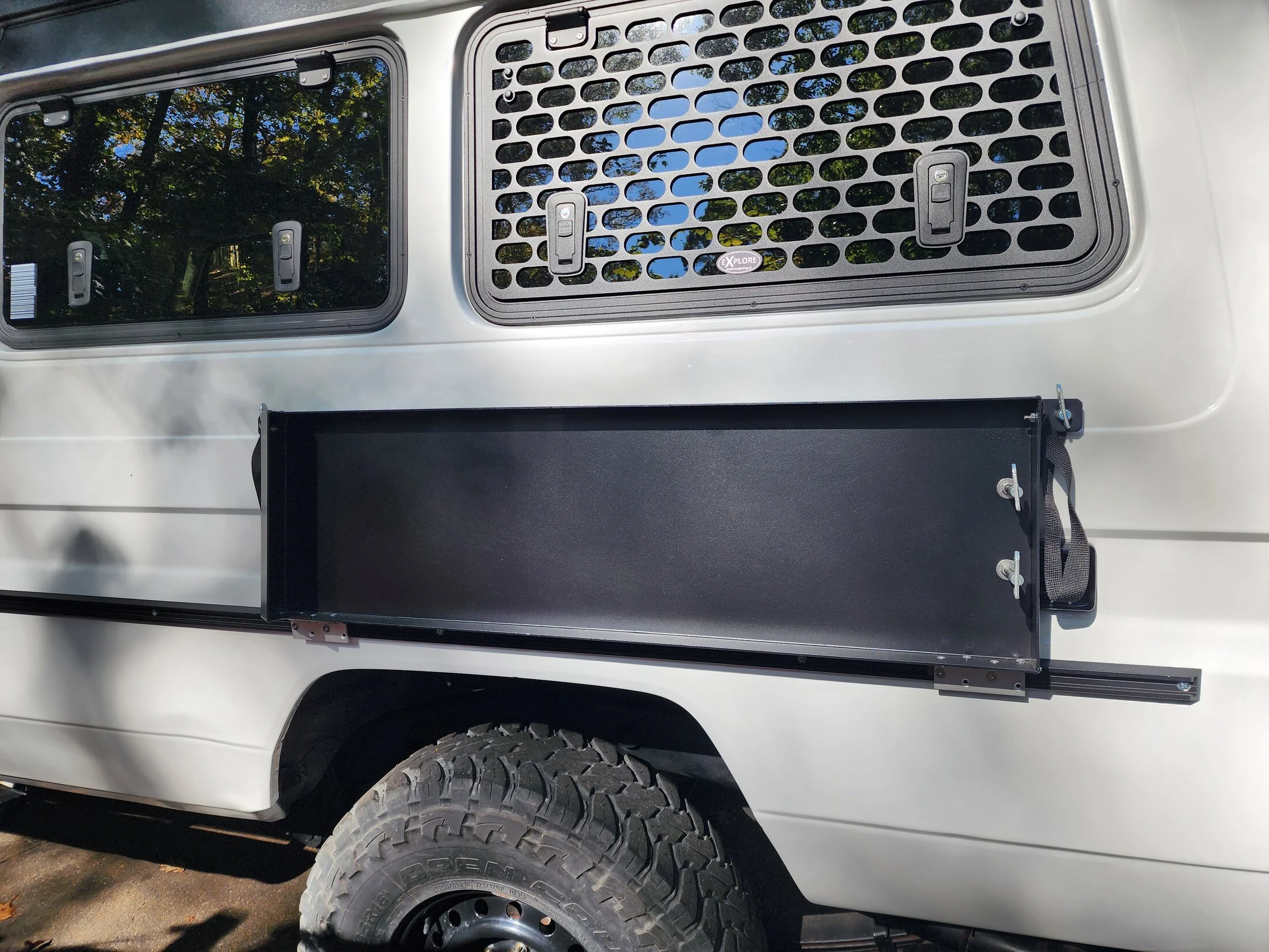

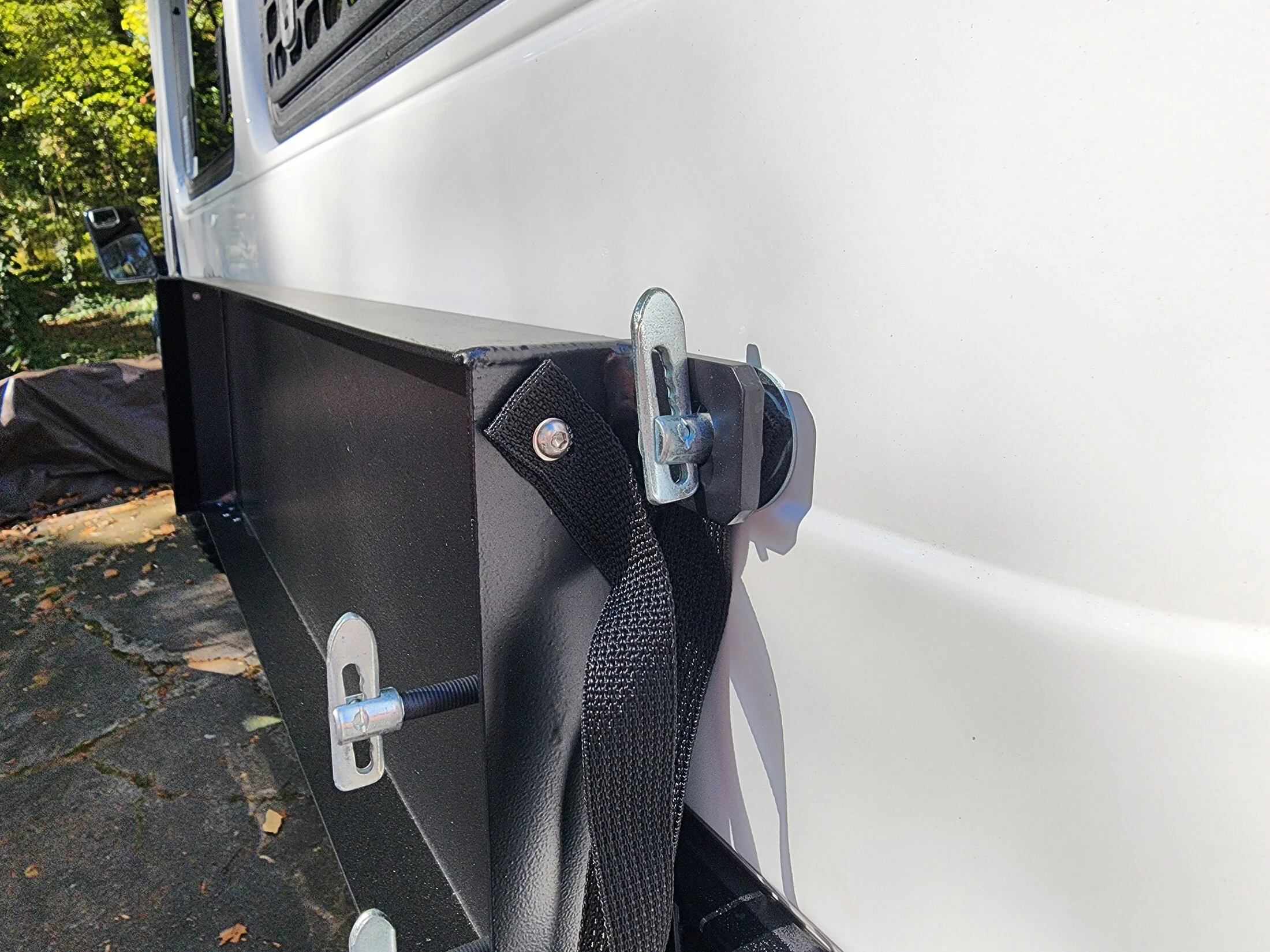

So I got this table mounted...looking at the above pdf snapshot. I'm missing the latches and hinged bracket that secures the maxtrax as well. Anyone else order this accessory and if so, did you get these items? Repeated emails to Alu-innovations have gone unanswered.

I don't have those either. I do have the pins that stick out like yours inside the storage area of the table, believe that is the locking mechanism.

The one I marked up above is from Alu-Innovations, not Mission 4x4. The pins on the end won't keep the tracks secure in the table, they just hold one end.
I sent another email to Cassiem, he's not replied or acknowledged the last 3 or 4 that I've sent, but figured I'd try. I'll most likely have to make my own bracket as well as source some latches as the toggle bolts hold the table closed okay, but with no tension, so there's some rattling when the engine is running.

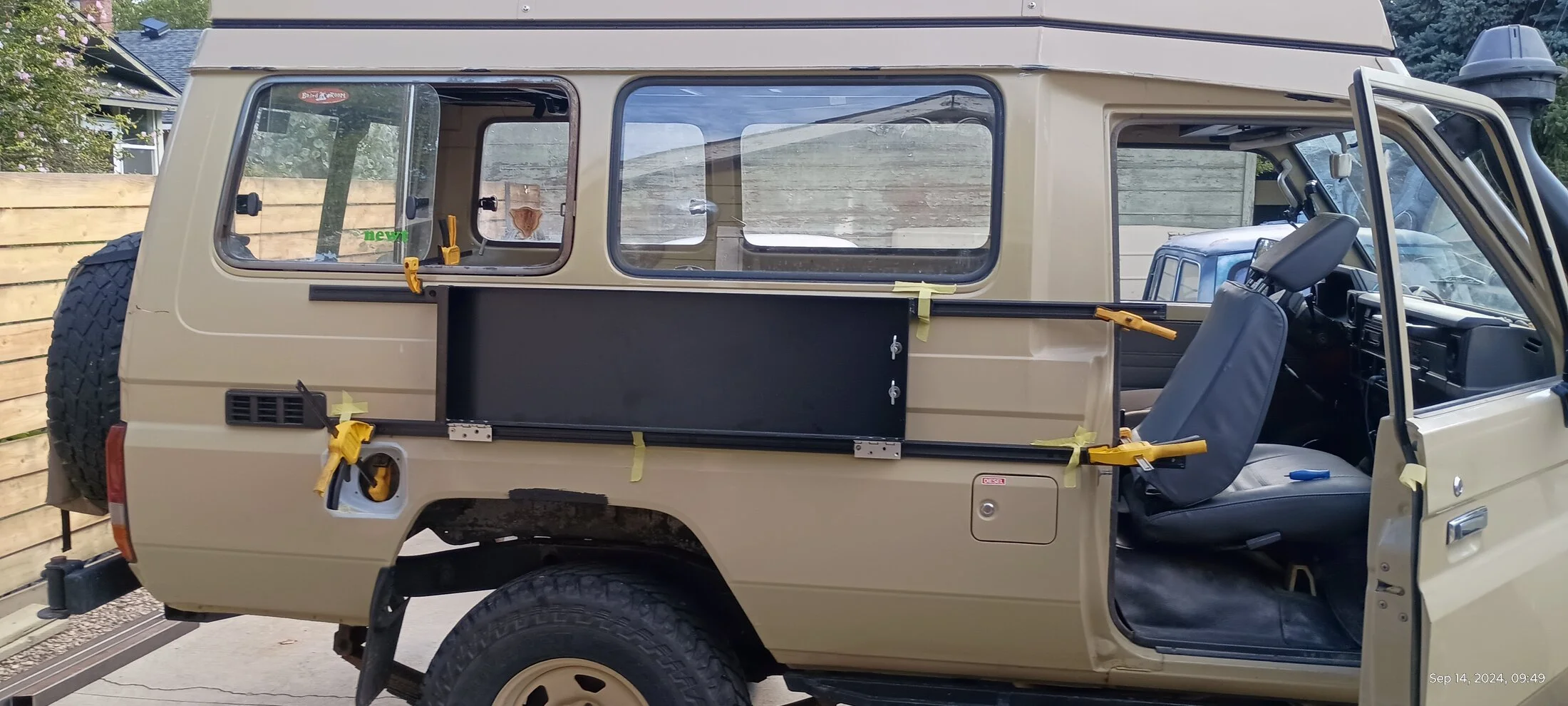

We mounted this thing a little bit differently. Used some stainless hardware and thru bolted through the body. Didn't use the top rail. I may use the top rail on the other side. Not sure yet. Don't have the correct traction boards either. Waiting on them to see how they'll fit.
From my research, this table (at least the one I received) is too small for standard MaxTrax. On the bright side, it does work as a table. I think in order to fit standard size/brand name tracks, it will need to be modified considerably.

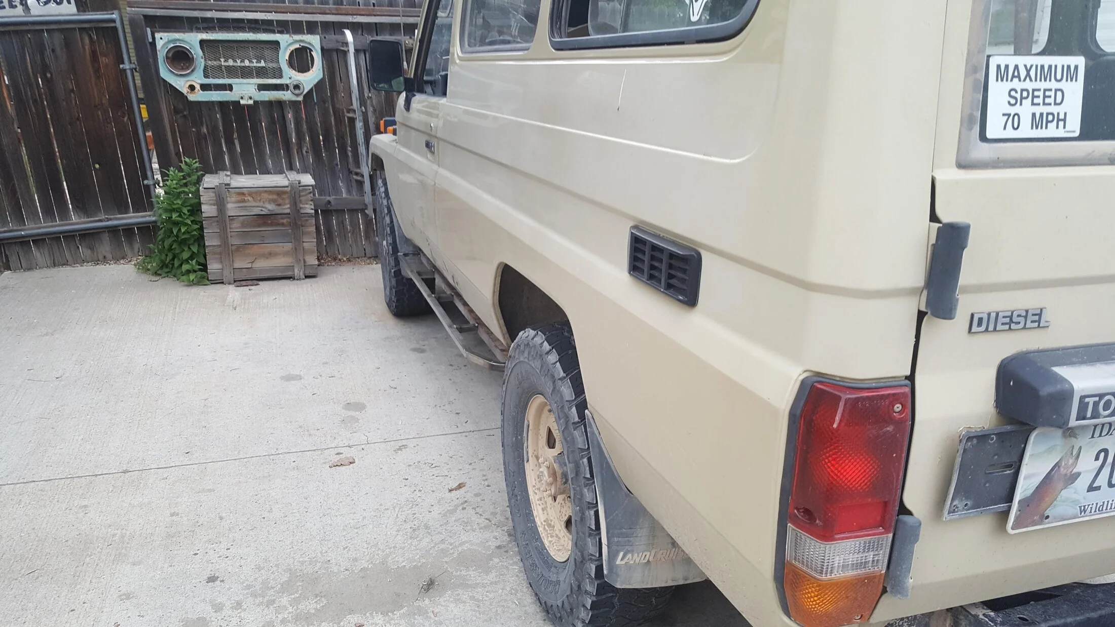

I like the sticker, I've got a similar one 'Max Speed 70'

I'll let you know how they work out. I may cut out the table and do a little fab work myself. Only time will tell.

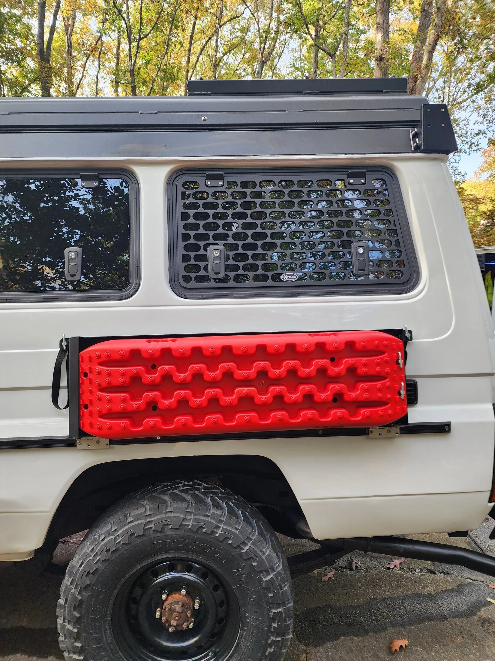

Did you get the new tracks yet? If so, how do they fit? Looks like even if they do fit, we'll need to add something to hold them in on the left end?
So I went with the 40" option instead of 41". They're a little loose on the front. I'm going to rig up something through the metal that I can just rotate to lock them in.
