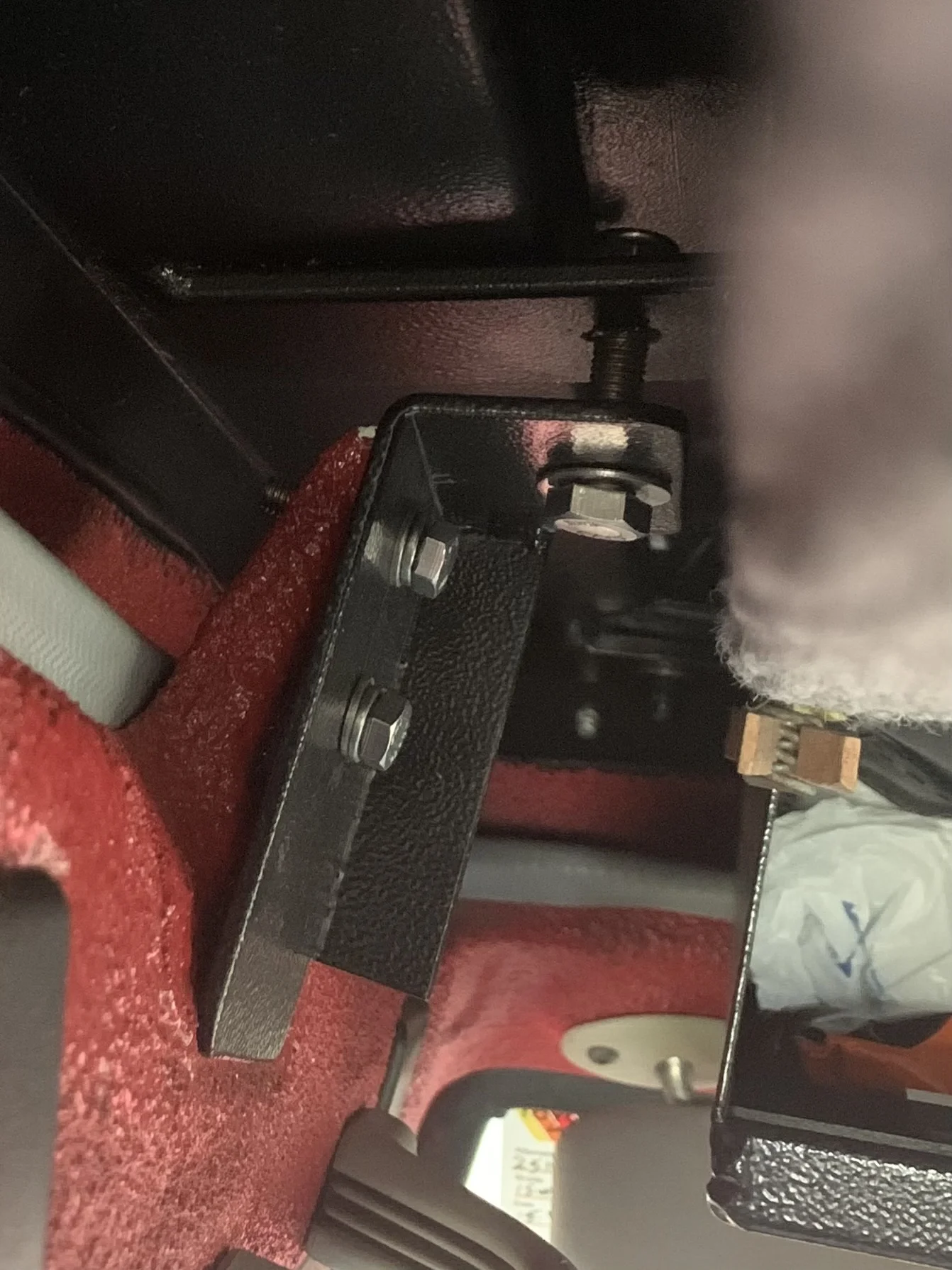

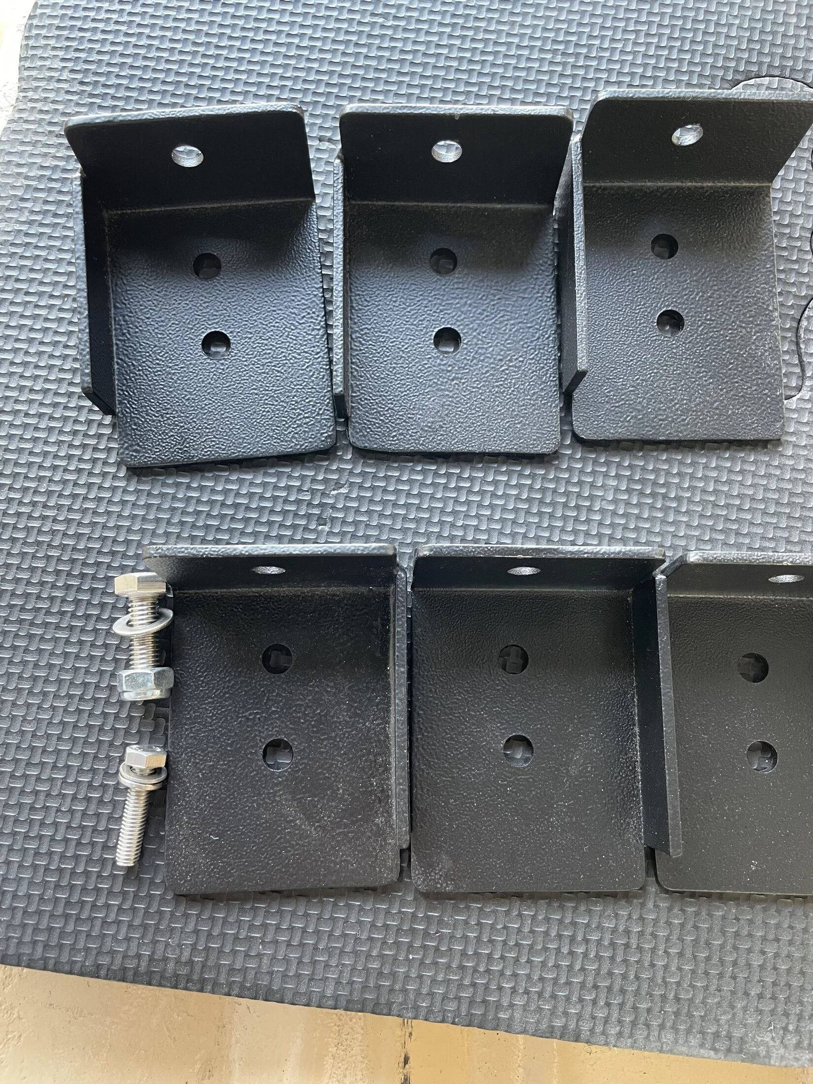

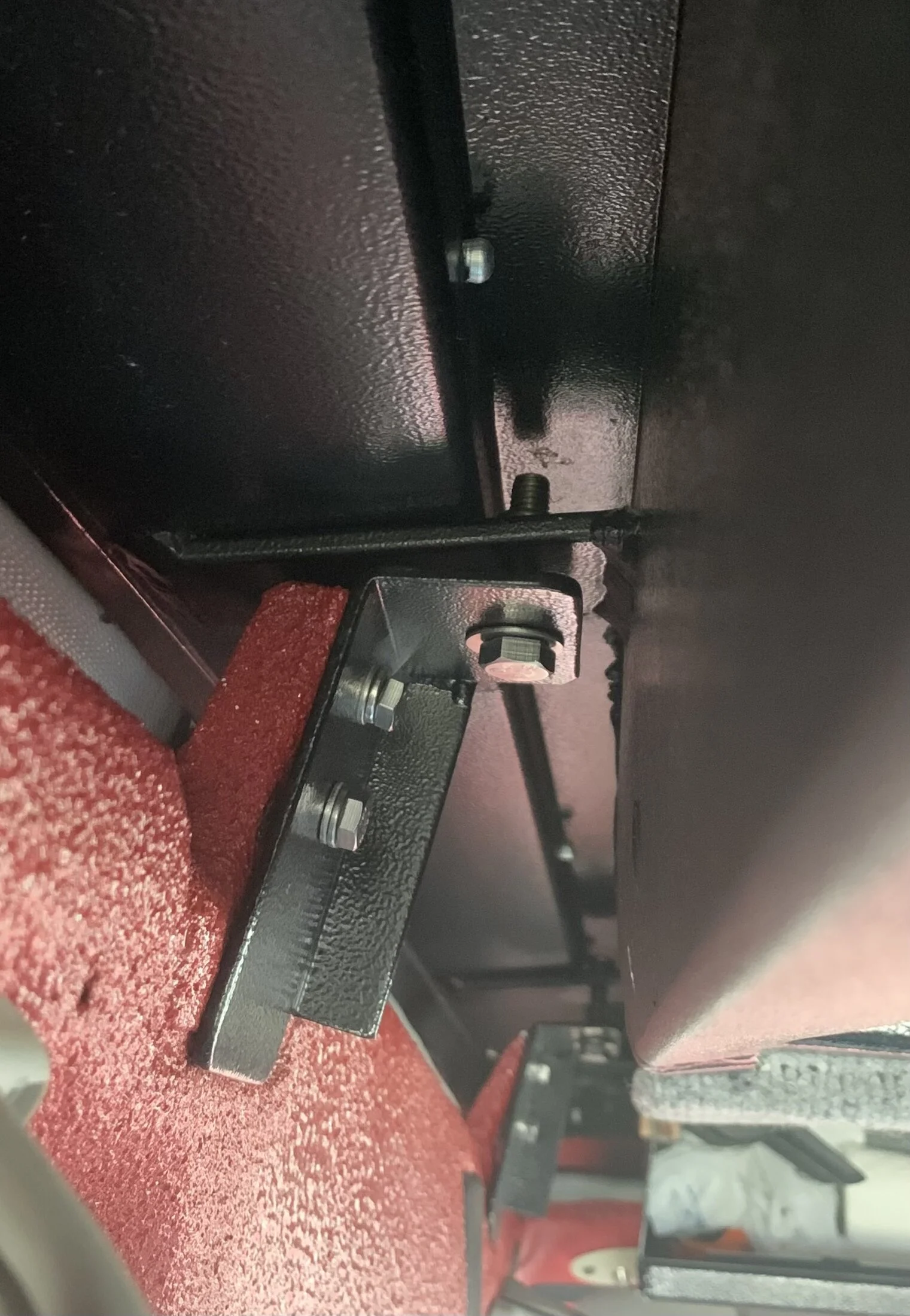

The larger diameter bolt goes from the bracket to the top. The powder coating makes the holes smaller, and sometimes they throw in random bolts that are completely not what is needed. I needed longer bolts than what was supplied for the brackets in the front.
I had to overdrill and elongate nearly all of the bracket holes to allow everything to fit. It would have been easier if the brackets came with out being pre-drilled. Also, don’t drill the holes in the poptop until it is glued and clamped. I pre-drilled, and the top ended up being in a slightly different position, so I had to do modify the holes some more.
Hopefully that helps you.
Photos are rear, middle and front bracket. You can see the larger gap between the bracket and top in the last photo, which is the front bracket.
And, I need to cut the side stiffeners on the brackets to allow the closure flashing to be installed. A problem for much, much later

Your Finnish trim may fit… my brackets sat too low because of where the holes in them were drilled. I was surprised at how “off” they wer. But my truck is an 86, so maybe the roof supports in newer trucks are higher… maybe

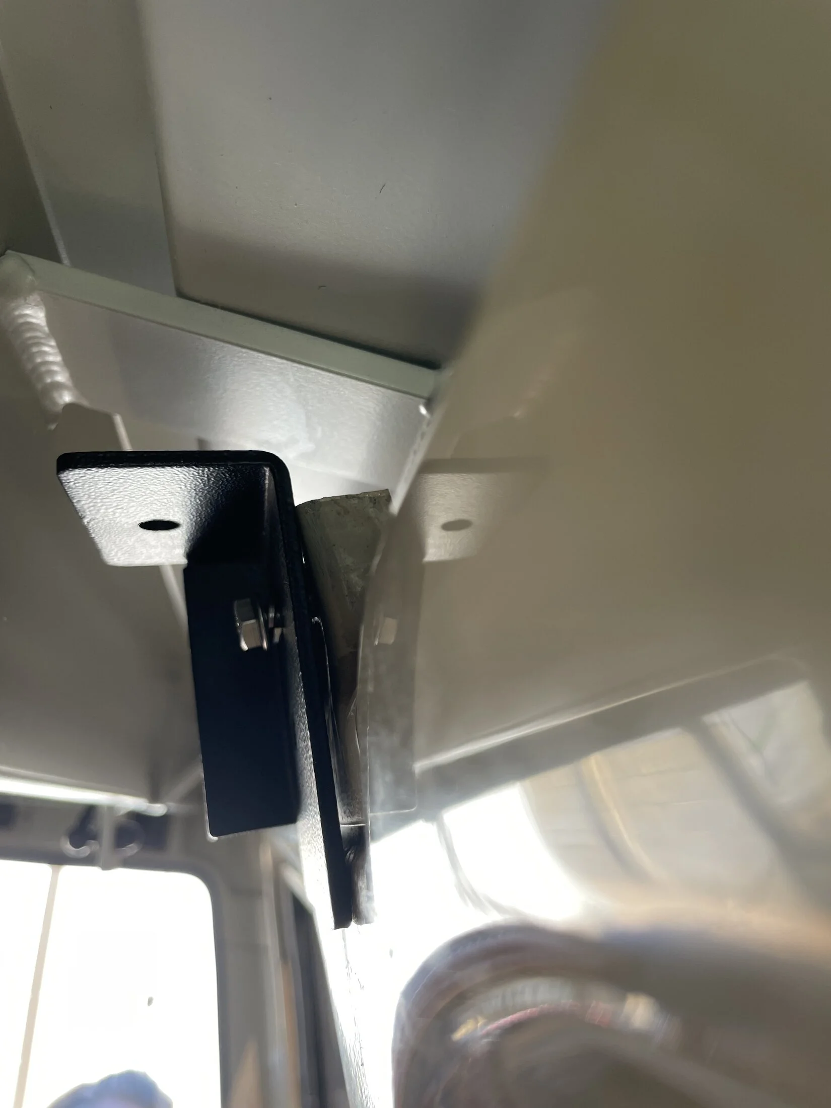

Yes, brackets on both sides of the truck. View attachment 3755627
