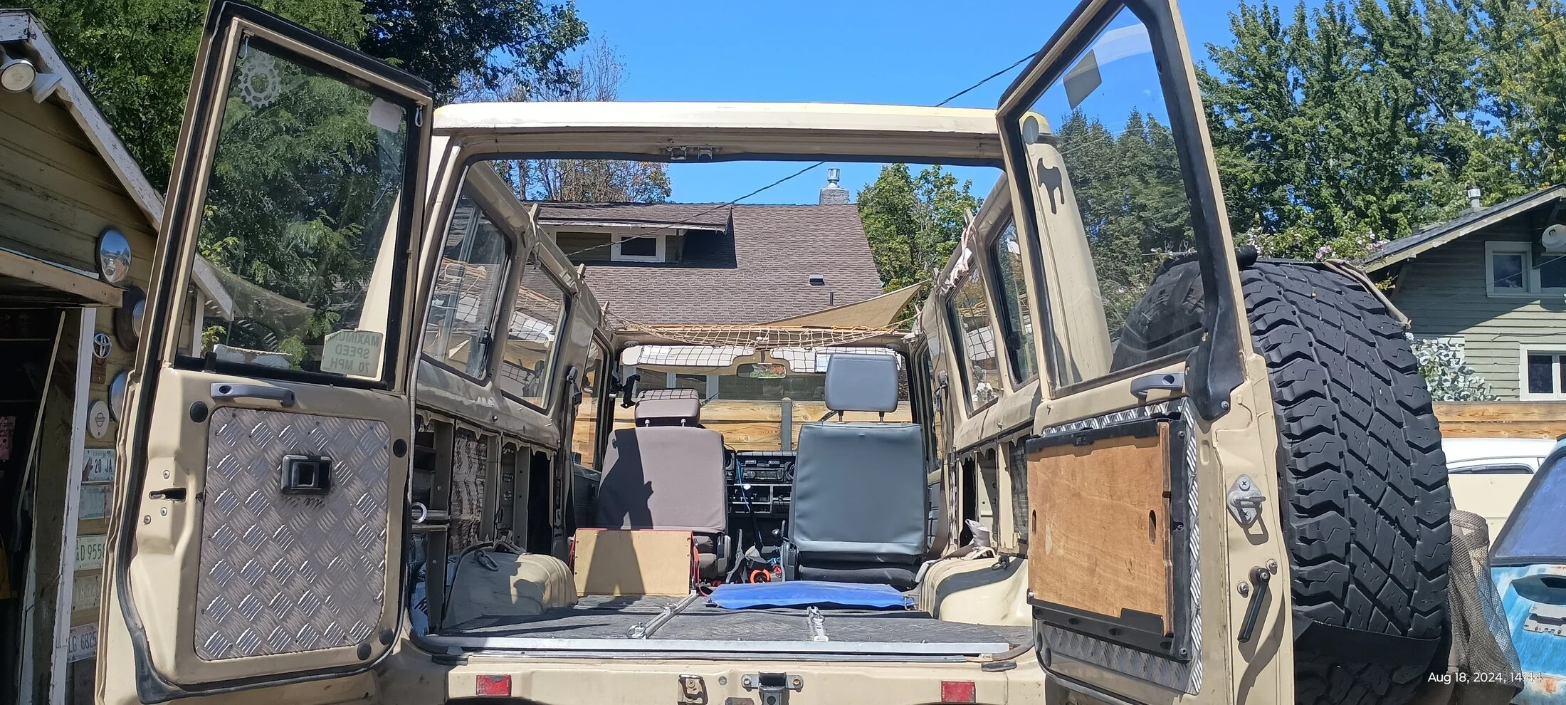

Removal of interior bows and tearing the headliner out.
Cutting the top of with some double-cuts mounted to a cordless drill.
Topless Troopy. I used a small pneumatic reciprocating saw for the corner cuts.

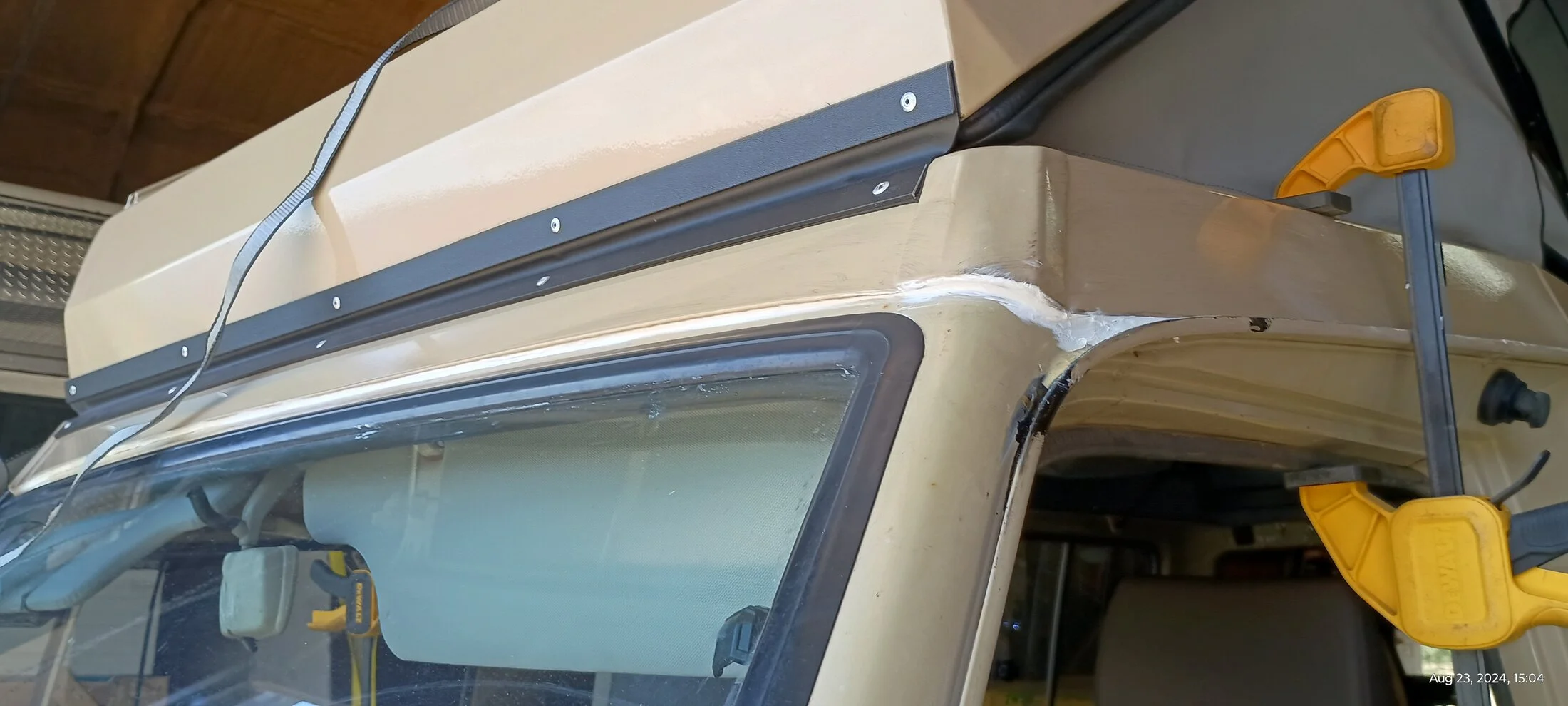

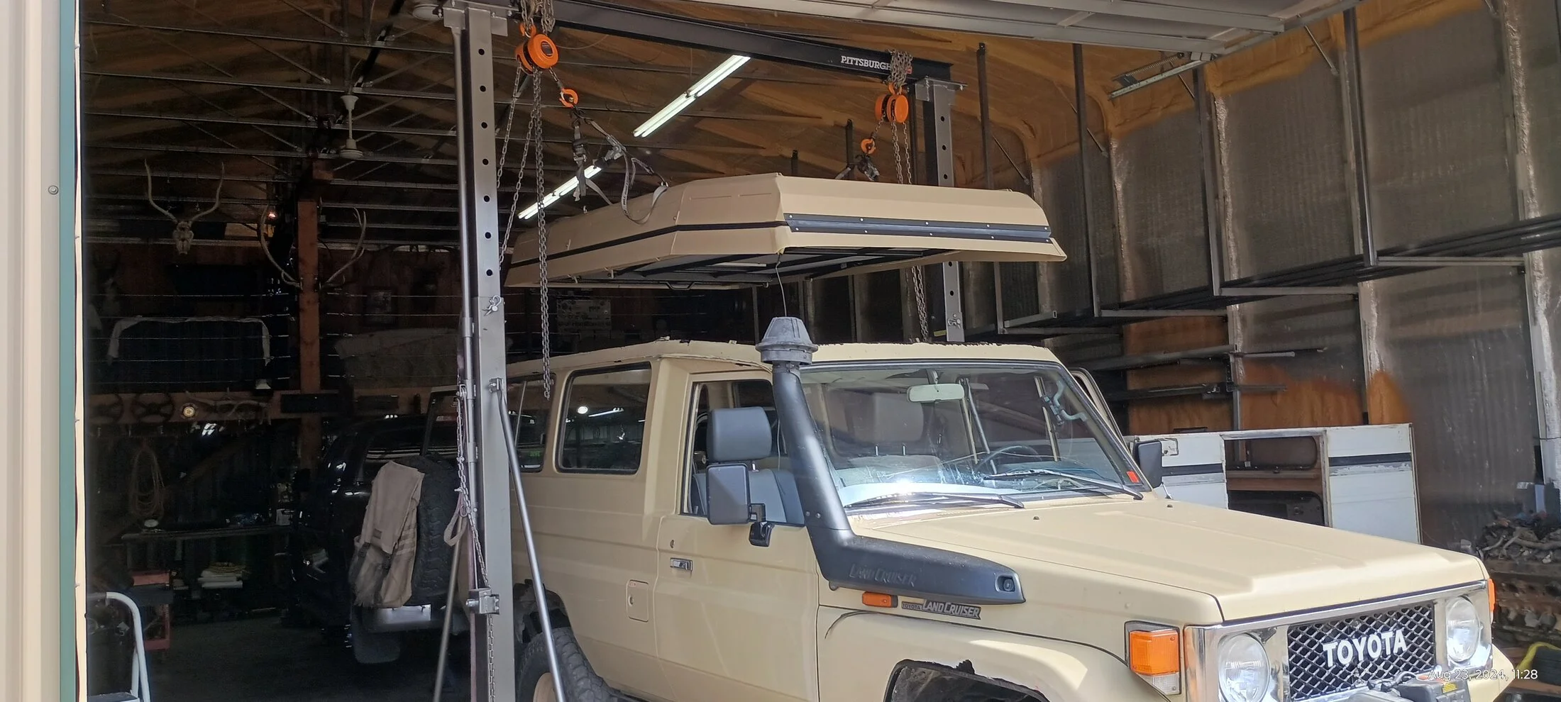

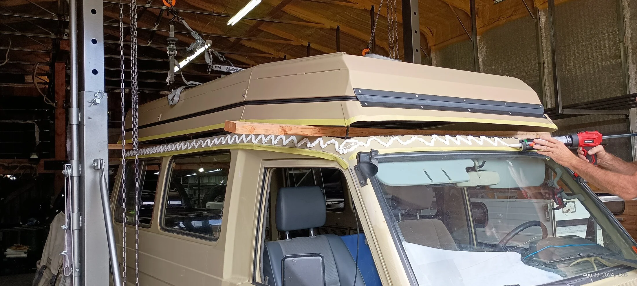

Test fitting. I had to remove my snorkel and pound the front right and left corners down a bit to close the gap up.
This is the referenced gap, filled with adhesive at this point.
Adhesive application using a cordless caulk gun. Note the tape on the gutter and top. Also the surfaces were sanded with some red scotch-brite pads and cleaned with acetone prior to taping and spooging.

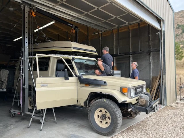

Setting it down on 2x4's keeps it from moving around while you're applying the adhesive.

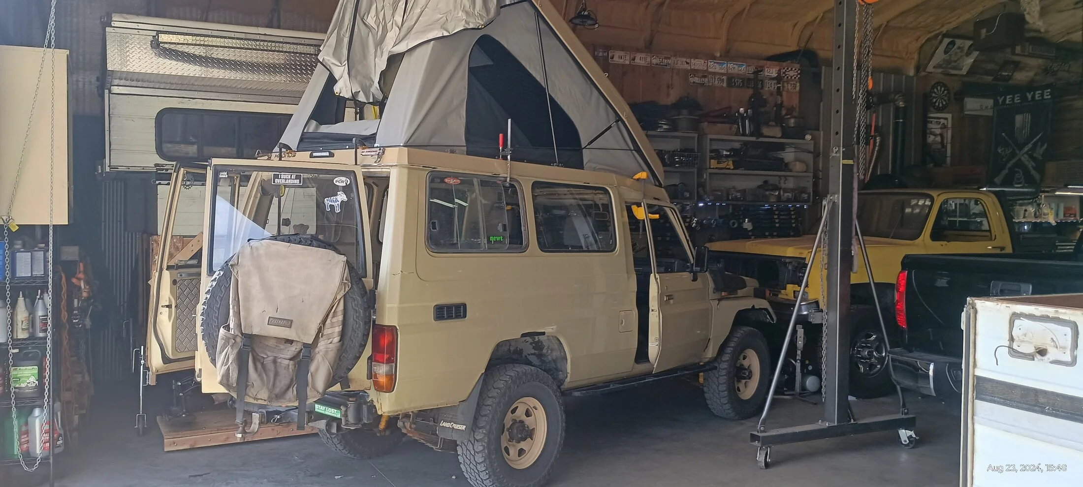

Parked out of the way and clamped for the adhesive to cure. Sikaflex data sheet says cure rate is 3mm/24hours at 23c and 50% relative humidity. I let it sit for 5-days.

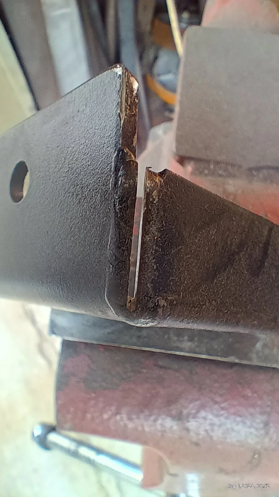

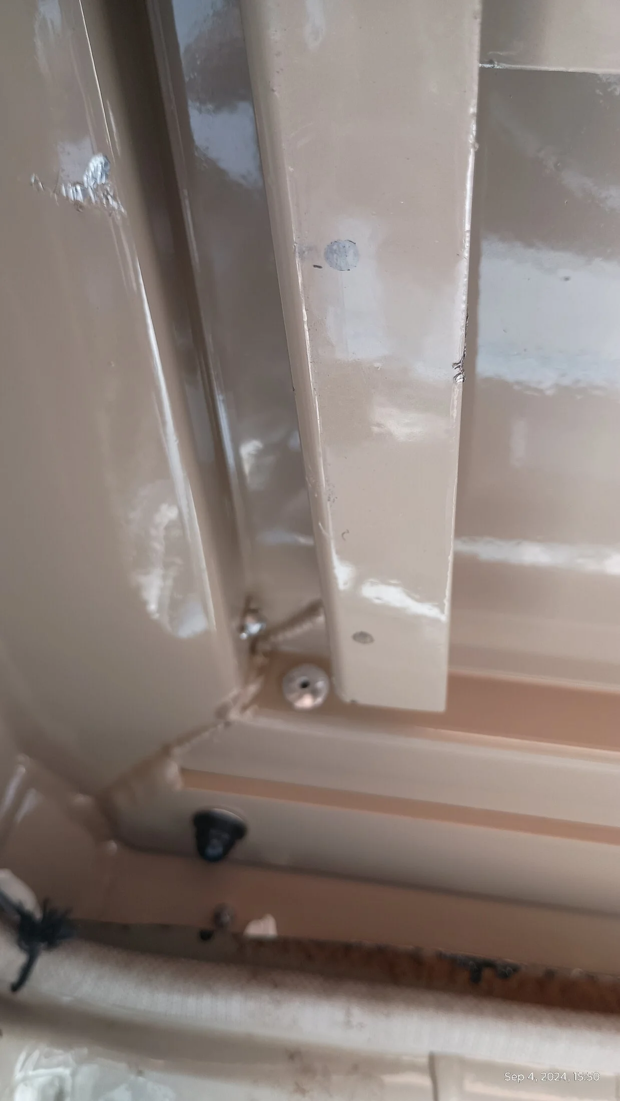

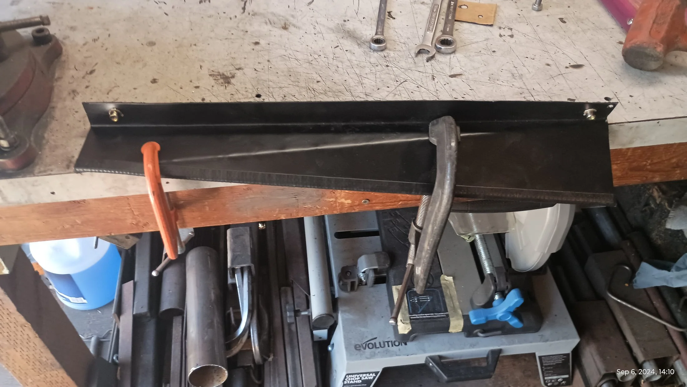

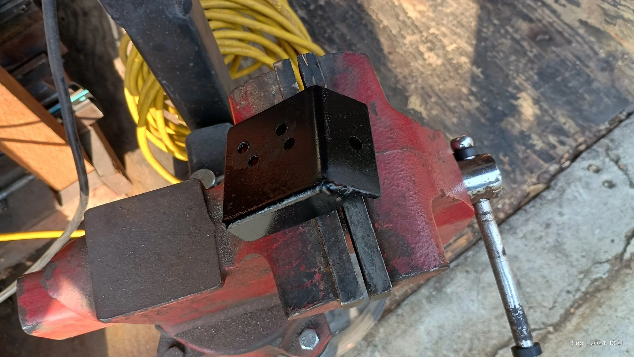

All the interior brackets that I received with my top required modification in order to get them installed.
I split one of the welds, opened up the 90 until it matched with the top brace, slotted the holes or redrilled completely new holes, some of them I cut the length down as well.
Once I got them to fit nicely, I marked the top's brace through the bracket hole and then drilled a hole in the brace for the bracket to bolt to.
Then I re-welded the corner I cut, cleaned and painted the bracket and installed it. This was as time consuming if not more time consuming than gluing the top on...
The last one that I installed, after I had cut all the other's down shorter, was too short to mate to both holes in the body, once I got it lined up to the top-brace, so it only has one hole bolted to the truck...🤷‍♂️

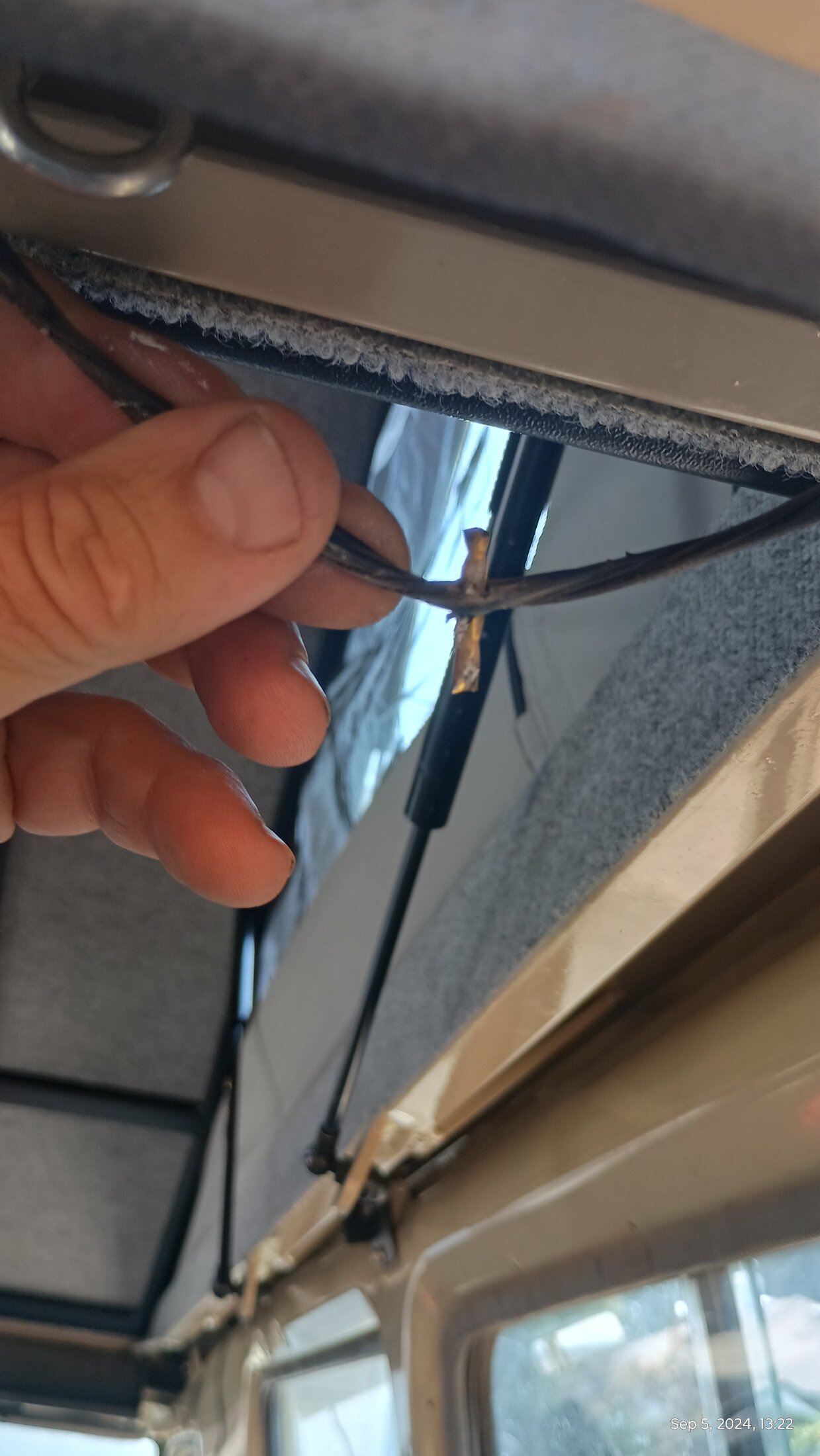

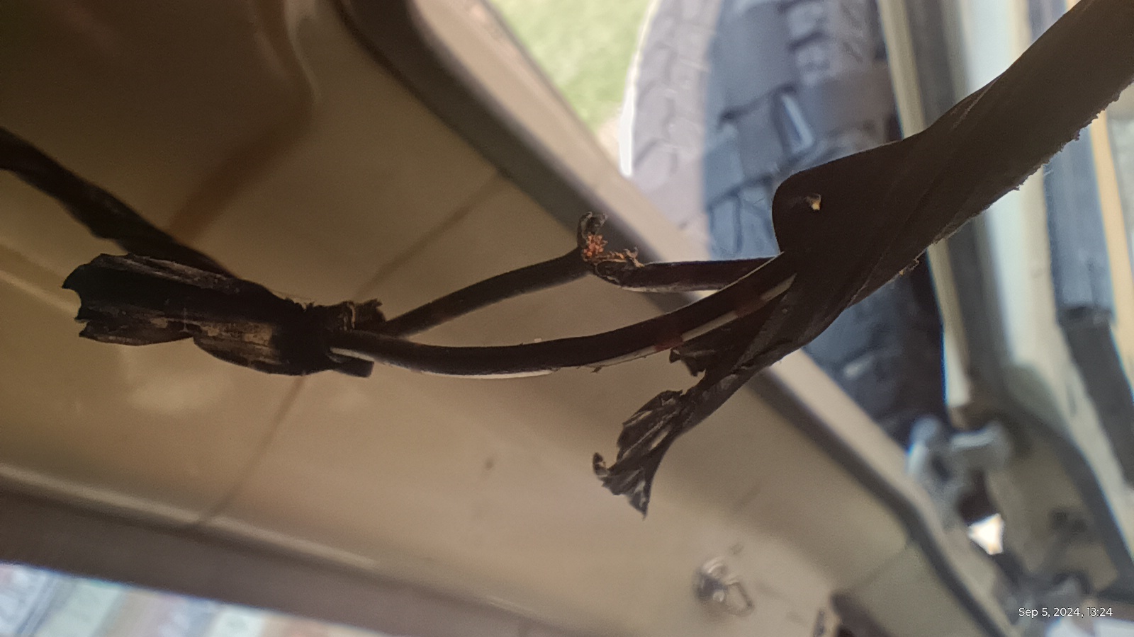

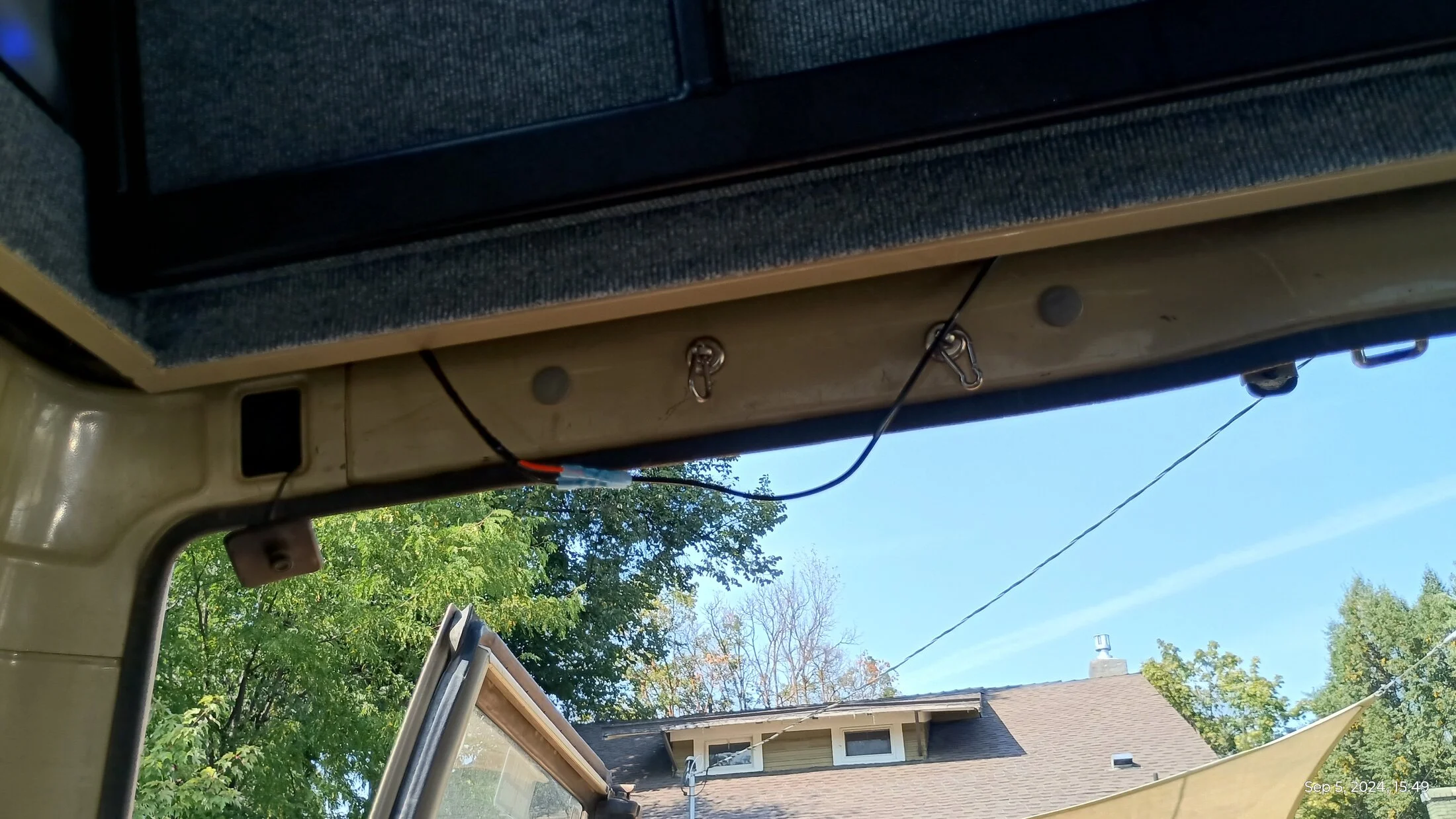

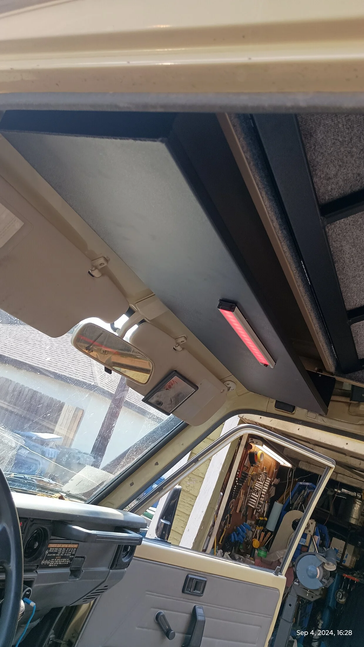

Next was wiring up power to the lights and usb ports. I have a 24v. truck, so I have a 12v house battery and fuse panel for my 12v. loads. I pulled a wire from my fuse panel which is up under the dash on the driver's side (LHD) along the wireway that runs under the passenger's side door scuff plate, and up the b-pillar to the the pigtail that the top comes with.
Grounded it to one of the bow-brackets.
googling told me that the blue wire is ground and brown wire is hot in Europe, so I went with that and it works, smoke-test was successful, nothing smells funny and no smoke.
The lights have white, amber and red. Cycles through in that order.

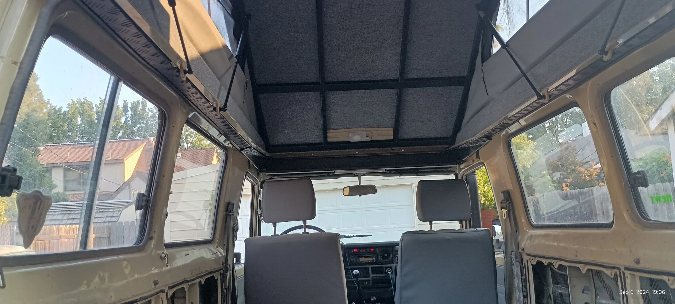

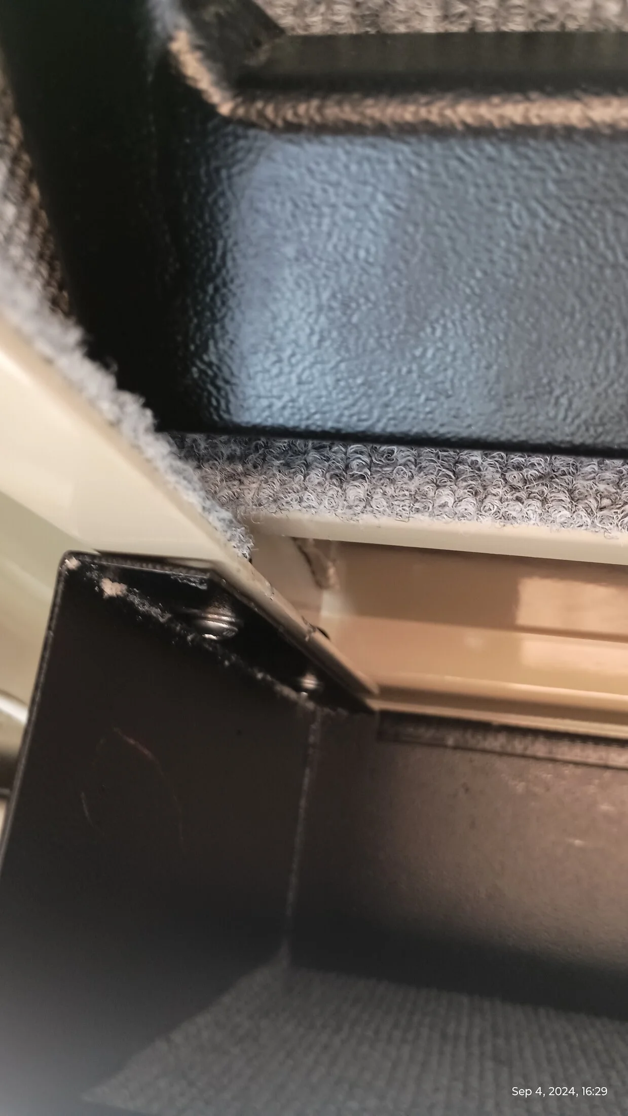

The top tapers in at the front, but the supplied shelf is square and mine came pre-drilled, so I clamped it in place, put it as far forward as possible, and centered it, then marked the aluminum angle with a pencil, removed the shelf, and drilled holes for the supplied hardware.
You really have to contort yourself to get a lot of this hardware installed...
This shelf should have a taper in it to match the top, it would make it a lot easier to line up and install. As it is, it's thin aluminium, so I was able to make it work.
Next was wiring up power to the lights and usb ports. I have a 24v. truck, so I have a 12v house battery and fuse panel for my 12v. loads. I pulled a wire from my fuse panel shich is up under the dash on the driver's side (LHD) along the wireway that runs under the passenger's side door scuff plate, and up the b-pillar to the the pigtail that the top comes with.
The lights have white, amber and red. Cycles through in that order.View attachment 3719331
I just tried to wire in my lights on mine, the OEM dome light wire didn't work well for me with this application. It also only turns on when the door is open, so no good for using the USB ports, etc at night.
I'm looking for a good spot to re-mount my OEM (led upgraded) dome light. I was thinking of mounting it to the b-pillar, but I'd need to cut a big hole for it to recess into. I might see if I can put it in the beauty strip on that side. Those things are flimsy.

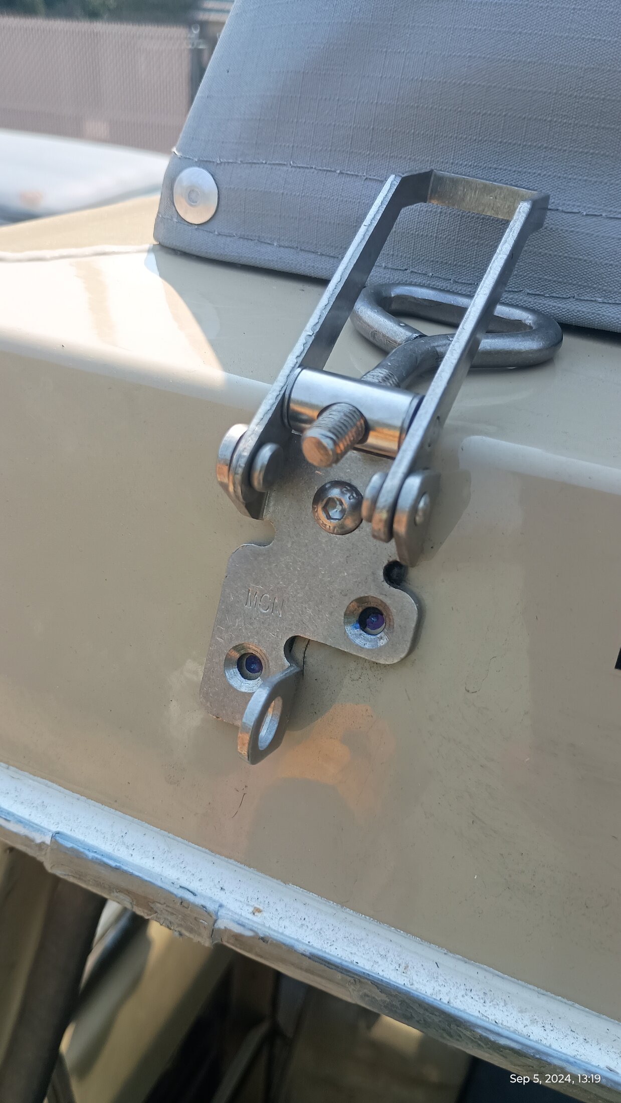

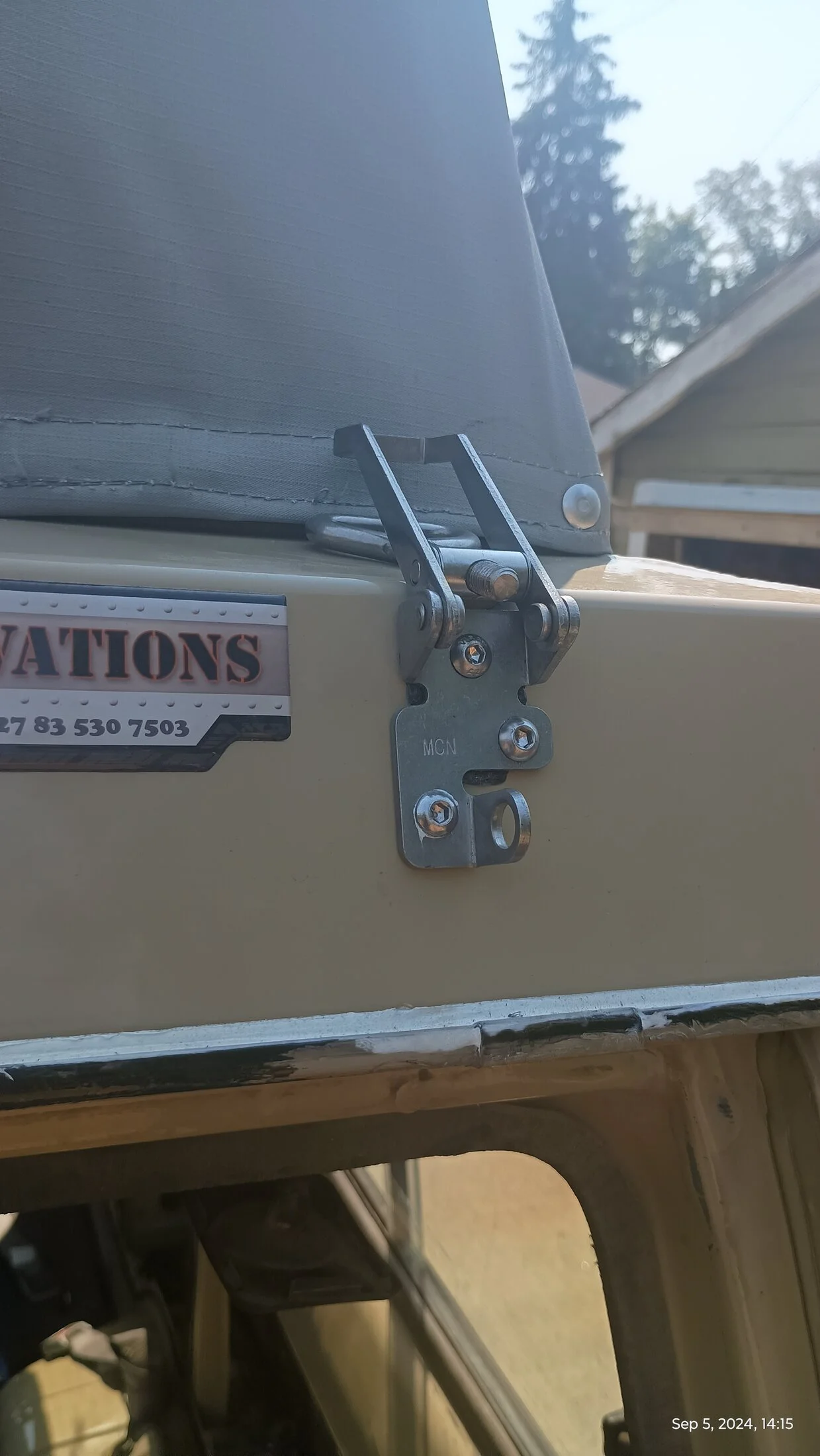

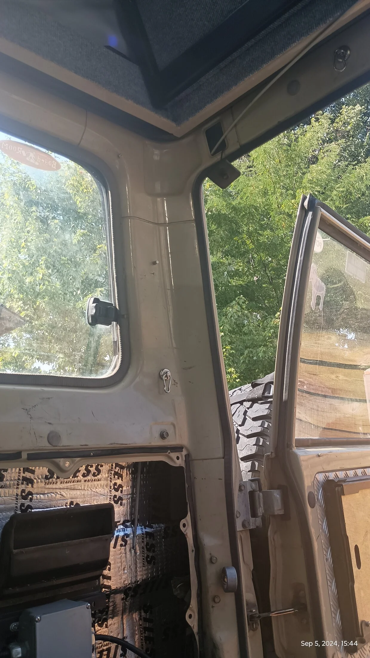

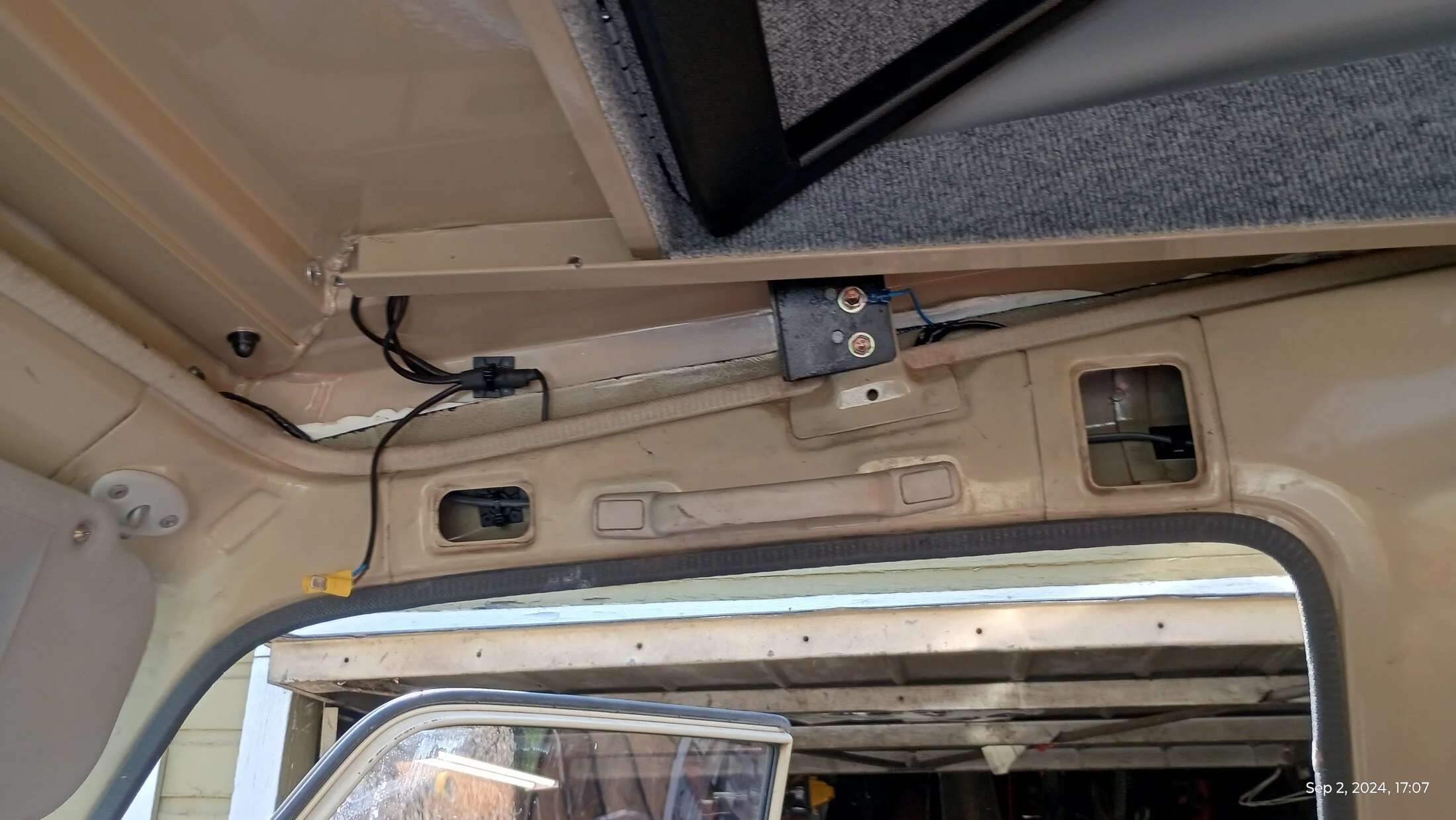

The latches that hold the top closed only have one bolt in each one when shipped as the two other bolts will interfere with installing the top.
So, once the top is installed, you drill holes through the new top and through part of what's left of your roof...there is absolutely no room to get a hand up inside to get a nut on those bolts. Somehow, I did manage, but it was a PIA! The frame that supports the bed on the inside is in the way.

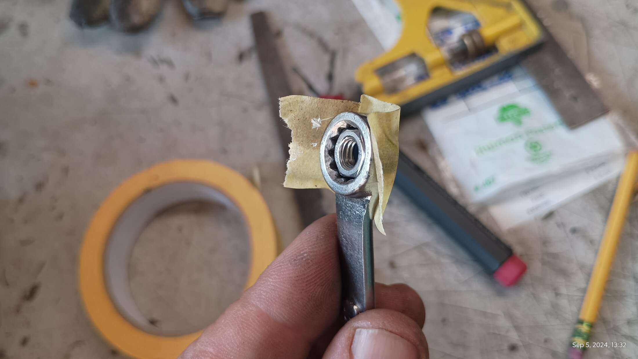

I taped a nut to a wrench and got 3 of them on, one was so close to the bottom seam, I could barely get the nut in the seam to get it started.
Probably should have put some sealant on the backside of the latches prior to bolting them down, but there's no way I'm taking them off again.

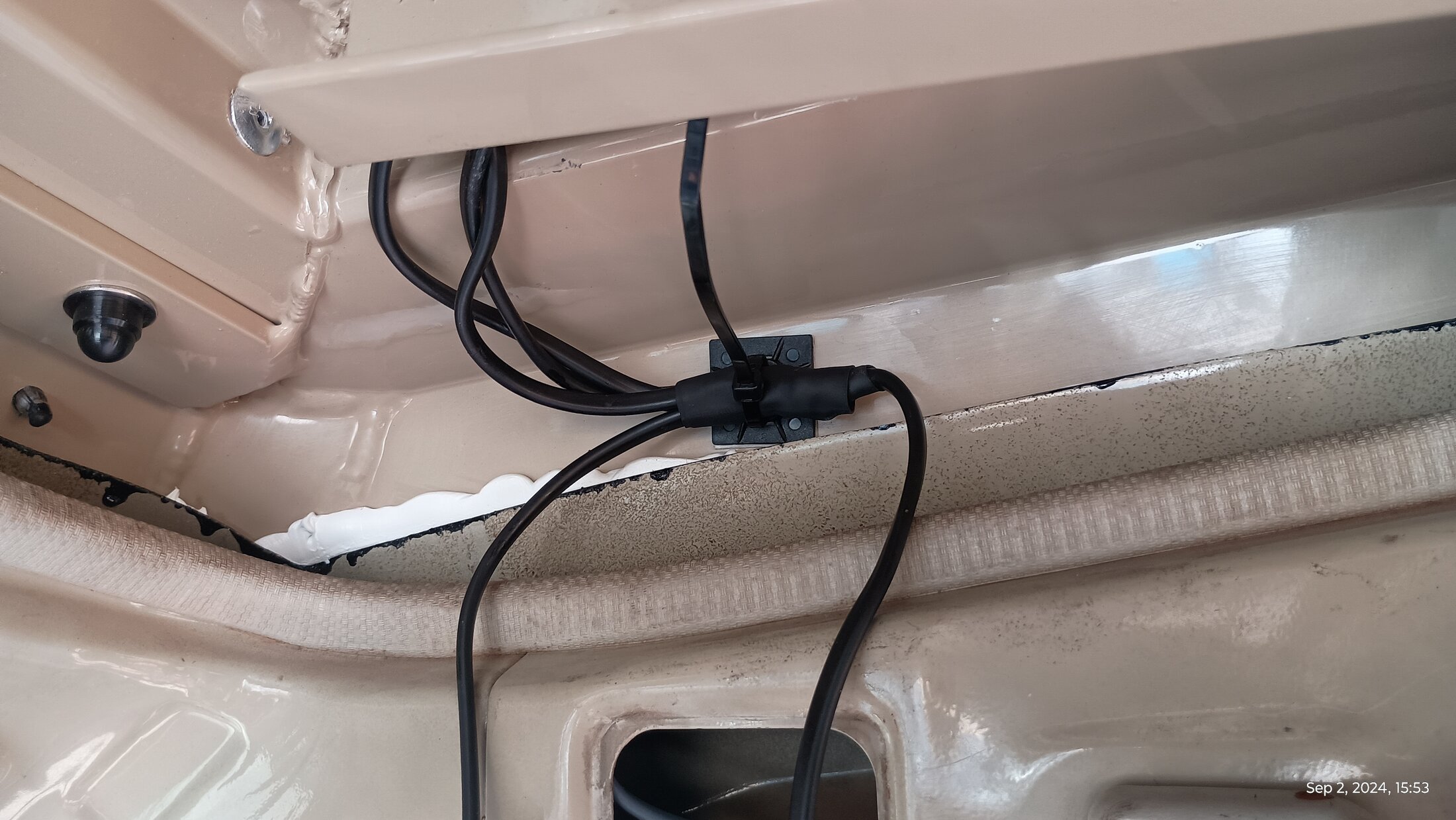

Oh, and the rear dome light wire runs right along that trough...of course I found it with my drill bit.
The latches that hold the top closed only have one bolt in each one when shipped as the two other bolts will interfere with installing the top. View attachment 3719534
Probably should have put some sealant on the backside of the latches prior to bolting them down, but there's no way I'm taking them off again.View attachment 3719536
Oh, and the rear dome light wire runs right along that trough...of course I found it with my drill bit.View attachment 3719533View attachment 3719532
Your rear latch is different than mine. Did you get the "tall" roof or the regular?
High roof.
I tapped into my trailer light converter output and ran a wire up to the third light.
I didn't want to risk a really short-lived bright light, then nothing, using the truck's 24v feed.
You have the same latches at me I just never put any more screws in mine 🤣
Suppose I should get on that now.
I'd just put the upper two bolts in to start, that lower one is a bitch to get a nut onto. Or, my backup plan if I couldn't get a nut started, was to pull the whole thing off and put a nutsert in the lower spot.
I'm probably going to put rivnuts in for this!

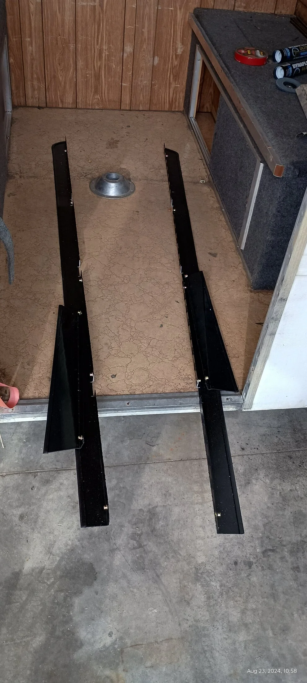

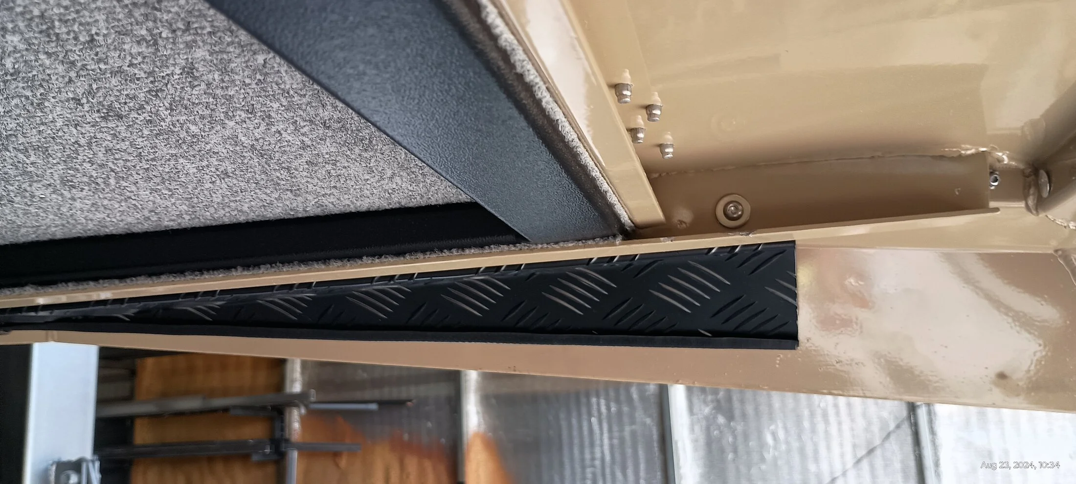

Last bit for the install was the beauty strips that close off the gap along the bed support frame and the side of the truck.
I had to remove the shelf on the passenger's side to get the front piece installed, there was some 'massaging' of the bends also...
