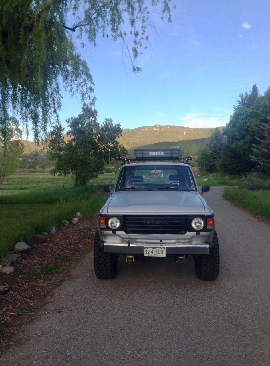

You know what my vote is... Black it out!! I love the contrast. Mine has never chipped, I used plasty dip (Not the best of finishes) but the rubberized coating has really held up against chipping. One thing is it doesn't clean off as well as other painted surfaces, but I have had no issues cleaning it. Mine has held up for 5 years now, I am just about to redo it due to the chrome bubbling up under in some spots... My grill was a little beat up when I got it so I didn't feel bad about painting over it. But we are talking about 5 years in the elements with no garage... I think that's pretty great for no real prep. I really like what @Jasonredwood recently did with his grill. Turned out great! It's just a couple of pages back on the "What did you do with your 60 this weekends"
5 Years ago (Clean)
Couple Months ago (Little dirty)
You know what my vote is... Black it out!! I love the contrast. Mine has never chipped, I used plasty dip (Not the best of finished) but the rubberized coating has really held up against chipping. One thing is it doesn't clean off as well as other painted surfaces, but I have had no issues cleaning it. Mine has held up for 5 years now, I am just about to redo it due to the chrome bubbling up under in some spots... My grill was a little beat up when I got it so I didn't feel bad about painting over it. But we are talking about 5 years in the elements with no garage... I think that's pretty great for no real prep. I really like what @Jasonredwood recently did with his grill. Turned out great! It's just a couple of pages back on the "What did you do with your 60 this weekends"
5 Years ago (Clean)
