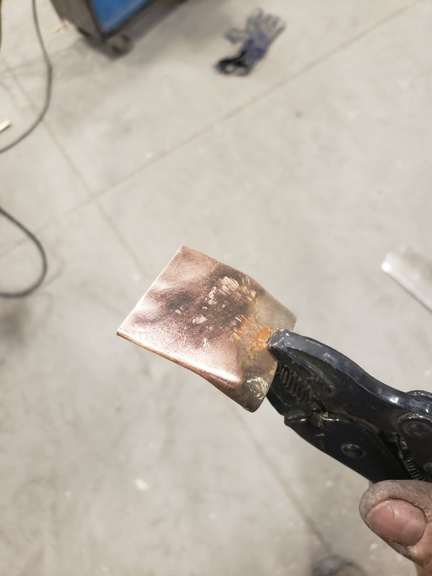

Finally making some headway. I welded in the patches to close off the fender vents. I tacked from the outside then welded from the inside. Still have grinding and cleanup but went well. Also closed off the holes for the rocker trim strip. I used a piece of smashed flat copper pipe as a backer and welded it shut. The weld won't stick to the copper but gives a base for a large hole for easy fill in. Hopefully tomorrow I can get the grinding done and maybe even powder coat some pieces with white.

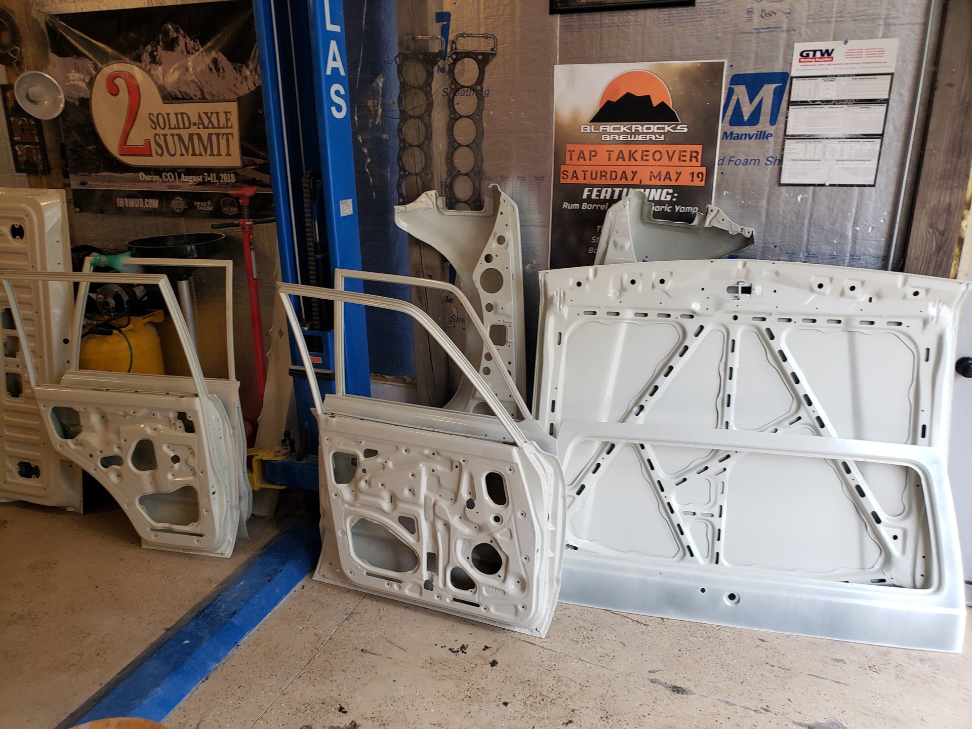

The sandblast, seam seal, epoxy powder coat, and white base powder coat is finally done on all the body parts. Just brought everything home to do final bodywork and prep for paint. I REALLY want to be done with paint before April but not looking good with a week to go.
Everything got a hot iron phosphate wash on the bare metal, then zinc epoxy powder coating, then a color matched white on the inside of all panels. The outside gets the same paint as the body.

Wow! The hood looks especially amazing!
I thought it was a good hood when I got it.
Did those lower/outer corners on the front doors clean up okay?
Yeah the hood is nearly perfect. I used the original doors from Chunk. The replacements had a little rust and the passenger one had previously been bondo'd up. I clamped vise grips on the bottom of the door where it was smashed upward and beat them down with a bfh, pulling the metal back down. Then I made a tool to fit in the door and drive the seam back down from the inside. Should have taken some pictures of that but it went well.

That’s a killer paint prep process you’re doing. That’s going to be super durable and look great for years.
Baking everything in the PC oven probably cooks a bunch of moisture out too.
I'm hoping it helps, it definitely should. It's an odd thing for me because this is the cheaper way out since I am set up for powder coating. I am kind of thinking it through as I go because I haven't done it before.

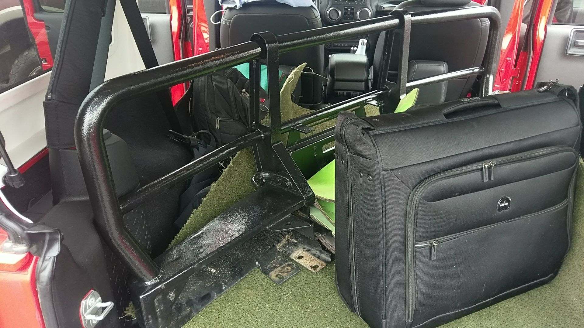

And in other news: My long search for an old style arb bumper is coming to a close. Mud member @Ian Crawford sold me his bumper off of his 60. It needs a little work but not too bad. It will have a spa day at the powder coat shop. My buddy Pete (who went with me to get Chunk in CO) picked it up for me in Louisville. Of all things, it is riding around in the back of a Jeep Wrangler! Hope it doesn't get Cooties. I am meeting Pete later this week for the dinner/beer payoff for hauling it for me.
Thanks Ian and Pete for the help!
