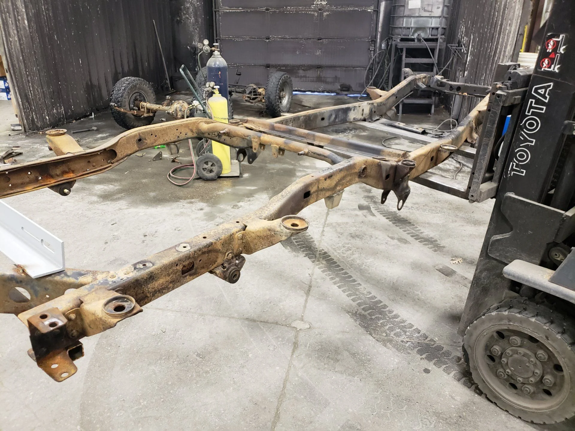

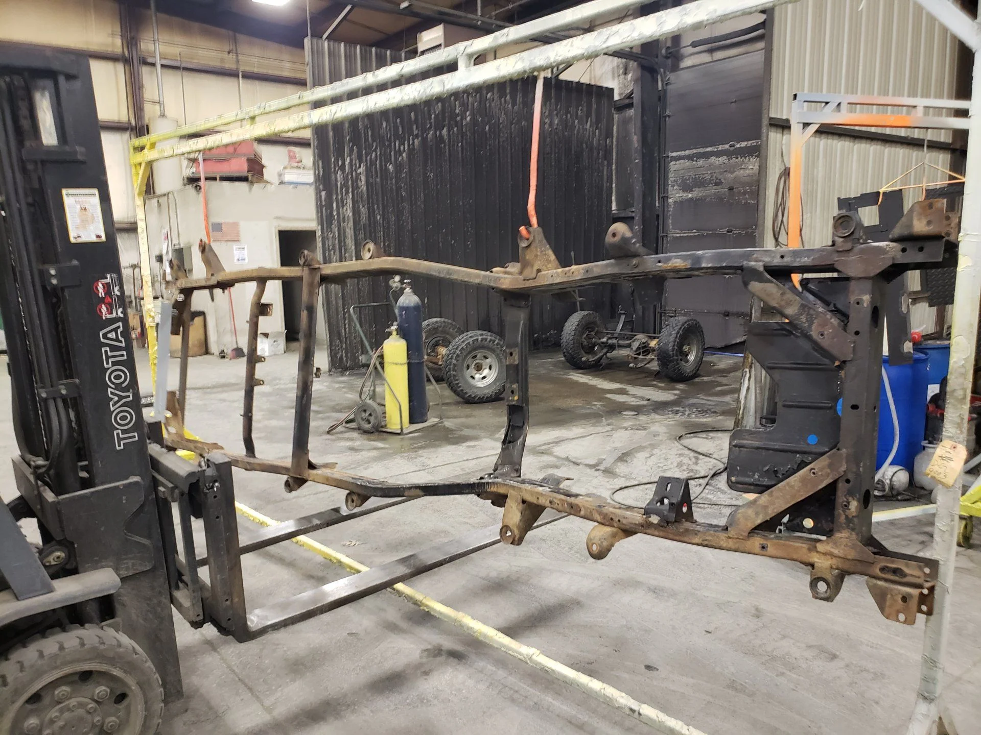

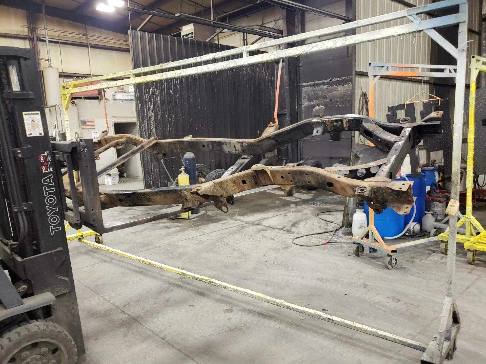

I finally got a minute to work on the frame some after work. I had started to remove the axles and today got them free and the frame hanging on a powder coat rack so I can finish pulling bits apart.

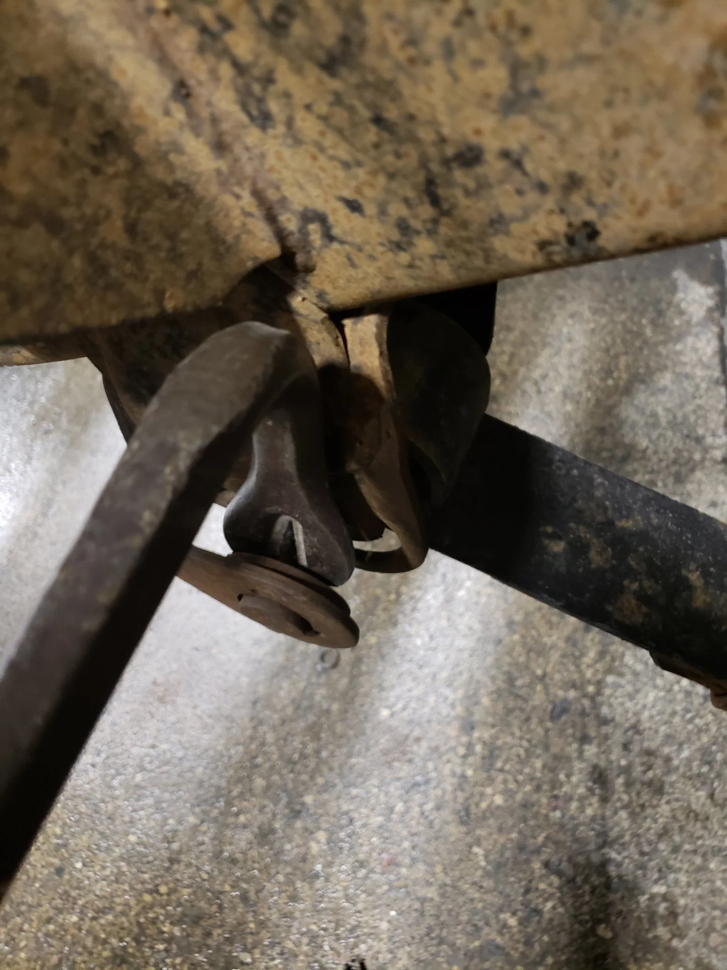

Everything came apart pretty easily. The steering stabilizer mount has a broken bolt and was tack welded on. No biggie, zipped the weld off with the torches. A couple pins were stubborn but a big crowbar made short work of it.
