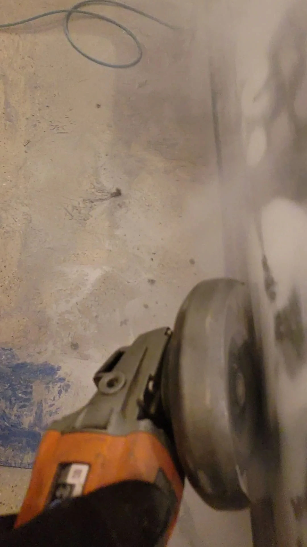

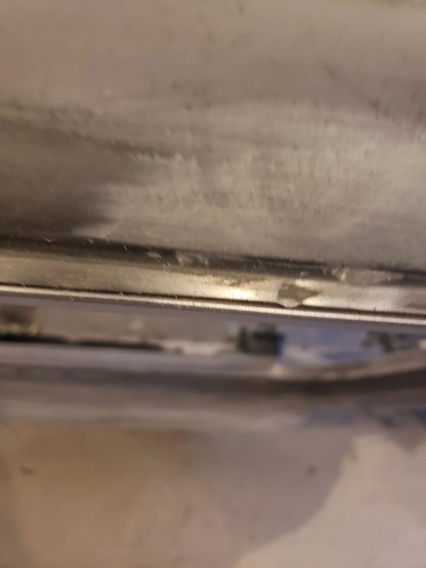

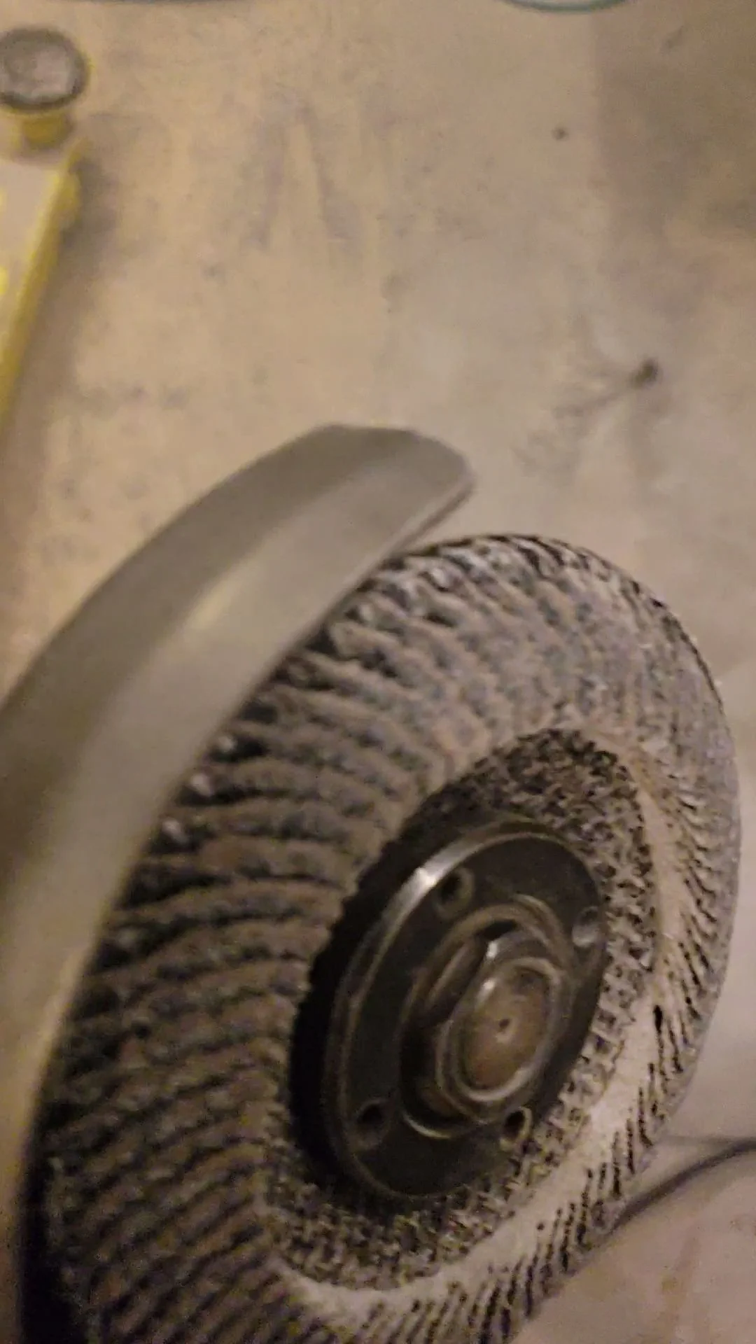

Another round of smoky seam sealer removal. I'm so happy with how well this works. After the flap wheel, a good running over with a wire brush attachment makes the drip rail nice and clean.
After that I sanded more and prepped more. Enjoyed getting a couple hours on Chunk. Now time to clean up and have a fun evening with my family!

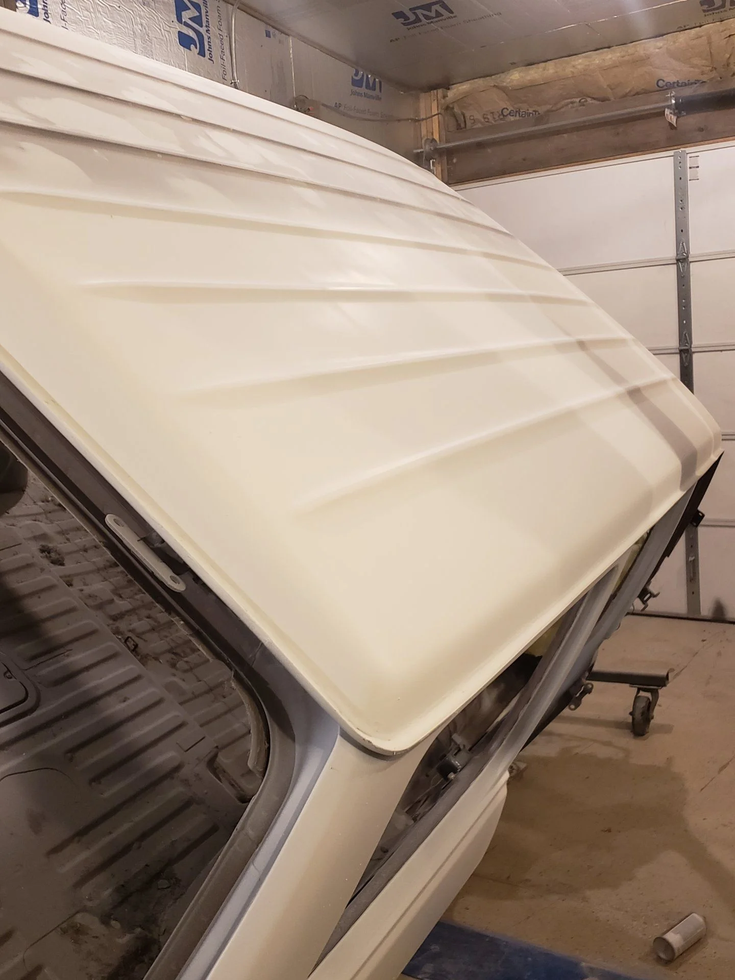

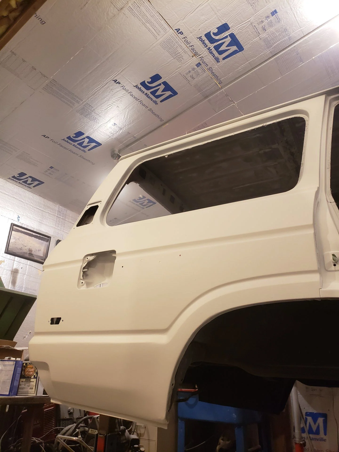

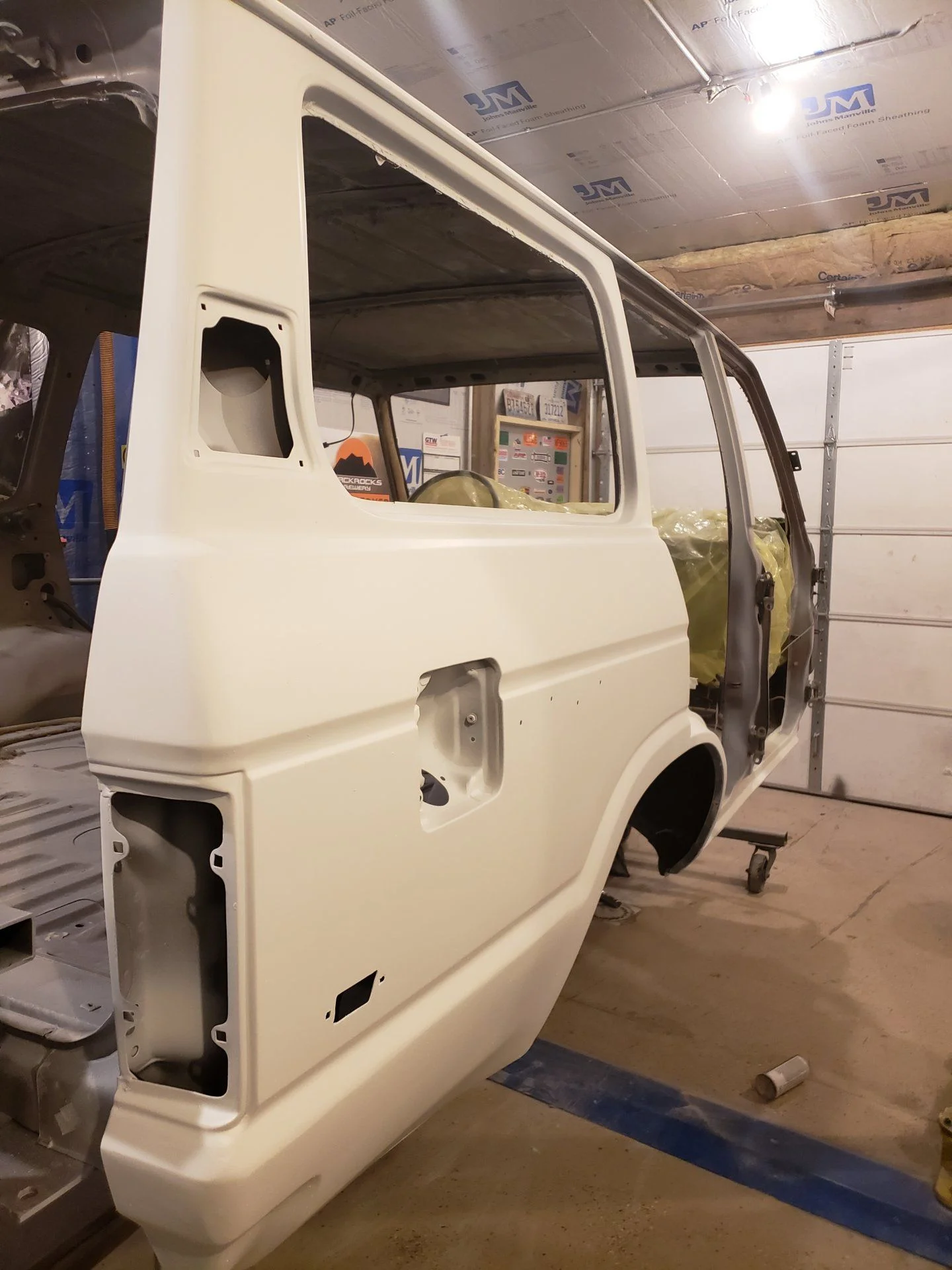

Work progresses, not as fast as I'd like, but it is what it is. Got the right side primed tonight. It is by far the worst so good to knock it out first. I see lots I like laying down primer and a few things I don't but hopefully they aren't too tough to remedy. Hopefully the weekend/holiday affords some more hours on the truck.

Nice Pat. Love the primed look!!! Great progress. Retro stripes all the way baby! What wa the ambient temp when you hit primer?
I have my stat set at 63°. Seems warmer then that in there tho. I heat it with my amateur built (me) infloor radiant from my outside wood boiler.

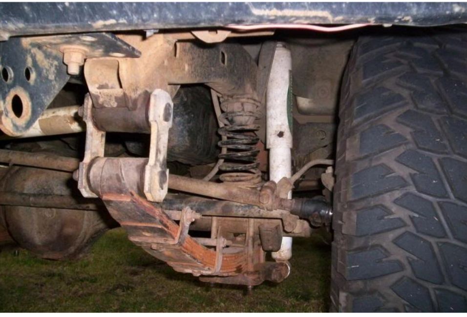

Nice! I'm not the only nut out there. But did they use genuine OEM Kia Rio junkyard rear coils? . I did this before I got my Tough Dog lift, seriously not a bad option to get back some height and add stiffness on the cheap!

Kia is the official supplier to Mr T for the leaf sprung coil assist conversion kit anyway, right?

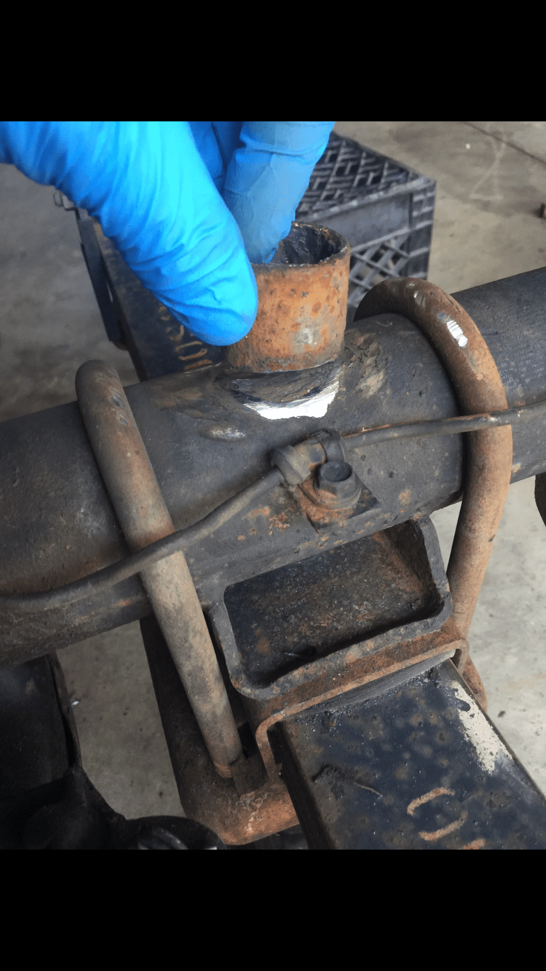

What actually kept the springs in place? Seems like it would be easy to spit out with just those short chunks of pipe on the axle.
I heated up the bottom coil to take the temper out of it, bent it flat and welded it to the spring perch on the axle just outboard of where the U bolts go. I put probably 20k miles on it, and plenty of wheeling that way. It took my front end from riding 1/4" off the bumpstops to 2". I'll see if I can dig up any pictures from my old phone. I didn't have any pipe nubbins.

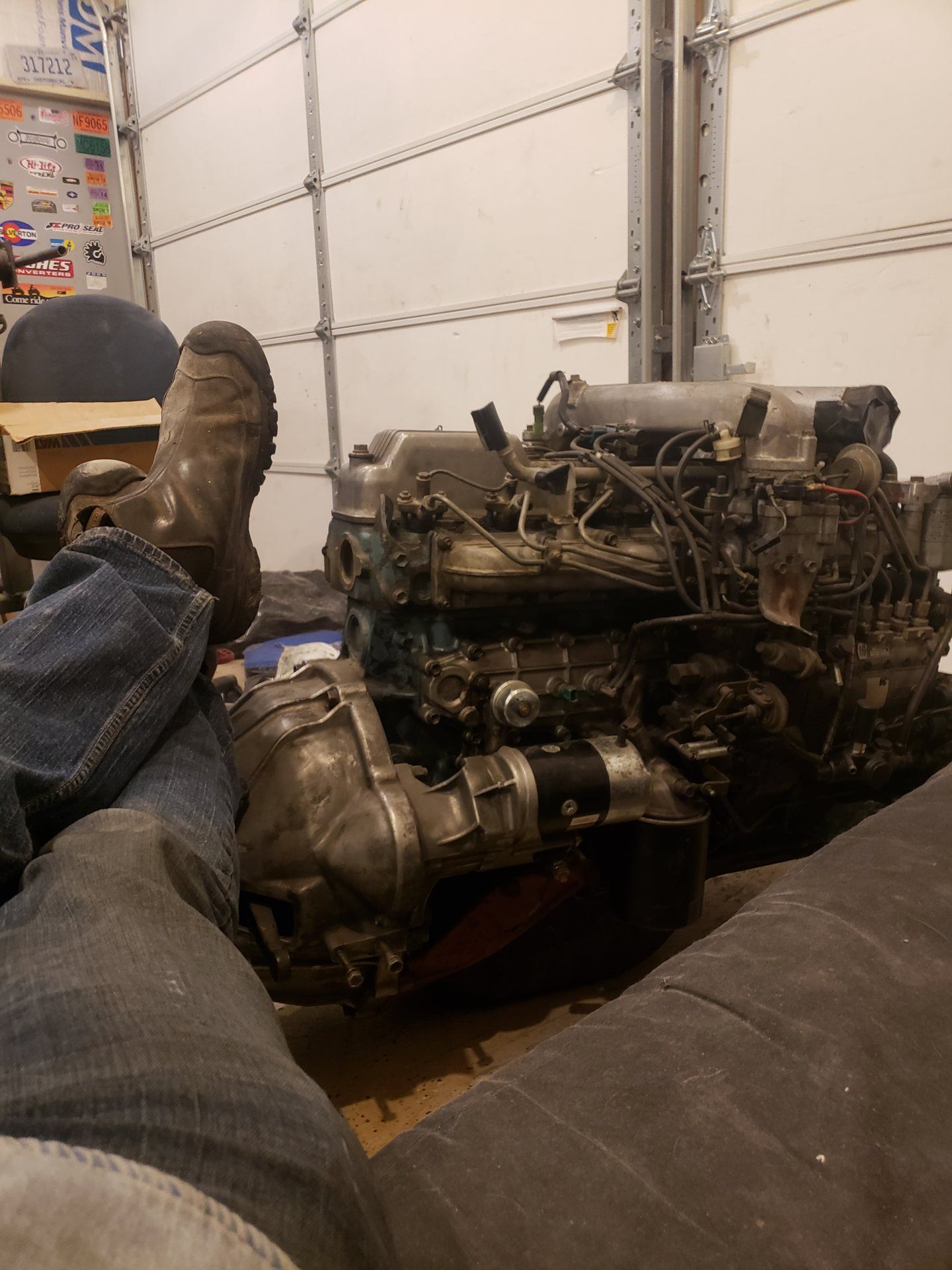

Bummer for me because my home shop is tiny but I brought the 12H-T home because work is so stupid busy that I have to make all the space I can there. Just have to make do. She makes a sweet foot stool. I think I'd rather sit and look at this than a TV anyway.
Coffee table....... I likey!
