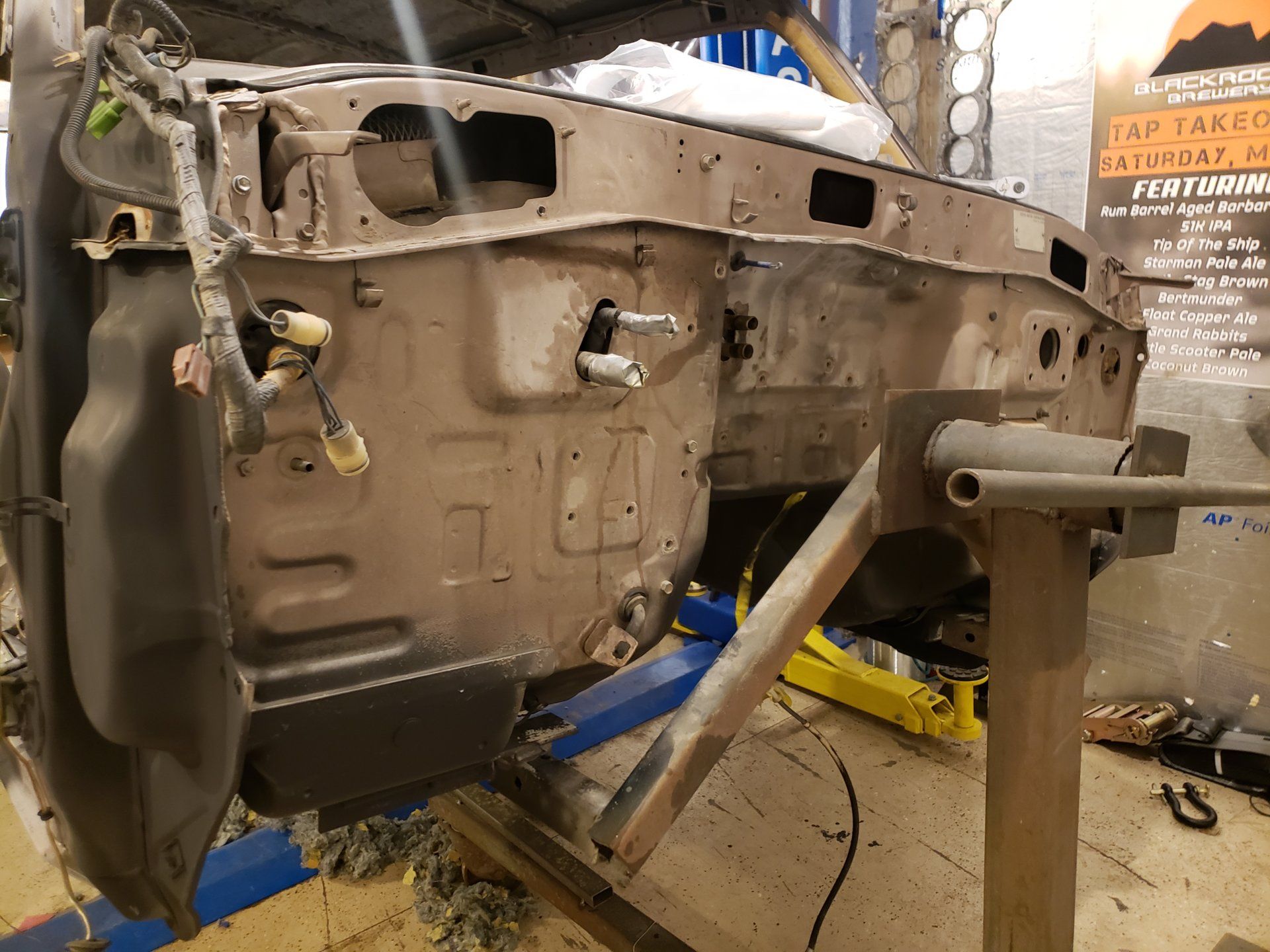

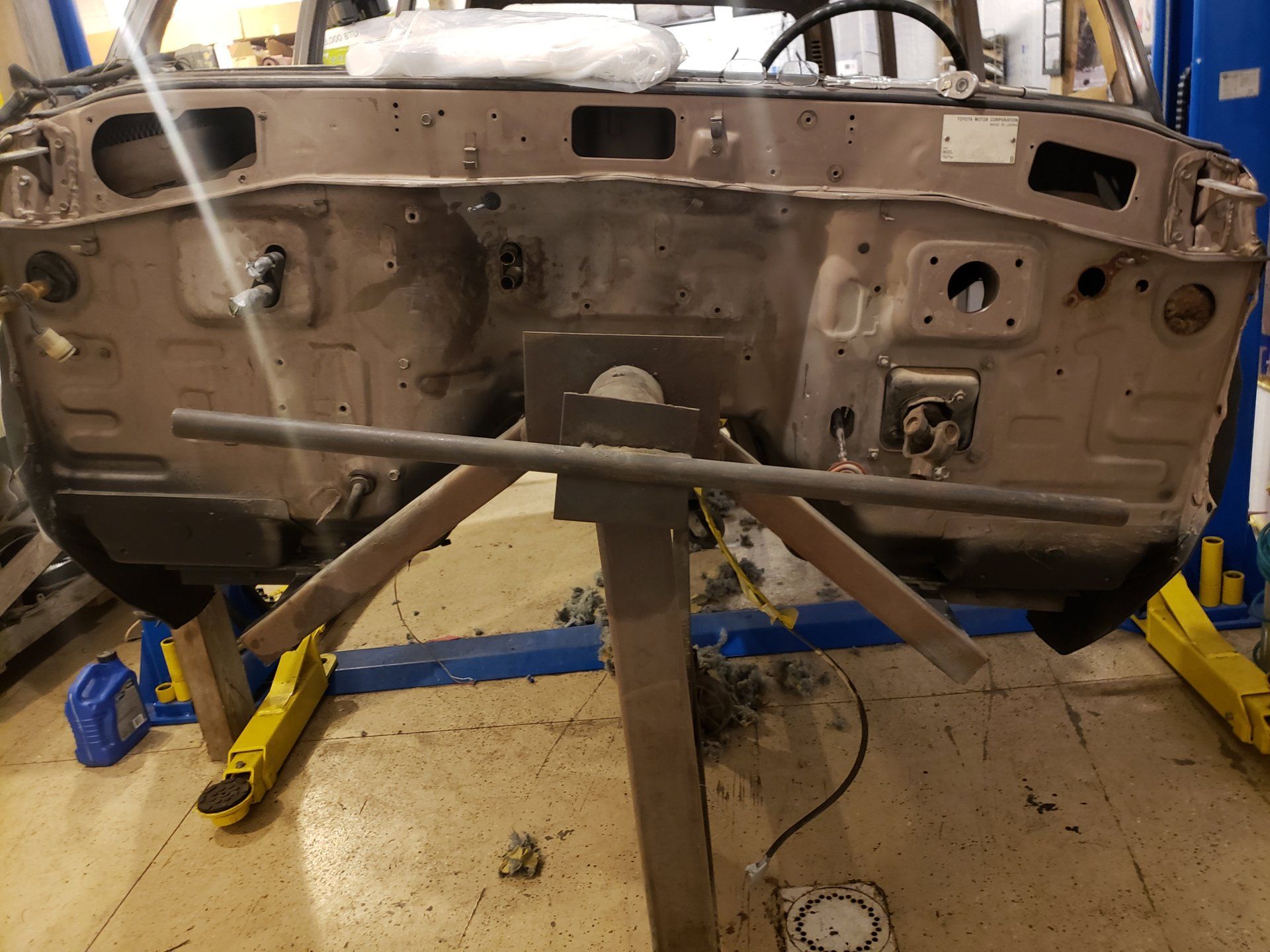

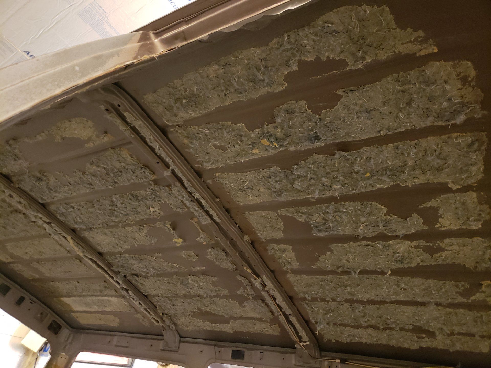

I got the firewall stripped tonight and ready to clean and prep for paint. Also I worked on getting the insulation off of the bottom of the roof. I scraped most of the fluff off but need to nix the glue. I think I will try some Krud Kutter or Goo Gone. That is tough stuff. It's great on that rotisserie because I can roll the truck almost all the way over and stand in the window and door openings and not work overhead.
View attachment 1845344 View attachment 1845345 View attachment 1845350 View attachment 1845352
I wire brushed it till the base glue. (so not to bare metal) Then Painted the glue layer. After that some degreasing, isolation mats Reckon and armaflex (europe products).
Pretty much got the inside of the roof stripped of that wicked headliner pad glue. "Gorilla Glue" needs to change its slogan to "The SECOND toughest glue on planet earth". I got it with some super nasty paint stripper.
The roof has its fair share of little hail dents. Not big ones but lots of them. With the inside smooth I can see/feel them and push the dents out easily. Don't even need a hammer, just the slightly curved face of a 1/2" extension and a little push seems to work well. Nice bonus is after a quick spray paint guide coat sanding the inside with a DA, the dents show up easily.

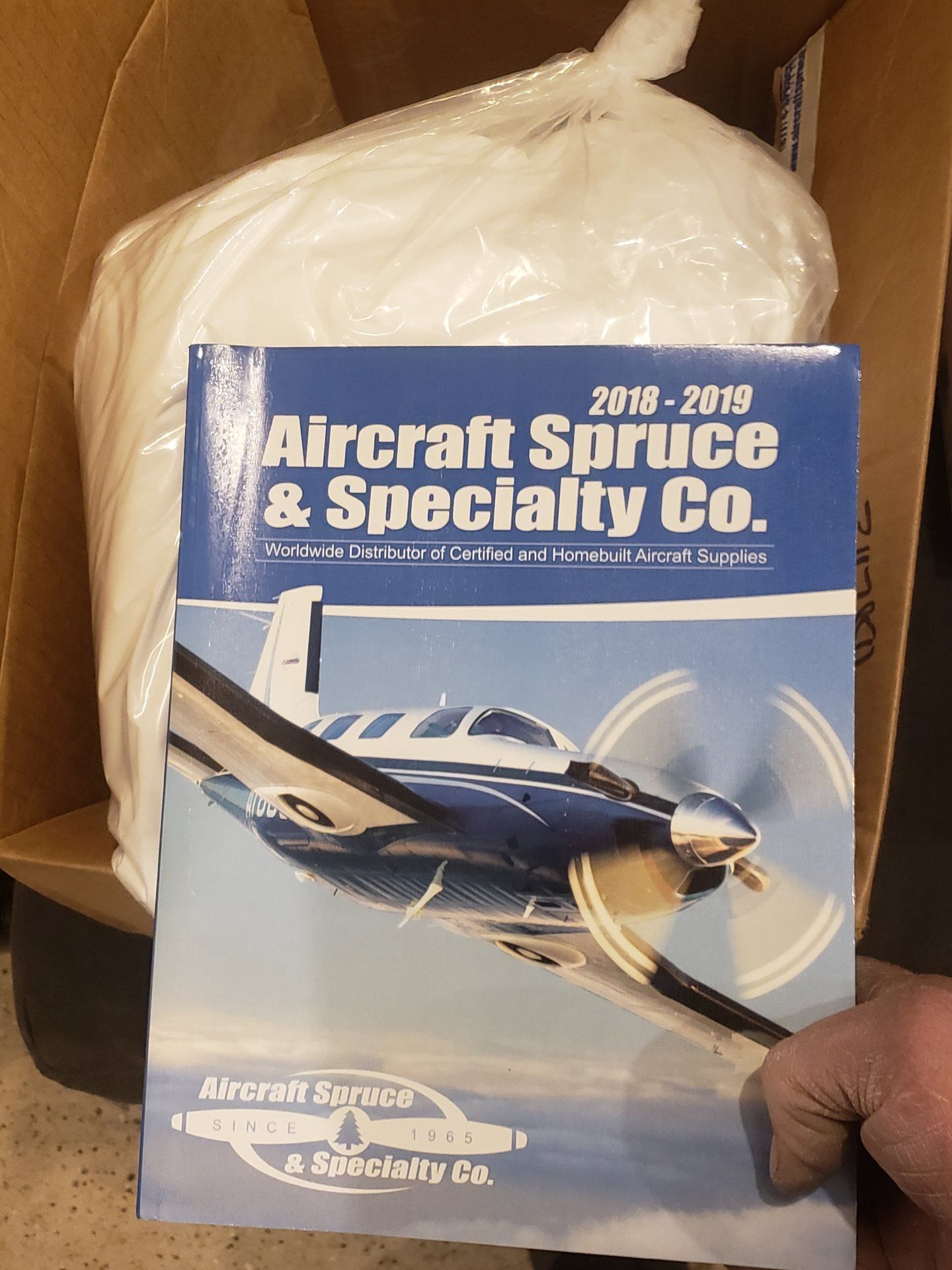

#1- My 3m glass spheres for the liner. I read some plus and minus things on diy insulation. One of the sites said I had to get a certain type (k20 in this case) to have insulation properties. Lucky for me, that's what I bought. Still a maybe but nothing ventured, nothing gained.

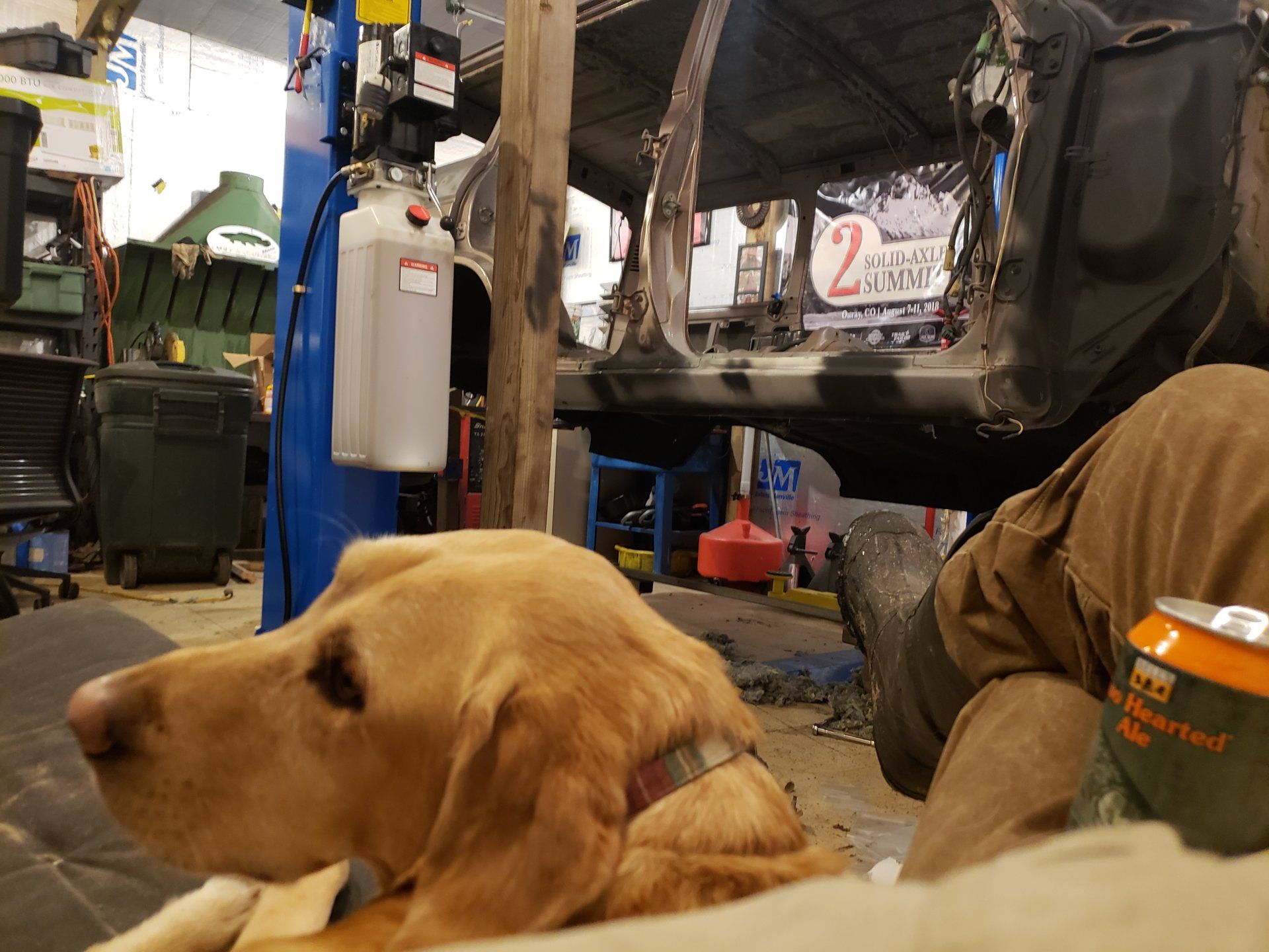

And of course, the whole time I'm busting my arse sanding, Buddy remains ever vigilant
Aaaand,

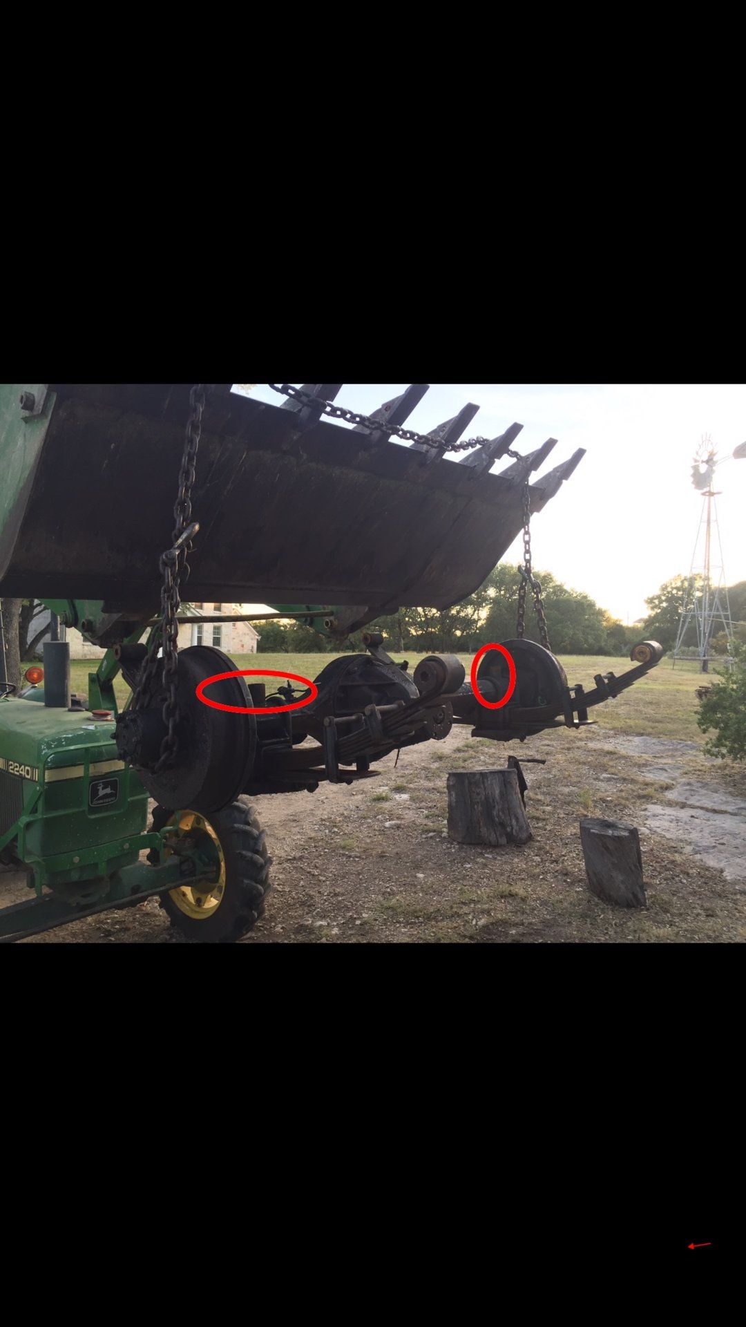

This set of cable locked axles just might end up under Chunk;)
Does it come with the interior controls?
That little bit I can see of that bed looks pretty nice too.
Yes, I am getting the controls with them too. They are still overseas, getting crated and shipped in the next month. They have those wierd little rings welded on the tops for springs or something but they will get cut off. I'm planning on going through them to make sure all is good and reseal them plus refinish the outsides. It's a tough pill to swallow expense wise but the truck on the whole is so far staying on or under budget so I am going for it.
I wish that box next to them was mine!
Cool. Good find and even better with the controls. This truck is really going to be something nice.
Funny, it looks like exhaust tubing. I wondered if it was for some sort of overload spring or home brew bump stop.
