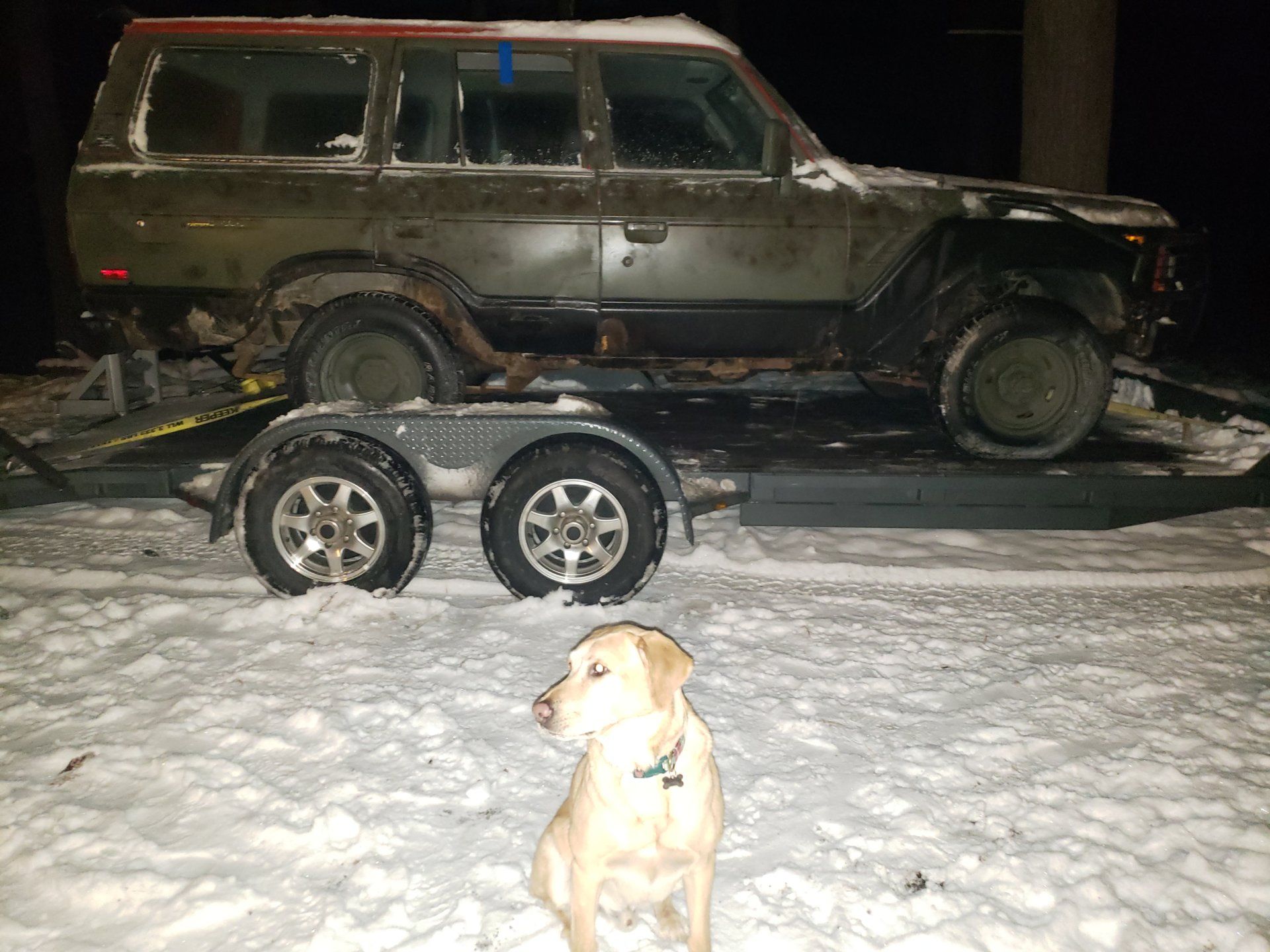

I also brought home a parts 62 for some items for Chunk. Some interior bits since it's grey, mirrors, air cleaner for the diesel, fan shroud, rear sway bar, and whatever else I can find useful.
^^^ buddy approved?
^^^ buddy approved?
He hasn't been inside yet but he seems ok with it. He wouldn't pose for a picture tho, so Holly the Goldendoodlehead got the nod.
I told buddy that CD needs a picture and he ran right over.
Here ya go!
