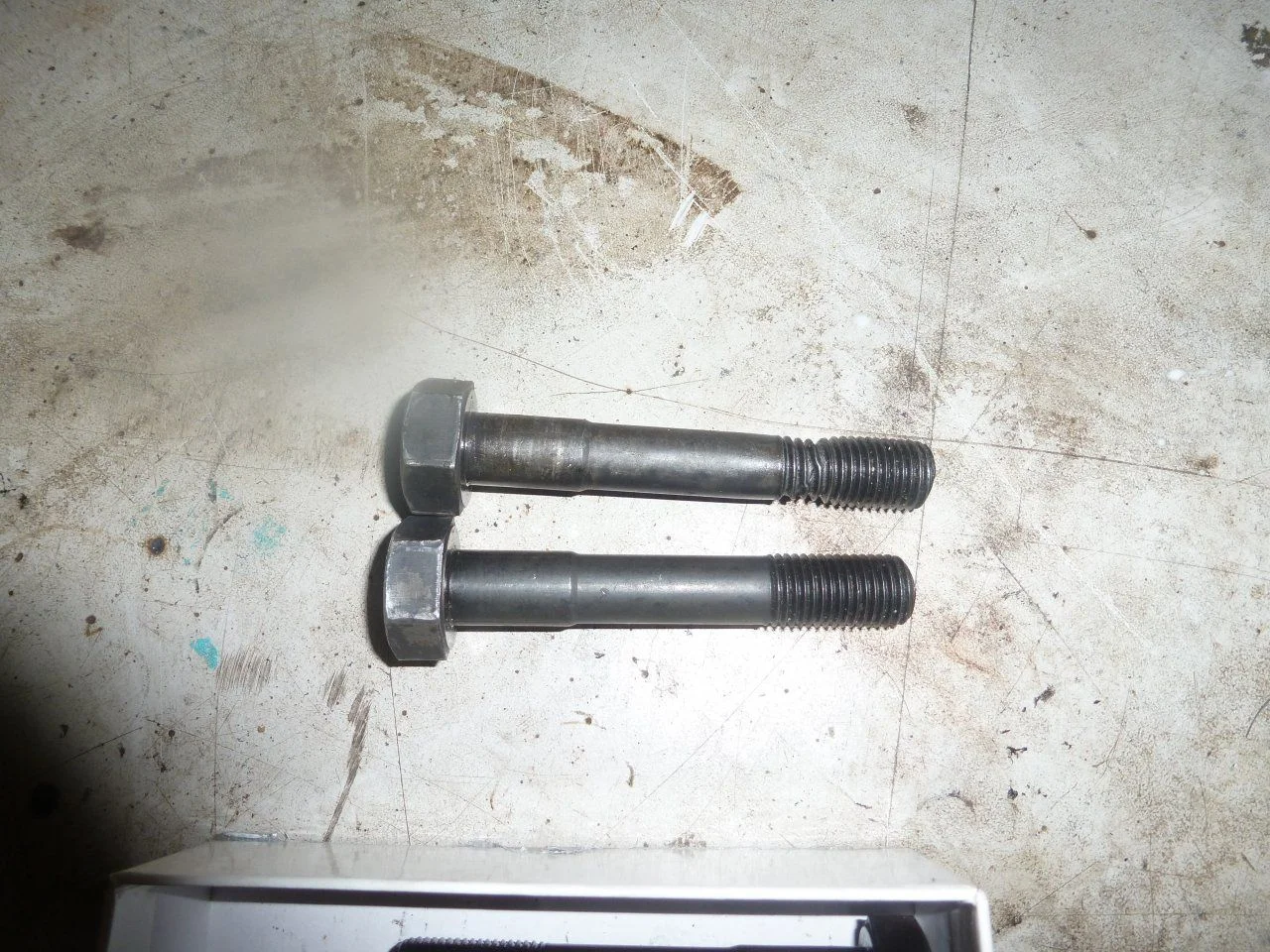

So, I managed to get the oil pump gears, but can't find a simple bolt. One of my main bearing cap bolts is stretched. They're a weird size, 13mm x 1.5, looks like Greg (gerg) will be saving me once again with one from one of his donor engines.
I hope to be putting this back together by Xmas. The company I work for is shutting down for the week of Xmas and I don't have a ski pass (no appreciable snow the last few years) so I'll be itching for something to do over the break.
Yeah... 13mm is a real non-standard size... I remember noticing that before with head bolts

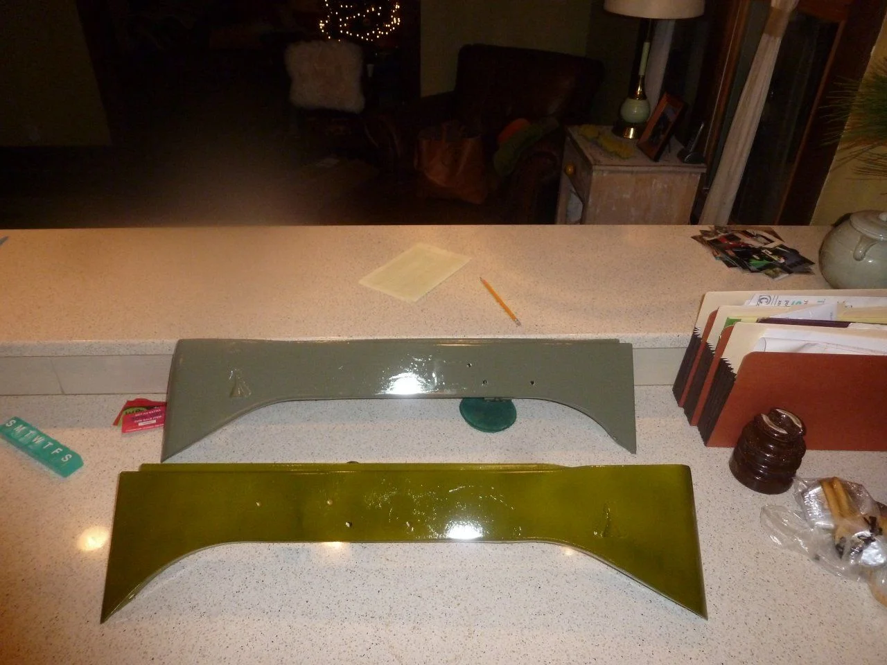

Looks pretty close to the factory color.
What do you figure the factory color was? Every part of this thing seems to have been painted multiple times with different colors. I sanded through about 4 colors on that one apron, brown, green, red, yellow and there was an orange in there too, but that may have been a combo of the yellow and red or a primer.

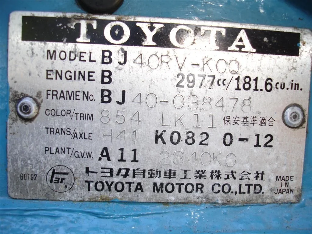

My colour is stamped on my VIN plate:
854 = Sky Blue

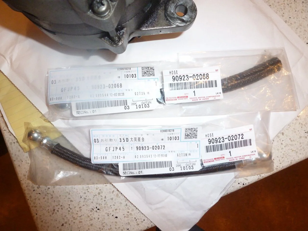

I received some more stuff from my new BFF's in Japan at JP-Carparts today...it's like Christmas everyday here. It amazes me how fast their shipping is too, I ordered some parts domestically on Monday (same day I ordered these) and I got these today, the other parts might show up Monday.
I mentioned way back when I was putting this engine together the first time that the hoses on the vacuum pump were all ratty, so I decided to see if they had them, and viola.

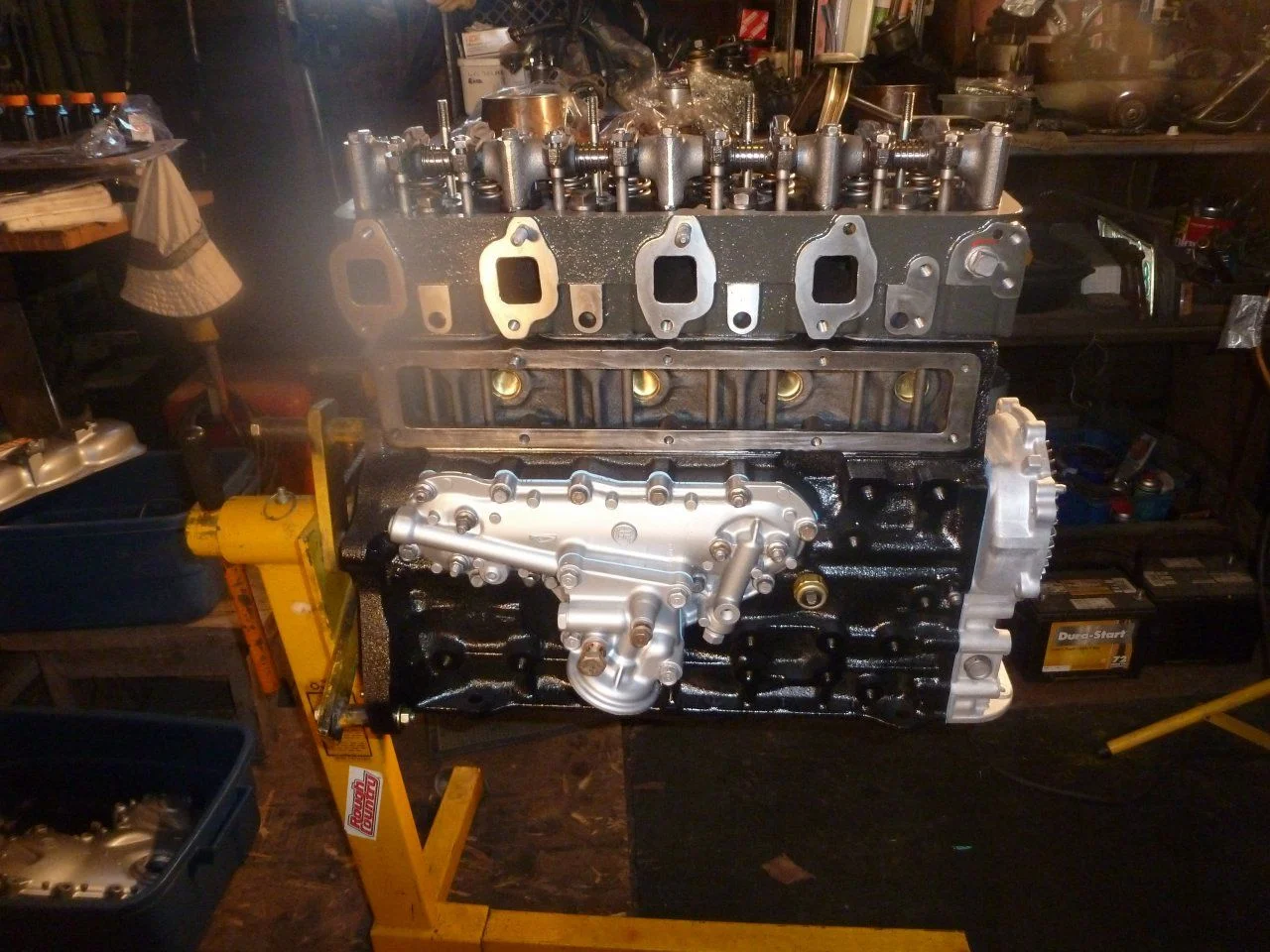

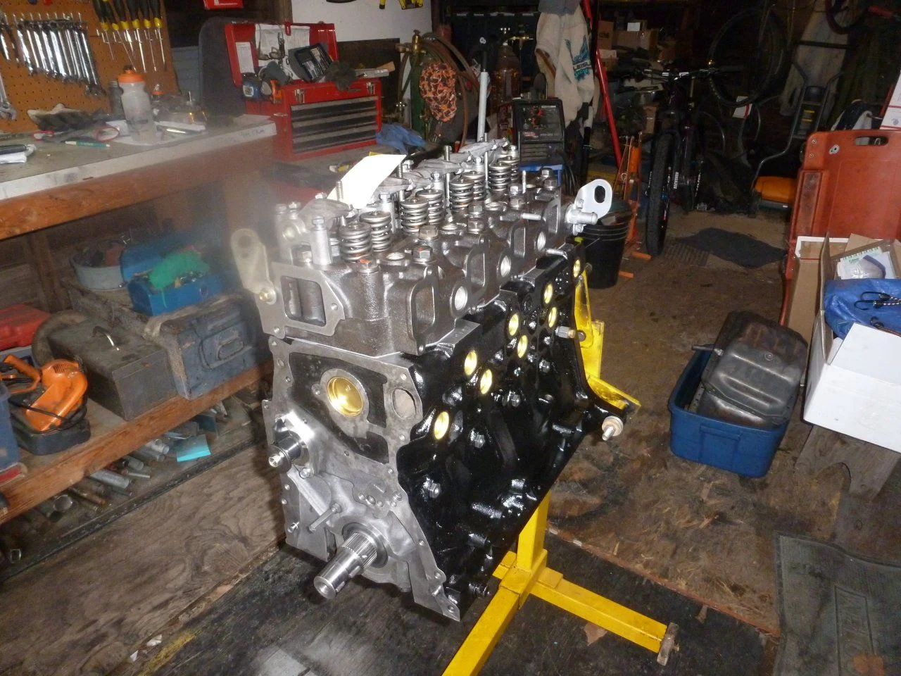

Shop has the short-block done less one main bearing bolt, which is scheduled for delivery later this week. Said everything went together really well, all the clearances are good. I'm 'on schedule' to get the engine back together next week.

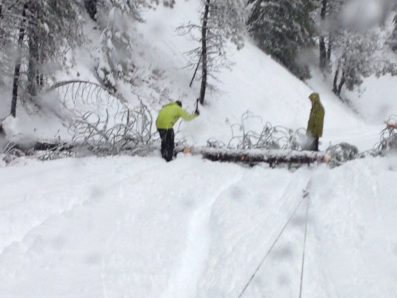

Still haven't made any progress on painting the engine bay though, too busy 'playing'. Spent the weekend at a Forest Service cabin, almost got to spend the week, this was yesterday morning, about a foot of fresh snow on top of the foot already there on our way in. Took us about 3 hours to go 15 miles back to the main road. Spent an hour of that time chopping a downed tree out of our way with a hatchet...note to self, put the ax back in the truck when you're done with it.
Got a sample of Toyota GRAYISH OLIVE 6H9. It goes on way better than the 637, yellow-green. Wife likes the grayish-olive. I like the yellow green (of course), but it doesn't have very good coverage. It's a toss-up right now.

Took the bolt over to the shop, they installed it, gathered up all my $hit, palletized everything and I brought her home.
Got it unloaded and in the garage for 'final assembly'...it's beautiful!

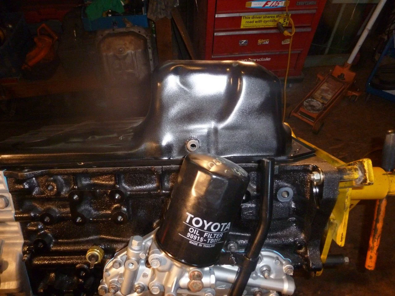

18 deg. F for a high today, put my propane heater in the garage and got a bit of it assembled. Decided to poke a hole in my old oil pan and move the turbo drain over enough to allow me to run the standard OEM filter.
Here's a shot of the old pan, with the OEM filter, note the fitting is almost directly behind the bottom of the filter.
I got another fitting from Jefferson State Machining (Diesel42) and moved it forward a tad on my old pan so it clears the stock filter.
Hopefully get the rest of it done tomorrow. Just need to install the crank pulley, water pump, power steering pump and alternator, adjust the valves and put the valve cover on. Oh and roll it over, get the freshly painted 'new' oil pan installed.
