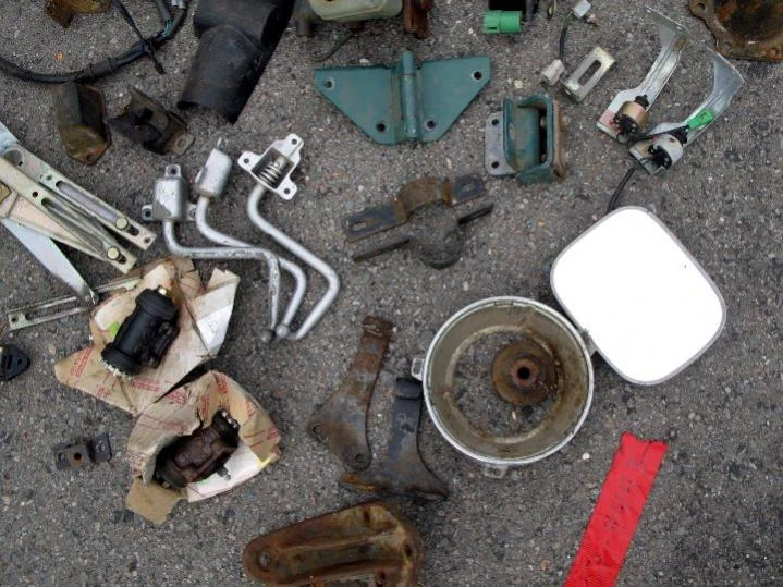

I've got a spare full-throttle switch and bracket from a CA-smog '76-'78 (at least) fj40. I'm guessing it fits the good and durable bill and the price is 'reasonable'.
Top-right of this photo:
attachment.php
attachment.php

Thanks man. I did manage to find one at Summit though that was sealed and water proof. That was one of my big concerns with mounting it on the shfters. Its a Ron Davis switch that should fit the bill for what I need perfectly, and its also relatively adjustable.
