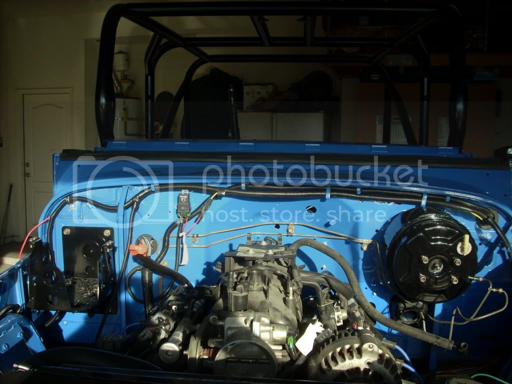

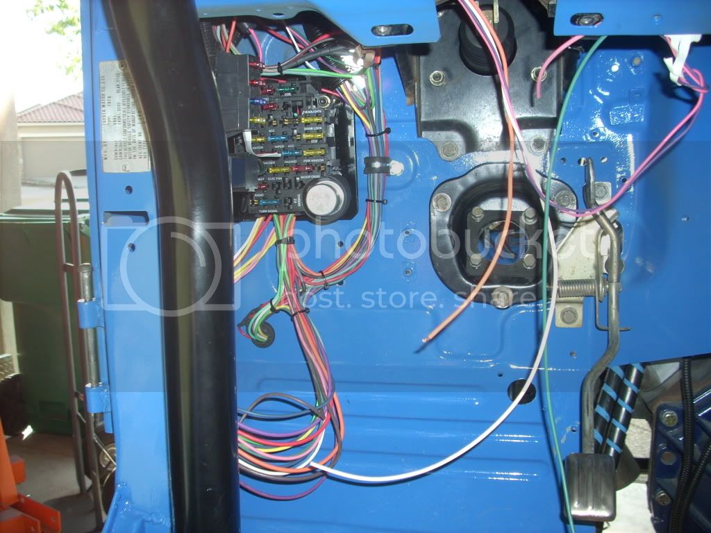

Progress;
Fuse block area almost all buttoned up
Front loom 90% done
We should bang out the rest of the front and the majority of the rear tomorrow.

Rusty got almost all if the control wiring done and were about ready to put the steering column in!!!
I got the rear harness pulled and most of the connections done on that.
Closer and closer!!!
Man I dont check in for a couple days and missed 3 pages and an ton of work. The wiring looks killer.
This was actually a lot of fun for me, I haven't done anything this big before.
We need that High Beam relay before the column goes in.
Nice to hear you got most of the rear end hammered out.
We should be able to start testing this week.
When it runs mandatory burnout video is needed.
Exciting! Great job on the wiring Dan & Keith! It looks great in the photos and even better in person. Can't wait to hear that V8 sing.
