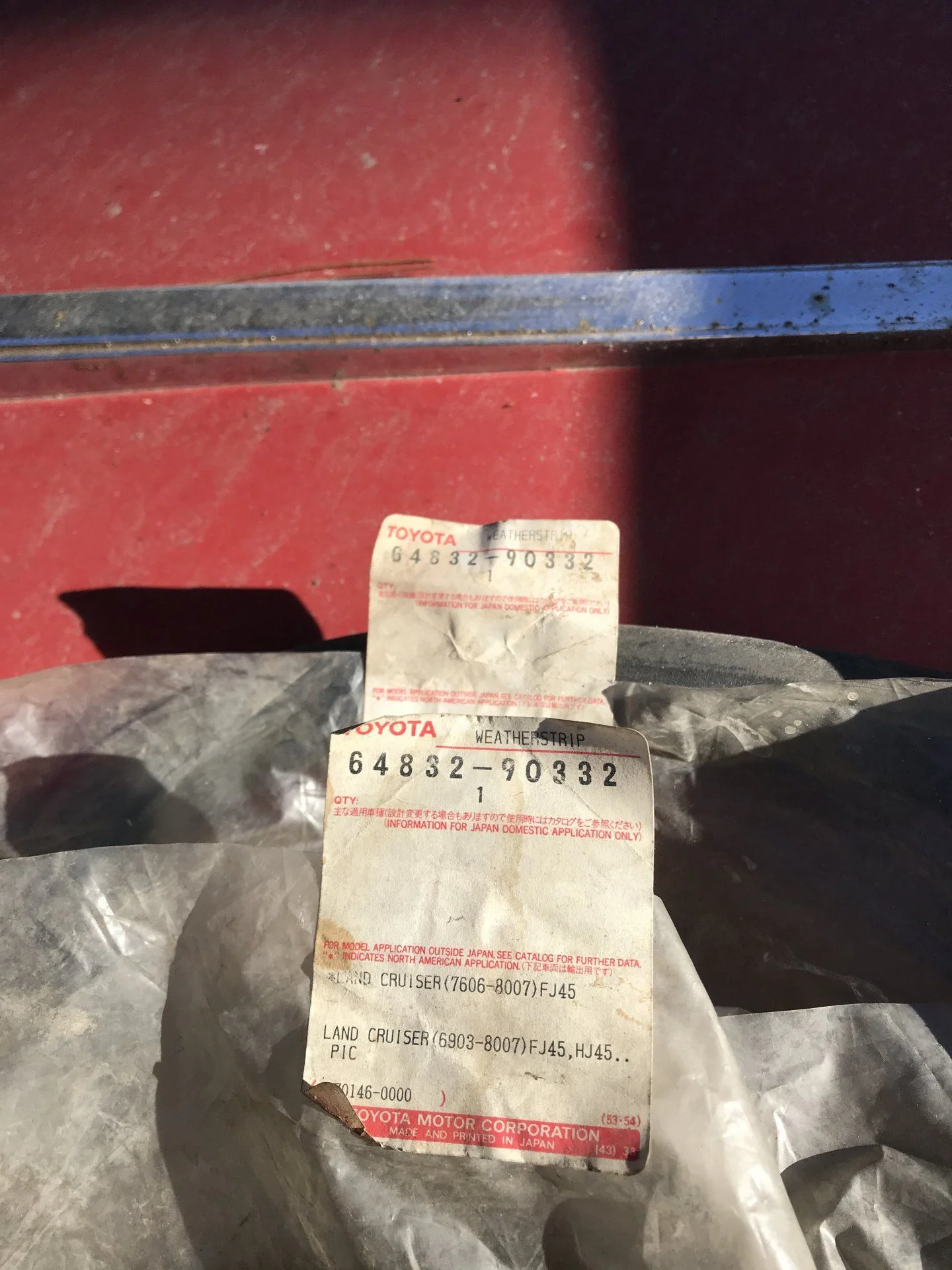

TTT, Tech question... FJ45 rear corner glass. I was unaware but two different part #'s
64813-90334rear glass Left
64812-90334rear glass right
@whitey45 is there a right and left rear corner glass? I didn't see any differences but perhaps we had two of the same side out at the same time. I can dig mine out of the box to verify i have both sides if they are different. To my uneducated eyes they looked exactly alike. We just installed the windows in Chef's last weekend and just want to verify we did it correctly or if we need to remove and reinstall.
There is indeed a left and right side, and the weatherstrip carries the same part number.. I put the two sides together and they are close, but the curvature is off from left to right. I just happen to have some nos goodness stashed away!
Thank you sir! I will dig my glass out tonight. I may have more questions. Want to see if i can identify which is which visually without a PN.

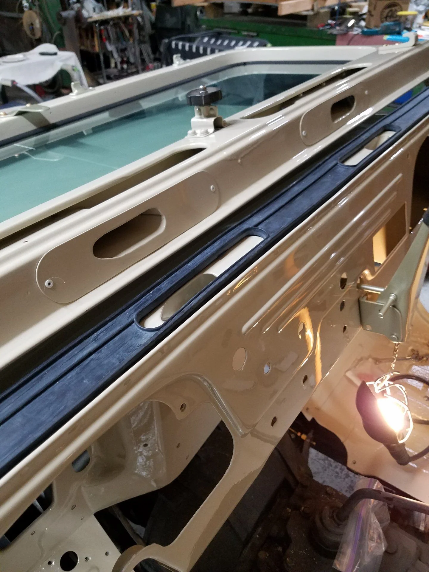

Windshield frame is back on. The picture shows the modification to the defrost vents allowing the windshield to fold down without the removal of the defrost vents.

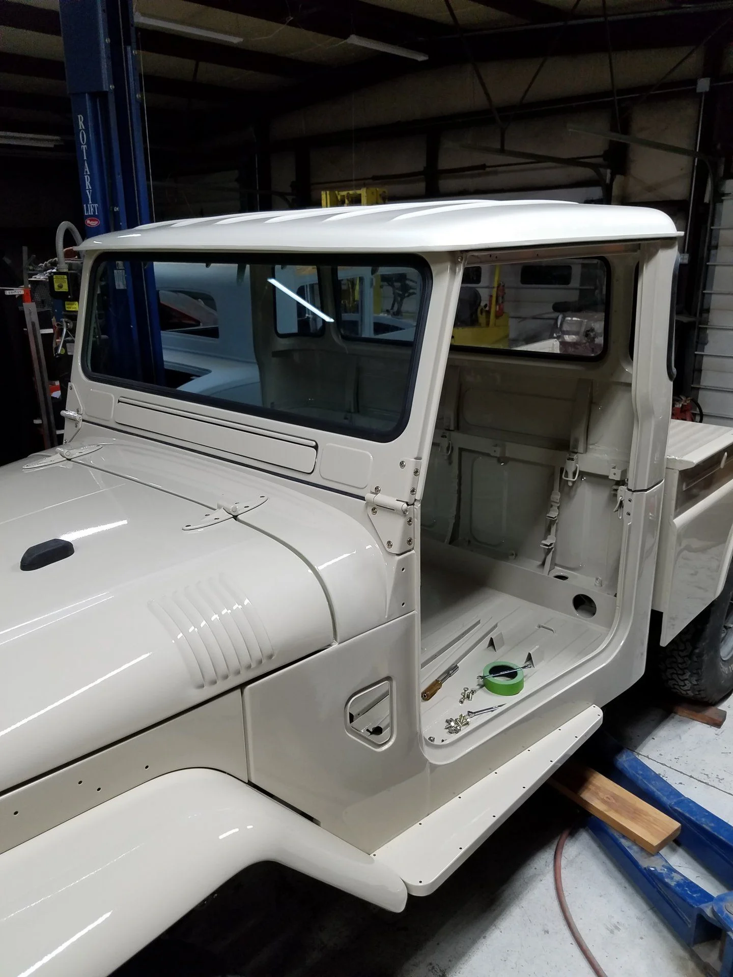

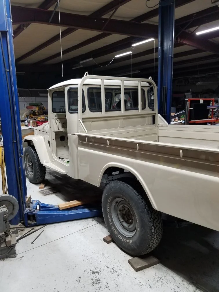

Hardtop is back on and headache rack is in place..
Stay tuned.. Doors are next. They are not painted yet but will be test fit now that the cab is aligned. Minor tweaking on the doors prior to cleanup and paint.
Lots of small things getting installed.

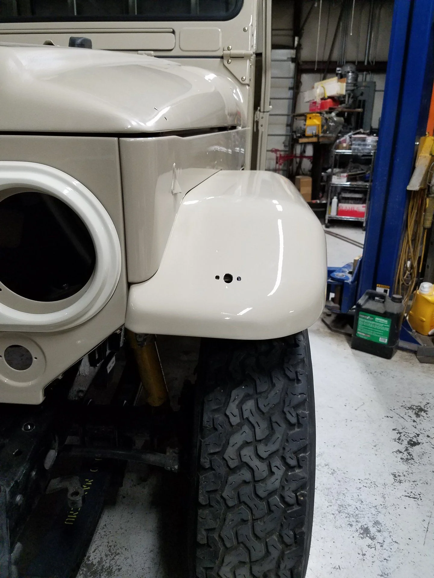

9/25/2020 update.

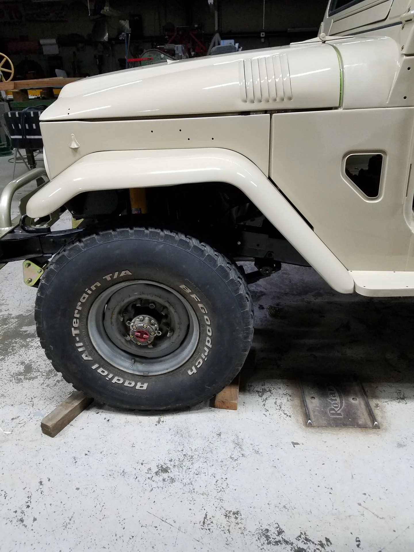

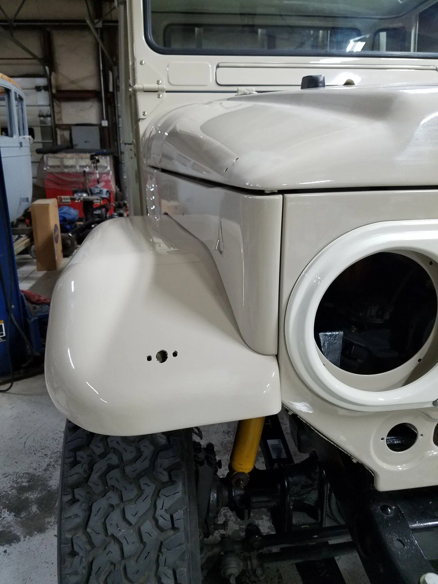

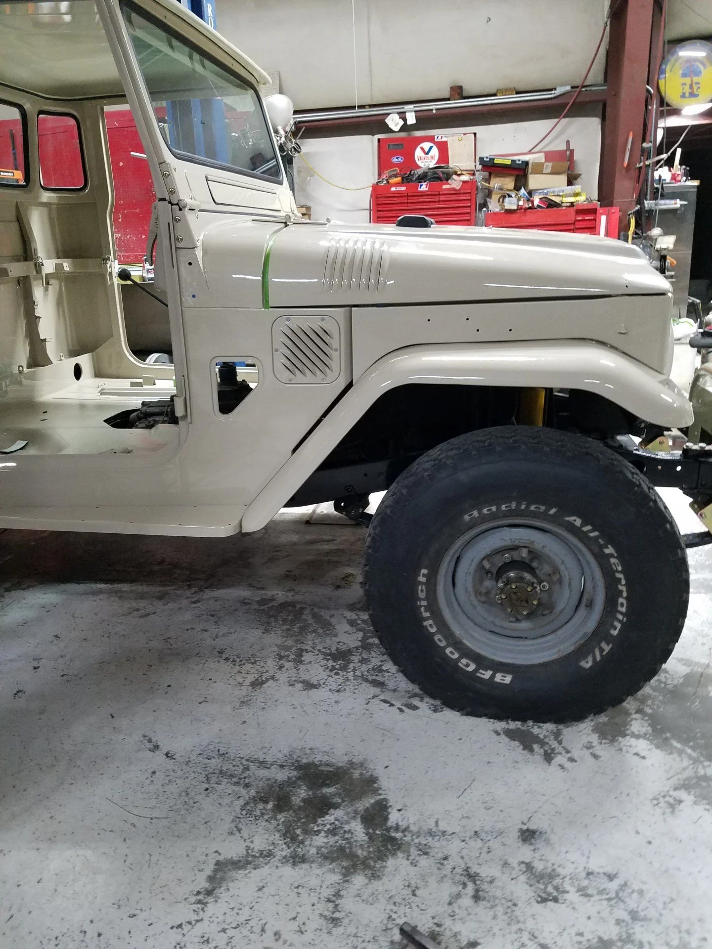

Tweaking to the alignment of the body panels on the front.
Body shop guy has an eye. Added 1/4 inch spacers to front tub mounts. Fender washers to right fender top bolts. Altered back bolts of the left fender a little bit. Added 1 washer on left apron to adjust vertical alignment. All cab bolts are now tightened down on the front end. Doors should be test fit by the time we arrive to assist on Saturday.
