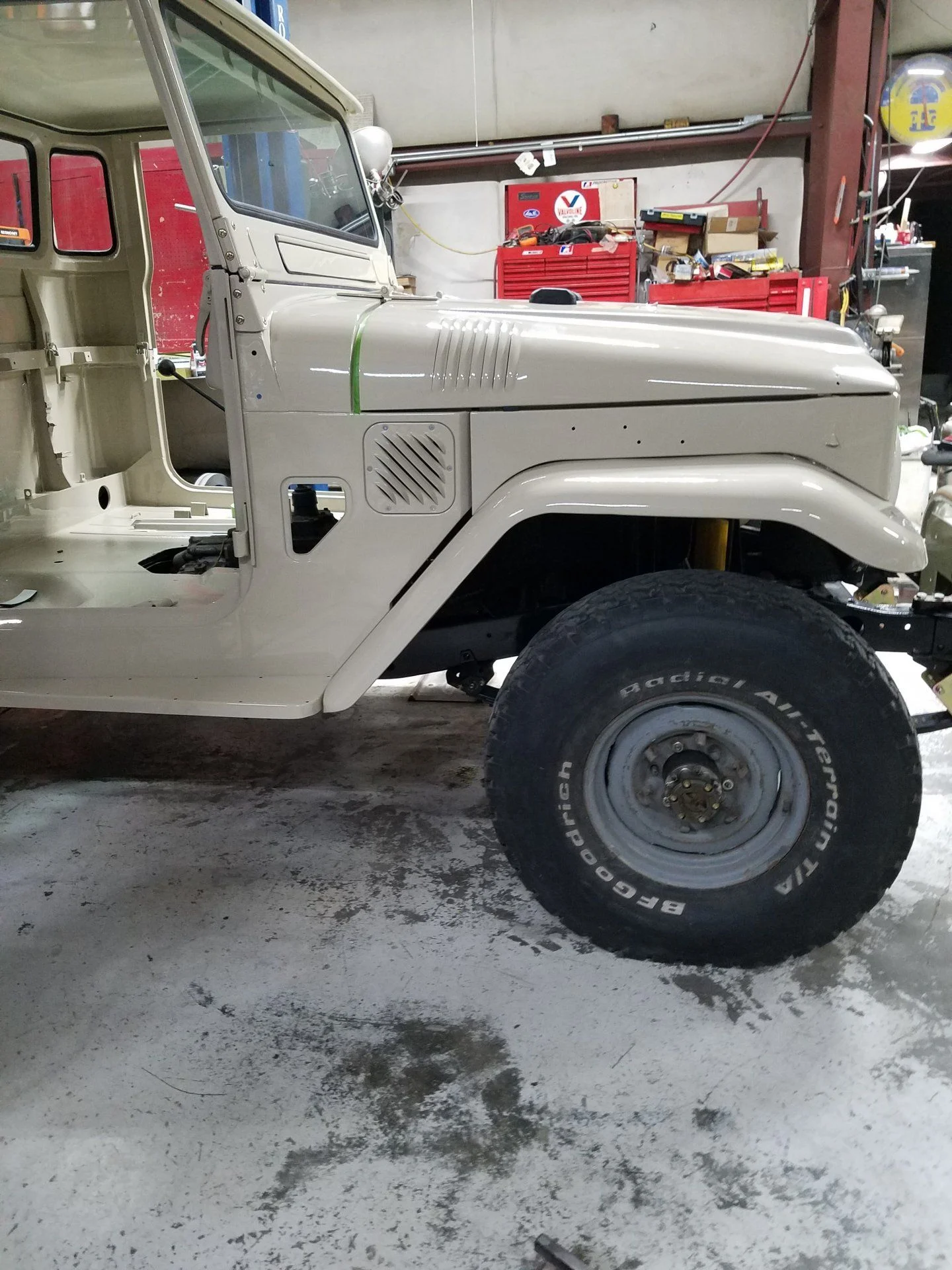

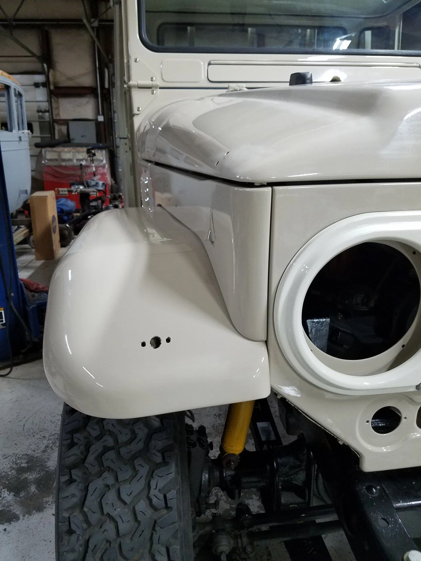

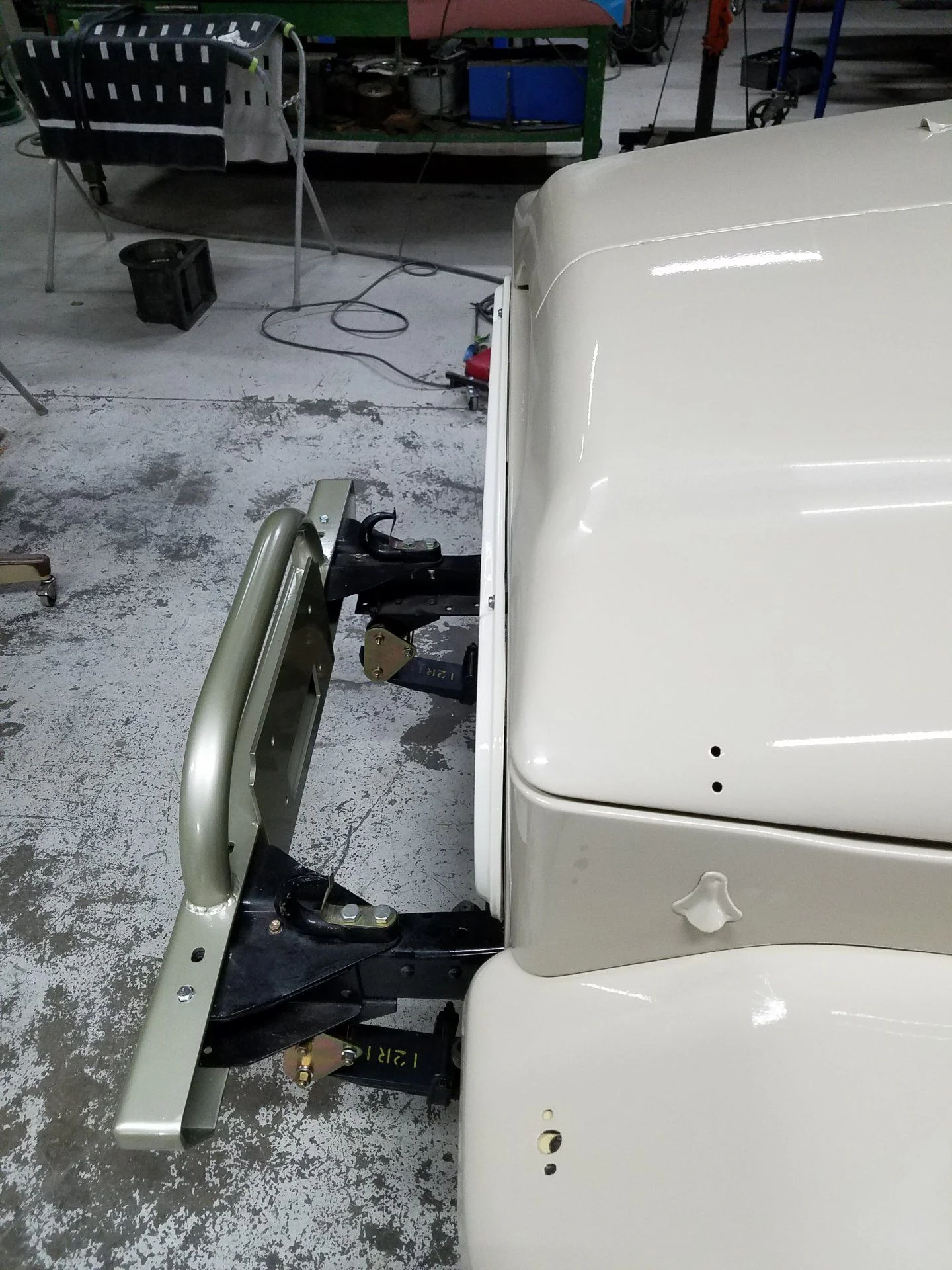

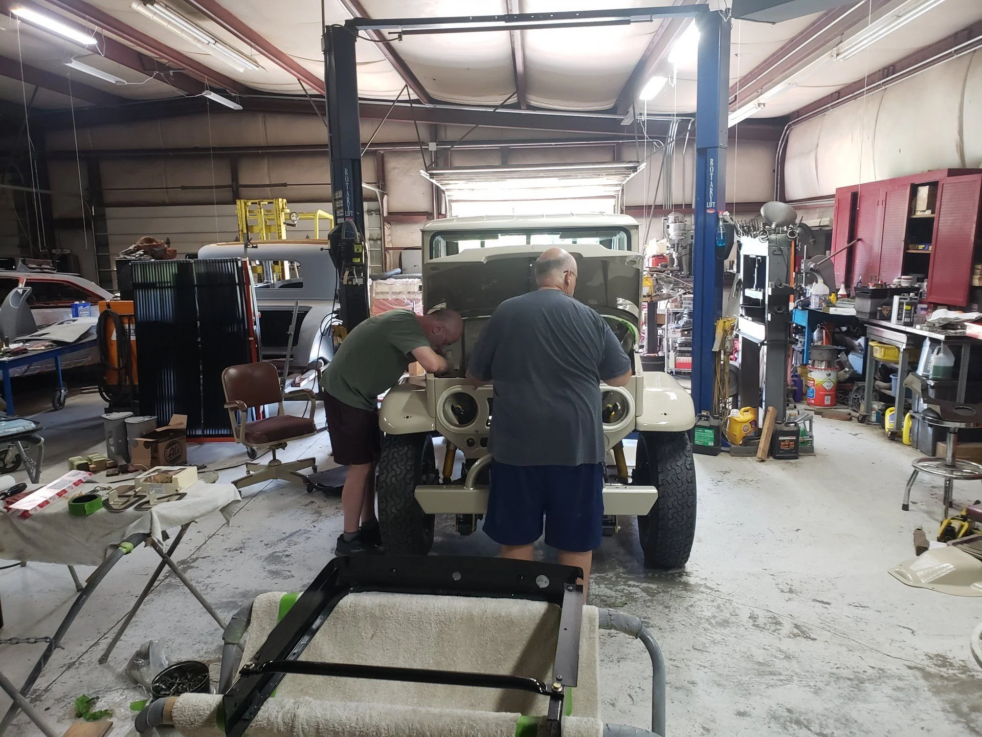

Tweaking to the alignment of the body panels on the front.
Body shop guy has an eye. Added 1/4 inch spacers to front tub mounts. Fender washers to right fender top bolts. Altered back bolts of the left fender a little bit. Added 1 washer on left apron to adjust vertical alignment. All cab bolts are now tightened down on the front end. Doors should be test fit by the time we arrive to assist on Saturday.
Somebody get Alan a clipboard so he can supervise correctly....
Pretty sure mine won't be that straight! I don't think i have the patience, skill or ..

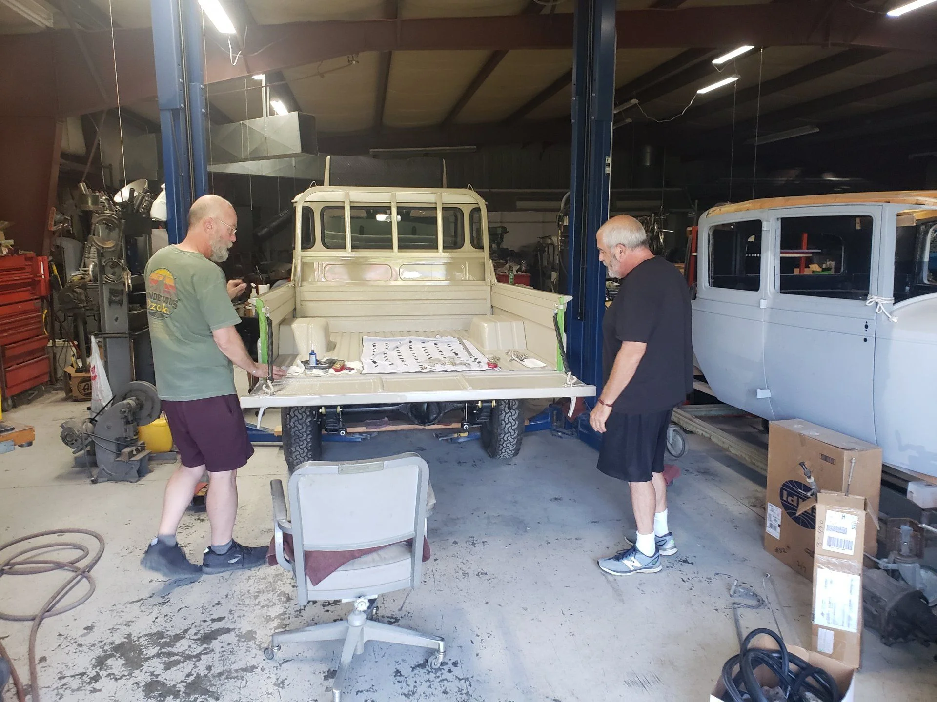

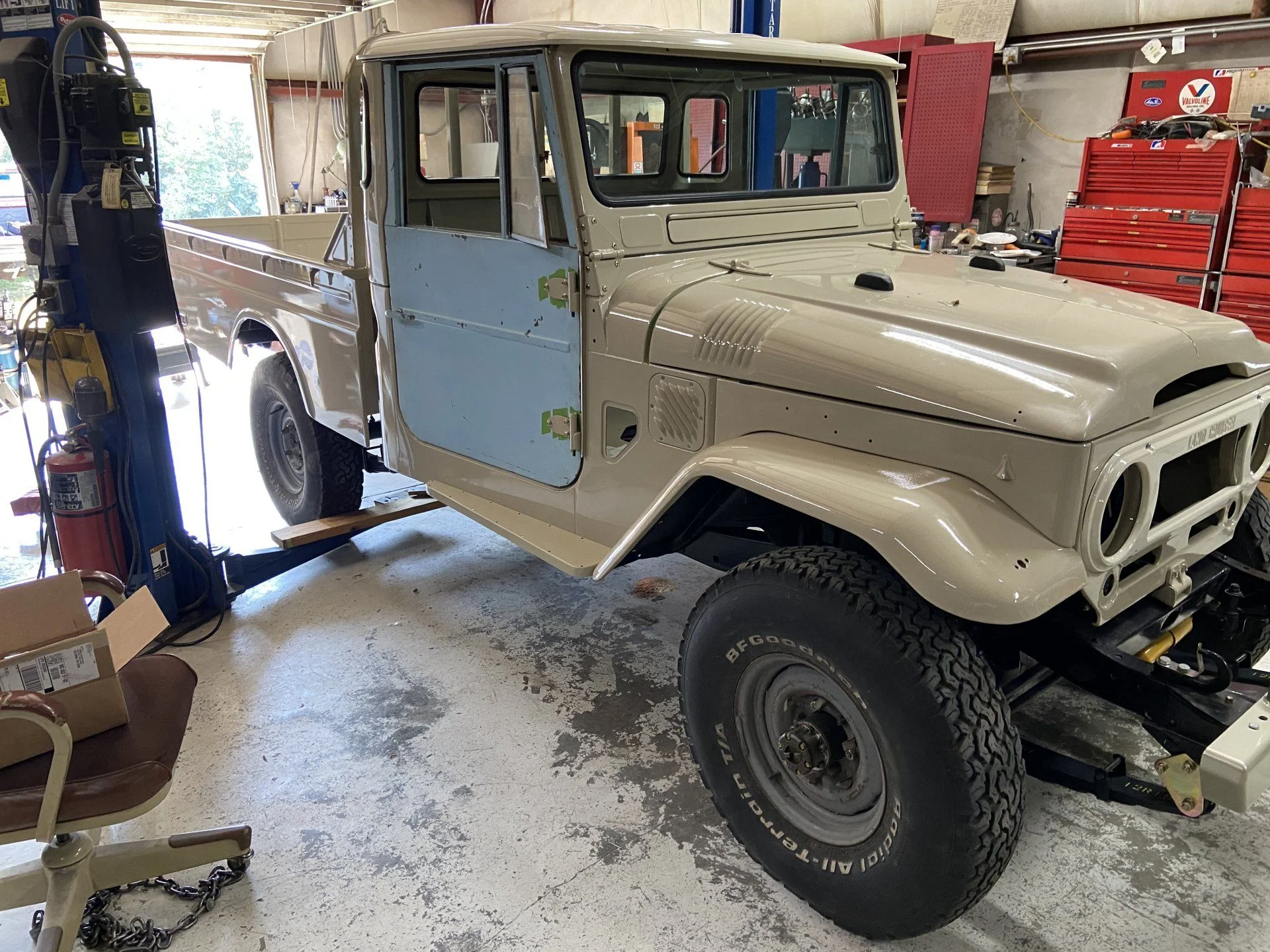

Doors getting aligned in prep for tear down session tomorrow. Found a couple boosters in my hoarde. Some tie rod ends. A Flowmaster, some exhaust hangers and some mandrel bends. Bringing 2 cluster faces to get painted and a defrost vent which Chef is missing. All foward progress!

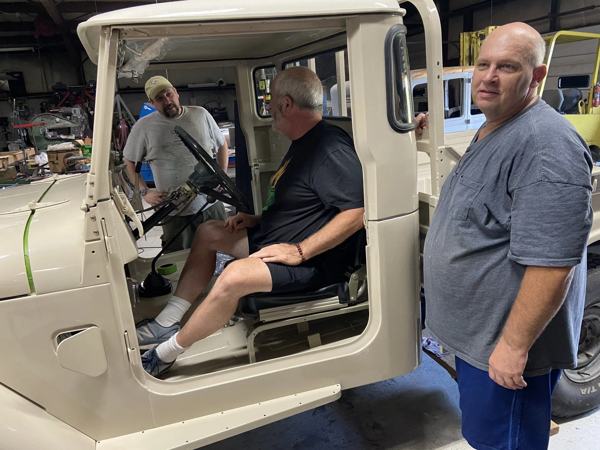

Drivers door test fit. Needs a bit of work on the back top corner to get a perfect fit.

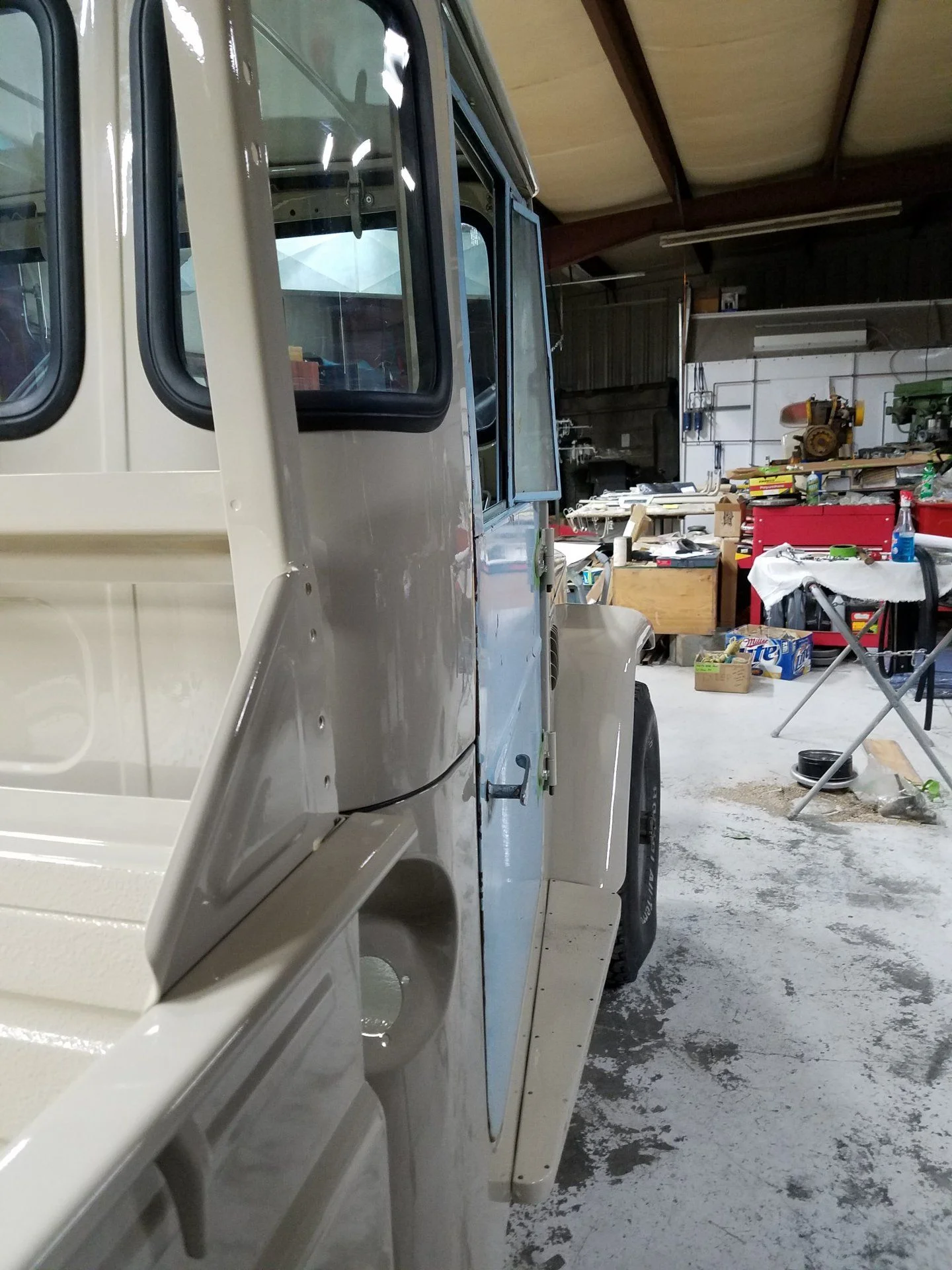

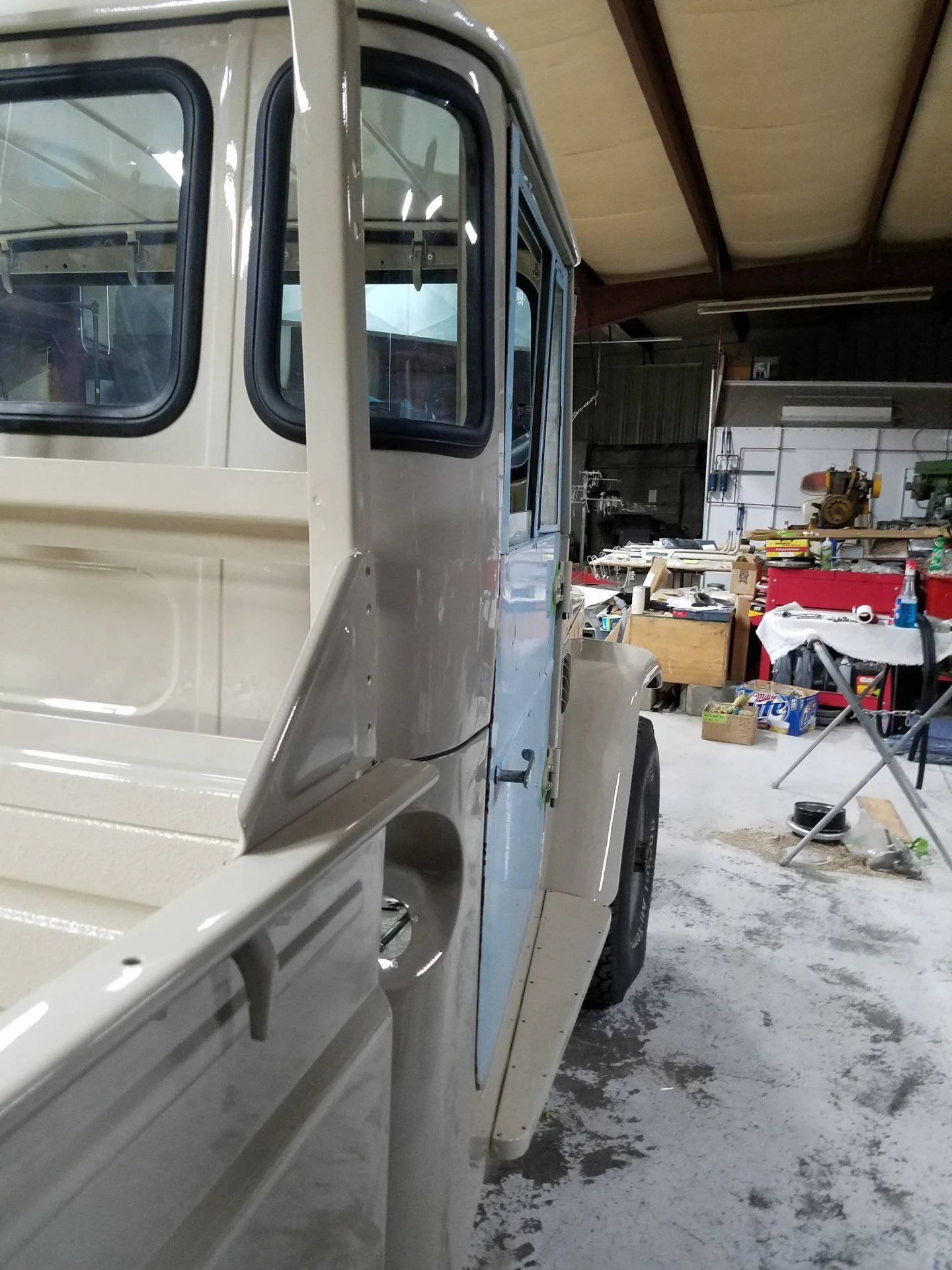

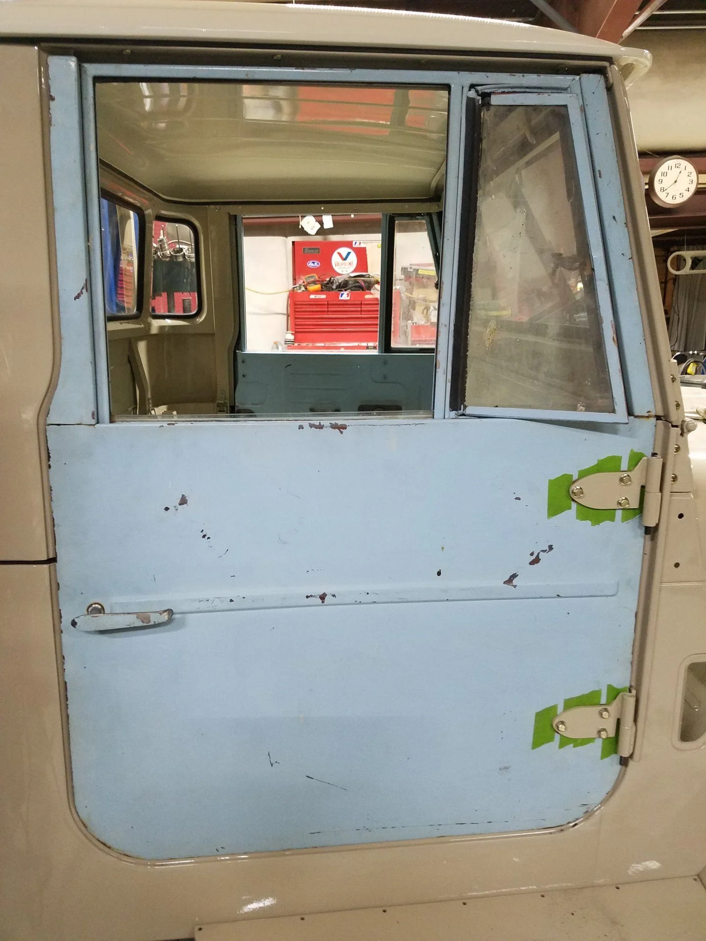

more door alignment prior to paint. Top rear corners are nicely aligned now.
May I ask how you got those corners aligned?
@middlecalf ill post up the details on specific heights of each shim next week but was approx 1/4 " on the pass side under the body/cab. Couple fender washes to shim out the fender top bolts. And slotted the fender to adjust forward and back a touch. These were not oem fenders and the inner brace on the pass fender does not come from Taiwan in the correct spot. It had been moved prior to paint on initial mockup.

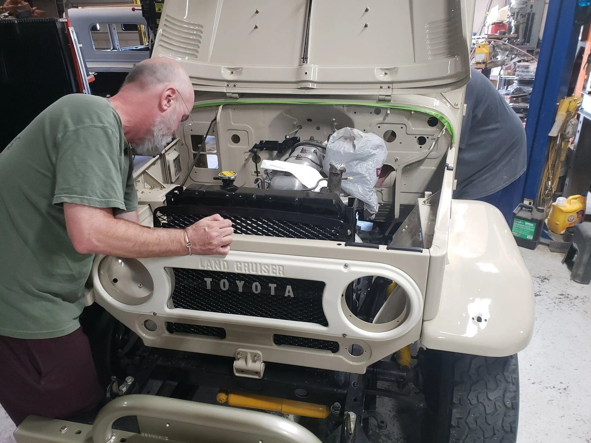

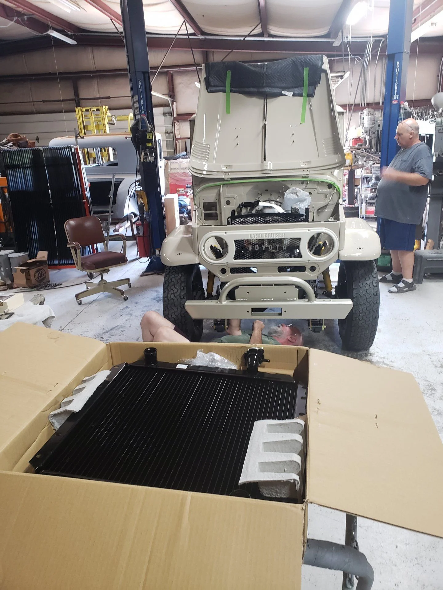

Work crew getting at it. Grill mesh first, new emblem. Then radiator hoop and support. New OEM radiator and painted shroud.

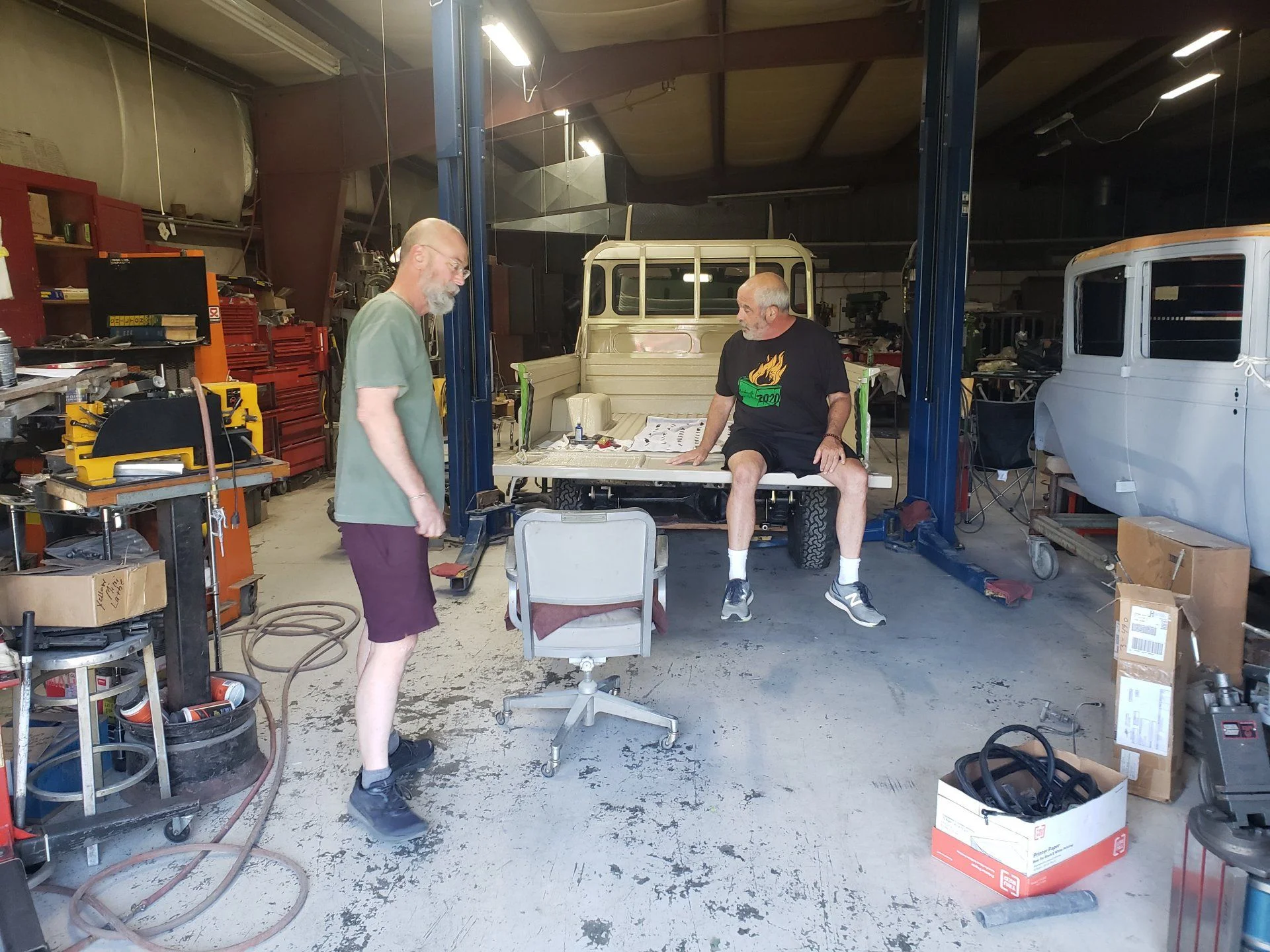

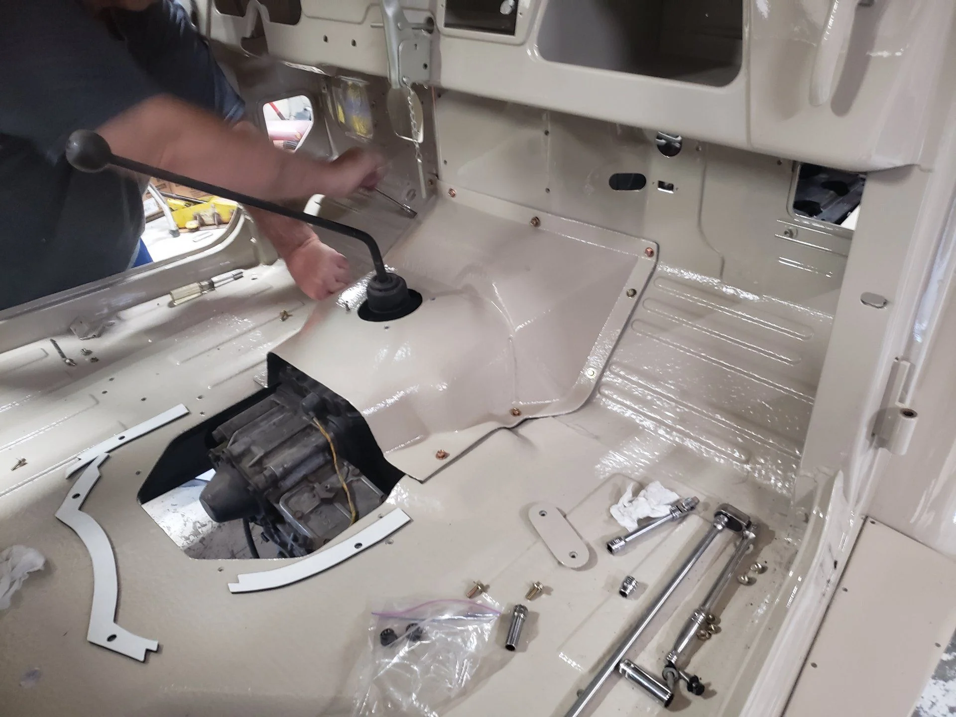

Transmission tunnel and gasket. Glovebox door, new visors, mirror and mount, tcase lever

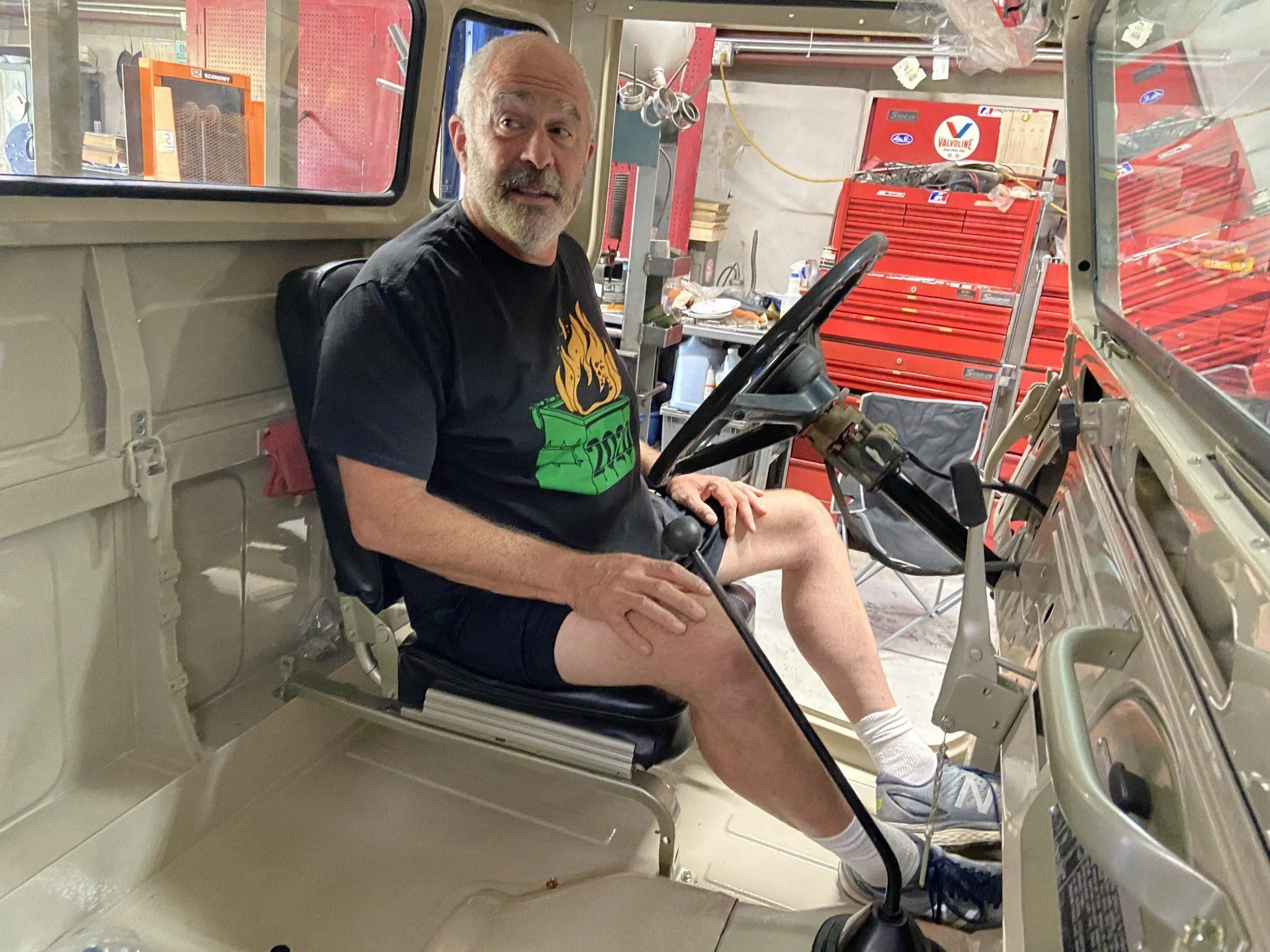

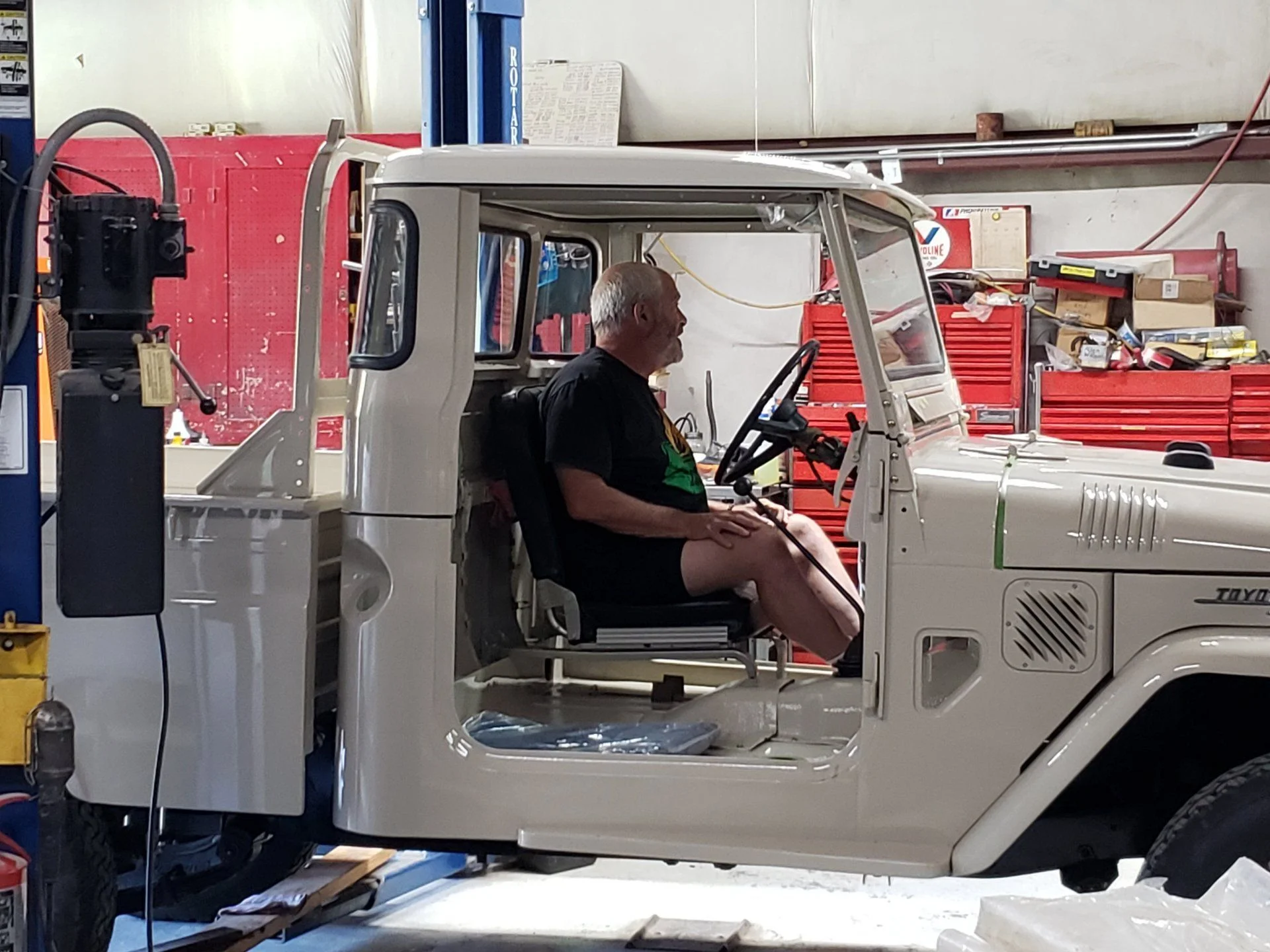

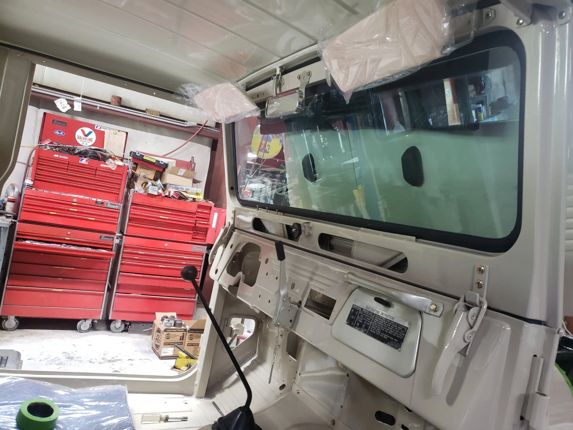

We started hustling, heard the boss was coming! Exterior mirrors on. Got the pedal assembly in place along with the steering column. Firewall graft allows 78 pedals and steering column to be used. Done just in time for posterior testing by "The Dude" who brought awesome salad and cheeseburgers for his crew of minions. Pretty darn special moment for us. This is the first time @Chef has actually ever sat in this truck! Purchased in pieces so it has been a jigsaw puzzle since day one approx 20 years ago.
