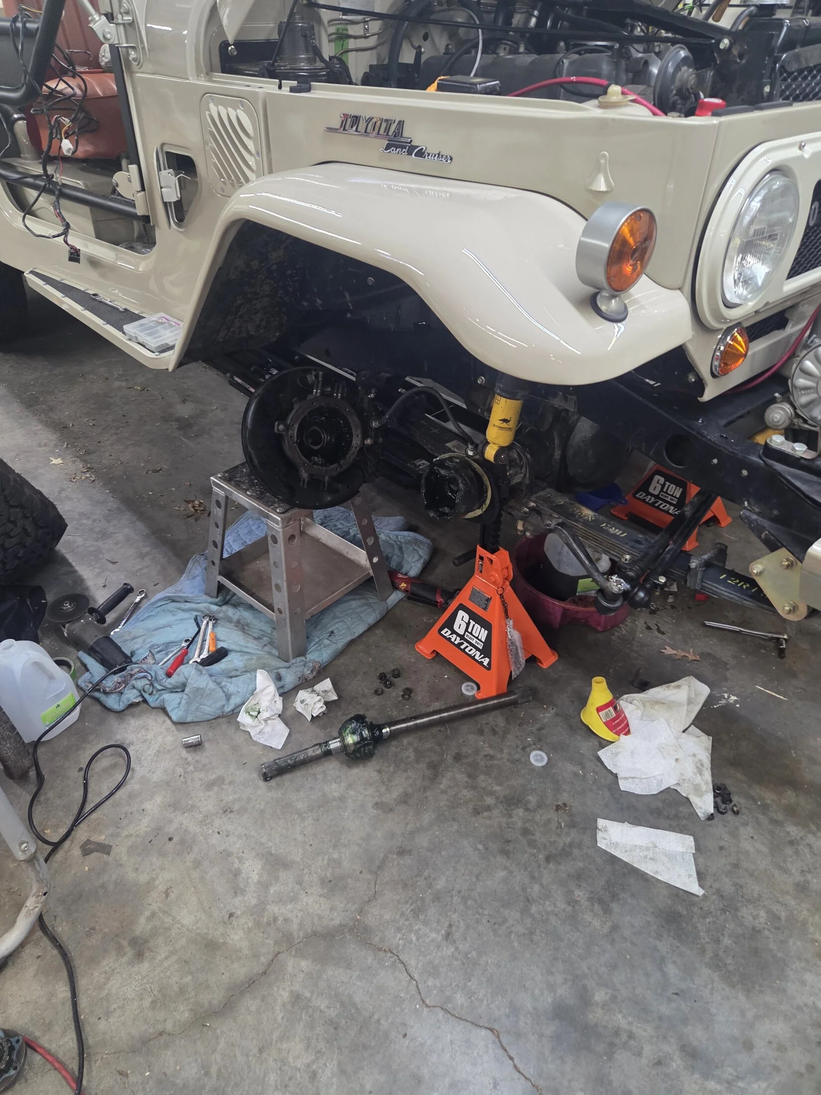

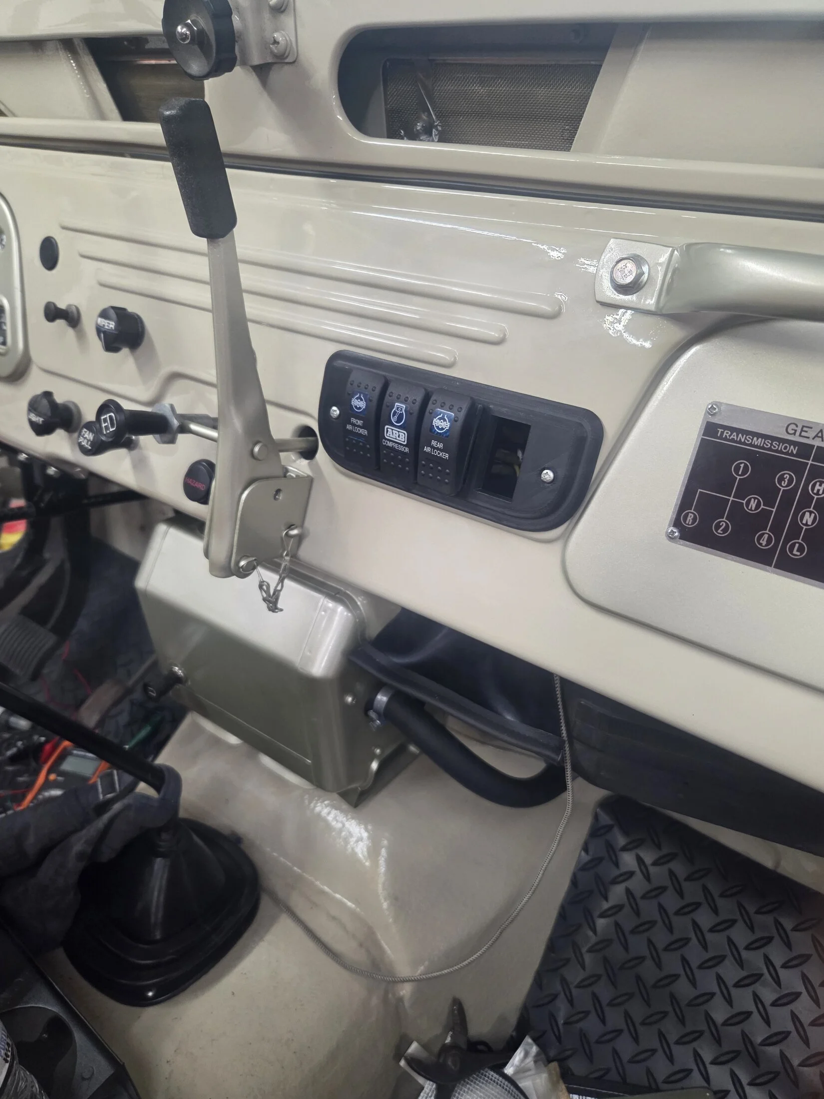

Pulled a 4.10 arb diff out of Chefs 40 frame and tossed it in his 45 pickup this weekend. Taking his 45 to the solid axle summit next month. Now the switches look weird but I can fix that later. For now it has a front locker. In the parts pile was a very old small arb compressor and some generic 12v air solenoids. It is nice to use up some junk lying around the shop, and work in my own garage for a change.

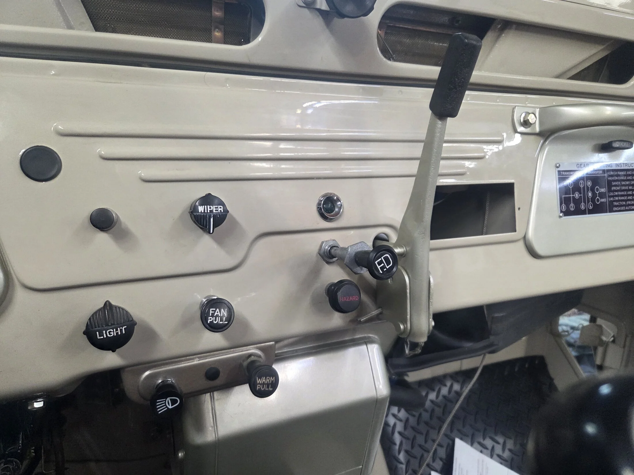

If anyone has a lead on a small push/pull switch that would fit where the aftermarket heater switches reside on an early truck send me ideas. Somewhere is one of those mounts with the 3 holes that goes under the dash
OEM fog light switch.
@toyotamatt has them
Ahh, and I have one of his switches! I'll redo it later after full testing. For now that was the easy button

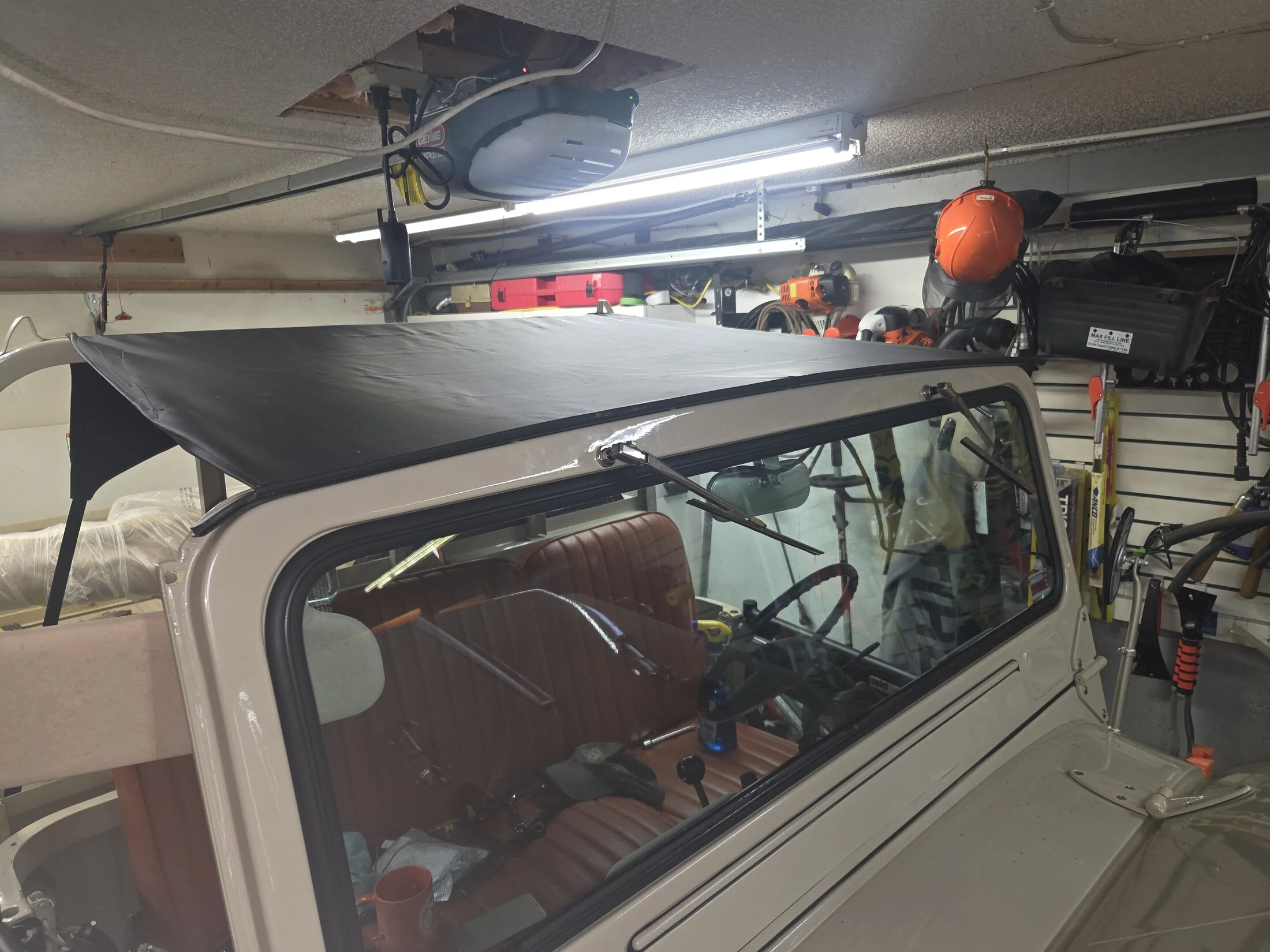

That looks better. Thanks for the idea Nolan. New knobs on the way and x2 fog light switches. For now first pull on switch is compressor, second is locker. And hooked up a heater valve pull, 3 years of popping the hood comes to an end. Now to rebuild a couple wiper motors and work on some sort of shade.
Shade and wipers functional, one wiper doesn't like to park. Worked fine on the bench, that's a later problem.
