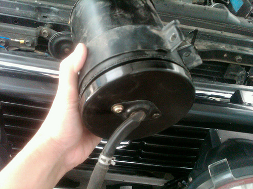

I modified the new CC by drilling a hole in the bottom cap and screwing in the OEM CC's swivel breather tube that routes down under the engine.
The new CC is like a saucer, venting into the engine bay but the OEM design is better I think.

FirsToy, great idea on the bottom breather hose. I thought that the canister sucked fresh air in thru that port, but it must also pass fumes thru that port when the pressure exceeds a certain amount and the engine isn't purging. Conditions like rock crawling at idle for extended periods will slosh fuel in tank creating vapors, and the engine doesn't purge at idle.
Great to hear that everyone is seeing positive results. Mine is still working great for me as well!
From taking apart the OEM Toyota one, I tend to agree. It seemed to me that the lower hose sucks in air.
Part of the problem was that the OEM cc lower hose sucked in dirty air over the years and clogged the filter inside- shutting off the fresh air and that would stop the cc from working properly.
Like you, I reasoned it could flow the other way with vapors, which is probably why Toyota extended the hose down to the breather box, out of the engine bay.
Or, it could be that it just prevents it from sucking in dusty air and quickly clogging the cc.

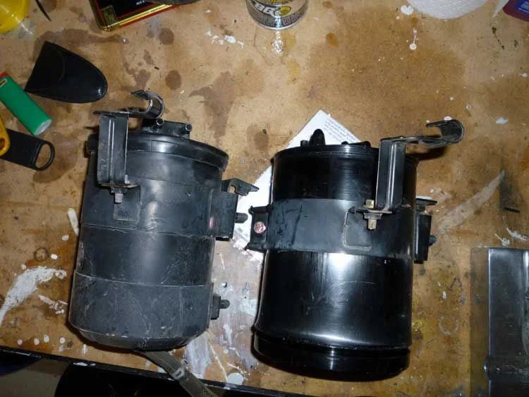

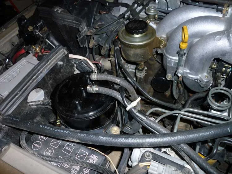

I installed this today. Did not drill the hole. Used only the top bracket vs the two on the existing unit to install. Went in real easy.
I had to use a longer bolt for the bracket as the circumfrance of this unit is bigger
