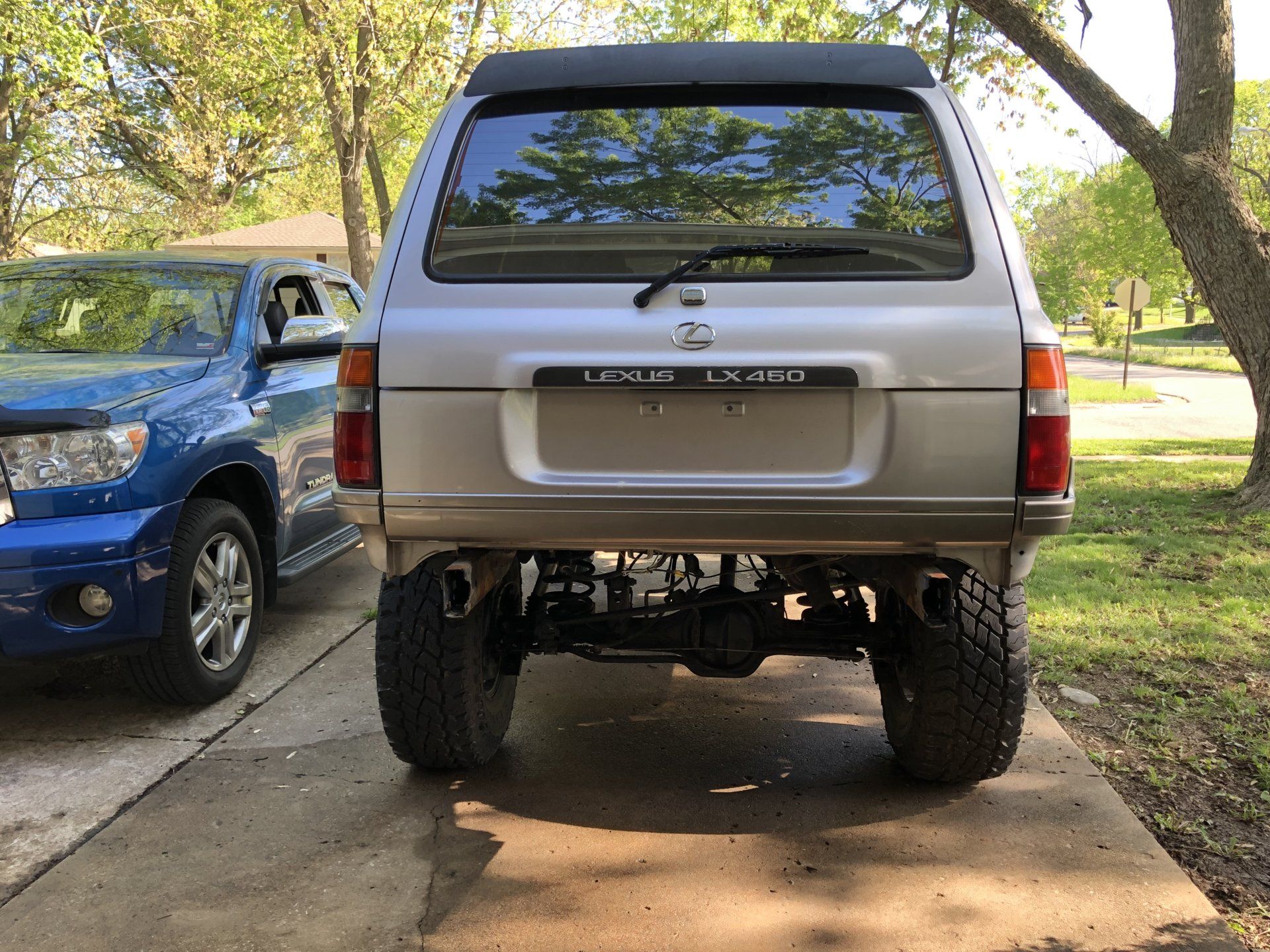

Now the LX is looking pretty bare since you can see up the back of her skirt.

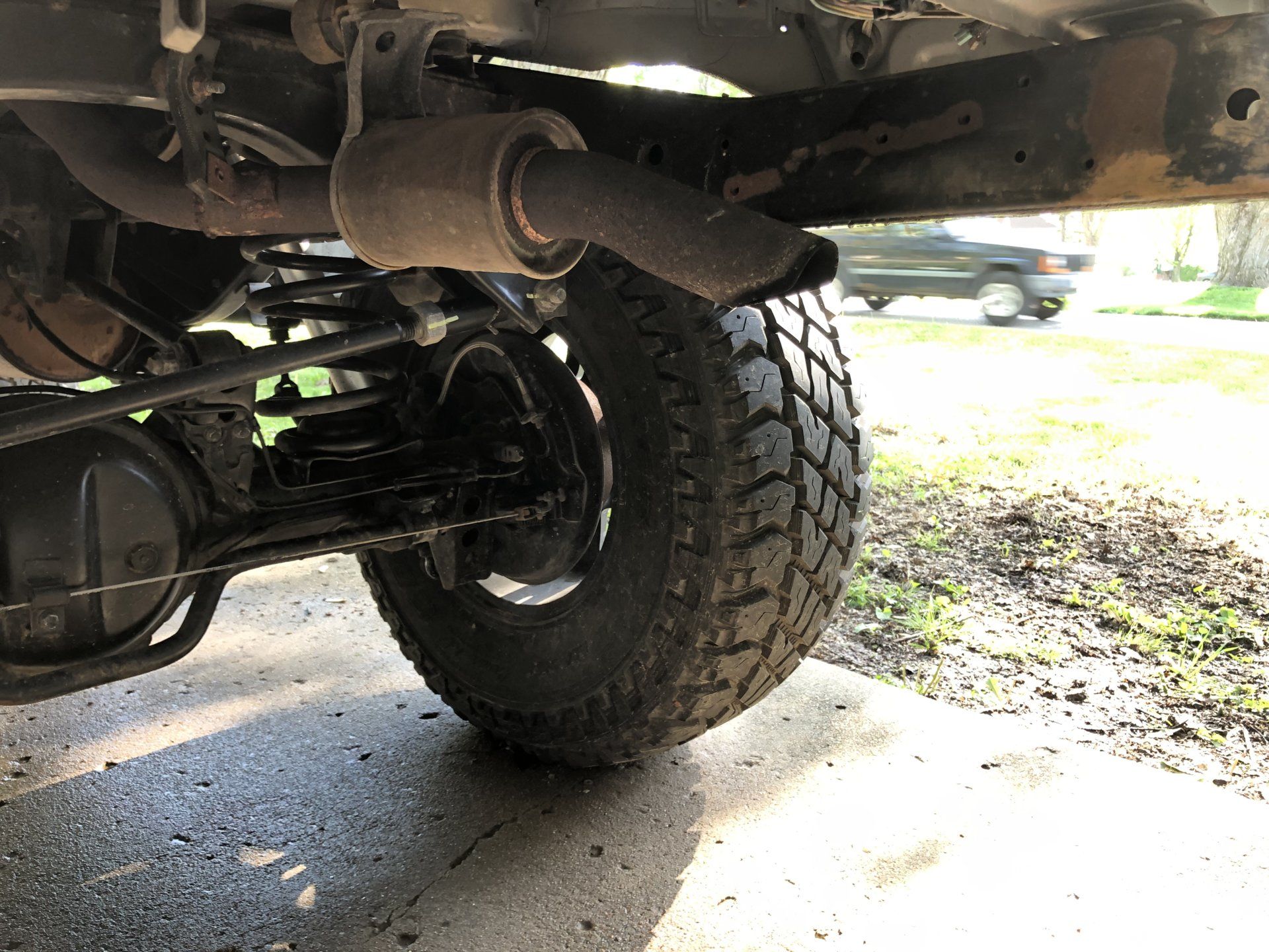

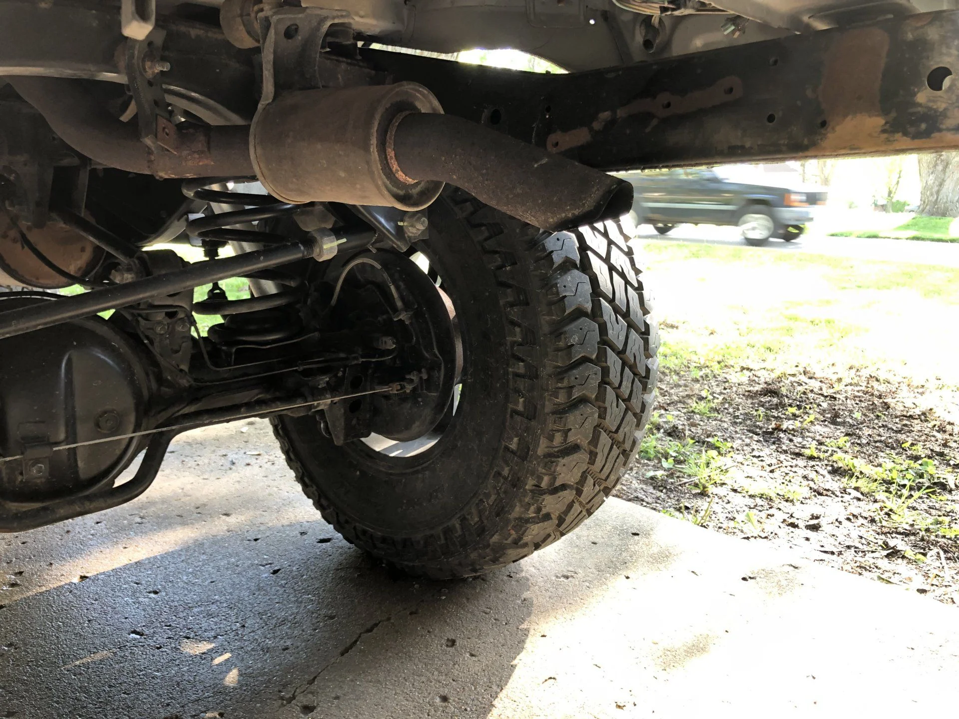

A picture of how I had moved my exhaust when I installed my bumper years ago. Think about chopping the resonator off and just welding a pipe with a turn down.
And some glorious eats at the Smoke Brewing Company yesterday. Chicken fried bacon with country gravy dip and loaded bbq fries.
Almost everyone that chops off the resonator regrets it later due to the added drone.
Yep, been there done that. I would like it to sit a little further back to not have so much exhaust trapped under the rear of the truck when idling. It currently dumps about where the stock spare carrier mounted, so halfway back.
I can say that in its current location I’ve stopped smashing it on things :meh:.

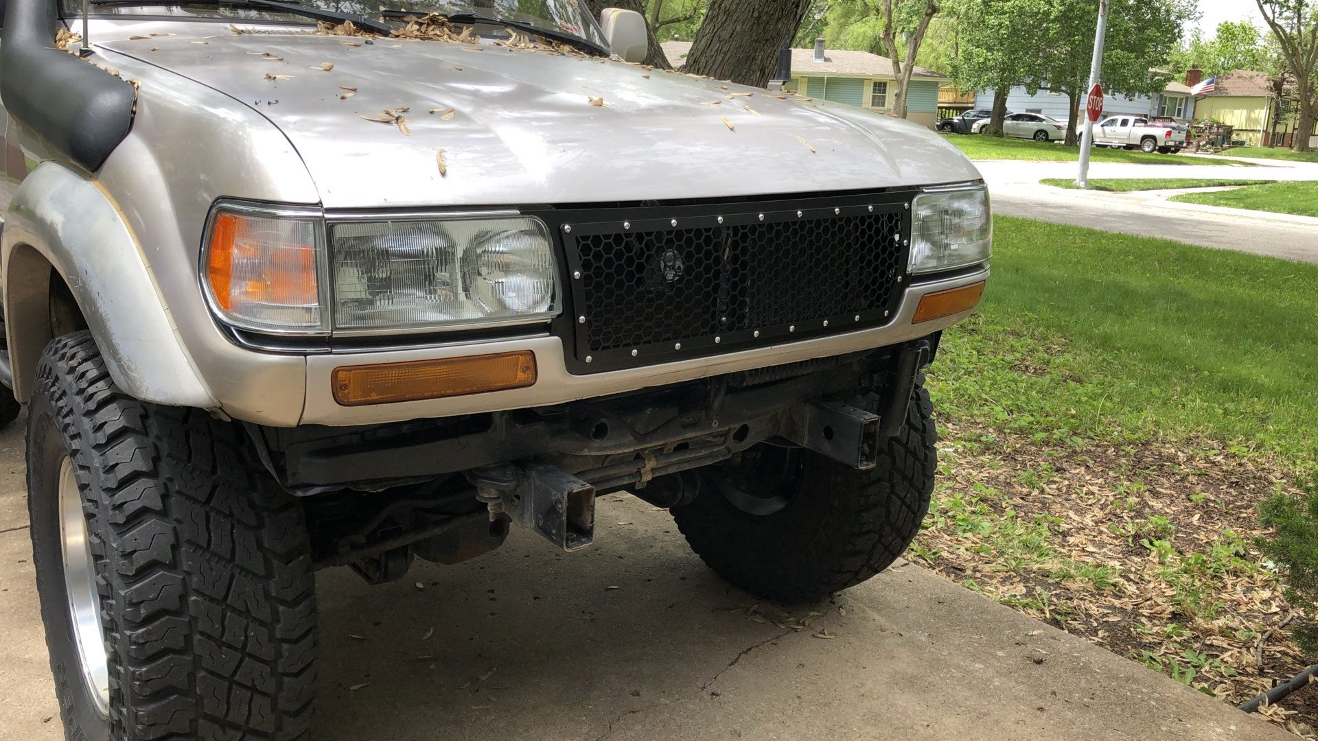

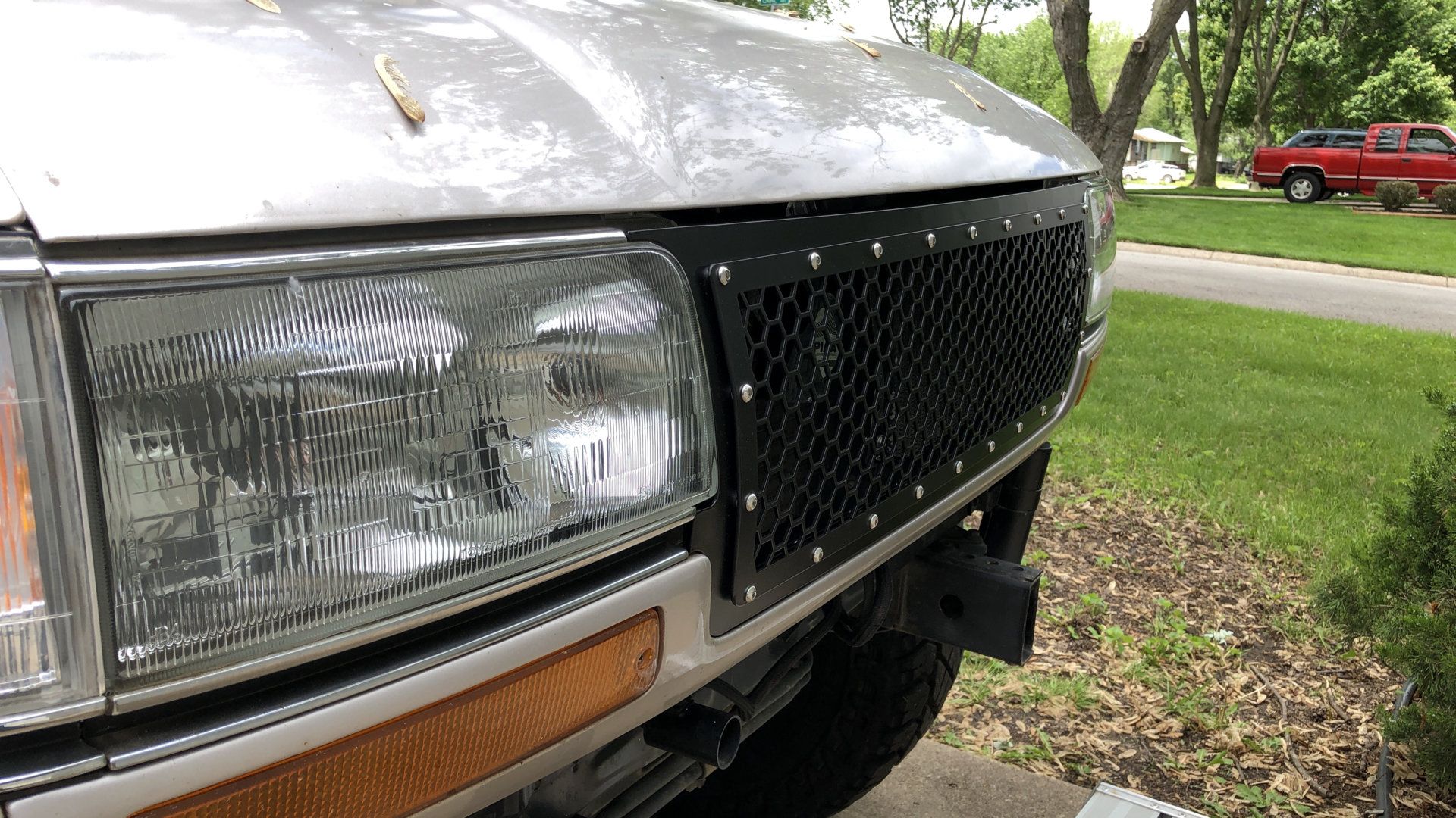

Mounted the grille back on the LX. Fresh powder coat and 316 SS hardware.

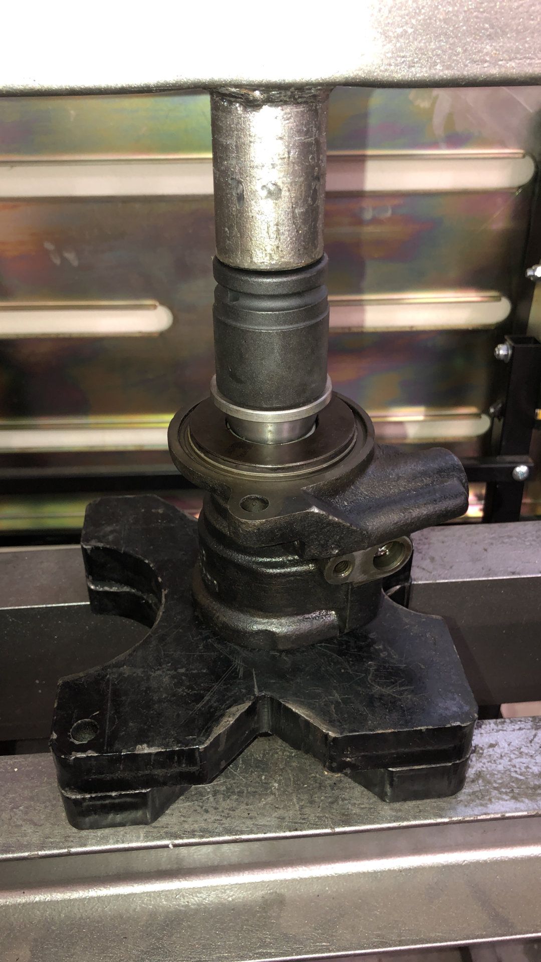

Pulled my leaking power steering pump and rebuilt it. Pretty straightforward rebuild, I did find that old outer pinion bearing minus the cage made a perfect fit for pressing the bearing back in the pump.

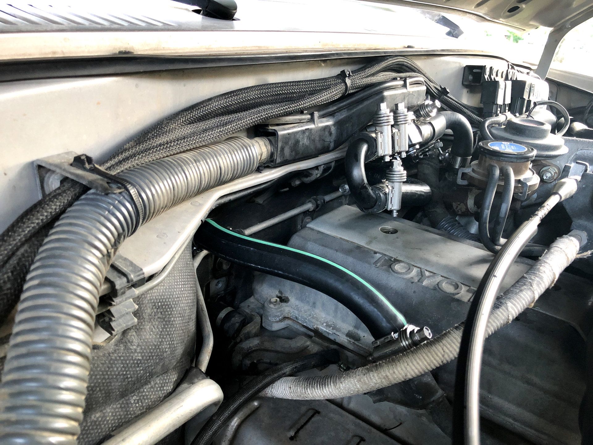

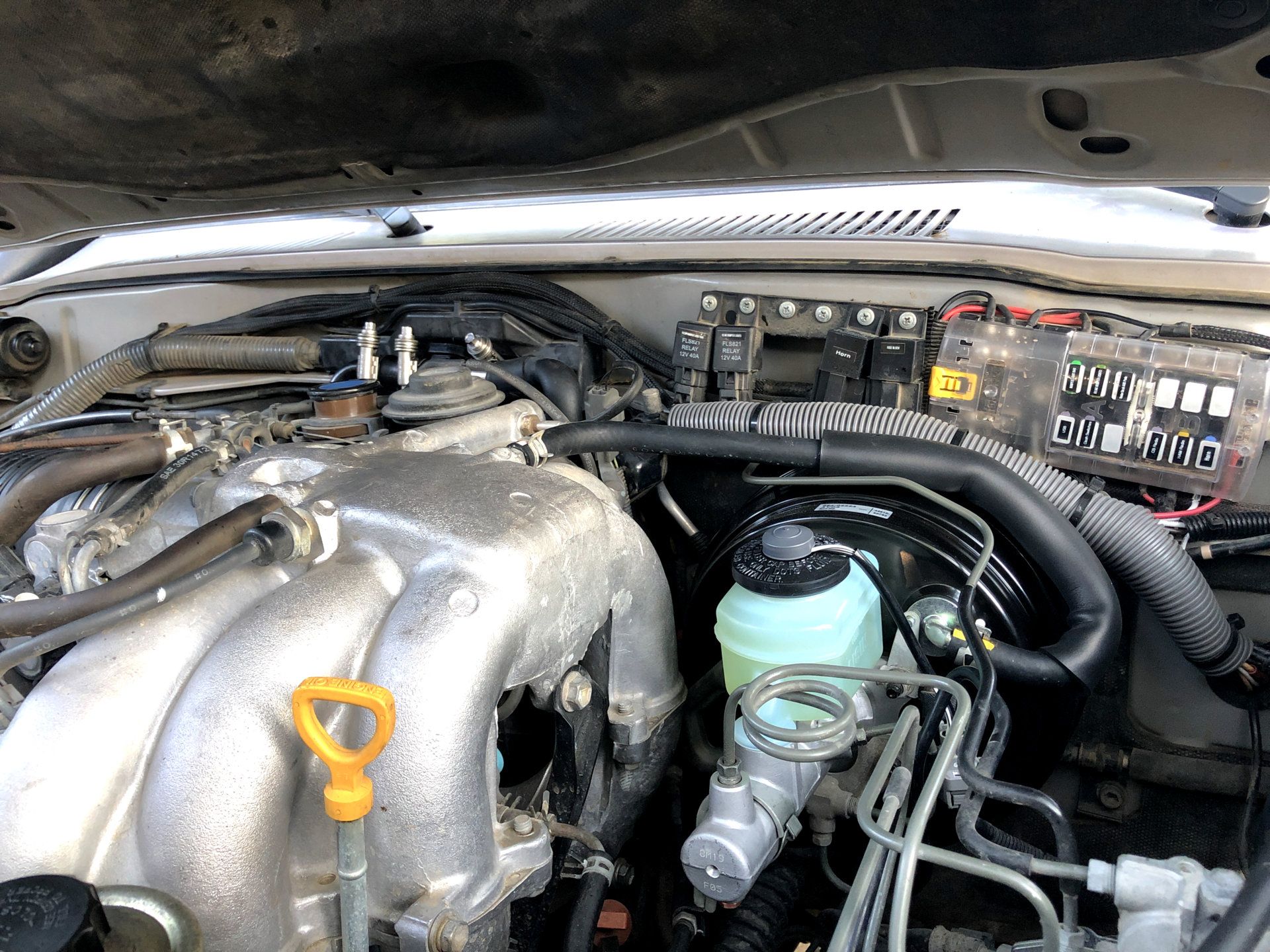

Also replaced the brake booster and mater cylinder. Then replaced the heater control valve, heater hoses, and bypassed the rear heater since I never use it. Still need to get under the truck and remove the old lines and figure out if I want to pull the unit from under the passenger seat.

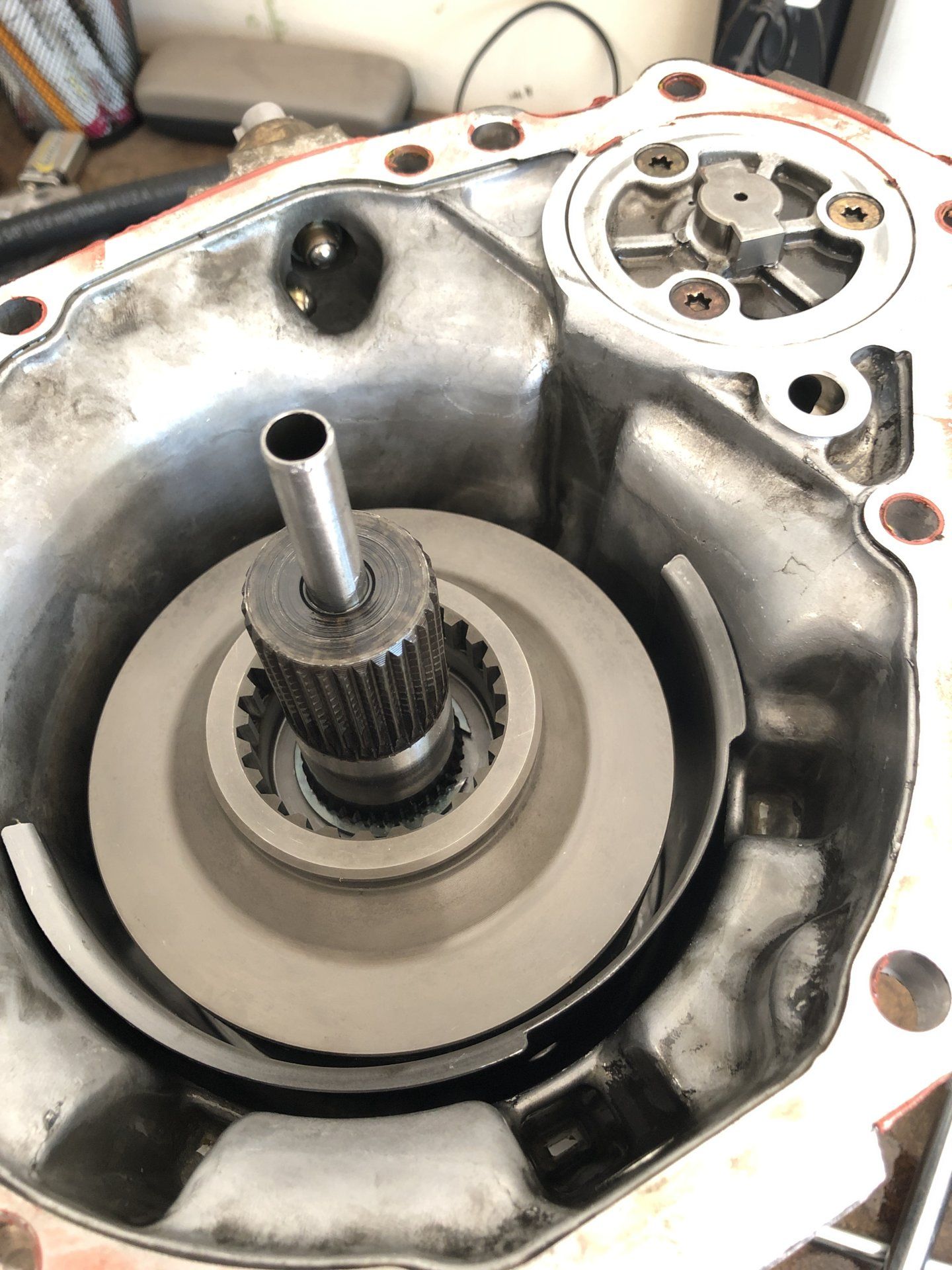

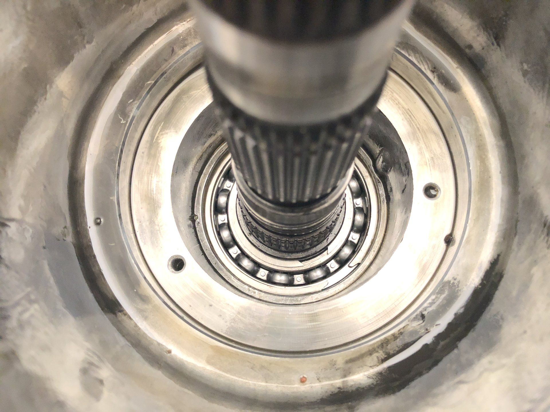

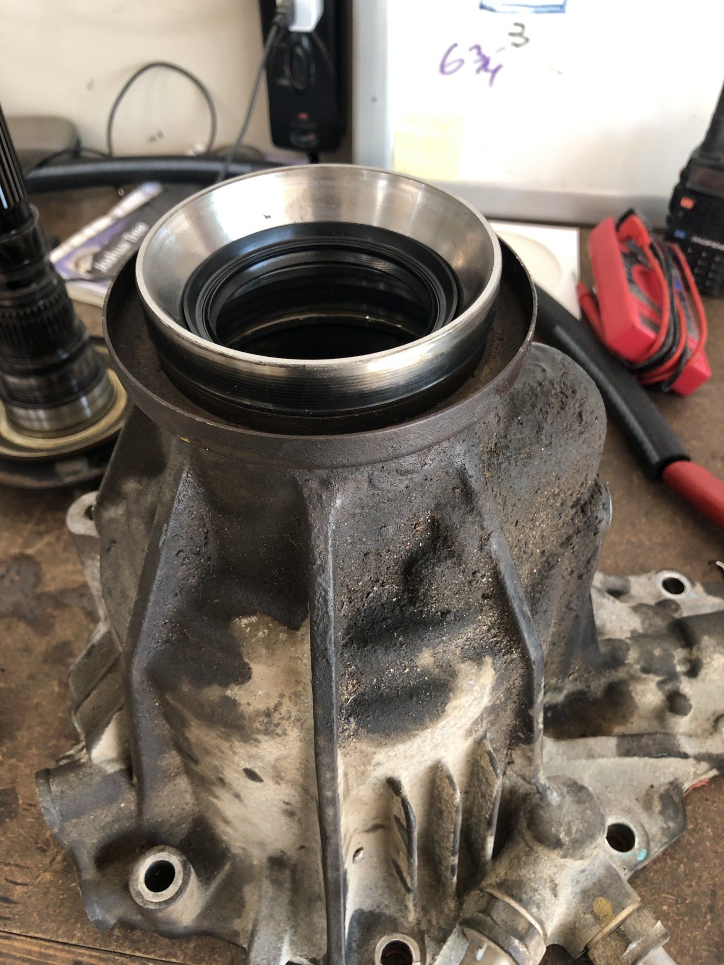

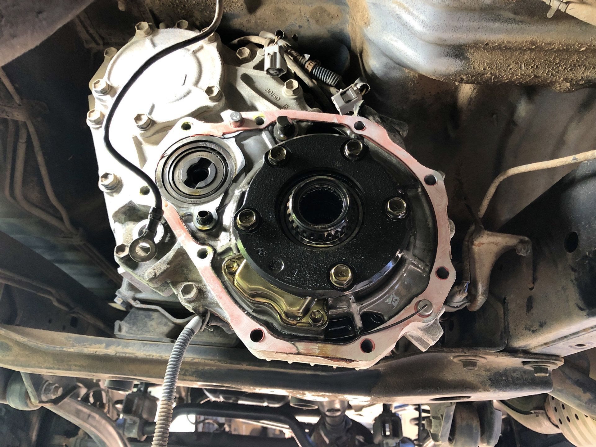

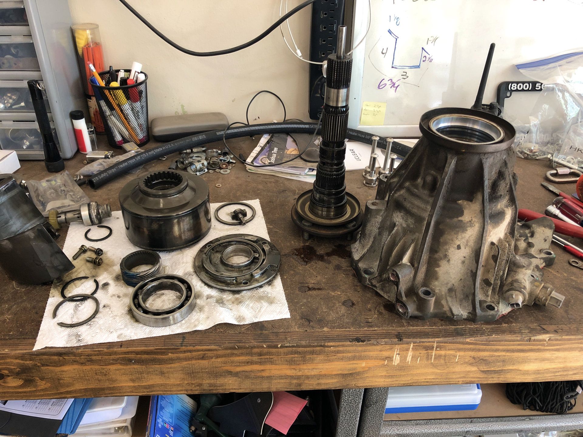

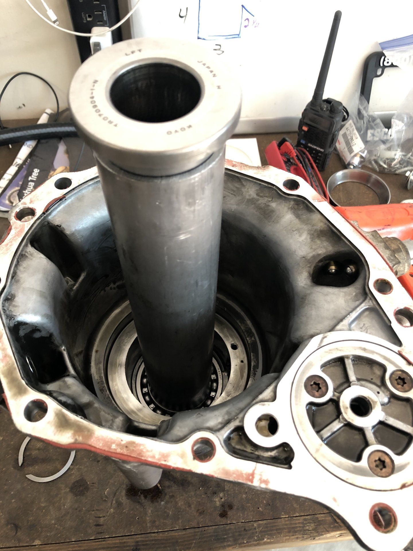

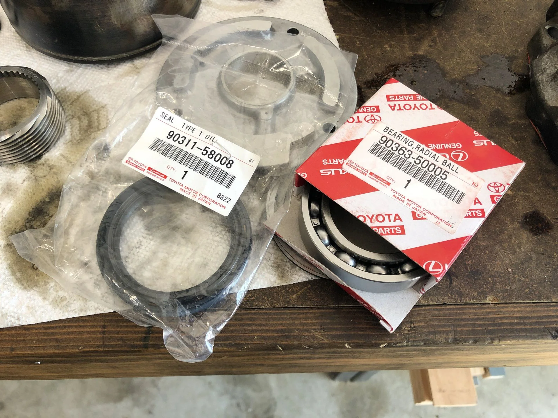

Replaced the rear output bearing on the transfer case today. Pretty easy going if you have the right assortment of tools and miscellaneous pieces of metal to aid in the install. Getting the bearing retaining ring out was the most difficult part. But a long flathead screwdriver and a right angle pick aided in its persuasion. An old bearing race made the new seal install a breeze. And a piece of metal tube made the bearing installation nice and easy. Now I’m back to the rear drivetrain of the truck being VIBRATION FREE!!!
Perhaps I should replace the front output bearing too 🤔

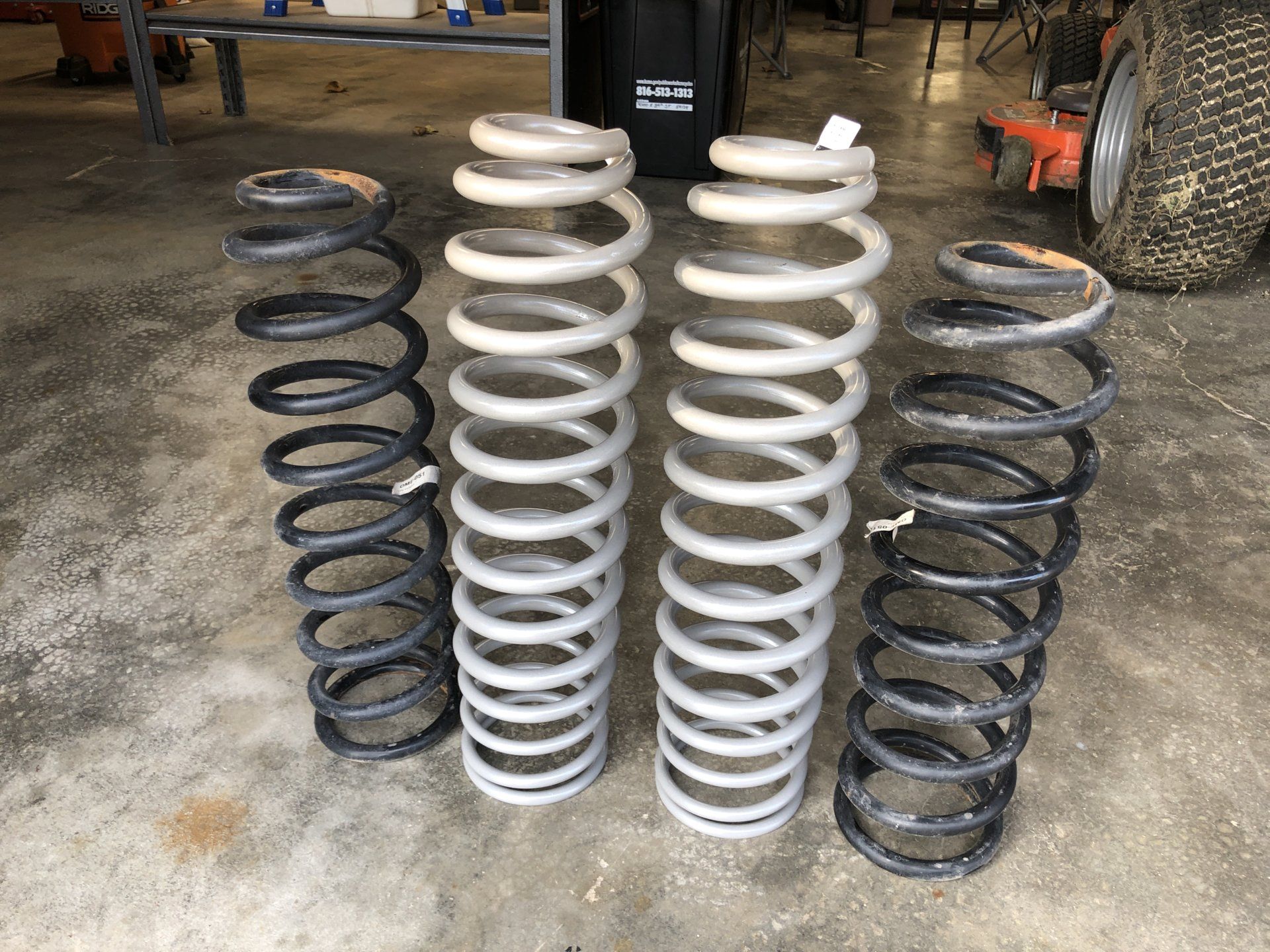

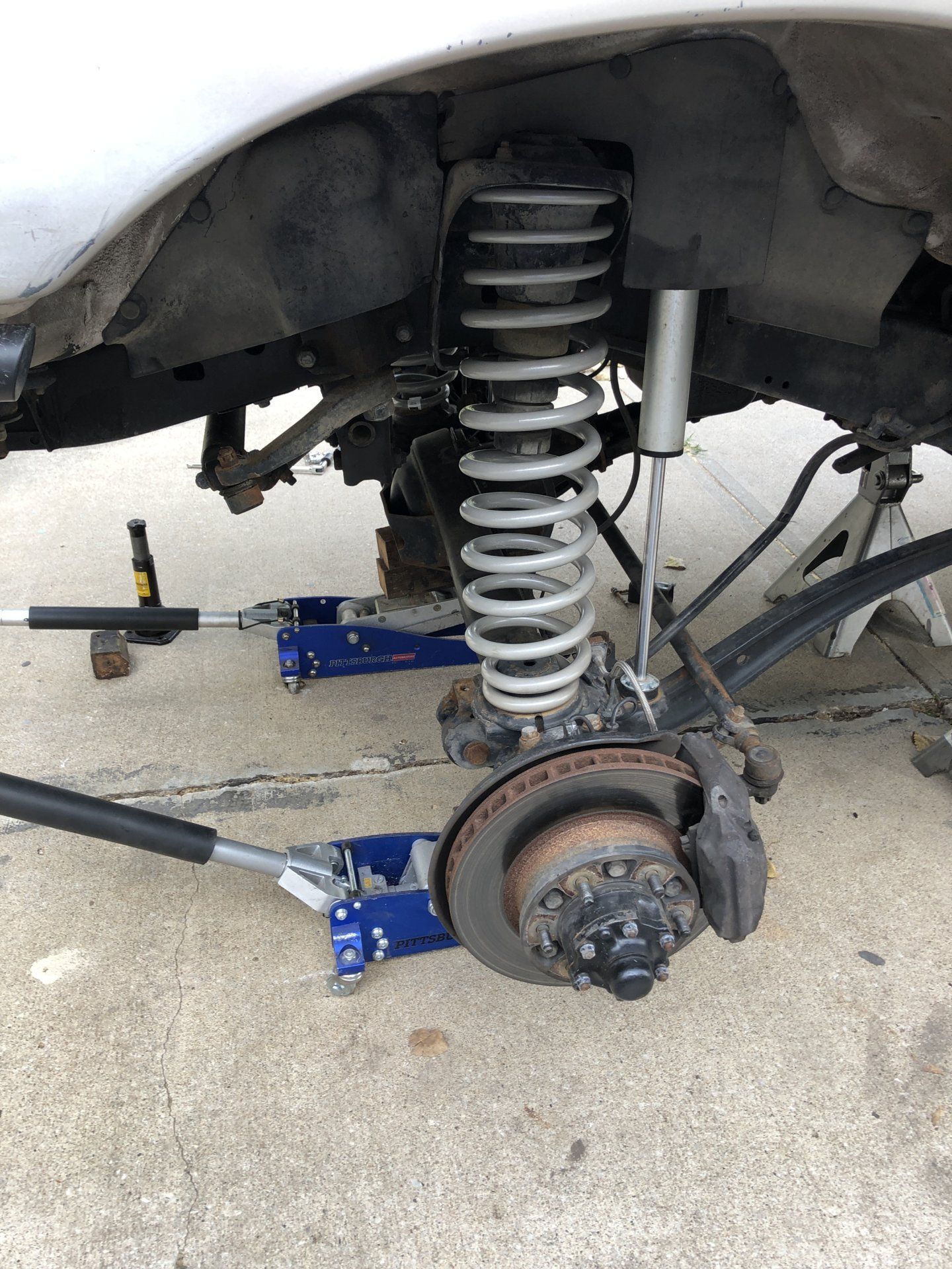

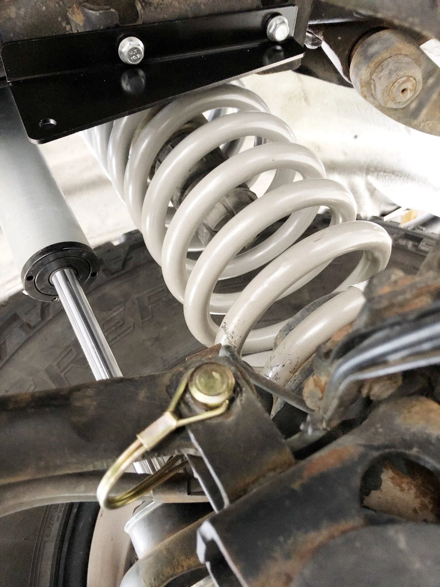

Slinky long travel 75mm springs are going in. Hoping it will lower my COG. I’ll give it a little while to settle before I take some measurements or give my initial review. Also have some long over due items to address this weekend that I’m waiting on to be delivered.
Wow, Slinky
Looks like you got a good powder coat job on that batch...
Mine sat at 23.5" in front settled in at 23.25"

Now I’m going to need to extend my sway bar drop brackets some more. 2” extensions are not enough for the Slinky Long Travel.

Not sure on junior80’s setup but so far it feels pretty solid on the road. Less body roll than I had with the 4+” lift I was running before. I can feel that caster is back on the higher side as the steering feels heavier again. Not so light and darty, I’m using LT plates for 4” lifts. I can’t speak for driveline vibes since I’m running a custom DC drive shaft in the front and have adjusted the rear lower control arm lengths.
I’ll have to wait and see how it handles when load going through an off camber switchback and rock crawling before I say I’m sold on them of not.
But so far, I feel they were worth the price. I just wish I knew if left is left for the springs or is left really right? Waiting for them to settle before really measuring.
Maybe I need to go jump it across some railroad tracks a couple of times :hmm:
