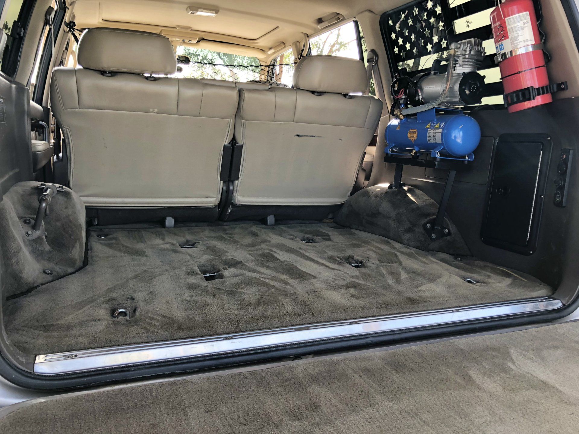

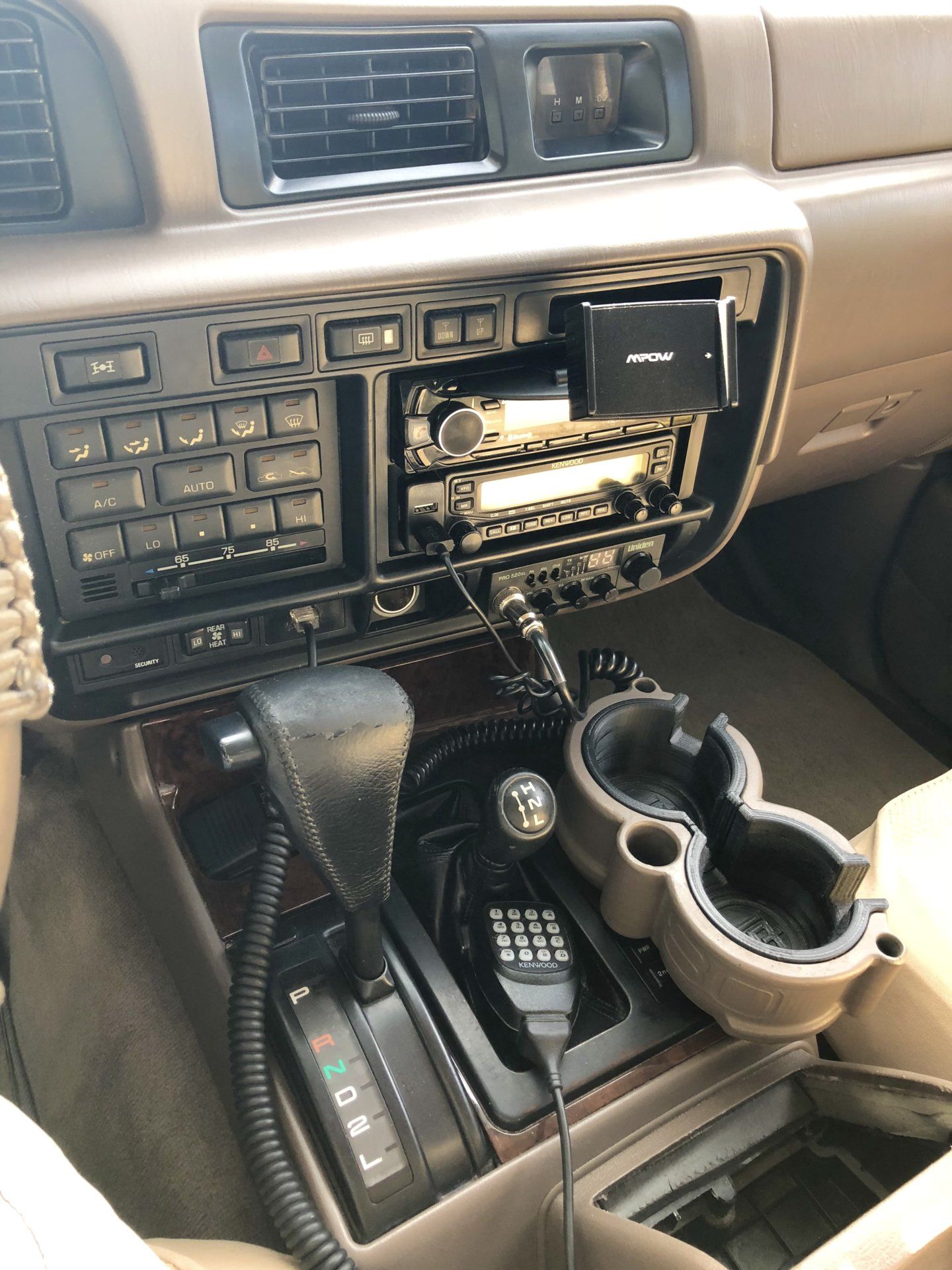

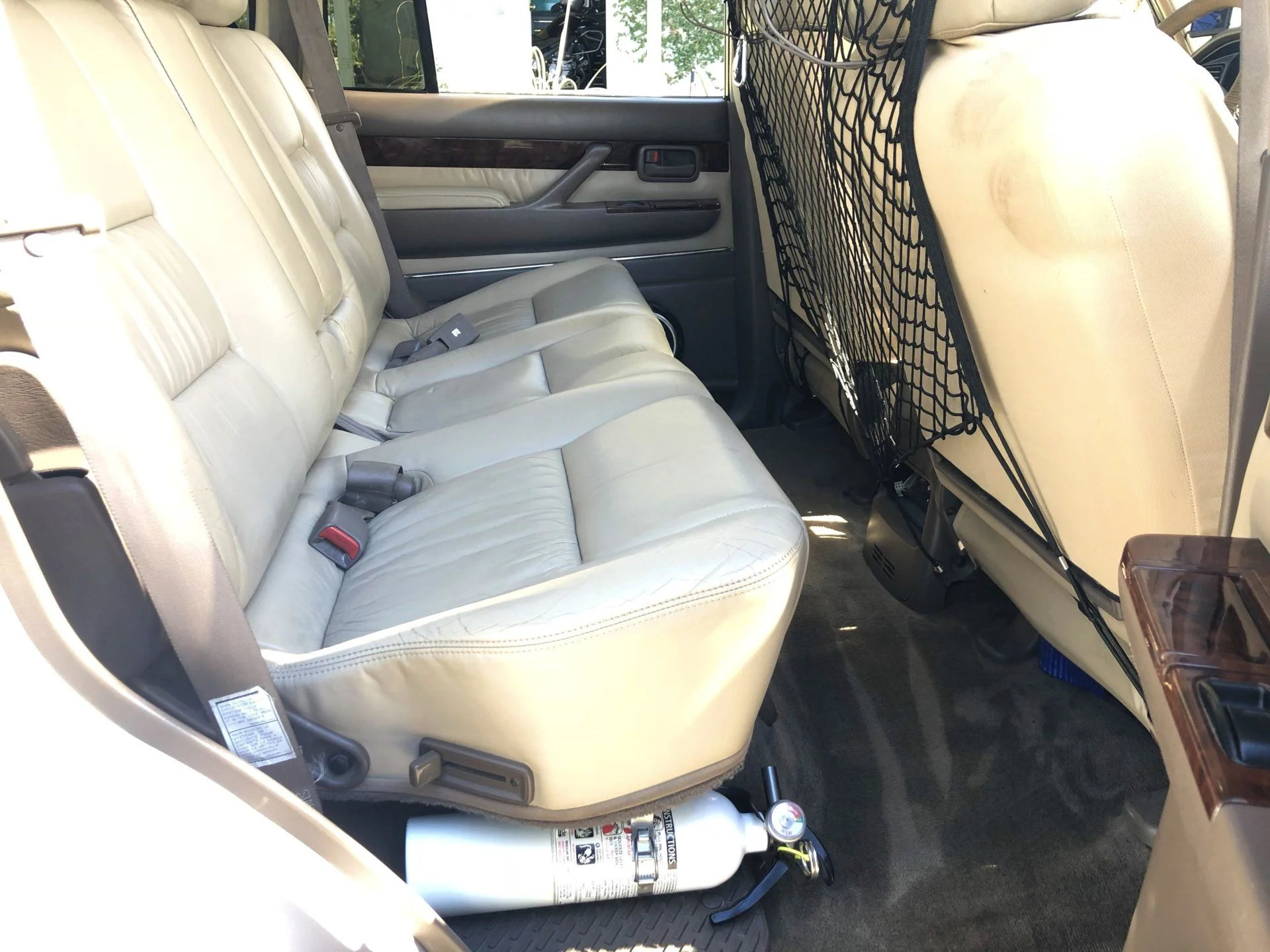

Spent some time on the inside today. After the last trip out the boys managed to track sand and hair everywhere. Vacuumed and shampooed the carpets, cleaned the leather, and gave the interior a wipe down. I’m also trying out one of the CD mount cell phone holders.

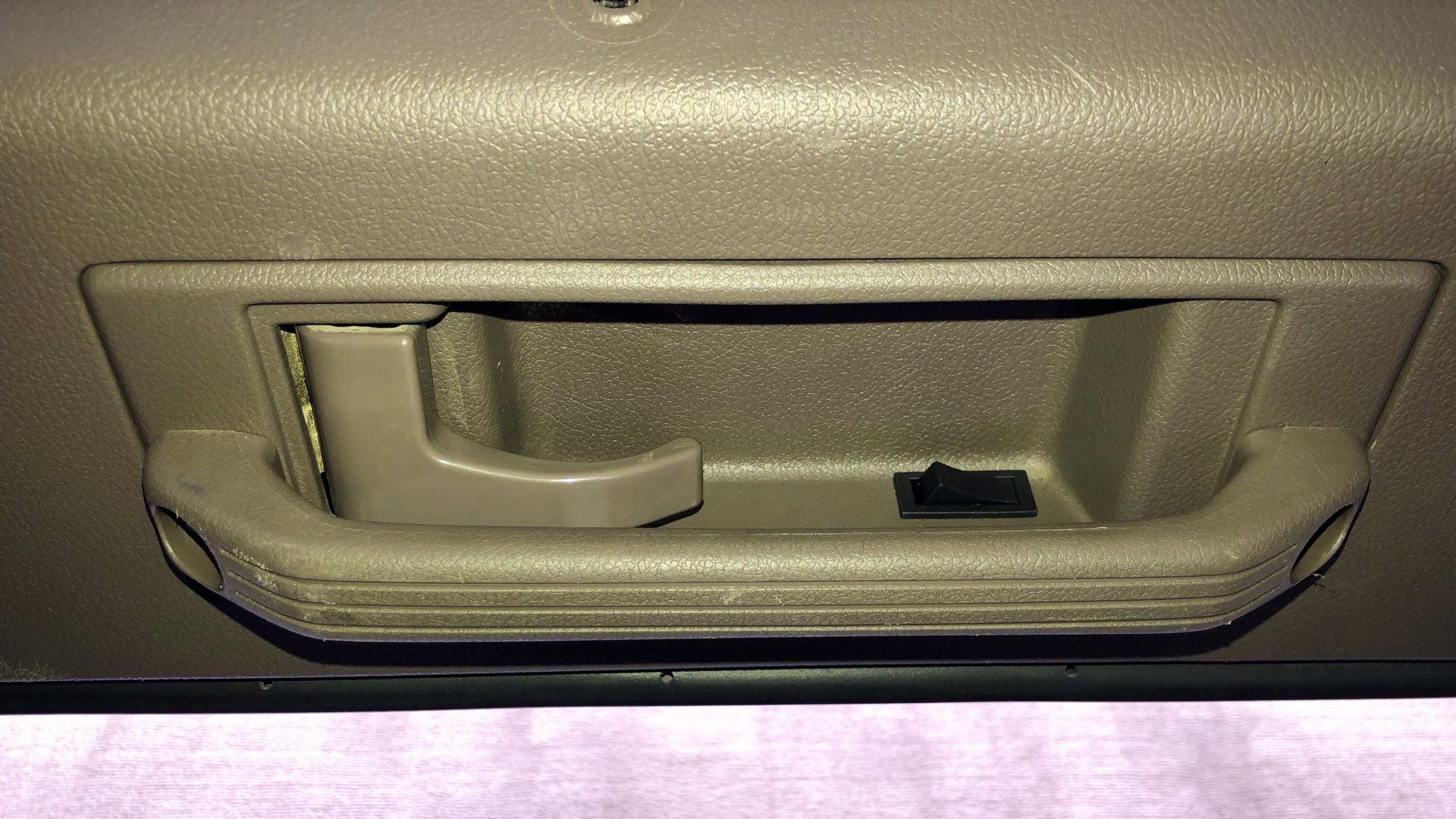

I also finally got around to installing a rocker switch in the rear hatch to turn the interior lights off when the hatch is open.

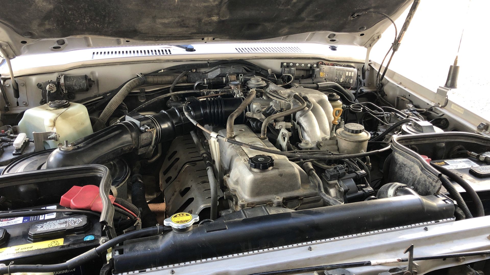

Installed a new air intake hose this morning.
Yes, I am well aware of my throttle cable :rolleyes:.

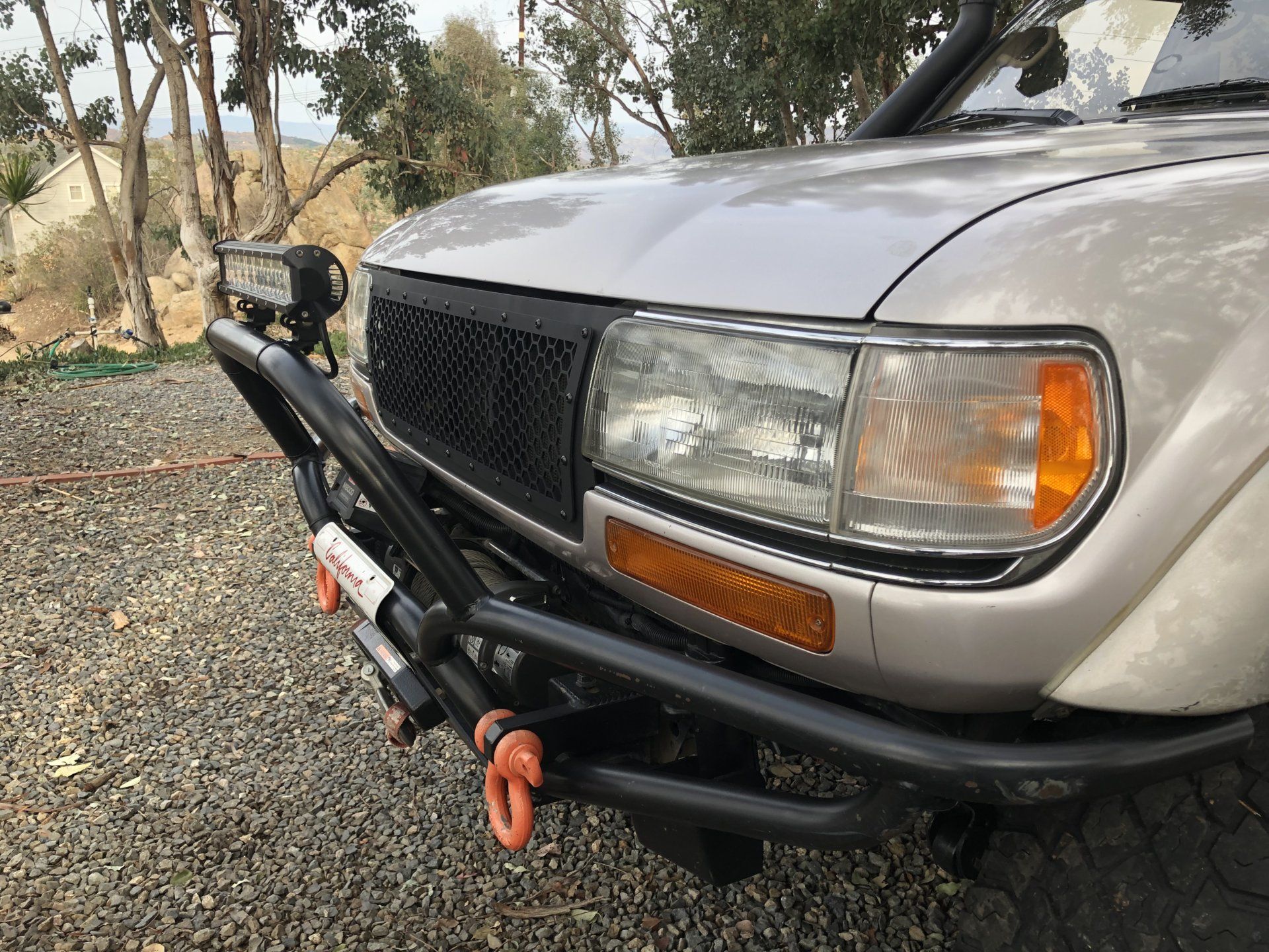

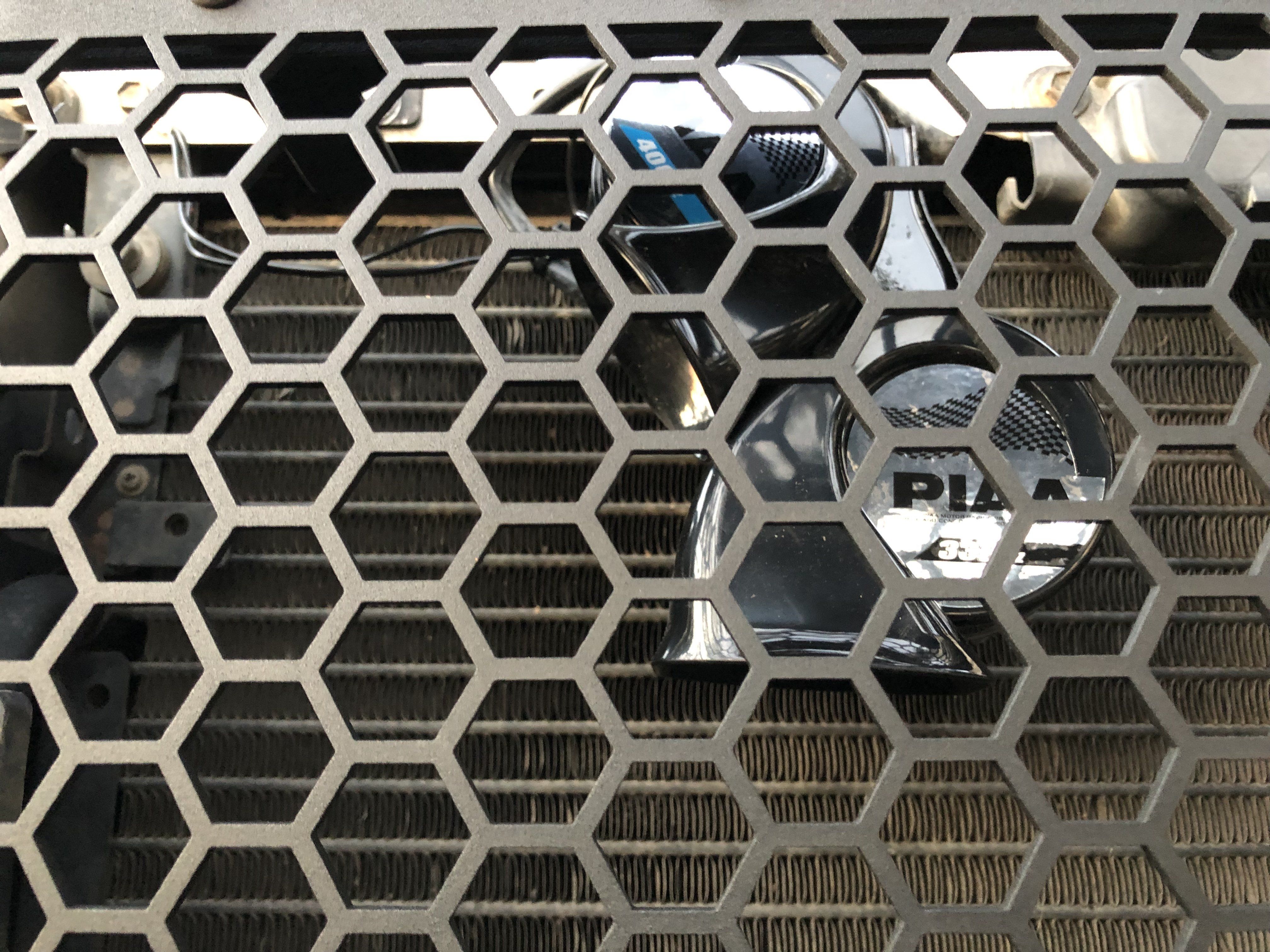

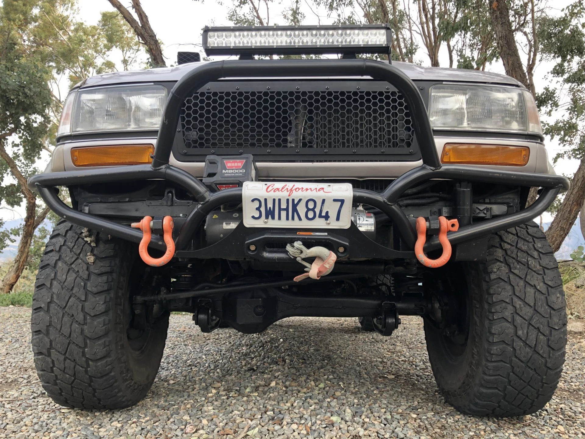

@kelly saad personally delivered this wonderful piece of art to me out in the middle of the desert. Waited till I got home for the install which was a non issue. Fits like a glove. I also replaced the factory horns with a set of PIAA Superior Bass Horns. Muy bueno!

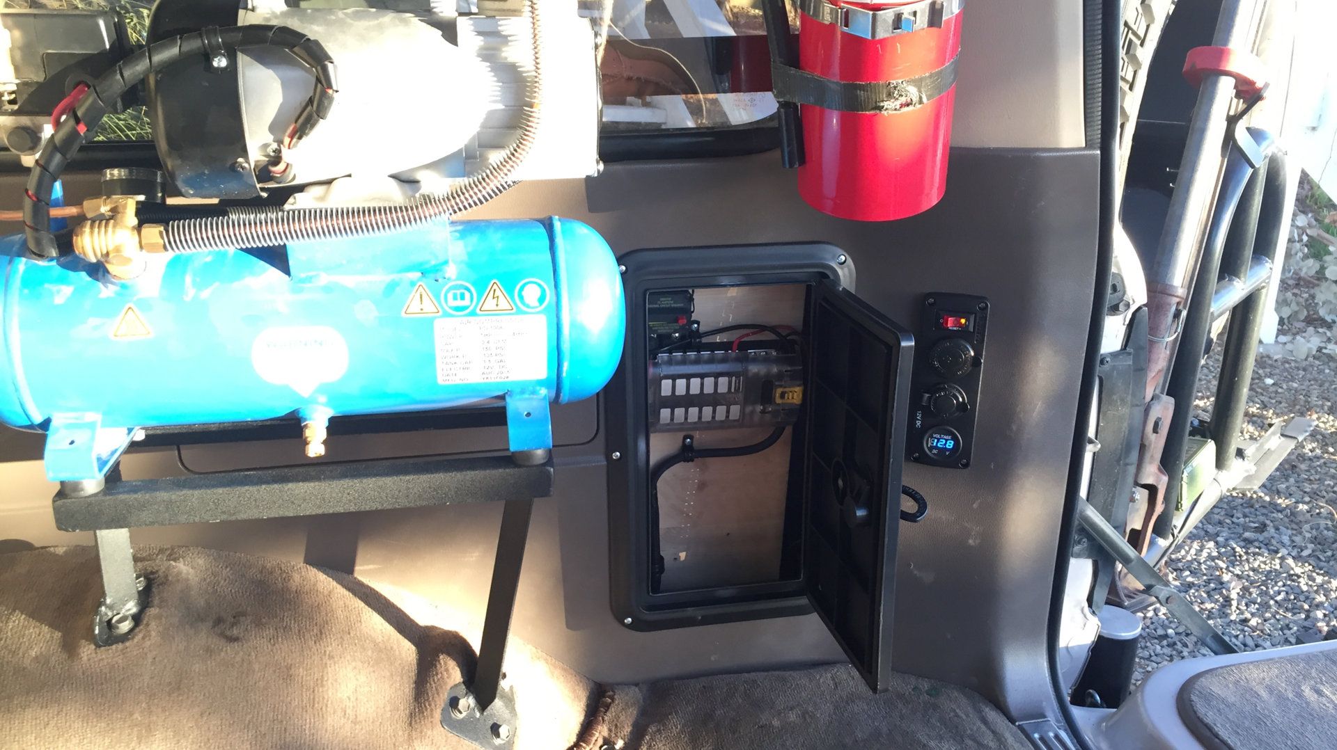

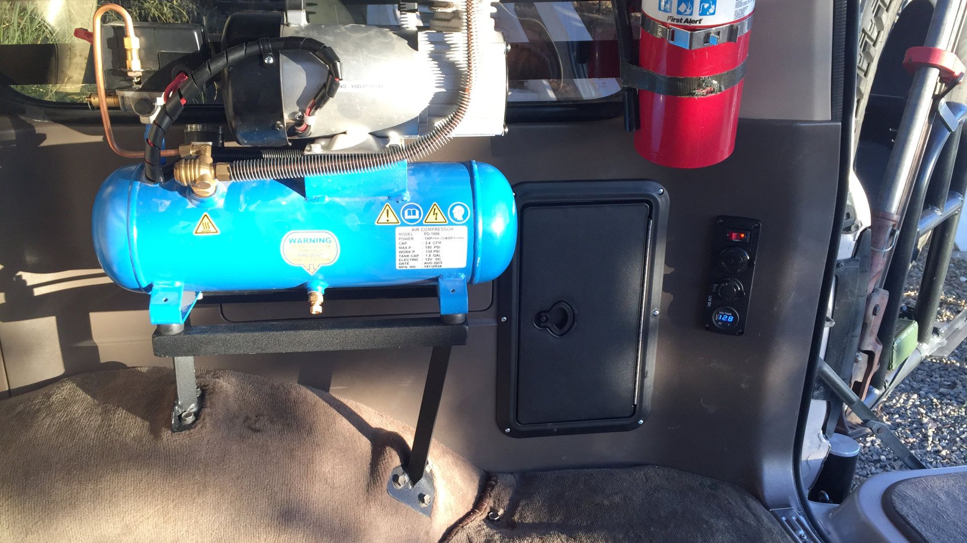

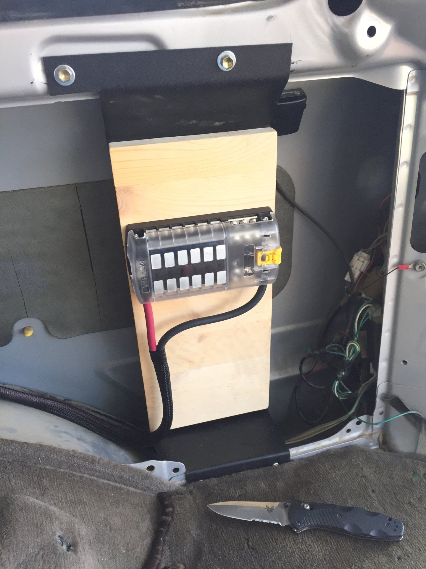

Can I get more info on the build for this fuse setup. Very interested in the way it is setup and wired
What more would you like to know? The rear fuse block is wired to the second battery via 4 gauge wire going through a 100amp circuit breaker. The fuse block is grounded all the way back to the battery. I decided to later add an additional ground to the chassis in rear of the truck (not in the pictures). The positive feed continues to another 70amp circuit breaker than to the puma compressor.

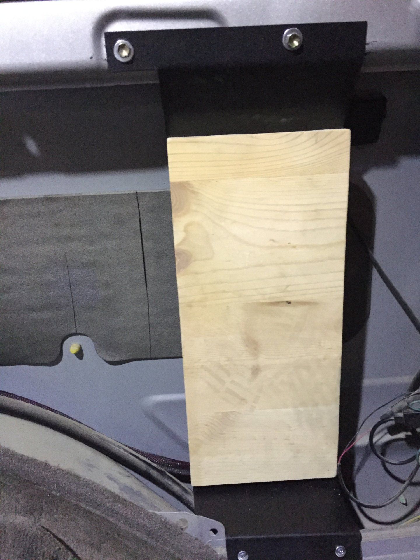

The fuse block is mounted to a piece of plywood as an isolator that is attached to some sheet metal I bent up to fit in the quarter panel.
Here’s a couple of pictures from during the install.
Let me know if there is anything else you’d like to see or any other questions you may have.
