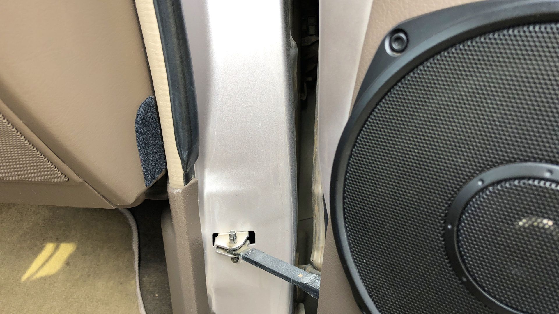

Tracking down a rattle/squeak that had developed recently on the passenger side in or near the door. The noise was present with the window both in the up or down position Sitting in the passenger seat and pushing on the door panel with the door closed duplicated the noise. Upon inspection it looks like the aftermarket speaker grill is just rubbing the dash. Strange that this just started, these speaker have been installed for about 3 years.
A little piece of the felt side of some adhesive velcro and all is silent again.

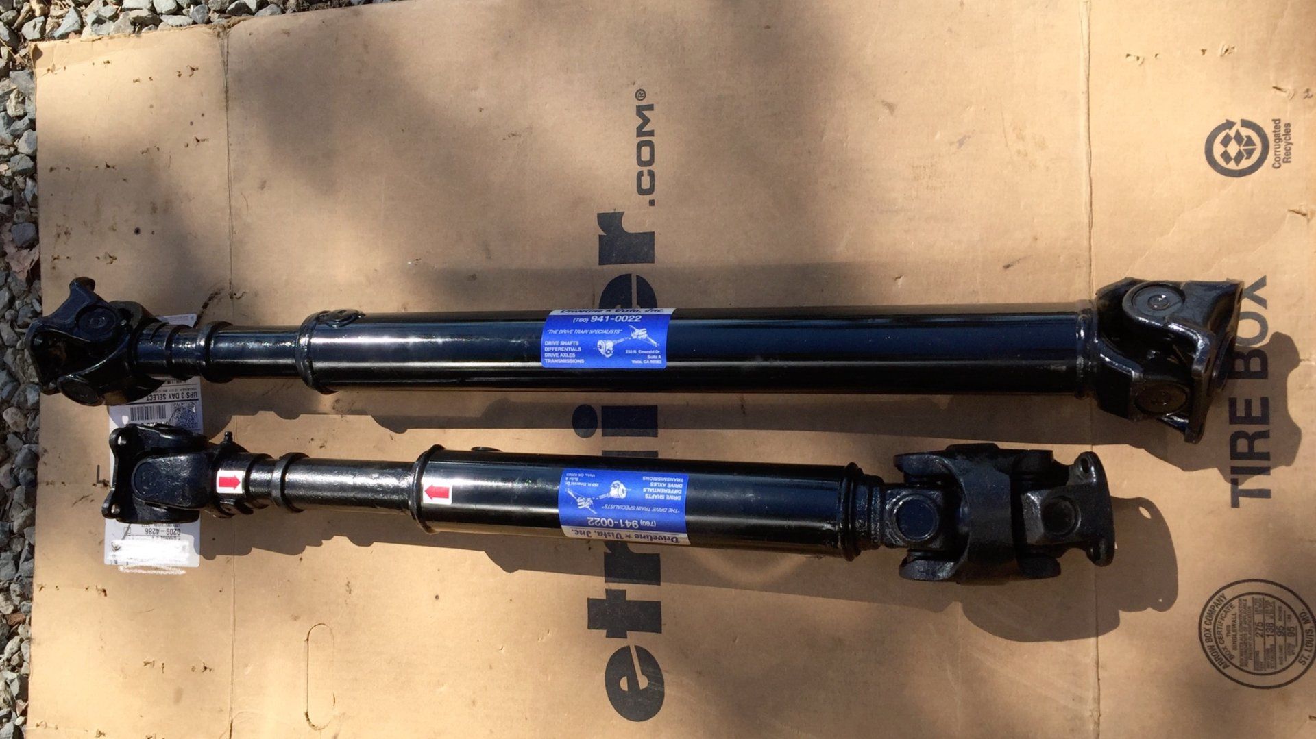

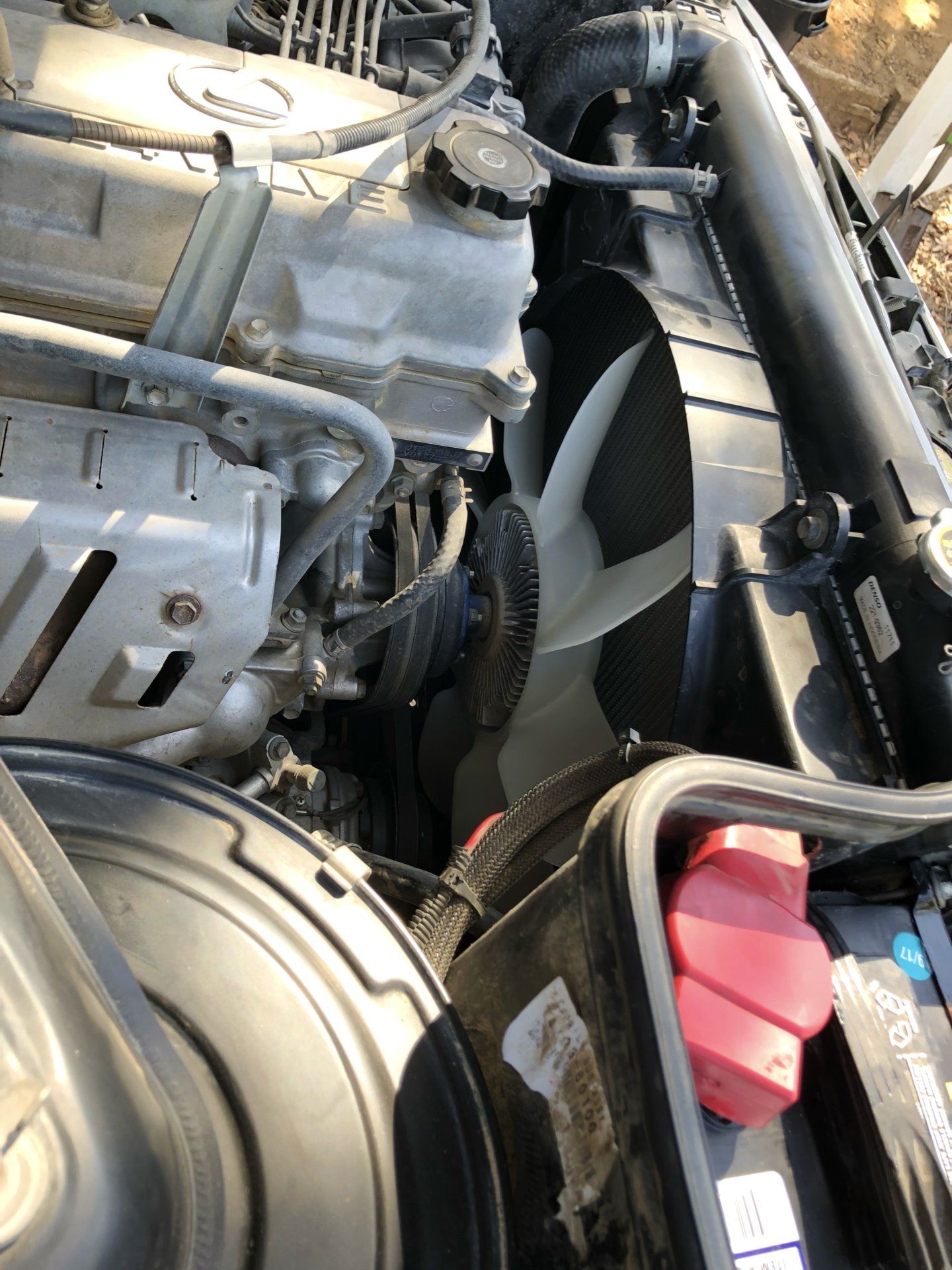

Thanks to @SUMMIT CRUISERS Jr for making me paranoid about the age of my stock fan since I had recently replaced my radiator. Replaced the original 21 year old fan that had 266k miles on it with a new one this morning.

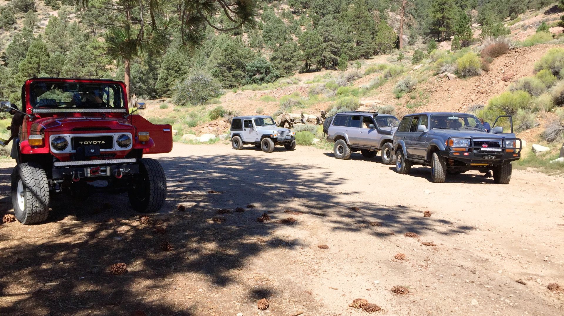

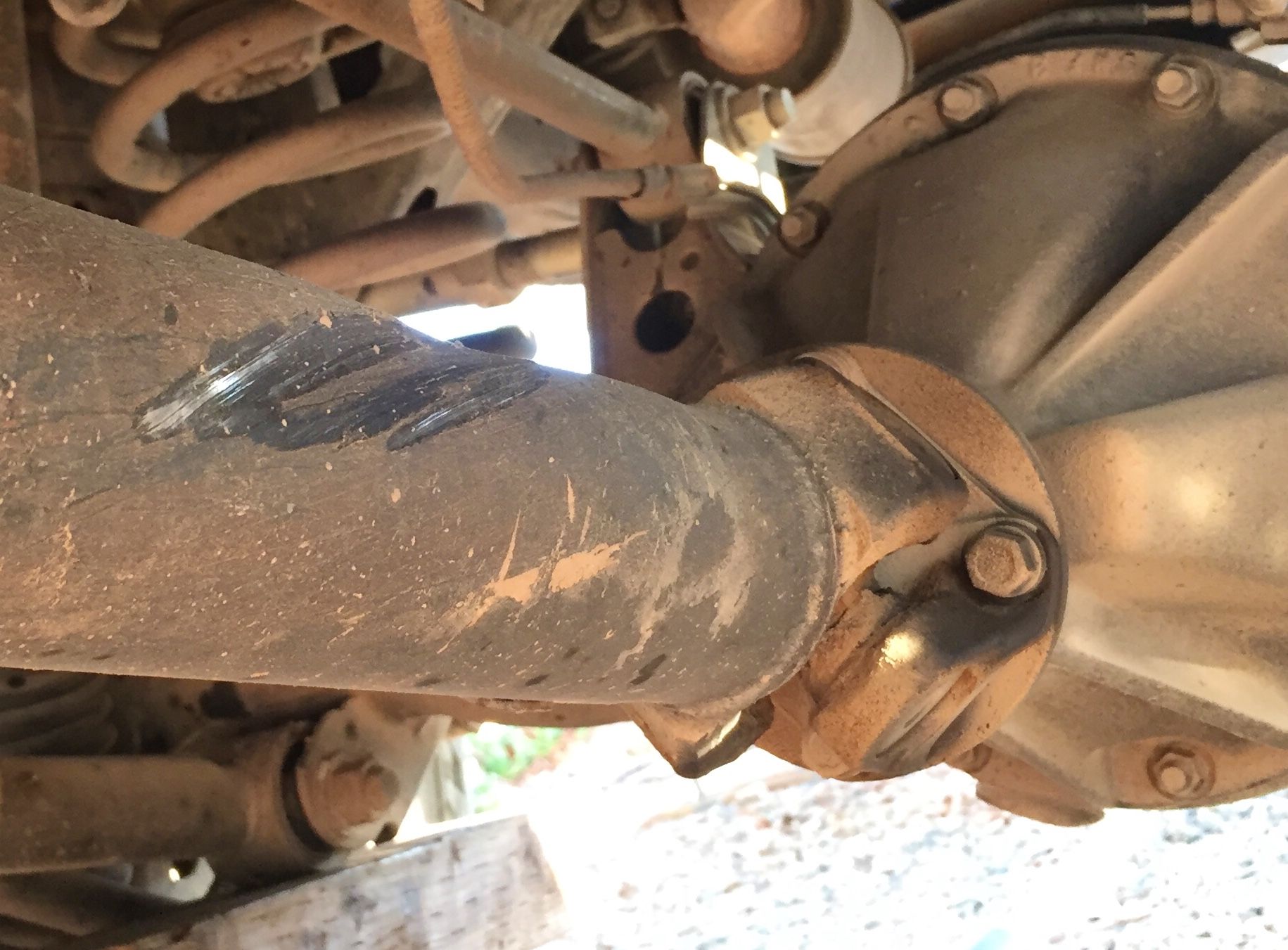

It’s been a while since I’ve gotten out and done any wheeling. But this weekend we went out to Big Bear and ran 3N69, Gold Mountain. I’ve run this trail many times and have never had any issues. Usually all you need is 33’s, sliders, skid plates, and a rear locker. With that setup you can take the easier lines and not have any real issues.

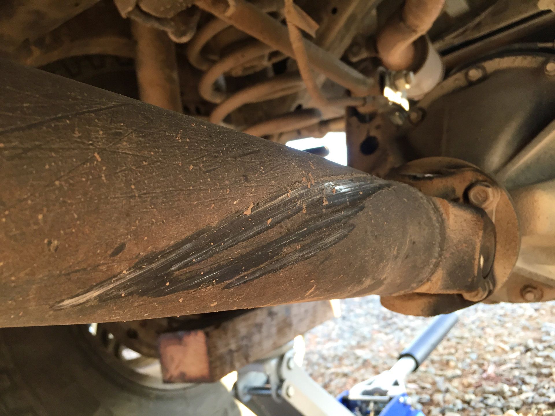

We had a built dual locked 40, my 80, a dual locked armored 80 on 285’s, and an opened diffed heep in our group. (I didn’t know the Jeep was opened diff until he was stuck on the first obstacle.) In any case, even with a good spotter, I managed to catch my rear driveshaft on a rock while cresting the ledge shelf taking the far left line.
In all of our groups defense, this trail is currently in the roughest condition I’ve ever seen it in. No pics of the trail, just my dented rear driveshaft. :frown: This has not been my year for driveshafts.
View attachment 1776499 View attachment 1776500
I trash driveshafts quite often, so your not alone.

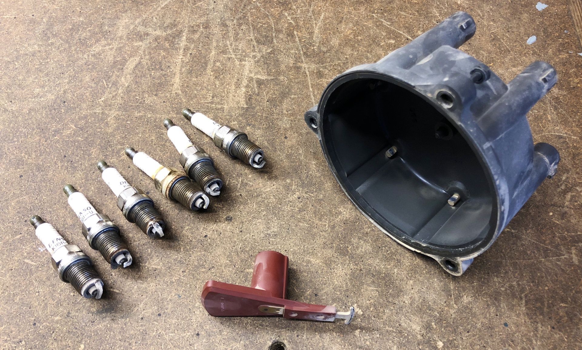

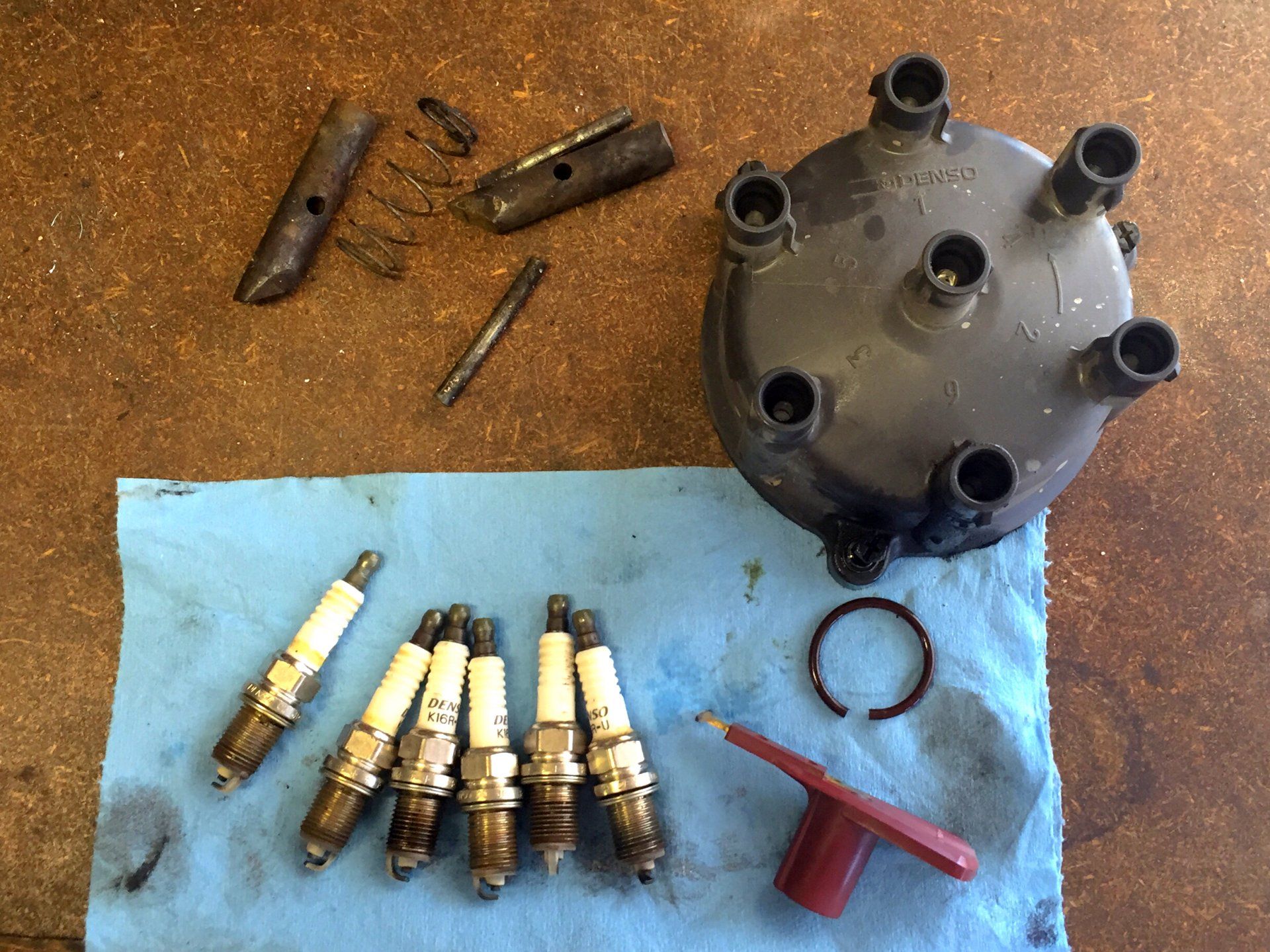

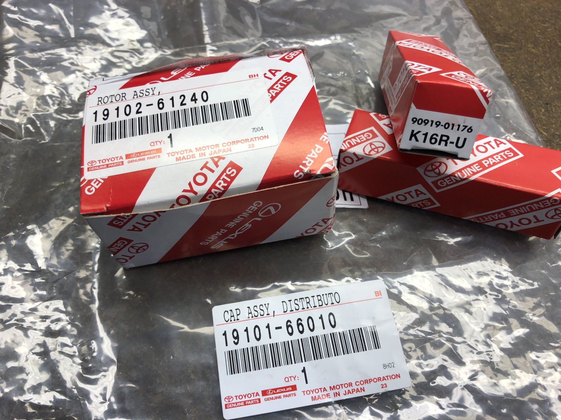

Replaced the spark plugs, distributor cap, and rotor today at 266k. Picture of parts numbers and parts replaced for future reference.

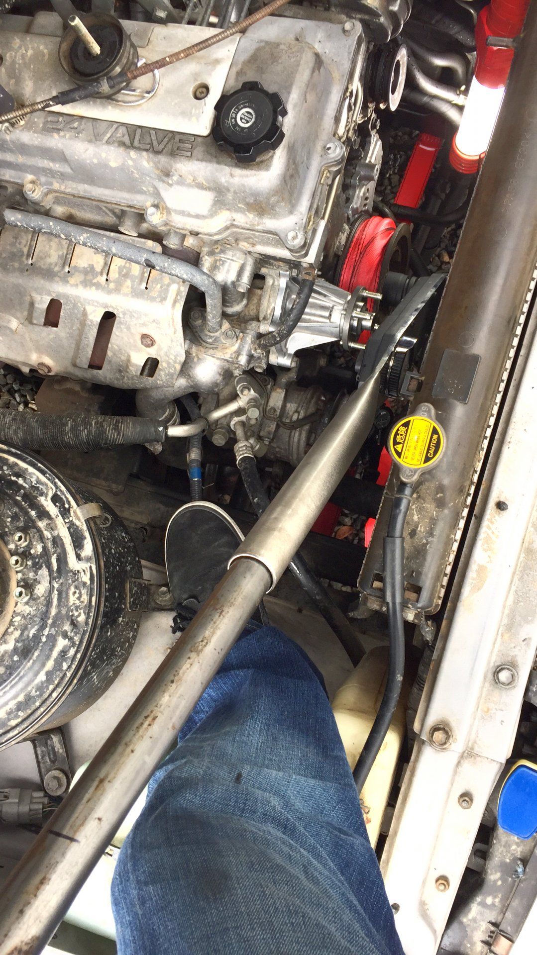

Also I still have driveline vibrations that I want to chase down. Looks like I’ll be pulling driveshafts today to try and isolate which one.

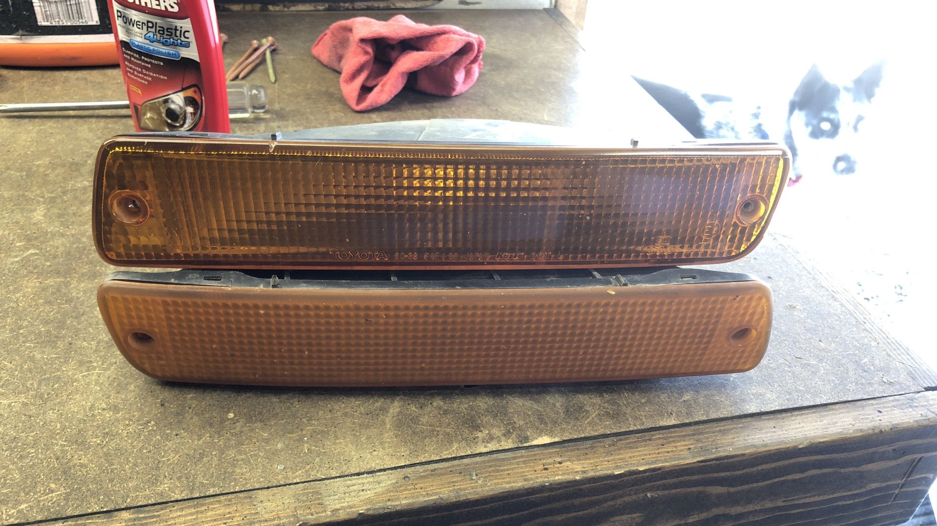

Found the plastic headlight polish in the garage so I gave the turn signals and marker lights a once over. I hadn’t realized the turn signals were that bad.
(Yes, my dog has light blue almost white eyes, the contrast exposure isn’t helping here).

Now you have me thinking about my cooling fan with 286k. I just replaced my radiator and the fan looked great. I need to stay off Mud........
