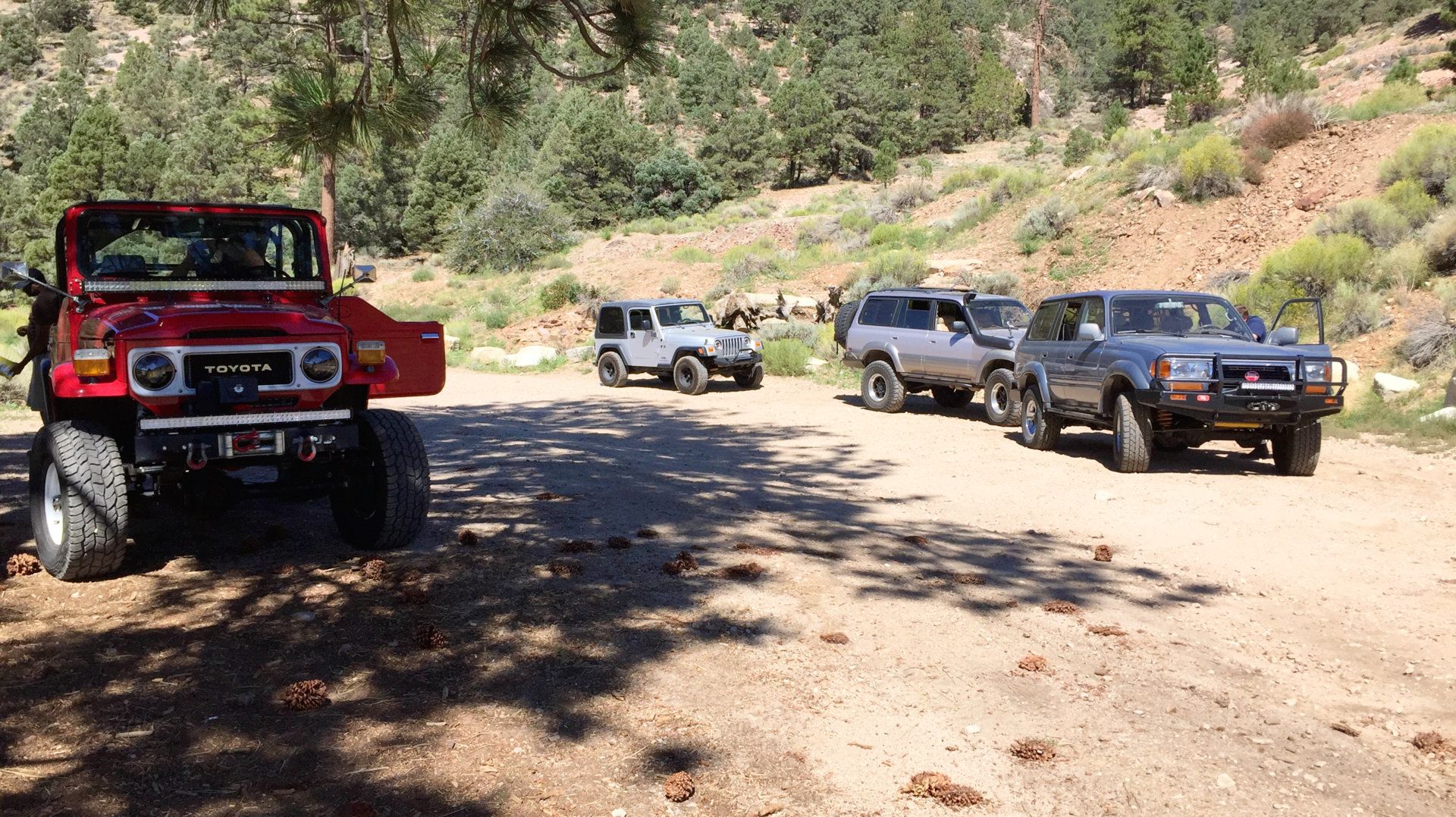

It’s been a while since I’ve gotten out and done any wheeling. But this weekend we went out to Big Bear and ran 3N69, Gold Mountain. I’ve run this trail many times and have never had any issues. Usually all you need is 33’s, sliders, skid plates, and a rear locker. With that setup you can take the easier lines and not have any real issues.

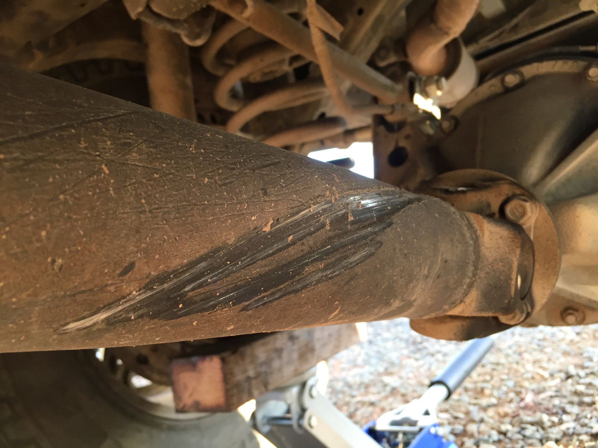

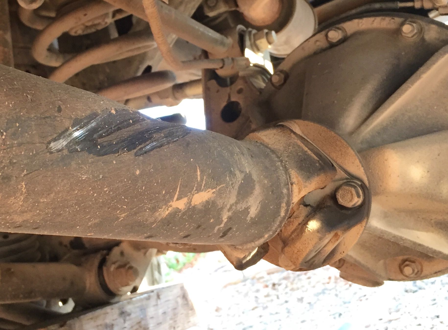

We had a built dual locked 40, my 80, a dual locked armored 80 on 285’s, and an opened diffed heep in our group. (I didn’t know the Jeep was opened diff until he was stuck on the first obstacle.) In any case, even with a good spotter, I managed to catch my rear driveshaft on a rock while cresting the ledge shelf taking the far left line.
In all of our groups defense, this trail is currently in the roughest condition I’ve ever seen it in. No pics of the trail, just my dented rear driveshaft. :frown: This has not been my year for driveshafts.
Round 3. We’ll see how long these ones last.

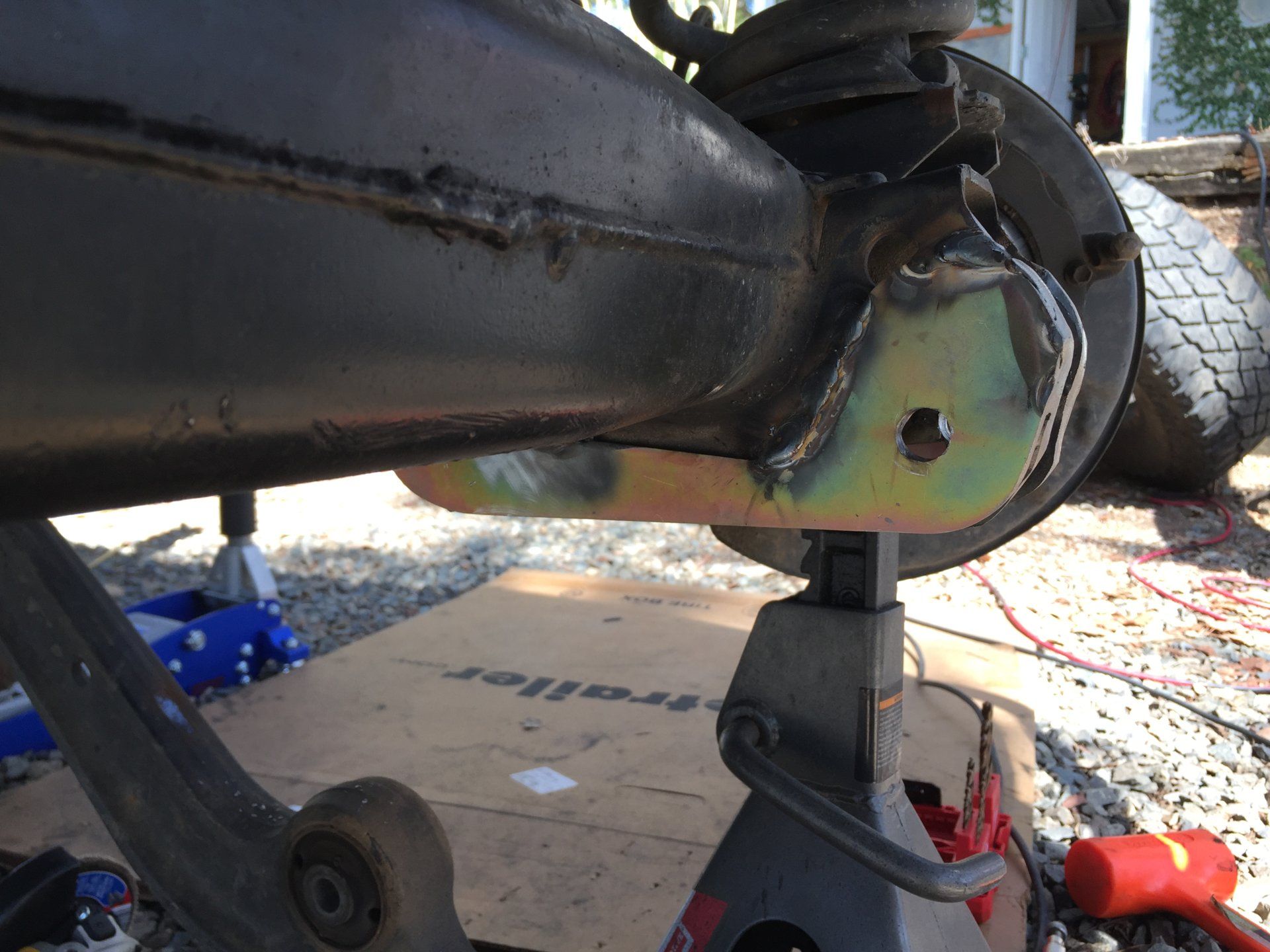

I swapped caster plates from Slee’s to Landtank’s via Wit’s End this weekend. The reason for this was to change the caster angle by rotating the axle on its center axis vice piveting it on the rear mounting bolt.
In my case for correcting for a 4” lift, it resulted it a few more degrees of caster. Still need to get over to the alignment shop for actual numbers but i could feel the improvement when I drove it afterwards.
To mount the new plates I first welded back in the material that was originally removed during the previous plates installation. Grounded it all down for a nice flush fit. Next I tack welded the new plates in place, followed with a few beads burned in to hold it in place. Then drilled the new holes as required with a right angle drill. Torqued down the new bolts to 127 ft lbs with a little red loctite for good measure.

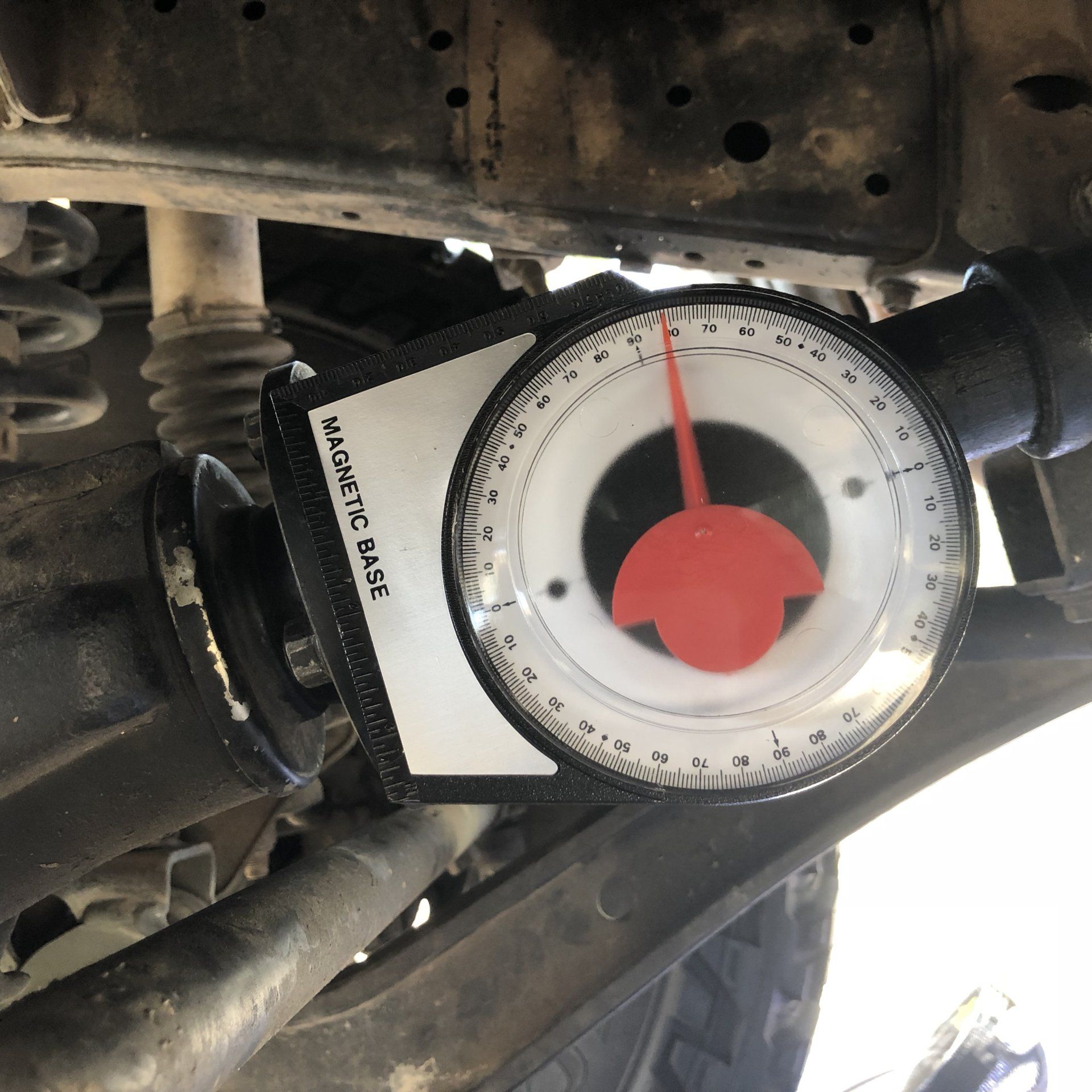

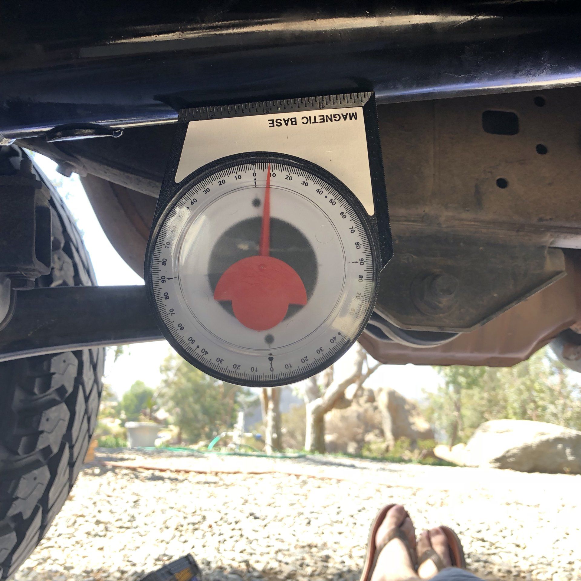

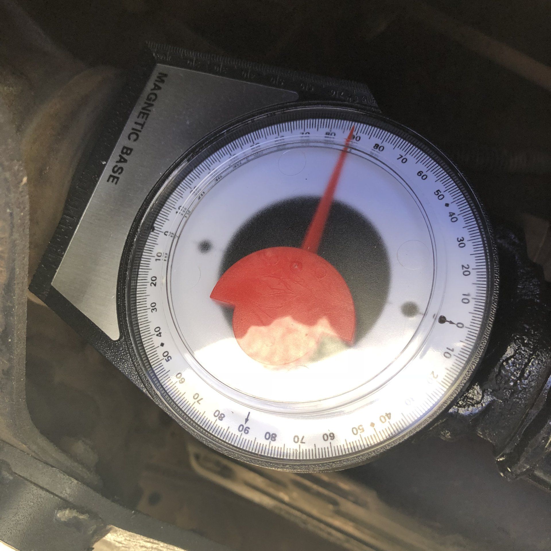

Is your pinion angle still good for the front DC shaft? Mine is perfect with the deficient castor readings. This fact has left me concluding that in order to do it right and maintain proper pinion angle with a full 4* of castor, a cut an turn is necessary.
Please post your castor results after you take it to a shop. I have Slee plates, 5” front lift and less than 1* castor angle. A cheap solution is always good.
Pinion angles of my front DC shaft (not on a flat driveway)
My caster is at 1* currently. To get to 4* I’d have to cut and turn plus design new radius arms or pursue a 3 link. The tie rod is just in the way for any other solution.
View attachment 1782015 View attachment 1782014

I would suggest you drive a truck with the other plates and decide for yourself. I can “feel” the difference. The truck is less darty on the road and feels more planted while cornering. I honestly wish I would have measured the angles before I changed the caster plates to see the difference.
