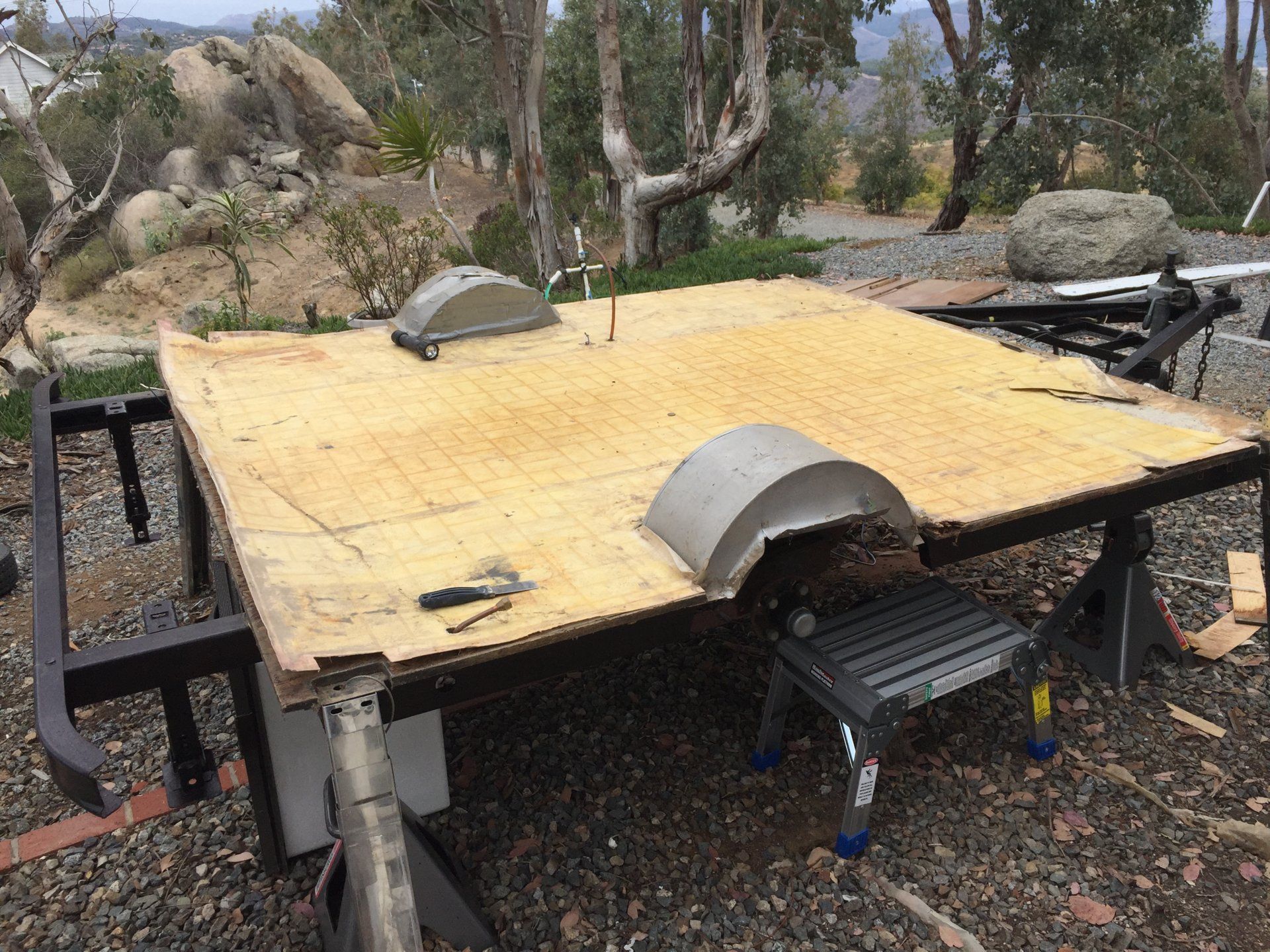

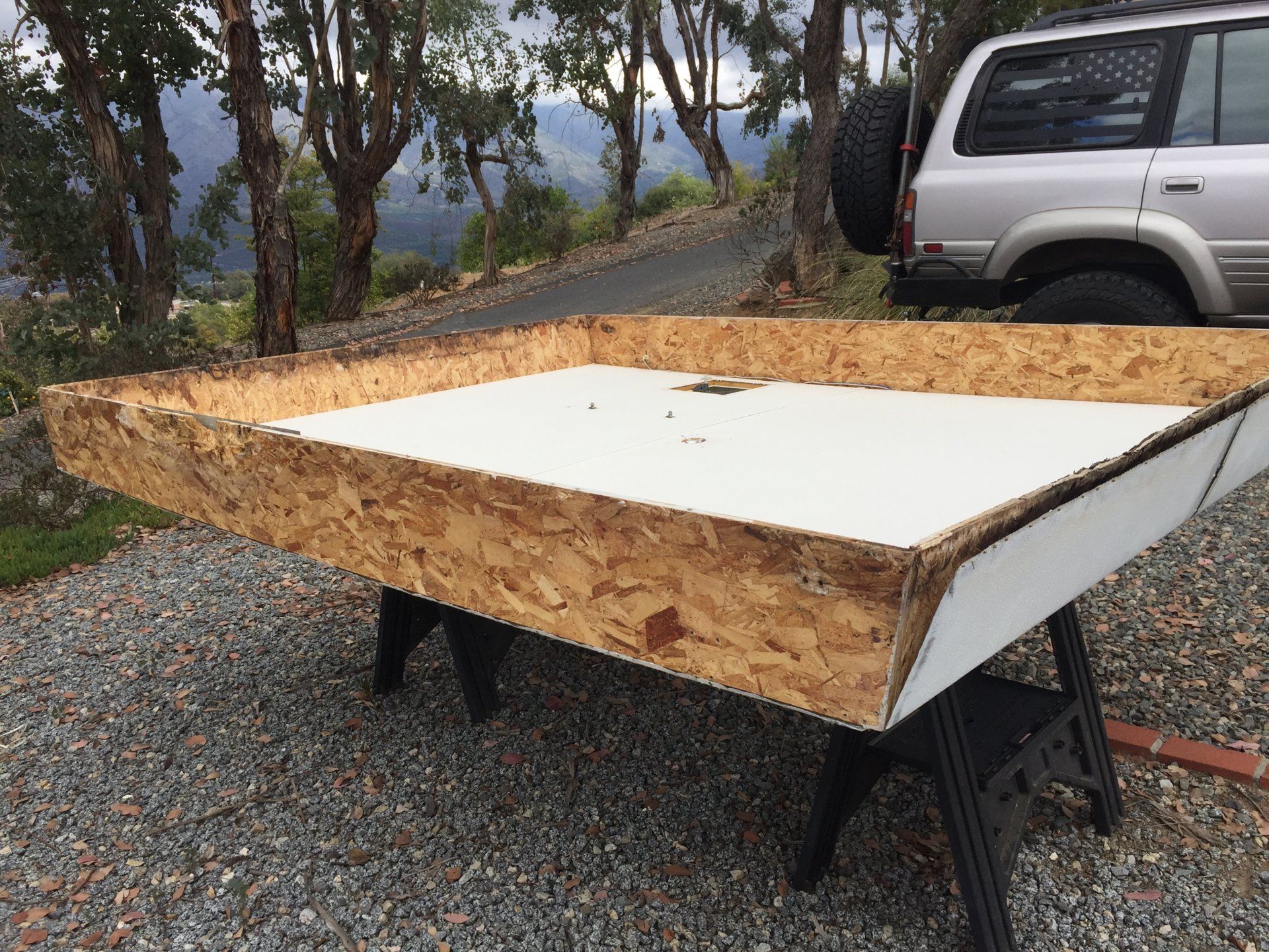

And the reason my truck hasn’t been getting that much love recently is because I acquired a pop up camp trailer that quickly became a full restomod project.
Popup Camp Trailer Build

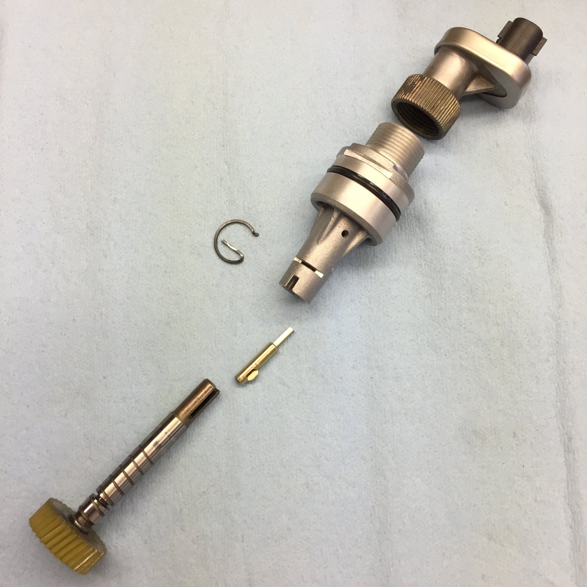

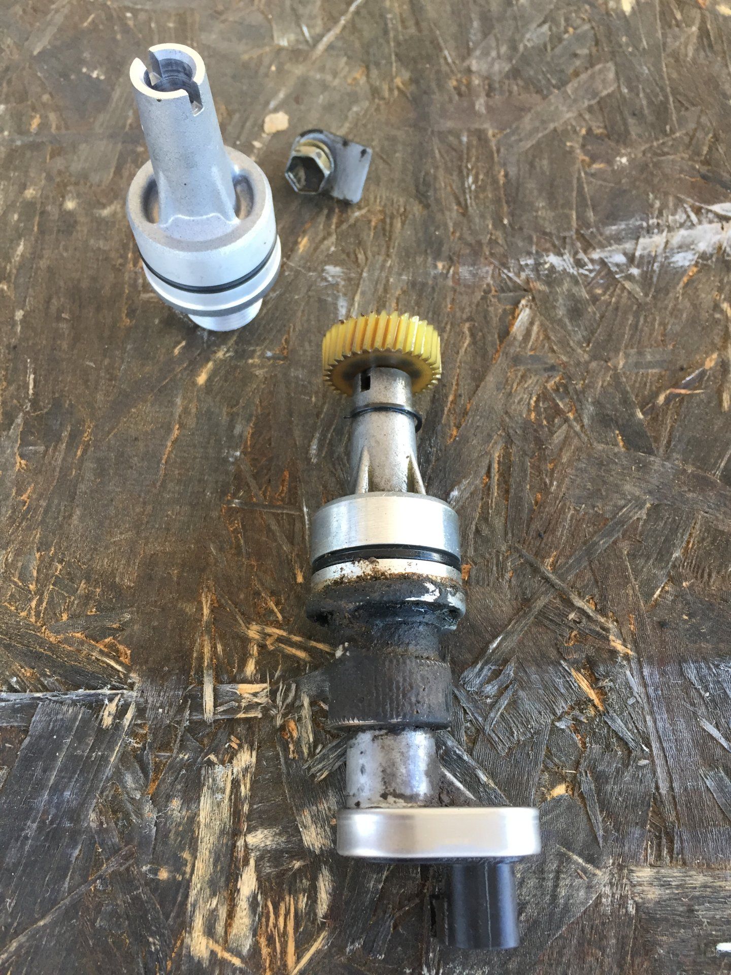

Finally got around to fixing my transfer case leak. The o-ring in the speedo gear thing had gone bad. Changed the TC fluid while I was there.

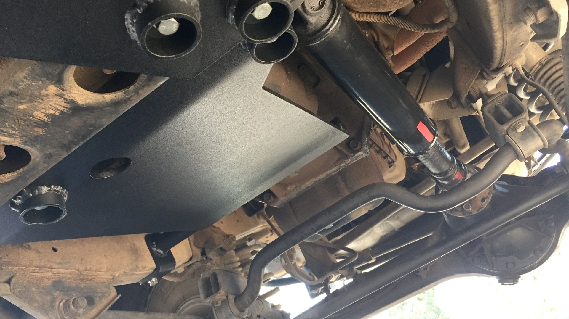

Also installed a new front driveshaft from @NLXTACY, thanks again Joey!

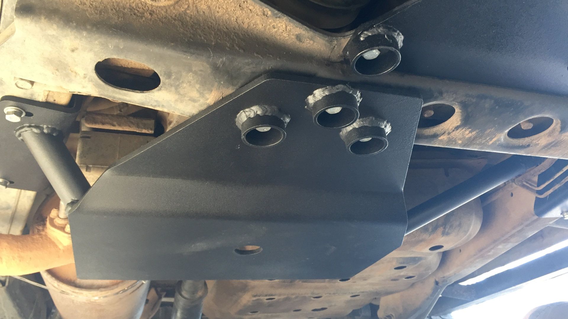

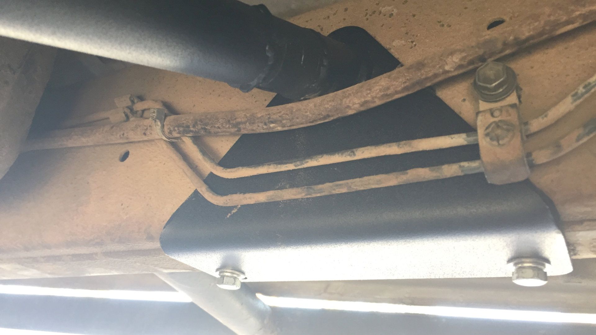

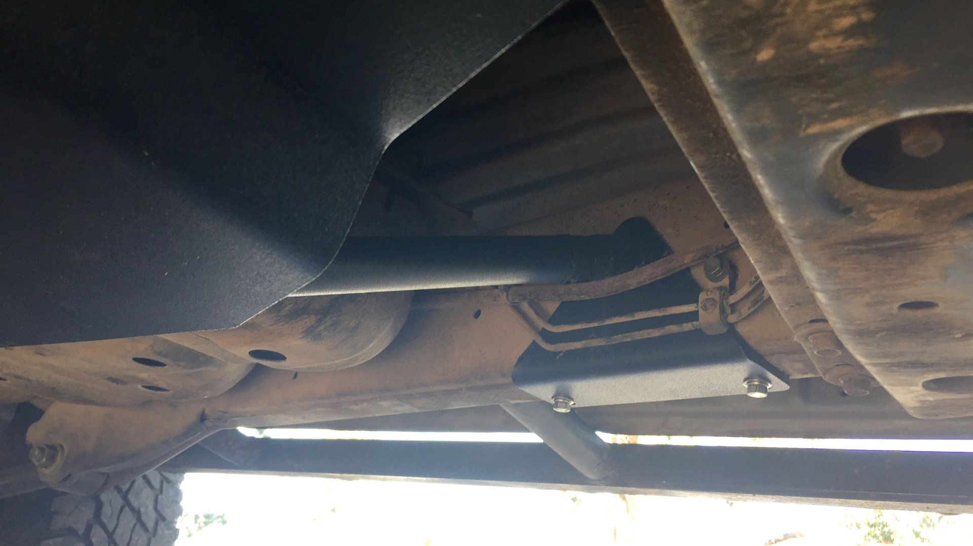

And got my new skid plates installed that we had Bent Motorsports in San Marcos build. Great work guys! Can’t wait to try them out!
