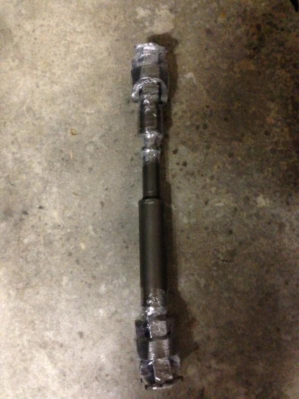

1. Your trans output shaft flange is point A.
2. Your pinion flange possition in relation to lift height is point B. (with correct caster).
These 2 points are fixed points at fixed lift height (with caster plates), and don't move. So I don't know what your talking about as to constraints and what not to do. If you installed a new Toyota shaft. You won't have any substantial vibrations (for while). But it's only a matter of time. As you haven't fixed anything, only post poned it.
The simple fact is... If you can't correct the pinion angles/location. The only thing you can do is stop it spinning.
If you have some re inventing the wheel knowledge. Please share.
Here's what I mean.
Factory, its pretty close but angles are still off.
4" lift with correct caster (pinion angle doesn't change). The upper uni is now on much more angle, the lower still not much angle. The more angle means more pressure on the uni's. So 1 has alot of pressure and the other hasn't much at all. This is where your vibrations come from.
"IF" Toyota had built it as a parallel flange set up. This would mean equal angle to both uni's. No matter what lift height, solong as its within the uni's perimeters. And would not vibrate.
It's not rocket science. You have 2 choices. Build a new housing to fix it. Or buy a part time and stop it spinning. There are no real variables or magic solutions. Dc shafts don't work! There aren't any constraints and what "not to do". There are your 2 points and angles fixed for a given lift height.
The rear is an unequal 5 link (shorter upper arms). At 5" it's only out by 3 degrees which isn't a worry. If it where a equal 5 link (upper and lower arms the same length and parallel) it would not change at all no matter the lift.
What ever you guys call it then. That's how is it. We don't use the broken back terminology. So a bit unformiliar.
The point is. That's what it is. Claiming to know what not to do and setting it up so there are no vibrations I'd bogus. The same with selling snake oil remedy dc shafts.
