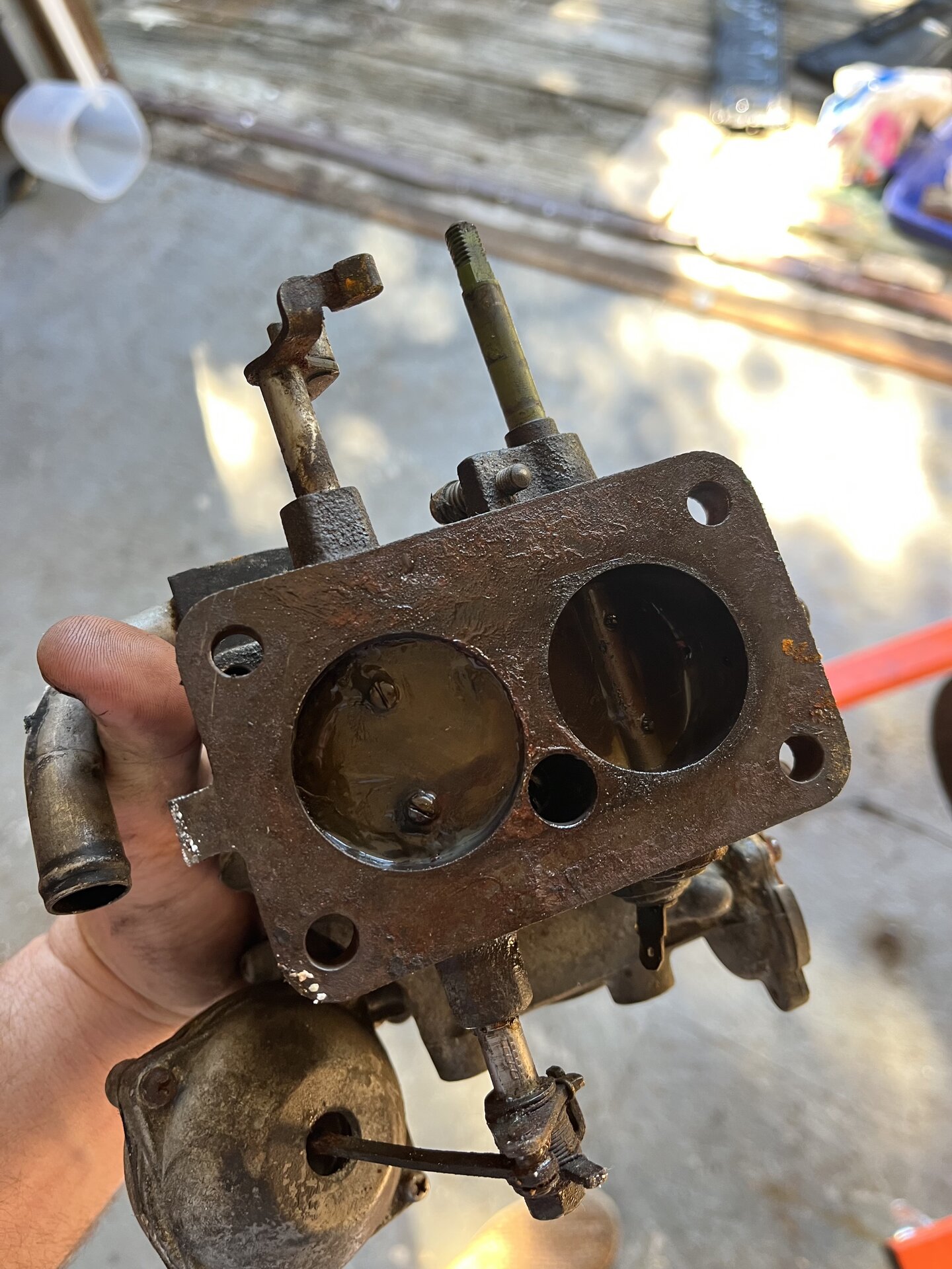

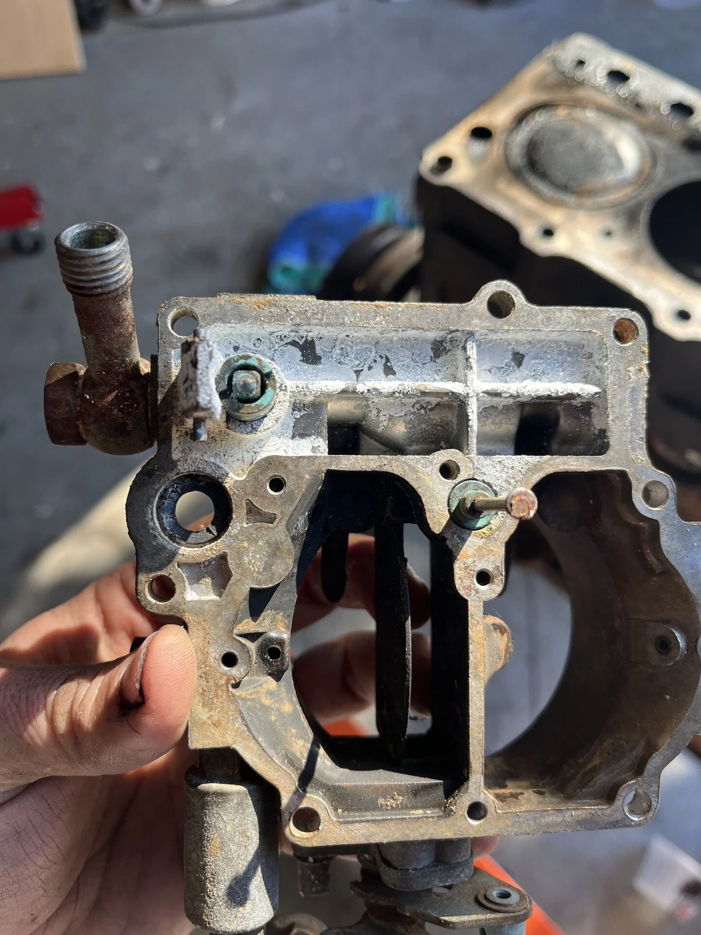

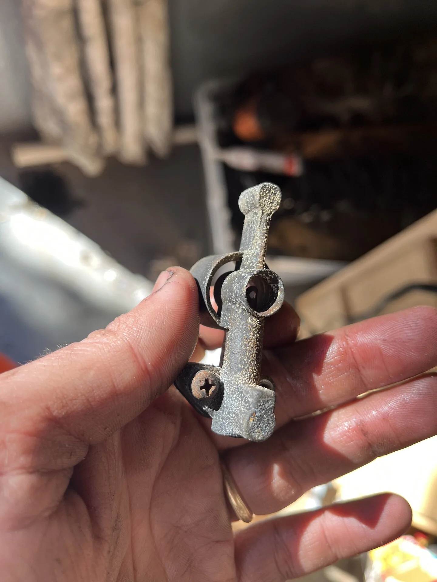

Who on mud is the recommended person to send a 2f carburetor to rebuild? Cost? or is it better to just buy a good aftermarket one like at cityracer? I am not sure mine is worthy of rebuilding but it is a oem carb. I started taking it apart but its a little out of my depth. here are some pictures. I have all the parts and screws and linkages.
Rebuilding it is pretty cut and dry. Watch @pinhead videos online. Pretty simple. I got a rebuild kit from Mike's. Has all you need in it.
That carb does look pretty rough.
Yeah the lower butterflys are frozen too on this. I may soak in diesel or gas. I think the FSM says to soak in gas before disassemble. Ill check out the video.

Your carb does look rough, it'll take some time and elbow grease to shine that up but it's probably do-able and worth the effort.
Mine was in similar condition with the butterflys frozen. I sent it off to Mark and he kept it for parts and sent me a different one he already had built.
