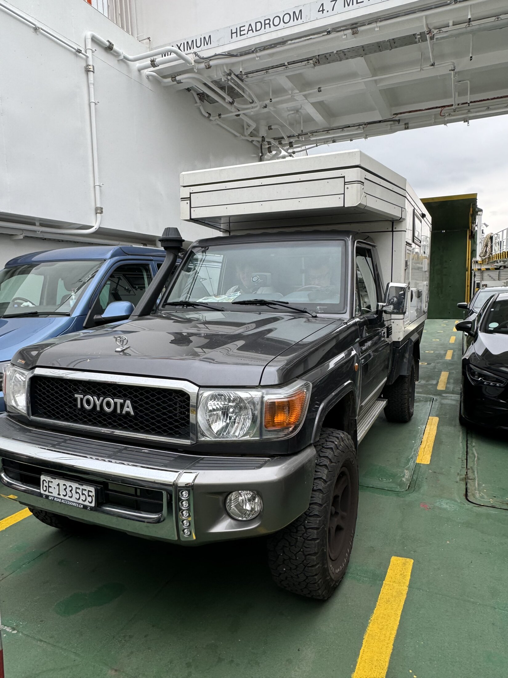

Shared a ferry ride with this 79 series camper conversion this morning. Ferry was leaving the Isle of Mull in Scotland. Older very nice Swiss couple from Geneva.
I wonder if this is Toyota’s version of a DRL for the 79 Series.
There is a small bulb inside the headlight housing, that when converted to LED, is very bright and at first glance appears as though the headlights are on. 😊
Yes I know that. I should have been more specific and said that the daytime running lights emanate from the same location as the headlights.
Continuing the hijack of this thread (sorry @WarDamnEagle) that’s a GCC standard and yes it’s some form of DRL.
Interesting as I don’t see those lights on the KSA or UAE 79 series pickups. At least I never saw them in KSA in person and can’t find them on their 2024 models (on their respective websites).
