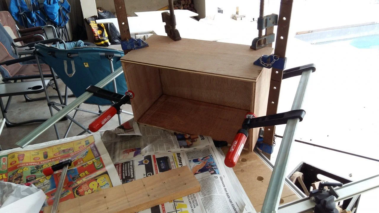

The only woodwork I have done previously, have been with either MDF or melamine board. Both these products are a very precise 16mm thick. I use a FESTOOL machine for making the joints with beech wood dominoes. This machine is designed for 16mm thick wood. The problem comes in with the plywood being only 12mm thick. The thickness varies quite a bit from one piece to another, and the extremely thin layer of ply on the outside splits off very easily. Also, I have only a few clamps which are long enough for the pieces of the bench, so I am gluing and clamping one or two pieces together every night. I thought I would be able to finish all the woodwork in a week, but at the moment it does not even look like I will finish with the left side bench before we leave on Saturday for two weeks in the Kruger National Park. V E R Y D I S A P P O I N T E D ! ! !

I decided on ply instead of aluminium because of the Festool's ability to make such strong, yet precise joints. What I forgot was that the machine uses the width of the board to determine the exact middle of where the slot is drilled. Because the board is now 4mm thinner, the slot sits 2mm off centre, and again, the slot on the flat side of the attaching board is off with 2mm.
I have made a "jig" to try compensating for this, and it works, but every slot now takes longer to set up, and the join is not so perfect as I would've wanted it.

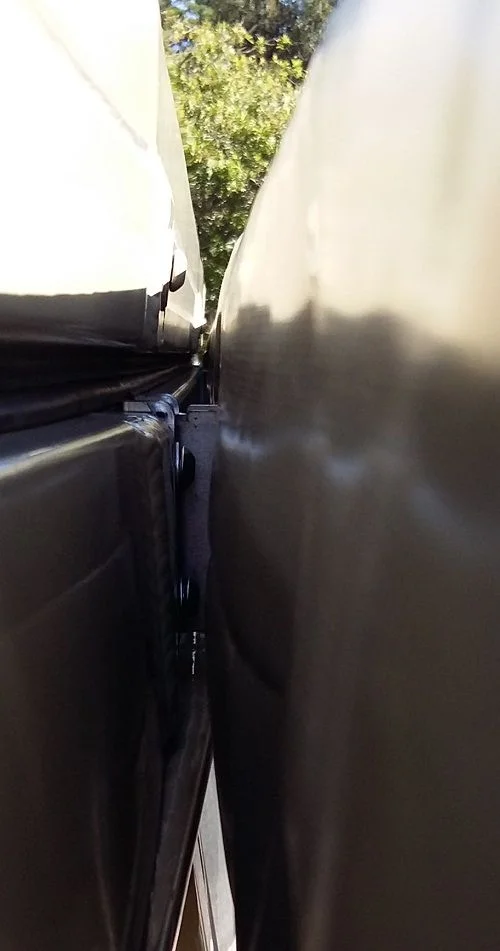

Hi Theo,
They mounted the front bracket through the stub left from the rib running overhead just behind the passenger's head, and the other on the back corner of the tent. Both brackets are just attached to the outside skin of the bottom half of new roof.
Front bracket
Rear bracket
The awning originally opened too low over the small rear door, but they gave me an extra pole for the rightside corner to lift the last "arm" and now the door will not catch the arm when open.
I love the size of the awning. It will be very handy when cooking behind the car.

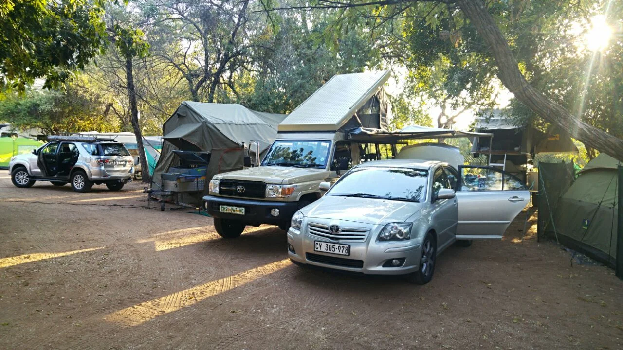

We just came home from a 2 week camping trip in the Kruger National Park. The car handled himself very well considering he towed a camping trailer with 2 Eazy Awn tents ontop.
Camping was hectic to say the least. I could not get the woodwork done before we left so everything (for 6 adults) we piled haphazardly into the back. I am anything but a neat freak, but the chaos from day one was almost tòo much for me.
We had fantastic weather and the animals were amazing, but now I am really stoked to get the storage sorted out.

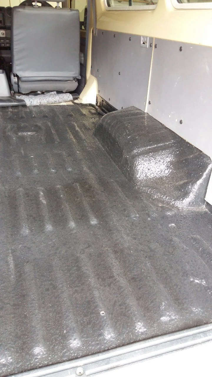

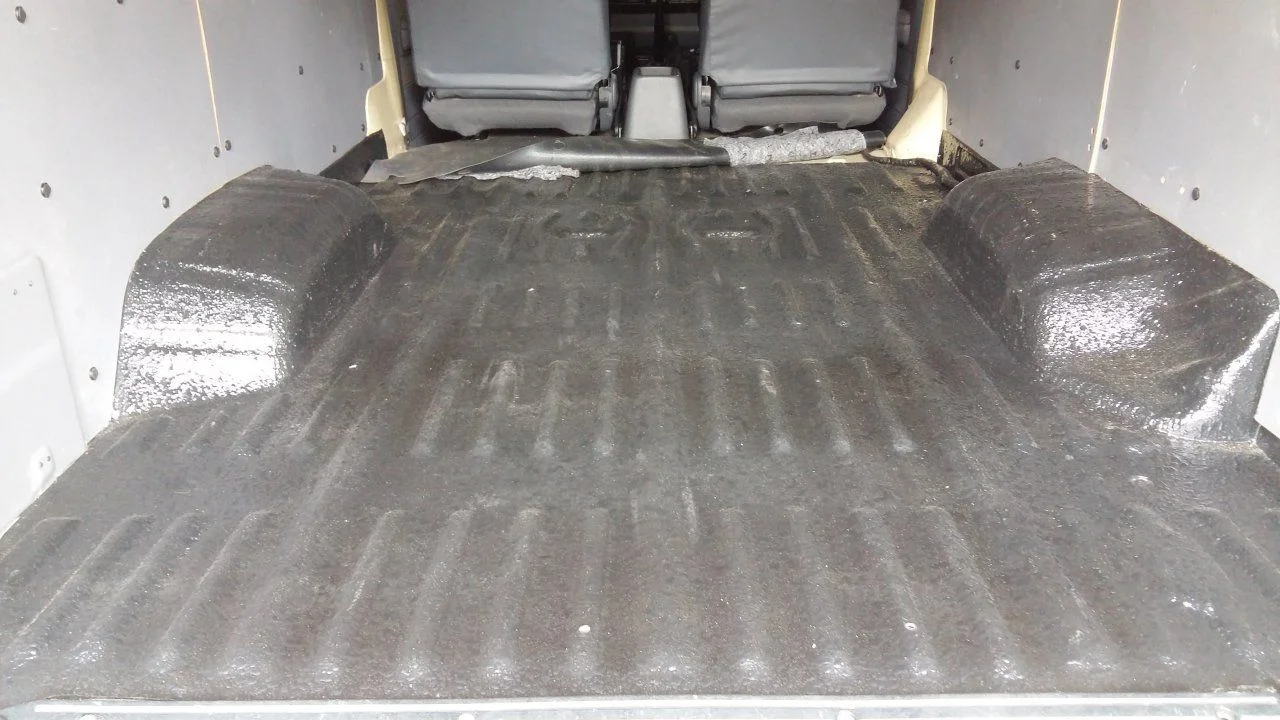

I had the bed of the car Rhino-lined and am very happy with the outcome. Now the ply floor can go in, which will make working in the back much easier, as hobbeling around on the uneven steel floor was not the most comfortable experience.

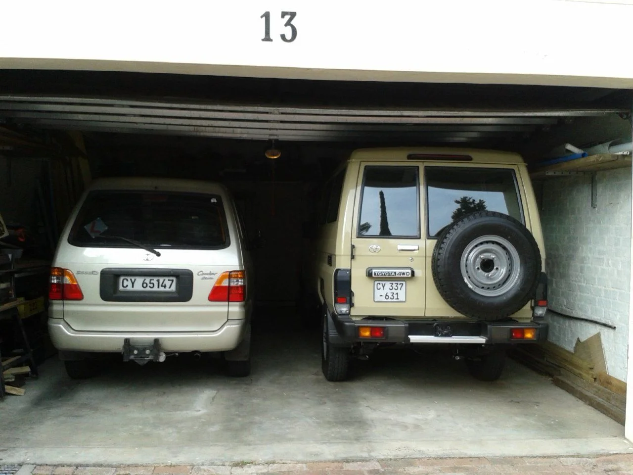

I have found this old photo on my camera of when the Troopy first came to live with us. On the left is my "old" car. The trusted Condor helped raise my children (and the rest of the hockey team!) for 10 years, but the proceeds of selling him is paying for the tent and the rest of the build.
