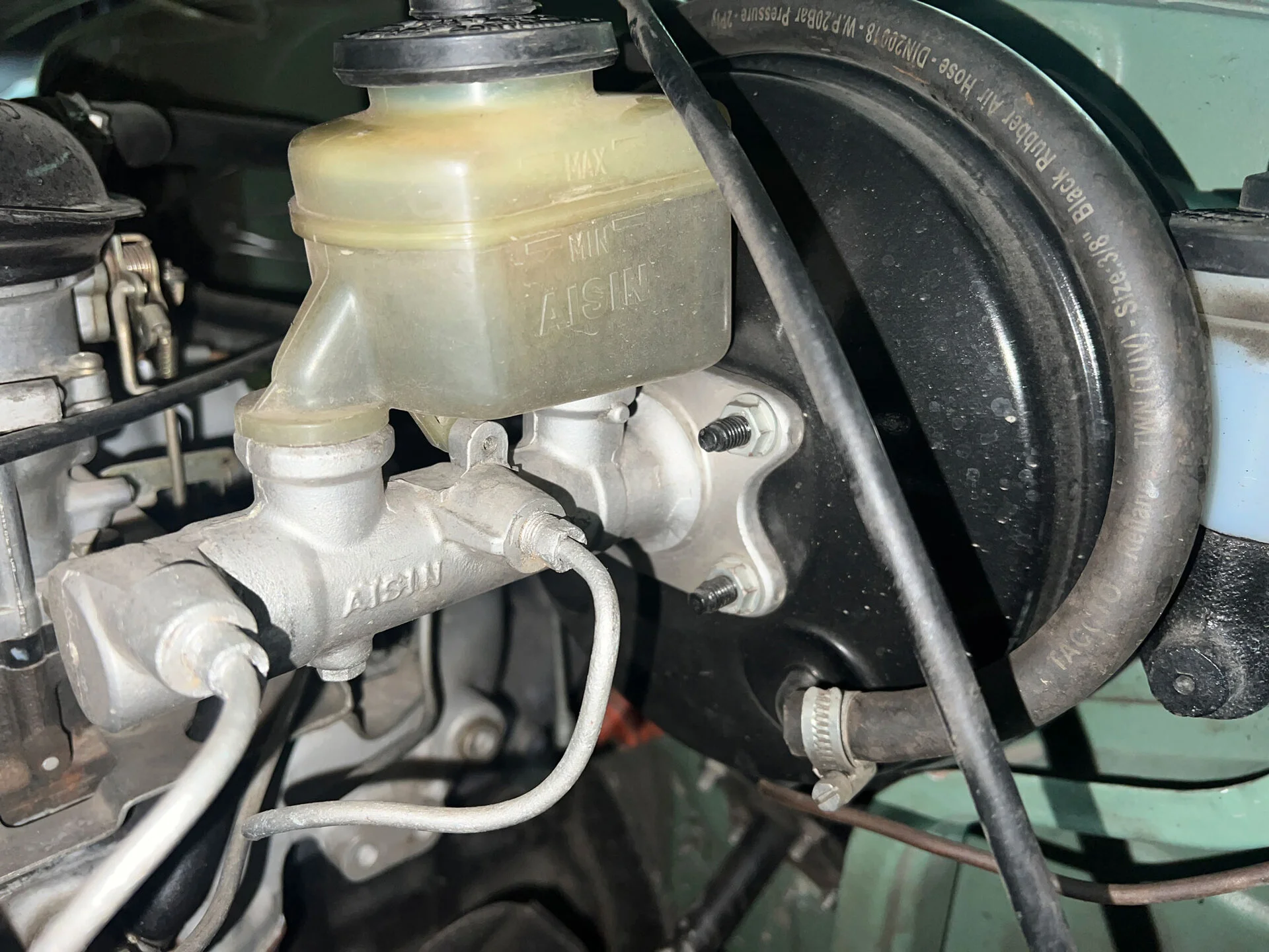

I have front disc brakes on my 1980 FJ40 and rear drum brakes. But the braking is horrible, any hard sudden braking results in wheels locking up (i believe the rear) and the car just continues to slide forward. Doesn't necessarily have to be at high speeds either. I know from my Datsun when I upgraded my brakes I had to also get the appropriate master cylinder and I believe the company that restored my car didn't install the correct one.
I'm planning to order one that suitable for front disc rear drums set up Brake Master Cylinder for '76 to '80 Land Cruiser FJ40 BJ40 FJ55 - https://www.cityracerllc.com/products/brake-master-cylinder-for-76-to-80-land-cruiser-fj40-bj40-fj55
But, I want to first check and see what exactly is installed in my car. Can anyone identify it please?
That looks like a 2nd-gen pickup/4Runner master cylinder. Not sure how compatible it might be with a 40, but my guess is that it would take some monkeying around to get the pedal freeplay correct? I wonder if the push rod and/or brake booster were swapped over too?

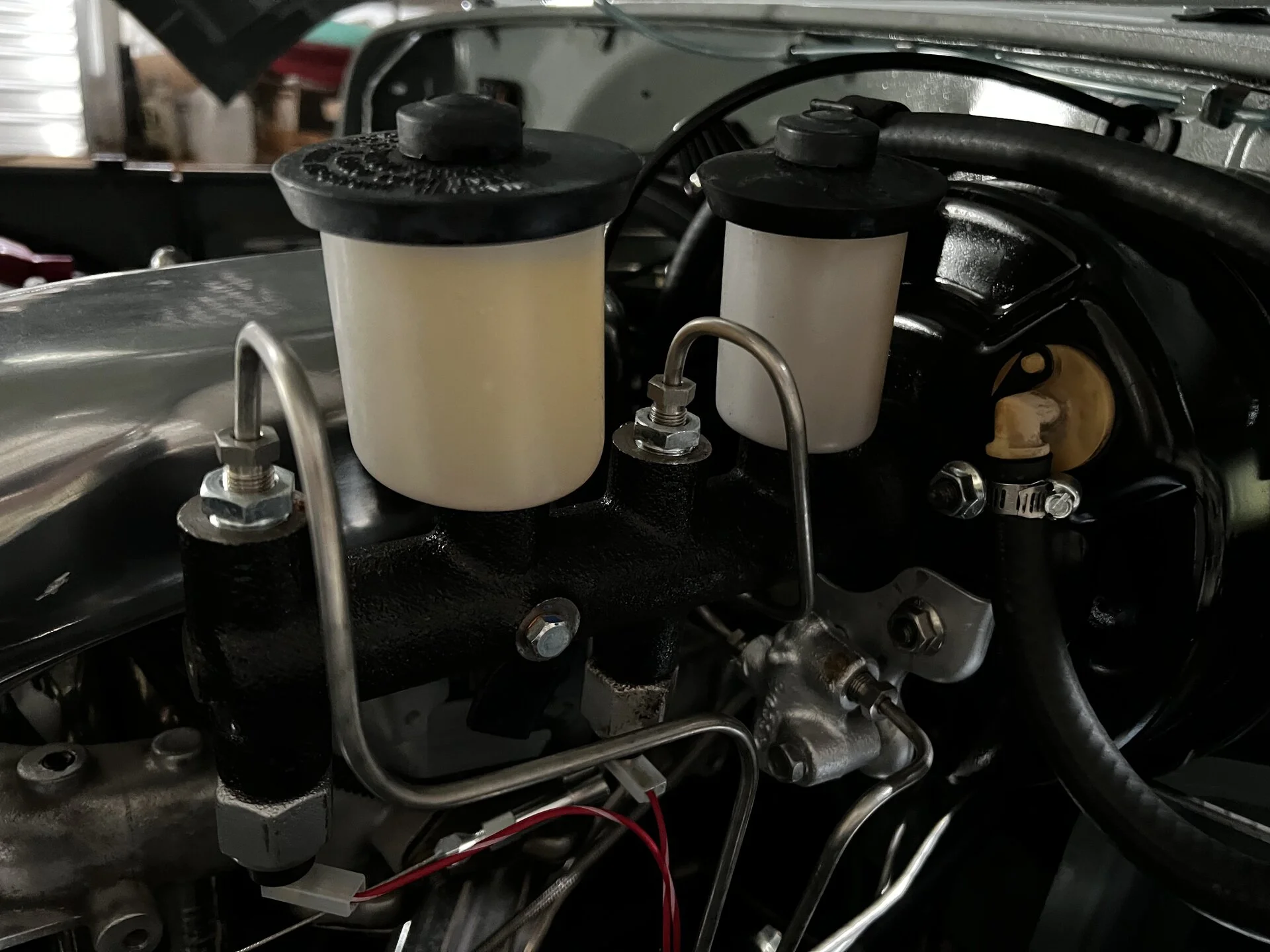

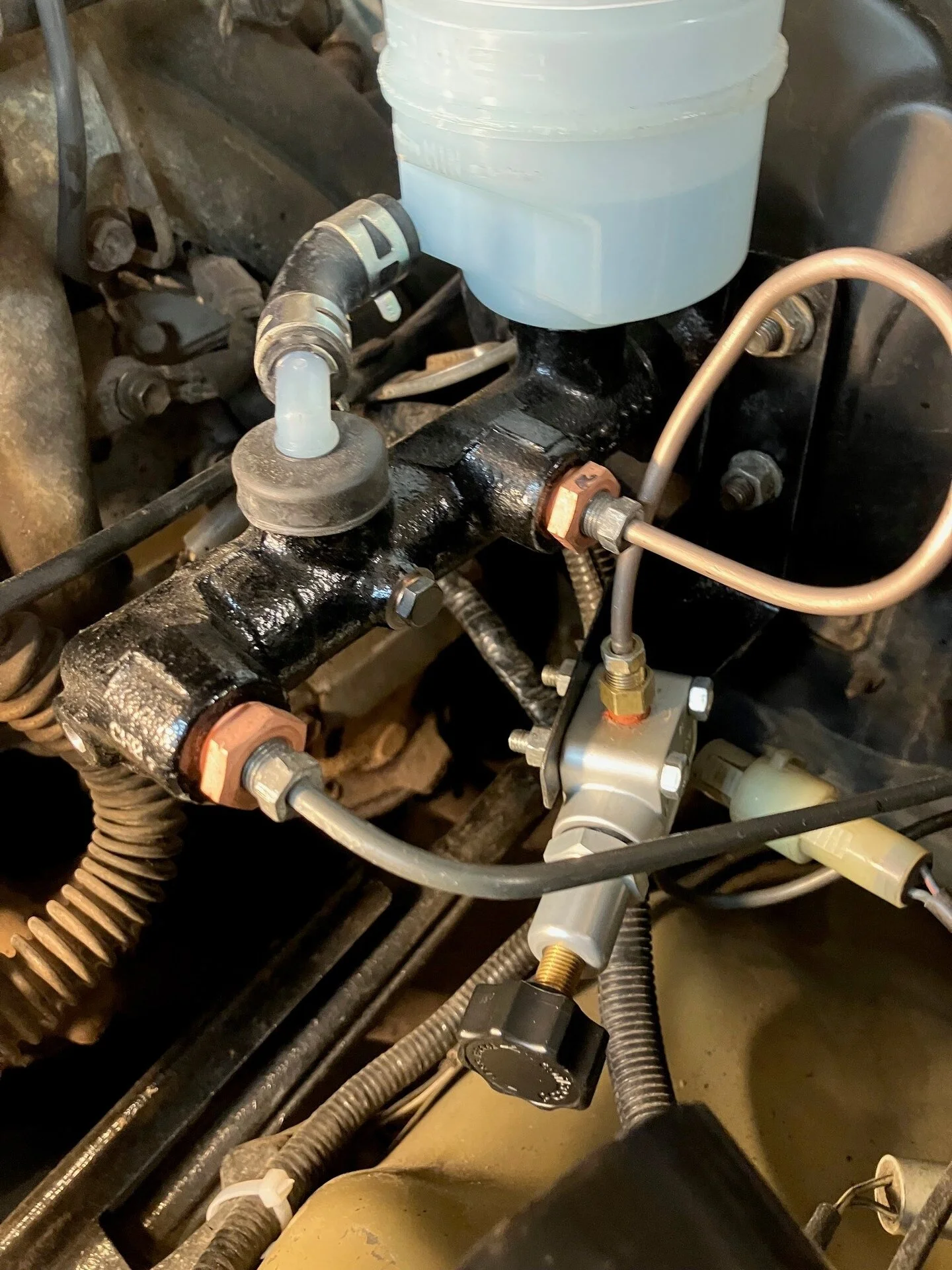

Assuming that MC *can* be made to work in a 40, it sounds like you might need a proportioning valve. Do you see one anywhere? It would be on the rear brake line somewhere. If there isn't one, you can add an adjustable aftermarket PV that allows you to bias the rear brakes so that they don't lock up prematurely. I installed one on my 62 when I deleted the stock load-sensing proportioning valve. They're not too expensive and not difficult to install if you have access to a flaring kit. City Racer sells one that will work with metric fittings: Wildwood Adjustable Brake Proportioning Valve with Toyota Adapters for Any Toyota - https://www.cityracerllc.com/products/wildwood-adjustable-brake-proportioning-valve-with-toyota-adapters-fits-fj40?_pos=4&_sid=81d909a2a&_ss=r
Here's a pic of my install:
If you decide to go back to the stock master cylinder, double-check that you have the correct push rod/booster as well, otherwise the stock MC might not work properly either.

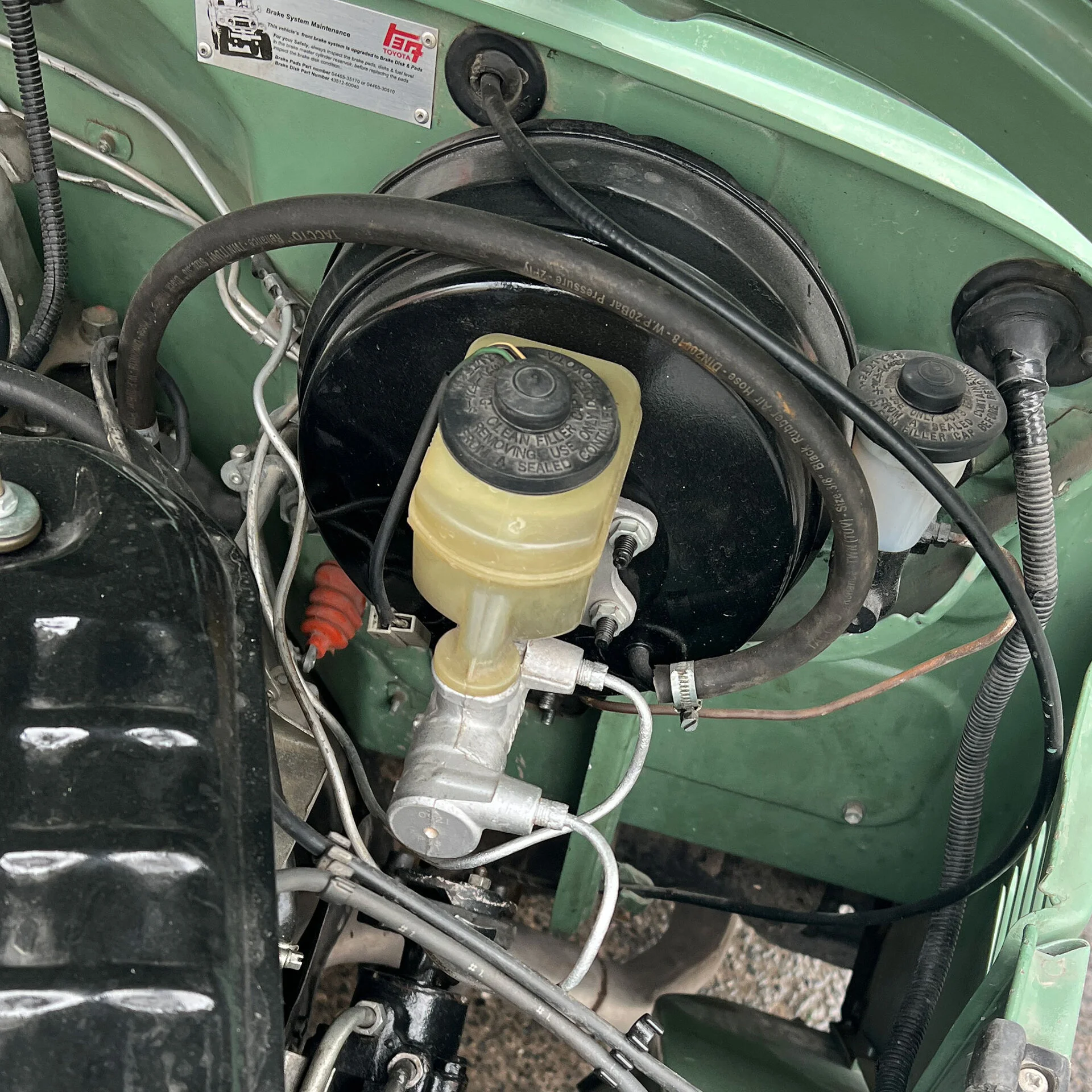

It looks like you have a quality Aisin master but I don’t see a proportioning valve which would explain rears locking up before the disc brakes grab properly.
I like the suggestion above with the CityRacer valve.
This is my OEM master for my ‘76 with front discs and rear drums. The proportioning valve is mounted below the master on the booster. It works well on mine.

wow that install looks so clean!

Is there a way to check it before I order? Also you were right, turns out the master cylinder wssn't for the FJ40, when I just started looking at Toyota master cylinders I ended up finding it and turns out I have a 1990-92 FJ80 master cylinder.
I'm borderline about to order a new booster, master cylinder and proportioning valve, but just emailed CityRacer to see if they'd know if my master cylinder would fit on my booster, so depends on what they say. I do feel relieved though knowing there was an issue with my setup because it means I now can solve it.

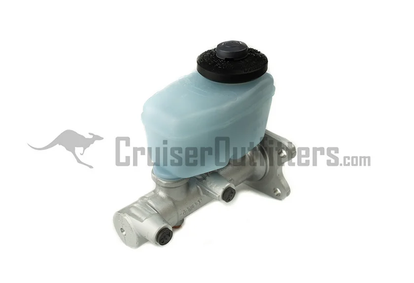

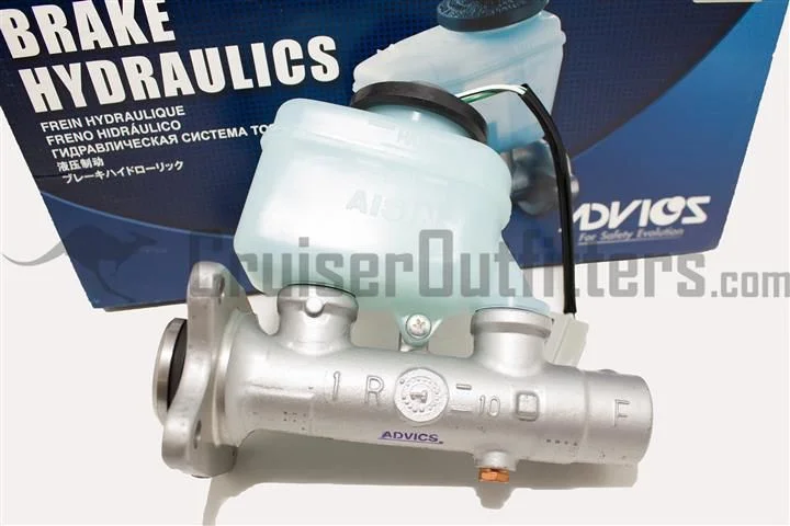

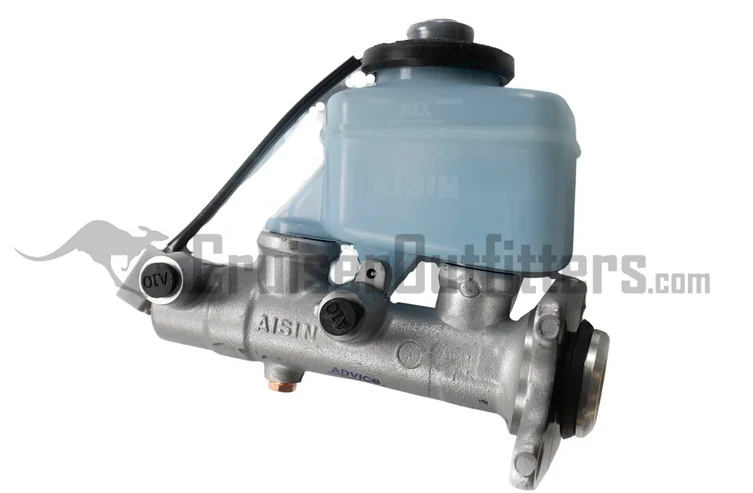

That looks exactly like this 80 Series cylinder:
You could verify for looking for the diameter stamp, it should be 1" which is the ID bore. You can also rebuild that cylinder should you want. But neither of those will fix your issue if the cylinder is not the culprit. That should provide good braking and is a VERY common upgrade cylinder for many fwiw.
You can see other 8x Cylinders here:
