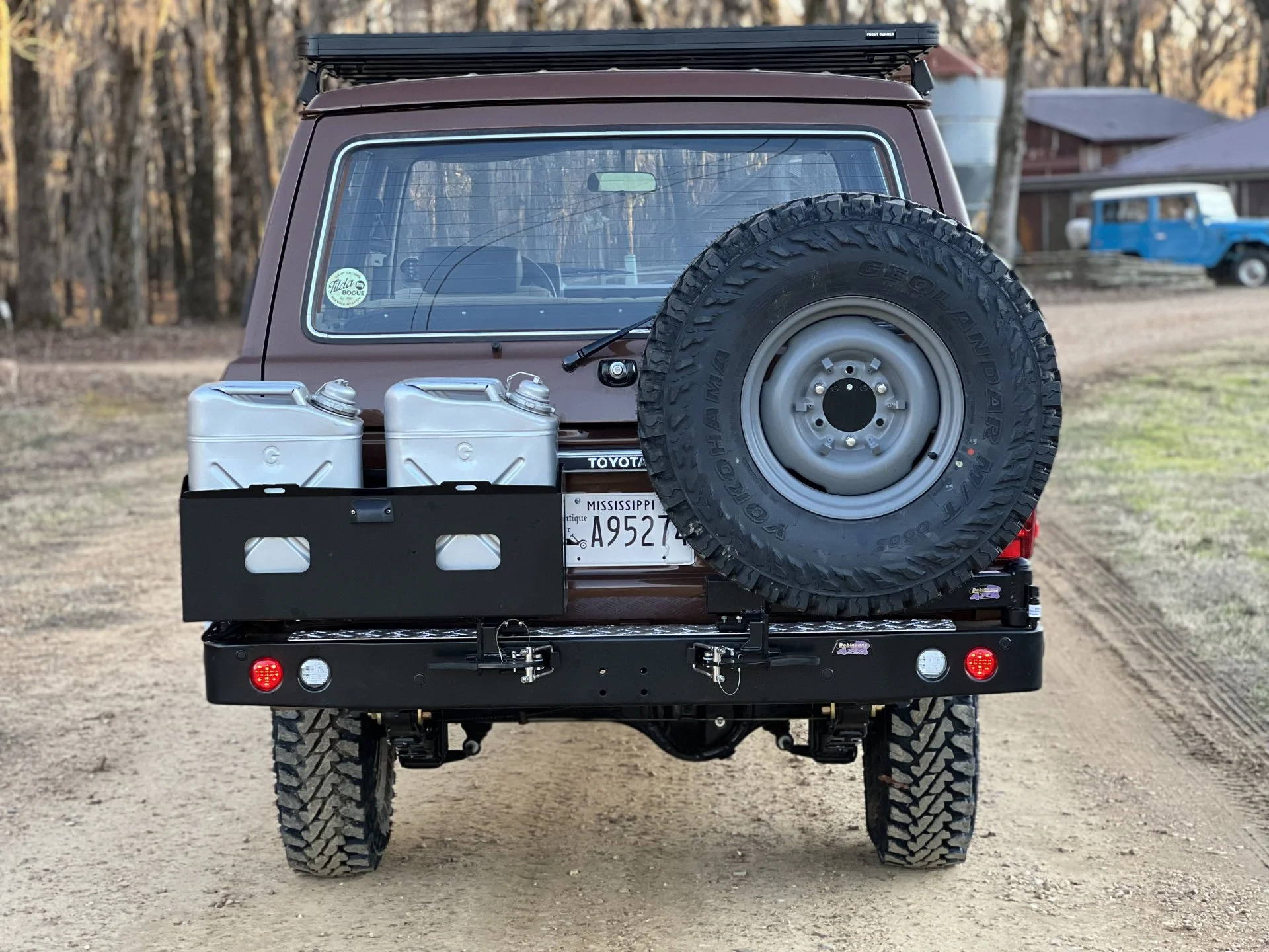

Pretty much spent the day polishing up the last few items. Wiring the rear bumper lights. Looming. Zip tying.

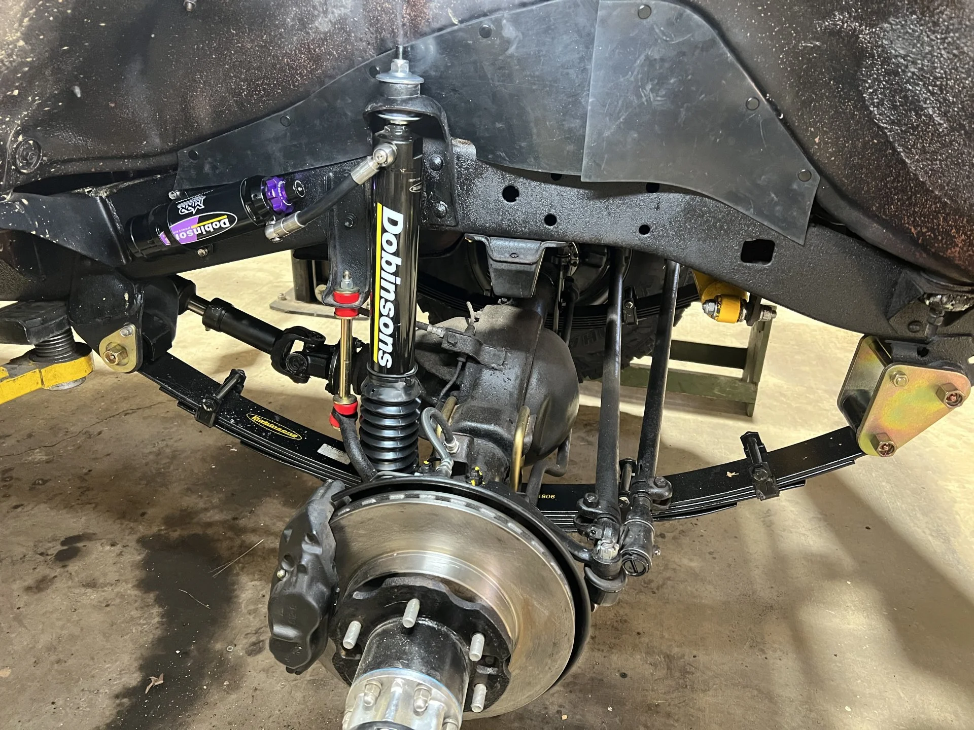

I am waiting on a top plate for the 4Plus @lcwizard flip kit to install on the passenger side that USPS lost before I can really get it out for some tests. I have not installed the shock over there.

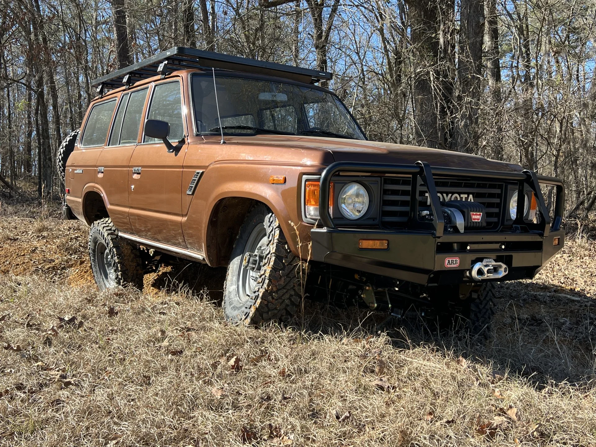

It runs real good. Nice and strong. No leaks (yet)

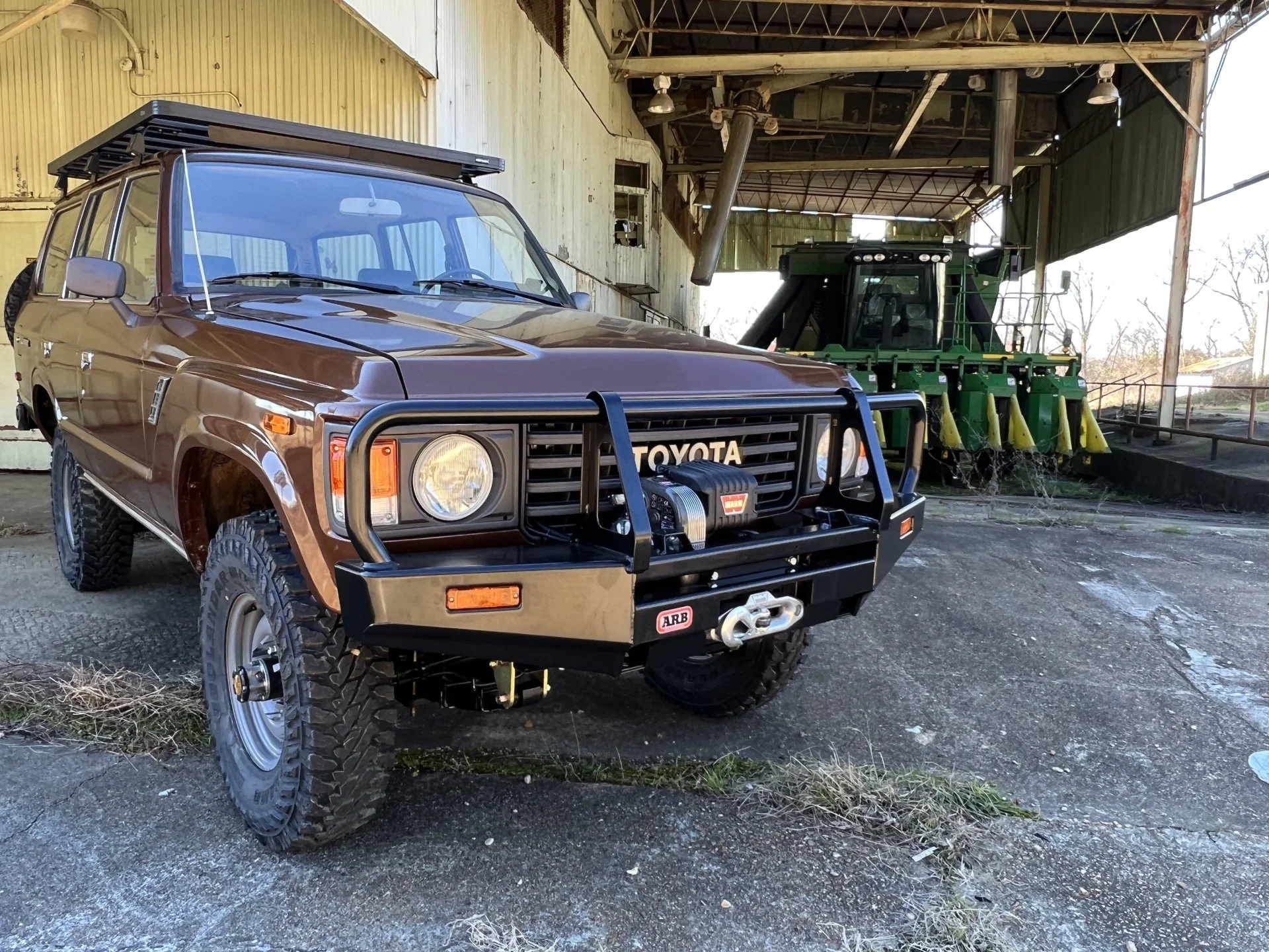

Very very happy with the look.
Those Dobinson’s sure do sit nice.
Very very nice simple build.
I’m 99 hours into it. It may look simple but it’s a lot of work …….

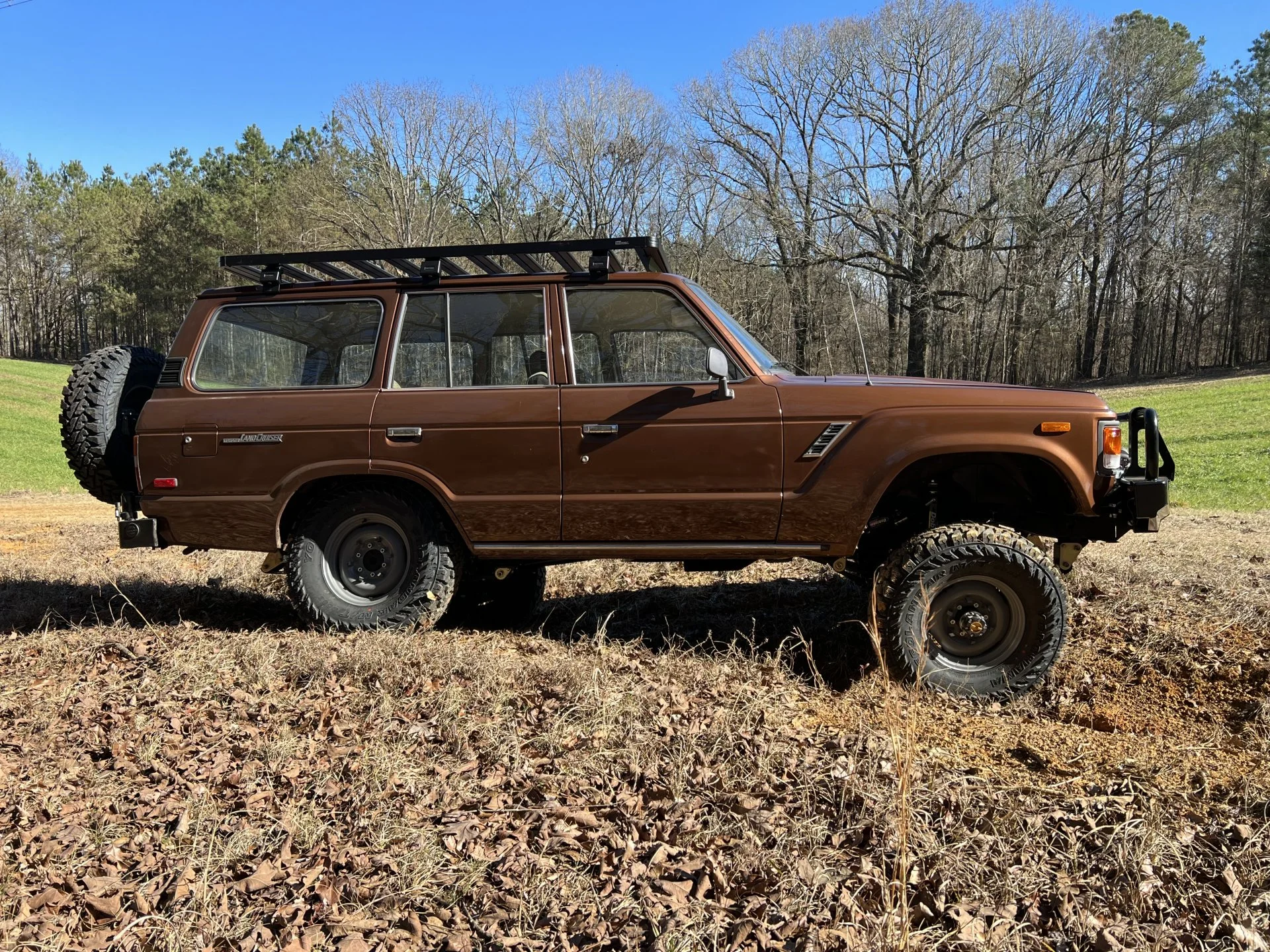

Calendar worthy. Only thing missing are those oem euro side mirrors, or 62 black ones. The little stock mouse ears completely suck for safety, visibility and usability.
I love that color
Maybe so but I love the looks of them.
I think the owner mentioned he was getting Euro mirrors

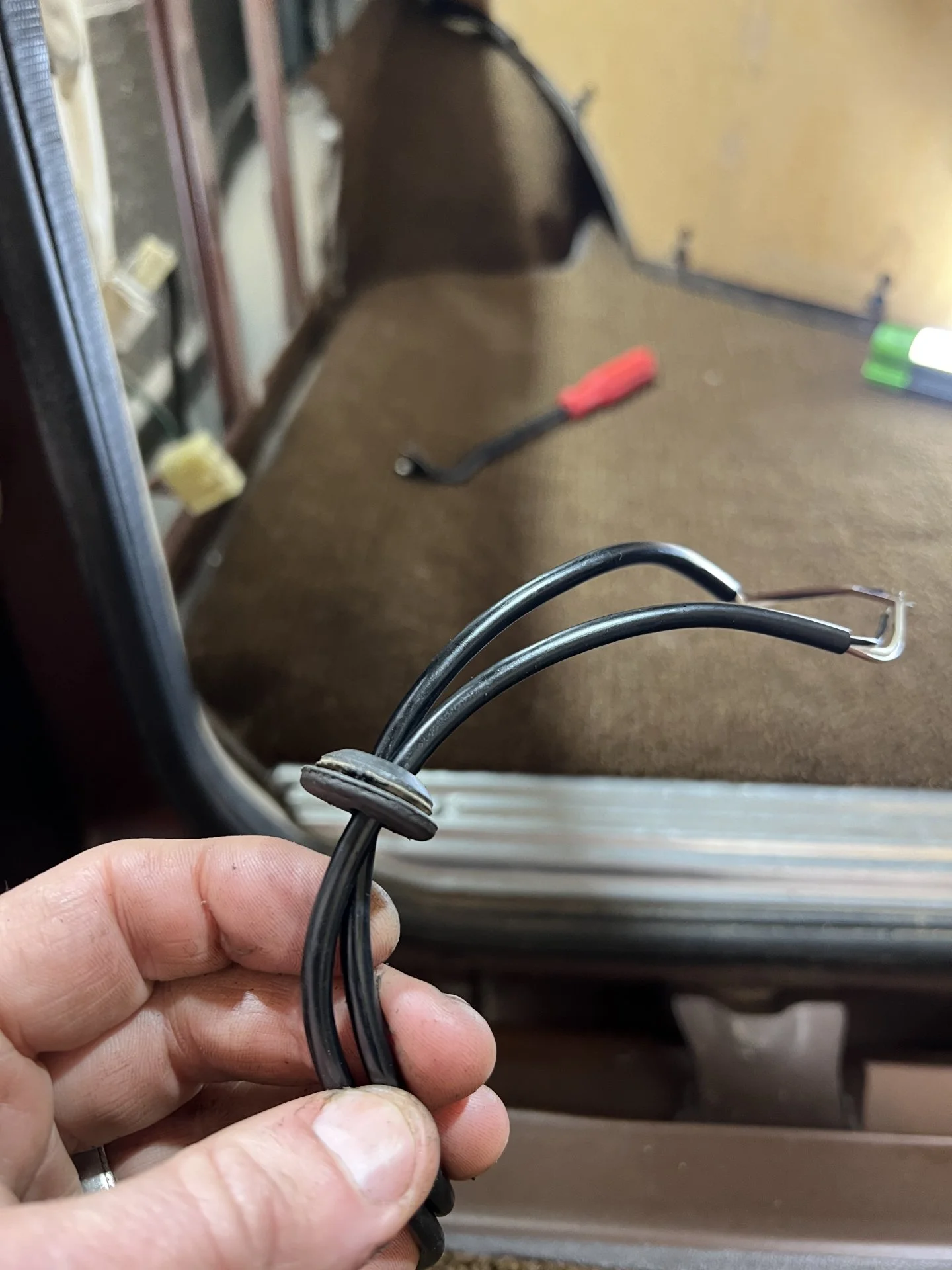

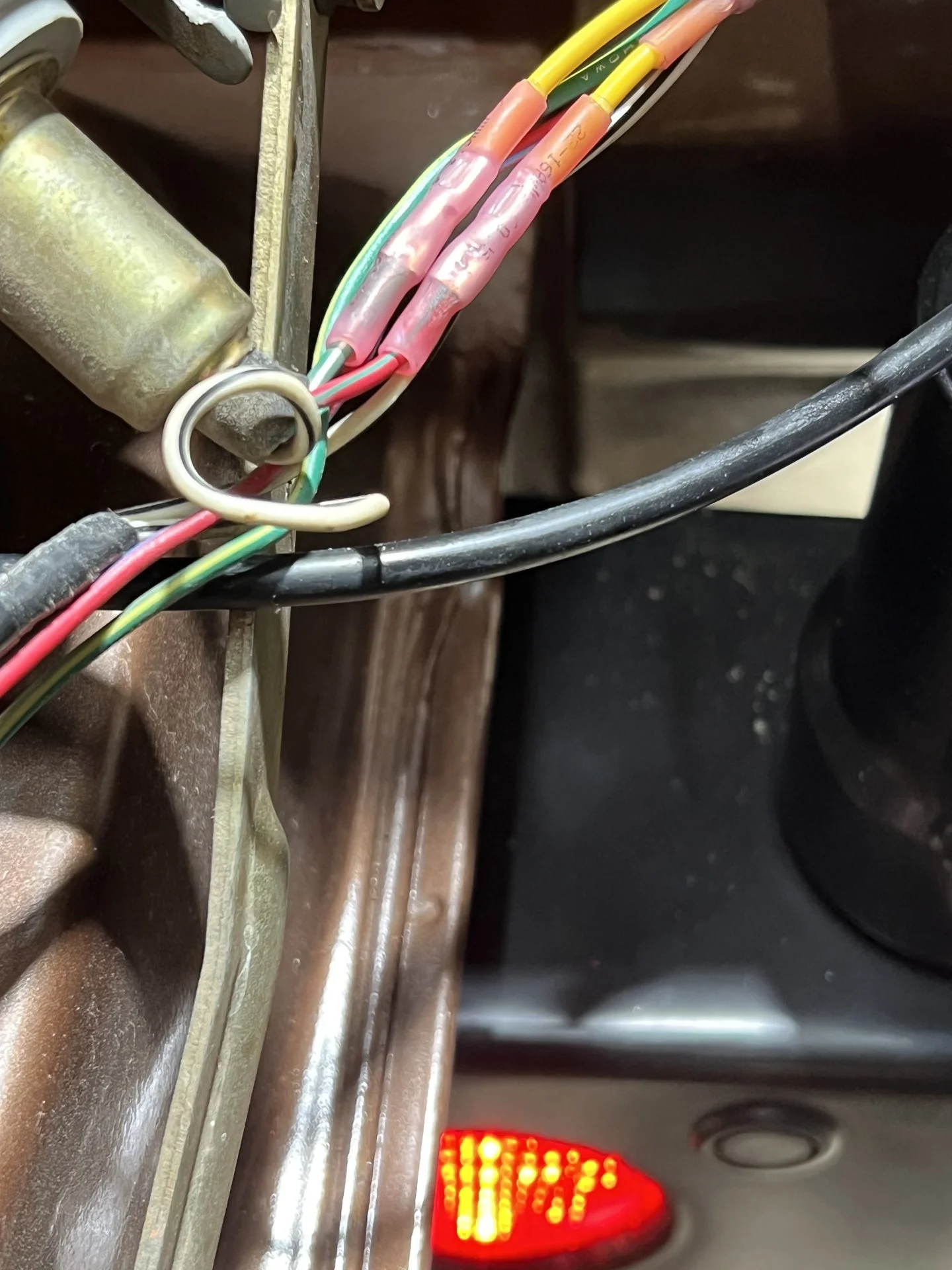

The rear bumper lights are a pain but pretty cool. Feed the supplied wires through the inner fender grommet and follow this awesome diagram
The clear LED lights yellow with the flashers. Kinda cool.
I highly recommend owning a PowerProbe for this

Went ahead and added the shock so I don’t have any more down time waiting in the flip kit part.

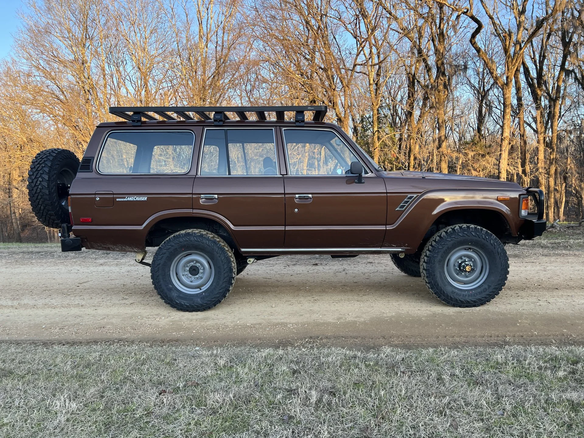

Nice job on the build. These are city racer steel wheels your using?
Correct. I like the wheel width and backspace with the 255/85s so much

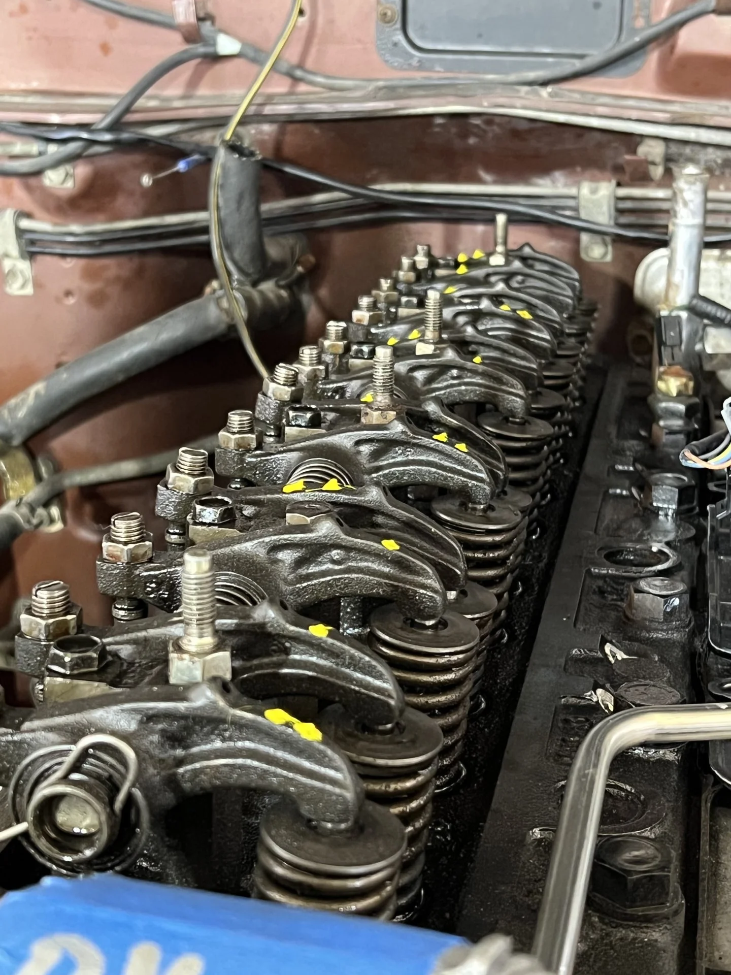

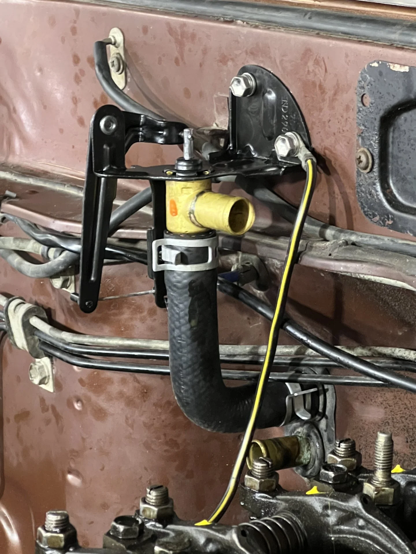

Gave it a good tight cold valve adjustment

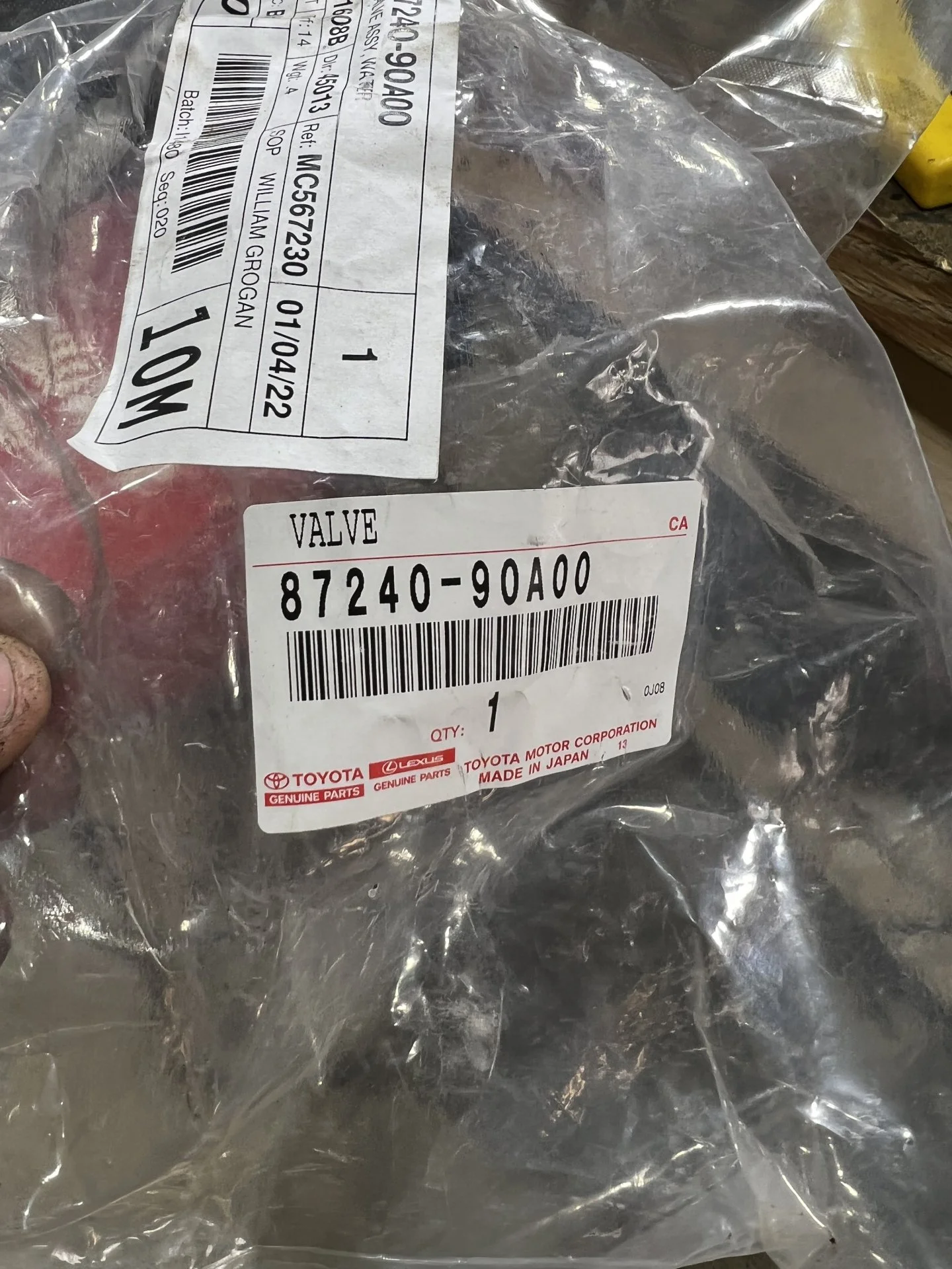

The PO had used a local shop and they “could not find” the proper heater valve so they had eliminated it

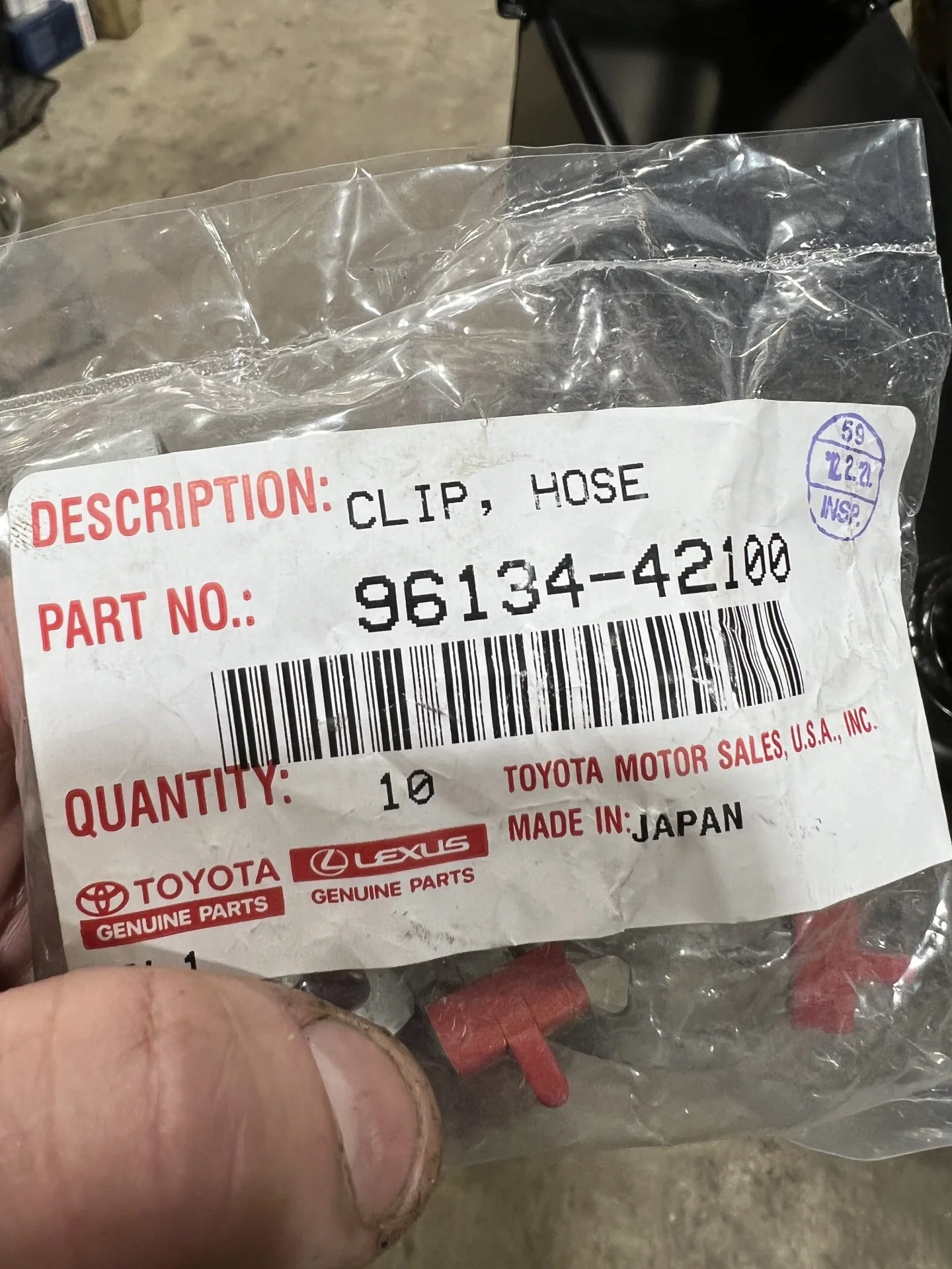

First time to use these little Toyota clamps @OGBeno told me about. I still love the wire clamps but for the small, hard to reach stuff these should be very nice
Hey Nolen, So is this the part number for 5/8" hose? And would you happen to have the part number for this style hose clamp in the 1.5" radiator hose size? Thanks!
96134-42100 constant tension clamp
1.5”

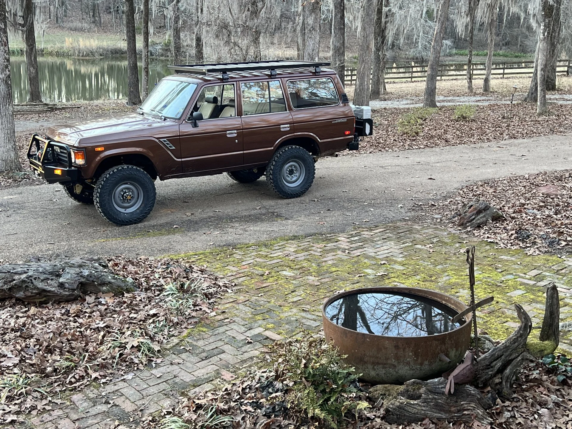

75 miles. No leaks. No problems. So nice to drive

Sharp looking truck. I keep saying this…. Curious how many Dobinson spring sets you’ve installed? Ever had any uneven settling issues with them?
So far so good. They settle but seemingly even. I have them on my 60 and you can see in the photo my 60 is lower than C Brown
