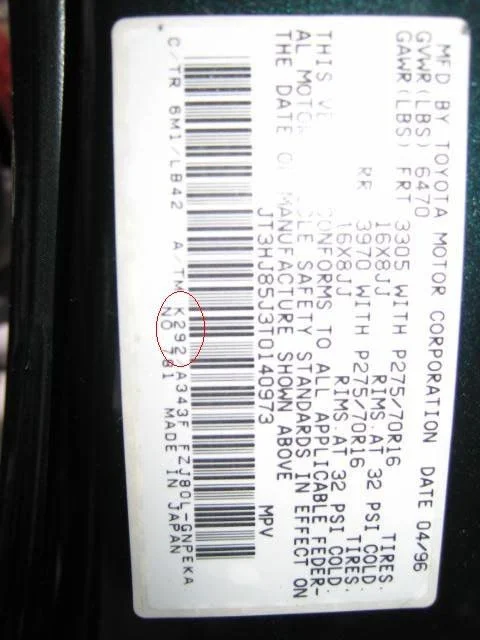

For FACTORY lockers, here are the FOUR things I suggest you do to verify if an 80/LX450 has them and that they work:
  1. Check for the magic dial either in person or via a close up photo of the area
    1. Rotary switch, immediately to the left of steering wheel
    2. Dial says "Diff Lock" on it with off, RR, and FR-RR positions/selections (see pic)
  2. Check the Data/VIN tag on the lower portion of the Driver's door either in person or via a close up photo of it (see pic)
    1. K292 = NON locking axles (from factory)
    2. K294 = Locking axles (from factory)
  3. Check the axles for the locker actuators either in person or via a close up photo (see earlier post)
  4. VERIFY that the lockers work (hopefully in person)

Of course there are always exceptions to the above. It is possible that a rig came locked from the factory and then had parts removed (as mentioned above) but that rig won't pass test #4. On the other side, it IS possible to swap factory locking axles into an originally non-locked rig and the only difference is that the tag won't reflect that (test #2). And of course there is always the aftermarket locker mod (ARB etc)

Do those axel codes work for JDM vehicles imported to canada?
I've found one I want to look at this week.
Never seen a JDM tag...Maybe Mot could tell us :D, or one of the current JDM owners can look at their tag.
I assume the tag is in Japanese and not English but numbers are numbers right?

My $0.02, even if you get the K294 tags, get under your prospective truck and LOOK for the locker actuators before you hand over the dough. It's not as if you're never going to be crawling under your Cruiser, so you might as well start early.

Axle Codes
Yes the codes work for JDM 80 series at least HDJ81's. I have two and they both have the K294 transaxle code and factory fitted lockers.
