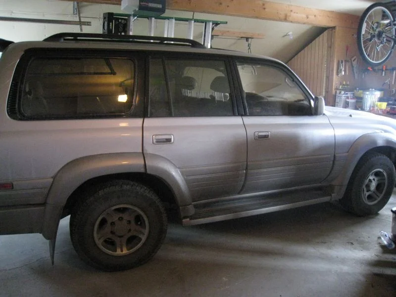

Okay, here goes...I'm gonna try some pics...
The LX 450
Hay Brian! Yeah, it's West but the kicker is they moved out here from Chicago where they said they bought it from the first owner 2 months ago who had it leased till last year...is that possible??? Said all work was done at a Lexus dealer in Chicago. How do I check what was done? I read somewhere on here that Lexus takes copious notes and keeps all records of work done to their vehicles. Is there a way I can see what was done? I tried to put a pic of the data plate on here but I'm over my quota. But it does in fact read K294. So, factory lockers! And it was made in 2/97. In the pic of the right side, the rear door seems a little off or it isn't closed...I'm gonna have to ask him/her more questions. Also, he/she said that at higher speeds the rear end sways around noticeably...is this a normal thing for these??? I've not heard about this on the 80/450. I'd kinda like to know if the 90K service was done...oh yeah, what exactly IS that anyway? Thanks for the reply. I'm being a little anal I suppose, but I'm selling my '03 F150 SuperCrew and getting one of these and since it's going to be my daily driver I'd like to dig into it as much as I can. Again, thanks. Walt
90K service is nothing to be worried about, these don't have a timing belt so it is just fluids and checks. that truck looks worn from the pictures, and having come from chicago probably has rust problems. the price also seems very high to me, but I guess that is from the low miles. If you are limiting your search to 100K or less you are probably going to overspend. IMO you could find a rust free locked truck for 3/4 of what they are asking for this one with more miles but better maintenance. high miles aren't really as much of an issue with these as is proper maintenance. Also, you might want to read the cost of ownership thread. It seems that a lot of people have been whining about their trucks on here lately, b/c if you don't work on it yourself, it is $$$$$ and it is very hard to find a mechanic who knows how to work on these.
