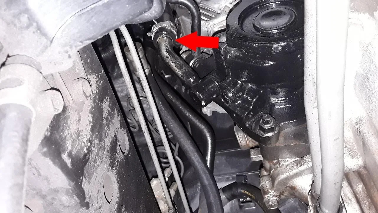

I had a pre-purchase inspection performed, and here are the negative remarks (most importantly, oil leak - photos attached):
1. Windshield wiper fluid does not spray. Motor makes sound but no fluid is pushed.
2. Brake fluid is black.
3. Power windows very slow.

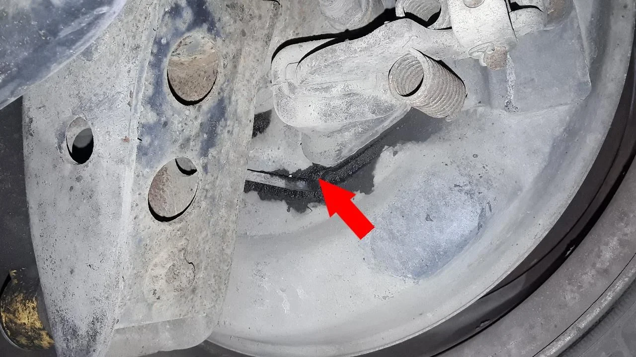

4. DRIVER SIDE REAR AXLE BEGINNING TO LEAK.
5. POWER STEERING FLUID LEAK APPARENT (return hose).

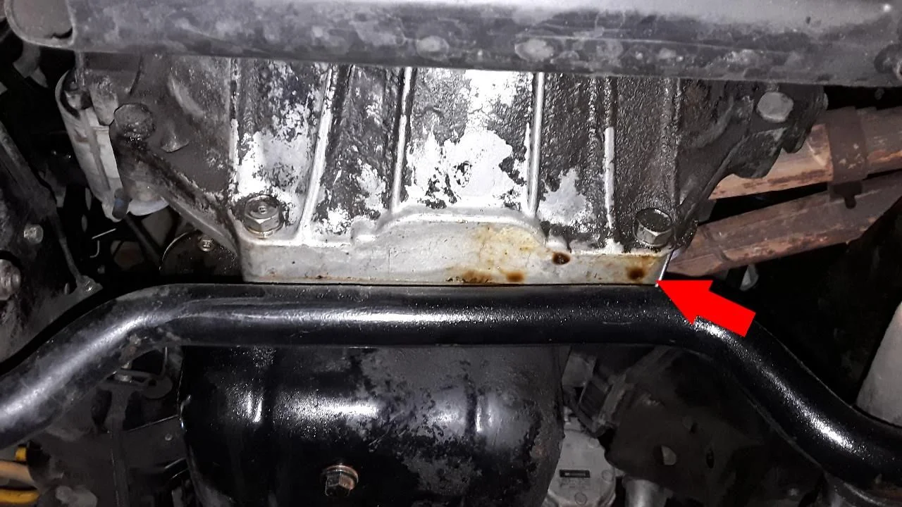

6. EVIDENCE OF ENGINE OIL LEAKING UNDER VEHICLE.

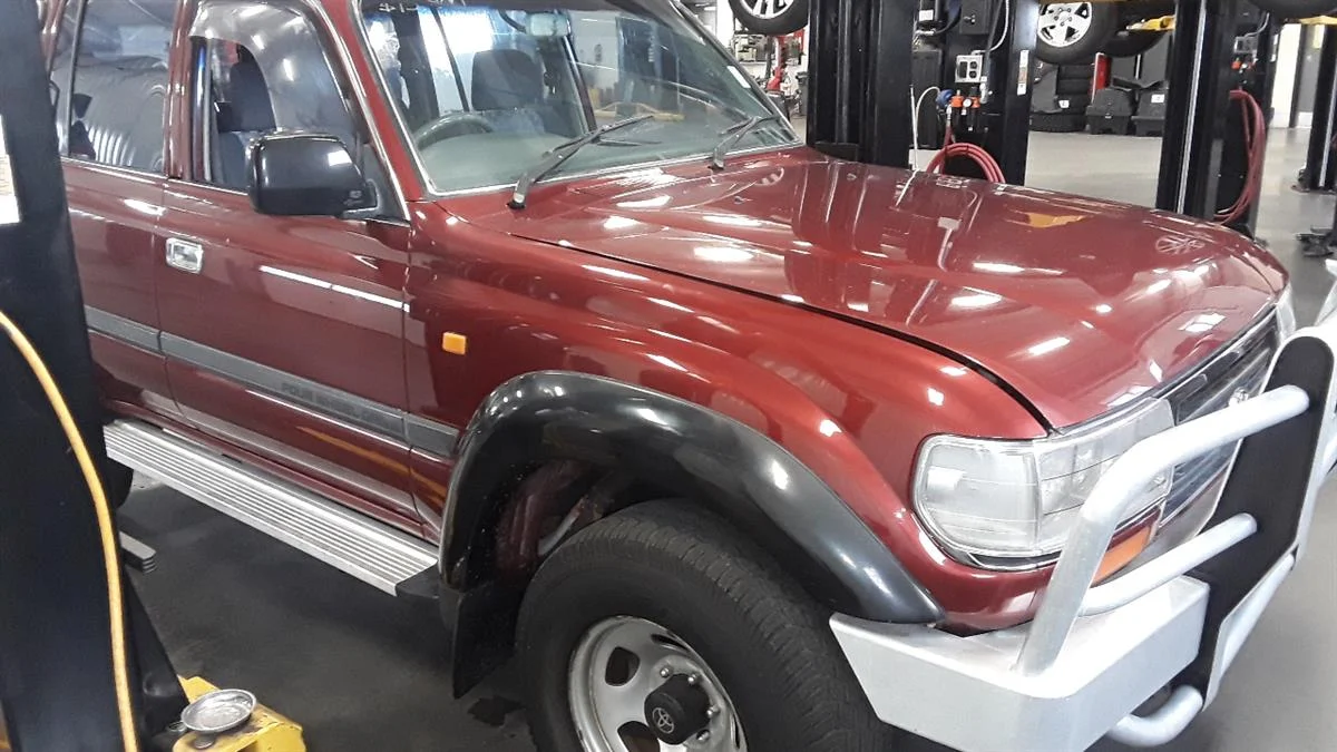

The power steering is a known issue. The house could be very brittle due to the heat in the engine compartment. @NLXTACY sells replacement hoses and they work great.
Doing the axle seals is not that bad either. If you have going to do the rears might as well do the front knuckles at the same time.
The picture of the oil leak looks to be a rear main but it is hard to tell. The 80 are known to have leaks at the pump up front too, so try having the inspector tracing the leak.

I see no problem with the leaks. Land Cruisers leak. That's why they need maintenance. Engine oil leak looks like probably rear main seal or upper oil pan seal. Both are a PITA, but not out of the ordinary.

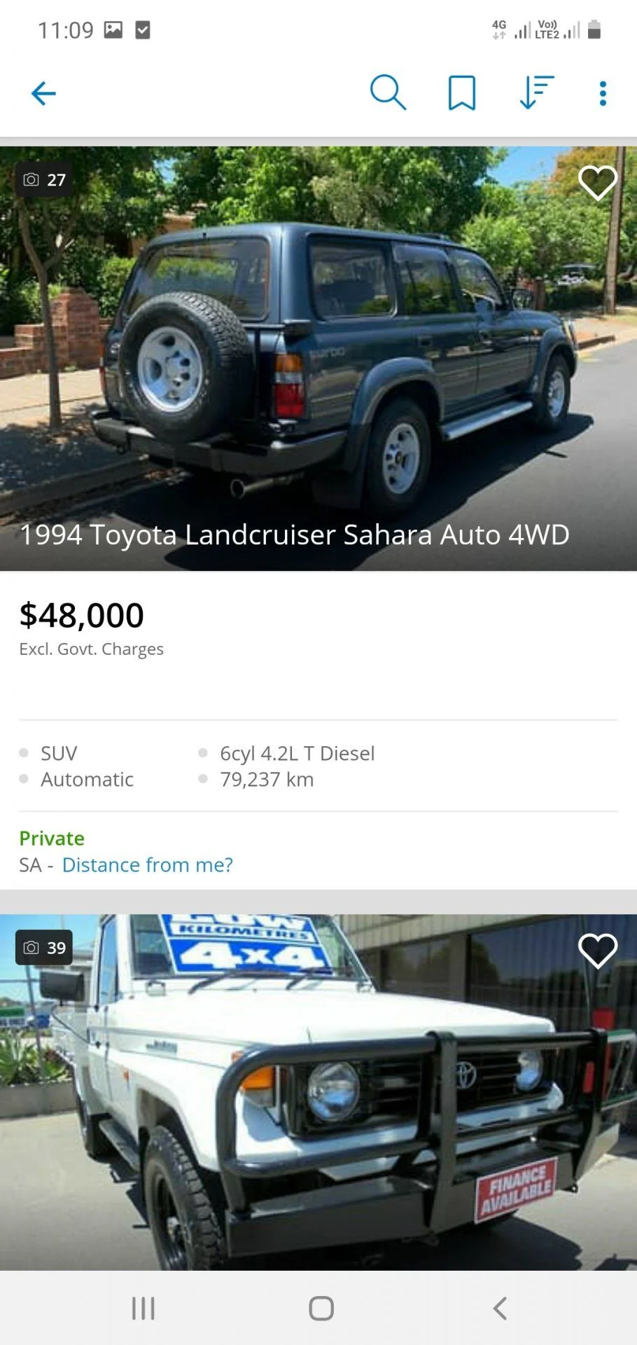

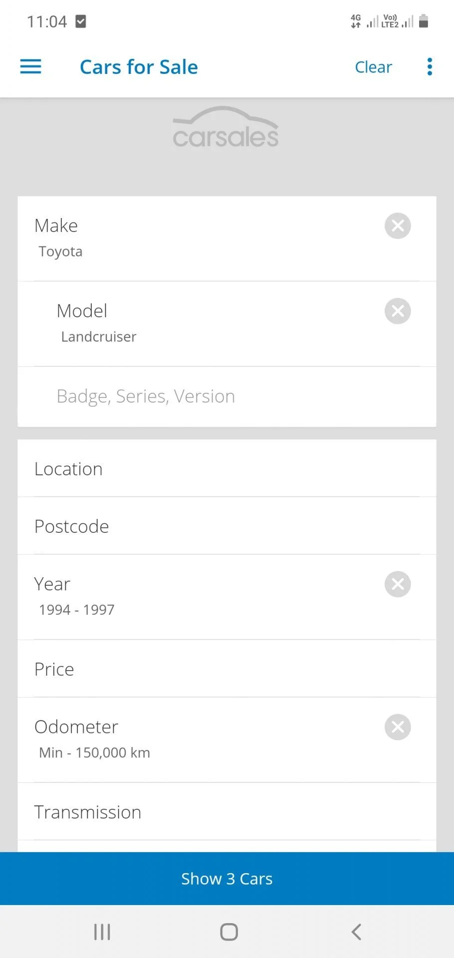

So, I did a quick search for landcruisers for sale in Australia with similar mileage, similar age
Carsales is the number one online platform for finding cars for sale in Australia.
Guess how many landcruisers in the search results?
That's right, 3 listed in the entire country with less than 150k km. 100k km landcruisers in Australia are like unicorn shït.
One is listed with 44k km, but ODO shows 366k km and has clearly got a lot of miles on it.
This one looks legit. It is diesel. So would see a 30-50% premium over a petrol version.
