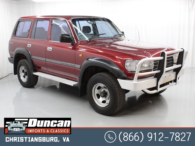

Looks quite clean :meh:
Its got aftermarket springs, shocks, steering damper, sway bar bushes fitted
Is been converted to dual fuel. LPG/Propane gas and petrol
The subtank has been removed at the rear to accommodate LPG tank.
LPG system is the two big round alloy components in the engine bay, plus flashlube valve lubrication system (installed because LPG converted engines had a tendency to wear valve guides prematurely)

Looks like its had a good clean up underneath. Has had some engine oil leaks in the past.

The appearance of the interior is what drew me to this one. The cleanest I found.

LPG conversion can be a headache because during engine work you'll run into those systems as well.
Unmolested 80 would be worth it, but this isn't unmolested.
