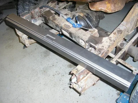

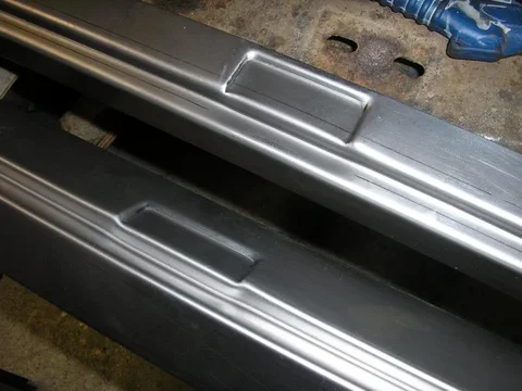

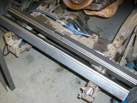

I made up our channels this evening. I put the latch recess in there with a little dickin' around. I think they look pretty good but its hard to judge your expectations from this far away. I also made a set without it.
ok, How do I get a set of those, and how much?
ding ding ding! I think we have a winner! those look awesome. the earlier model ones are infinitely easier (no lip and no latch indent) so if you are going to sell these you might as well make those too
Man - these are beautiful - just what I would expect from you!
I'll give you detailed feedback on fit, etc. going forward. The "dimple" looks great in the photos. If you like I can cut out a few small profiles from the original to send you if you feel the urge to manufacture more for others and really want to nail the stock sill. I can also get you dims for the other parts (support brackets, retainer behind the dimple, etc.) at some point if you like. It would be cool to see a complete sill with your level of quality built in. Looks like you may have lots of sill business if you want it.:)
Email PayPal amount when you're ready - can't wait to get my hands on these. Can you give me an estimate on the extra (without dimple) - might be a good backup for patch - or I may just hang it in the garage like fine art.:grinpimp:

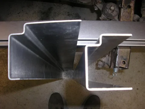

What kind of a brake are you using to make those tight bends? My local sheetmetal guy can only do 5/8"ths minimum bends, and he has all the tools.
He did recomend a heater/AC guy, as they have tighter brakes.

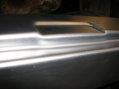

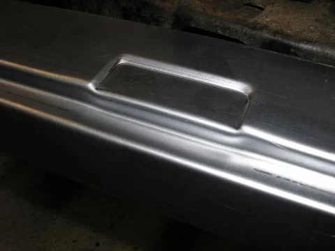

Just a note - on the latch indents, when I press in the indent it deforms the material on the next face below on the channel. You can sort of see it in the indent close up shots above. Personally I think its fine and hardley noticeable but I just want to point it out.
As far as making more goes I am certainly into that. Gus got the "proto-type price" but I just off the top of my head I would charge about... say... $60 for plain older style (no lip or indent) - $65 for the lip but no indent - and $75 for the full deal. I'll have to start a thread in the merchandise storefront section. I'd like to see how Gus likes the fit before making more so I won't be making them for a couple of weeks anyway.
I am using a 0.551/0.709 double V Wilson bottom die with a 40302 Wilson top goose punch and an 100 ton Amada 10' CNC press (though it only takes 8 ton to bend it).
The indent was made on a 60 year old 20 ton press with a quick hand made tool.
