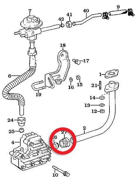

BTW - the random, left-side exhaust leak you heard when driving my 40 - do you think it could come from around that big 36mm nut in the SOR diagram below? I see some carbon/blow by down under around the inside of the fitting/threads. I'll see if I can get a picture up at some point.
When I had this setup on a 2F, I was always blowing gasket #1 because the nuts #12 or studs #21 would always loosen up. I think it was caused from normal heat cycles.
Have you checked these nuts and gasket?
If it is coming from #1 then I believe that I replaced the gasket and then double nutted the studs and that helped. At least it took longer for them to loosen up again.
I never had leak issues with the compression fittings like the one you pointed out.
I took a close look at that "number 1" area in the process of trying to figure out how to pull 26 and 27. In fact it may be hard to get off without breaking something. It looks all original/tight with a nice layer of heat-treated surface rust.
The bottom/back side of 27 looks like it's blowing carbon down the side of the pipe about 4 inches and there's a little "black" on the inside part of the nut.
It's all but impossible to loosen or tighten 24 and 27 on the truck, at least with the fender, steering and exhaust in place. 27 was pretty loose when I got mine apart. A couple days soaking in PB Blaster and I got them to move and tightened them both. The whole EGR system is kind of a hack job. I put mine back together without a #1 for who-knows-why. It leaks, as you might have guessed. The part # for #1 is 25628-61060. I think a copper crush washer that fit around the pipe would work well.
the black carbon is sure sign of a leak so l think you are correct to suspect this as a possible source of the noise. Exhaust noise was one of the most frustrating aspects of the 2F in mine. I could never keep exhaust fasteners tight even replacing them with OEM parts.
4" along the pipe seems like a long ways for the carbon to be along the pipe if just leaking from the nut/compression fitting, I wonder if the pipe itself is cracked?

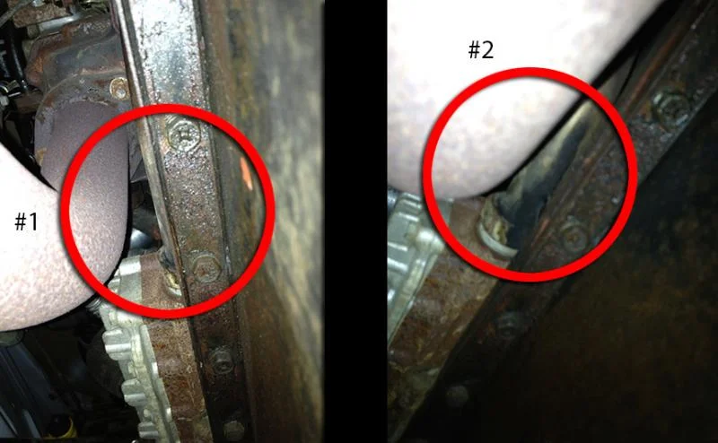

Excuse the iPhone photography - hard to get a good view of the nut. Image #2 is blurred but shows the extent of the black stuff. Up close I don't see a crack but I guess there could be. I assume 25/26 (SOR diagram) are some kind of sealing ring?
In real life this area actually looks better than the photos, threads/nut look pretty clean and silver-like - wondering if the factory applied any kind of goop/sealant to these parts when assembled. At the very least, at some point when the truck's hot I want to see if this 36mm nut will turn a little...
Because the upper area (SOR diagram #1) seems stable I'm thinking it might be a good idea to leave everything alone and keep an eye on it for a while. Luckily I don't have Mike's good ear - think I've only heard a little "mutter" of what could be an exhaust leak once or twice.
LOL, well my wife tells me I need to get my hearing checked. :p
Looking at your pictures, I'd guess now that the black soot might be carried along the bottom of the pipe with water. Basically, normal condensation in your exhaust after startup that is finding a small exit in that joint and carying the soot with it and running along the pipe.
If you don't hear anything then I would suggest not messing with it.
I think the ring is a compression style that squeezes the pipe when the nut is tightened, the ring's outer surface also seals against the egr cooler body.
In my opinion, it may not be water tight but still not producing enough of an exhaust leak to worry about.
