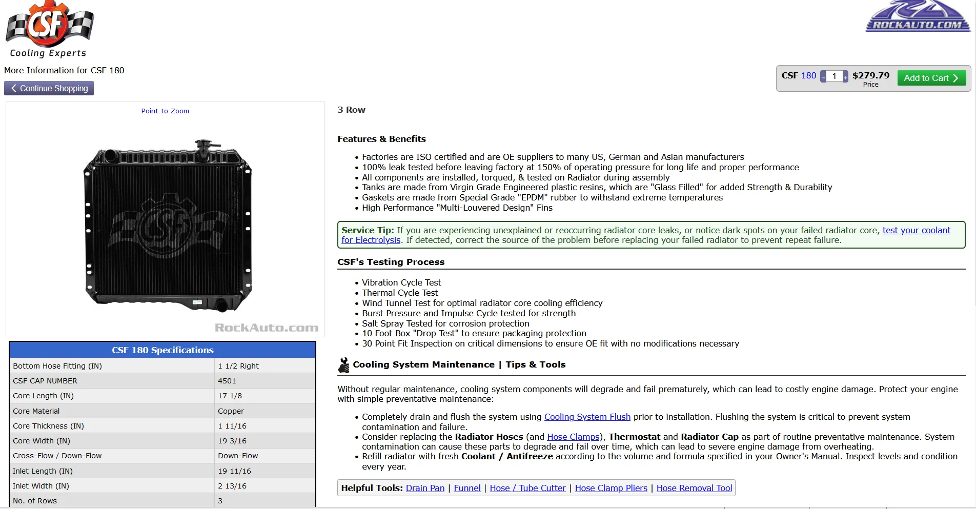

CSF is sht

That one looks good, maybe I should've gone that route.

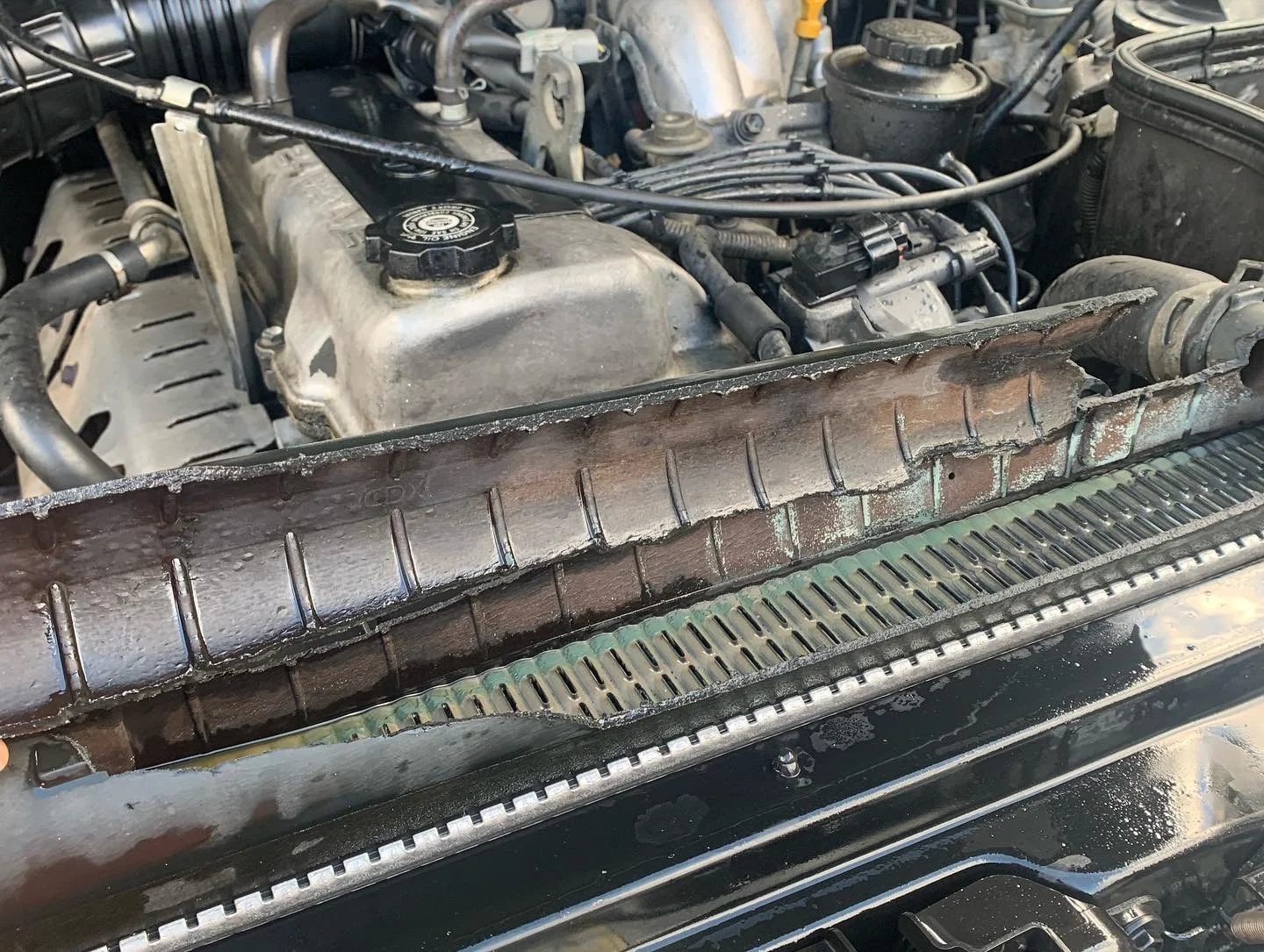

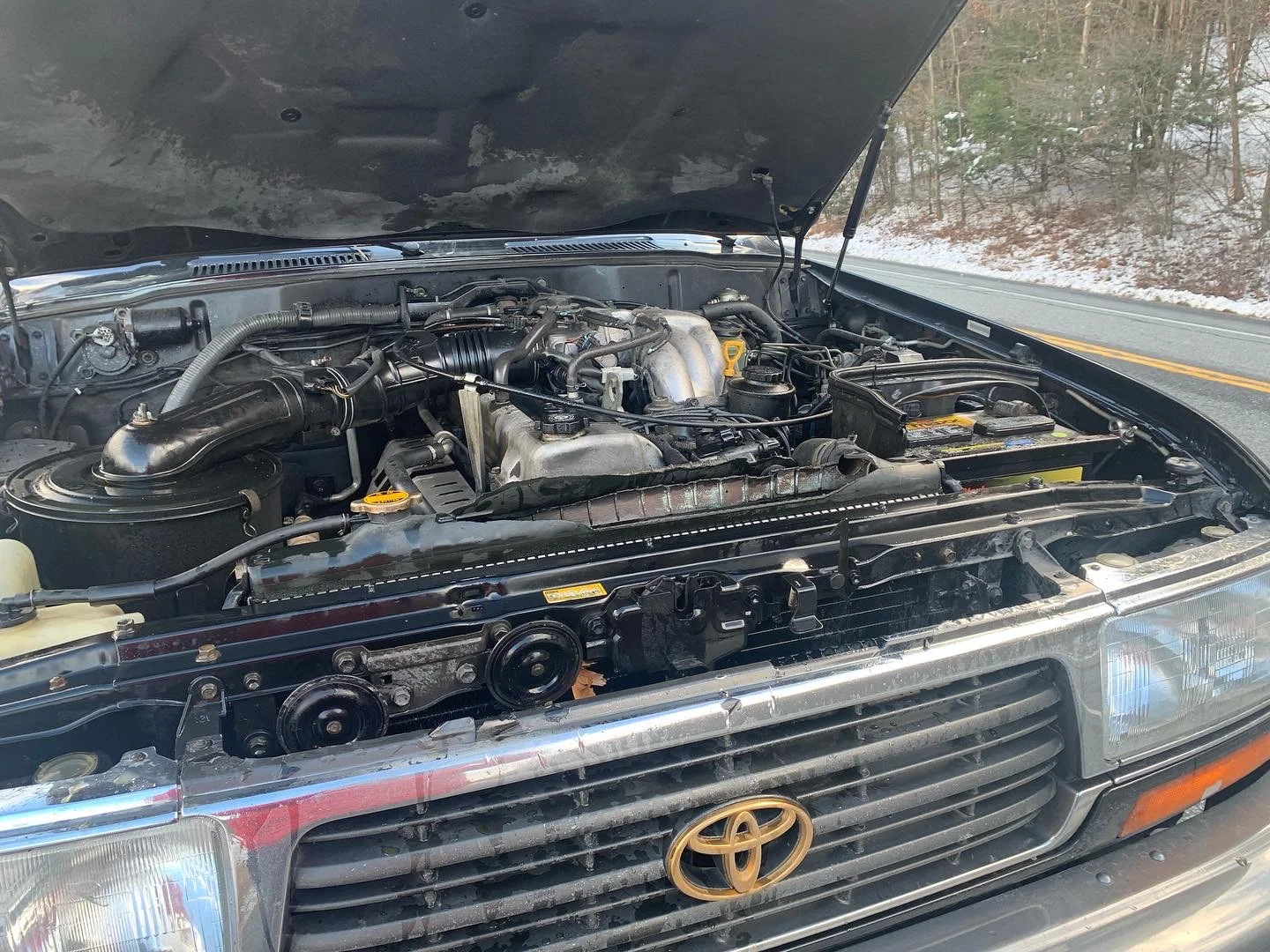

this is what my '96 did right before x-mas

CSF is sht
I received mine used so I had it disassembled, cleaned and resoldered and flow and leak tested, prior to installation. I can't speak for the factory new condition.
The jury's still out on mine. When it fails, I'll let you know.
