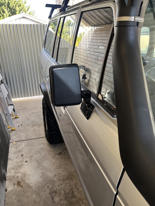

Shiny new 76 series mirrors fitted

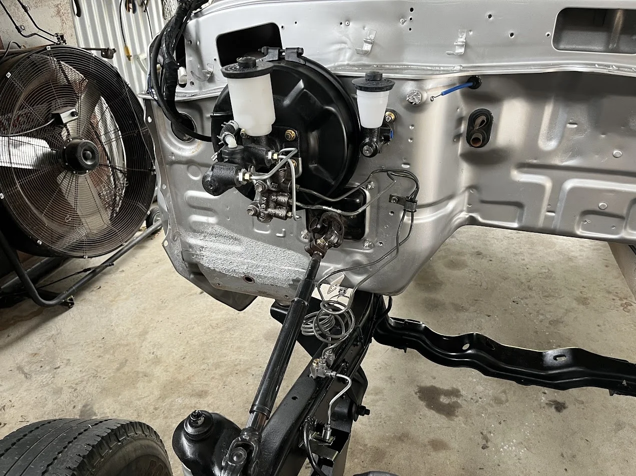

Whoops.. I had the rear and front braking circuits swapped... the rears were locking up under light braking and the fronts barely working.. after swapping them it now pulls up amazingly well. A factory baselined 60 braking system works very well!
Rebled the brakes and readjusted the rears.. she's pulling up really smartly now, well pleased with how quickly it can be stopped.

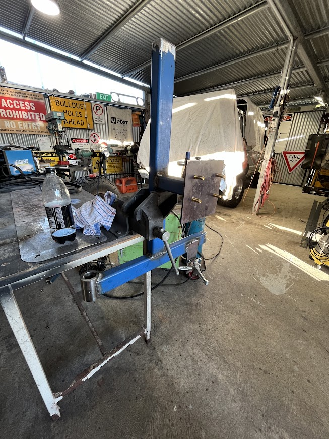

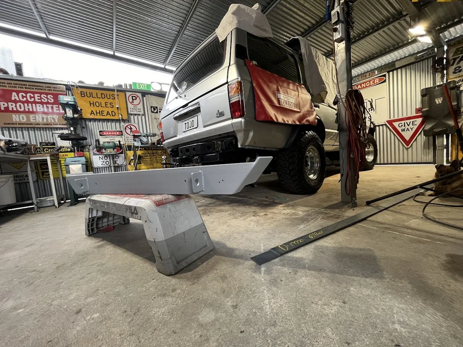

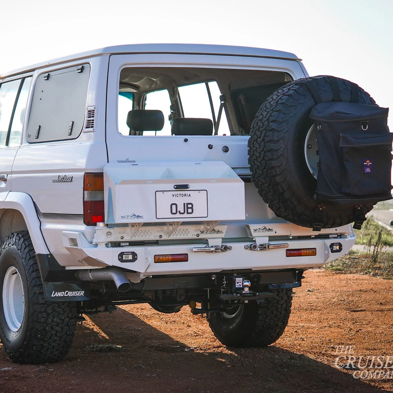

Back into the shed.. time for a rear bar with dual rear wheel carrier and highlift jack mount.. the bar I am sorta copying and my progress so far.. the beer can represents the spindle for the wheel carrier.
way cool mate! what sort of welder are you running?
An old MIG Magmate Pro 250.. I'm eyeing off some of the Unimig models though! Might be time for an upgrade. I do have a decent TIG welder as well, I had the best intentions of learning and still havent fired it up in earnest..

About 60% done with the fabrication of the rear bar.. Two spare wheel carriers next weekend if the mounting spindles and over-centre latches arrive this week..

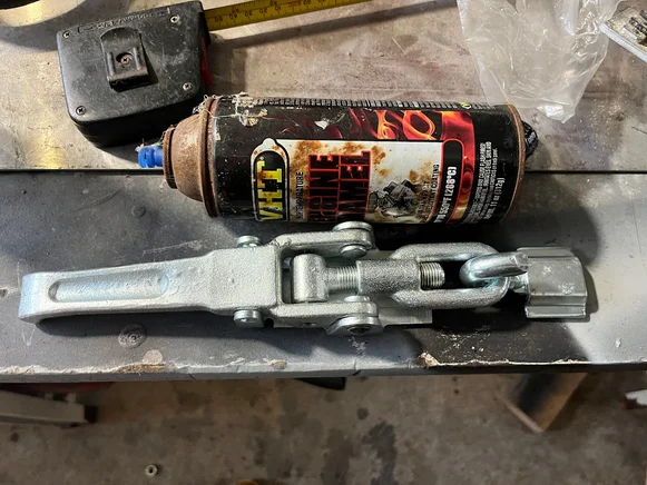

First rear tyre swing almost done.. this was more challenging than I anticipated but I think the outcome is going to be good.. also check out the chunky boi Over-centre Locks I got! As usual, metal fabrication looks like complete rubbish until its got a nice coat of black paint on it.. a bit more grinding, radiusing, and flap disc work still to go.. cause I aint a welder!
